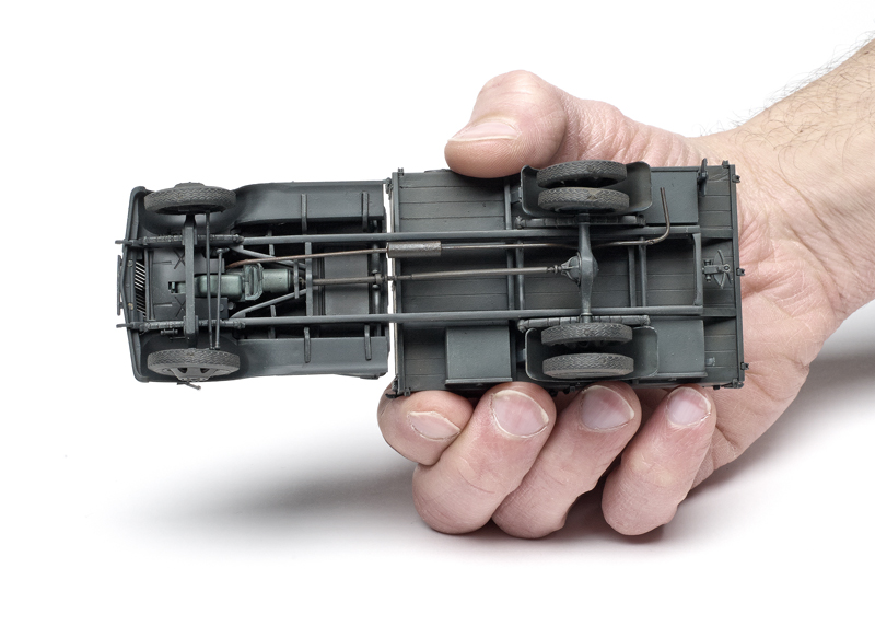

The frame comprises multiple parts. I skipped Step 8: It was easier to assemble all the major components of the frame first to make sure it was square. Then I glued the cross members from Step 8 to Part A64 and the sides of the frame, which allowed me to ensure they were properly aligned. The muffler is shown glued to two posts on the frame; it’s not a lot to hold it in place, so it’s easy to break off. Remember to drill out the end of the exhaust pipe.
The vinyl tires are the real low point of the model: not much detail and a lot of flash on the sidewalls that is difficult to remove. They are also undersized, especially noticeable in the rear where there is too much space between each tire of the dual rim. There are replacement wheels on the market, designed for 3-ton Blitz models, which would serve this model well.

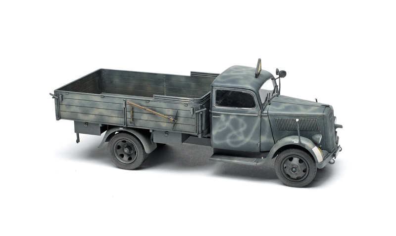

After seeing a vehicle painted in panzer gray with a sand camouflage on an Afrika Korps forum, I decided to add a camouflage pattern with markings for the truck in Russia. I primed with Vallejo German panzer gray (No. 603) and used AK Interactive’s panzer gray color modulation set for a faded gray, then overpainted with Vallejo Model Air sand yellow (No. 71028).
The decals were thick, had a lot of carrier film, and were impervious to Solvaset, even over a gloss coat. Silvering appeared after I applied Dullcote. Furthermore, my decals were out of register. I recommend going with an aftermarket product instead.
I weathered with washes and filters from Vallejo and AK Interactive, painted small details with Humbrol paints, and added the clear parts after painting. The windshield and light lenses required only a little glue to hold them in place. The rest of the windows snapped into place.
