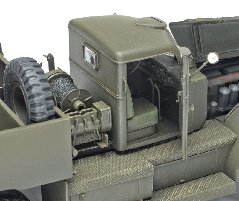

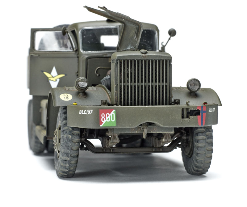

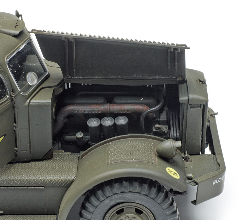

Assembly starts with the Hercules engine, which comprises many tiny parts in great detail. For example, there are three fan belts for three pulleys on the front; I had to enlarge their grooves to properly seat the belts. You could add engine wiring (not supplied).

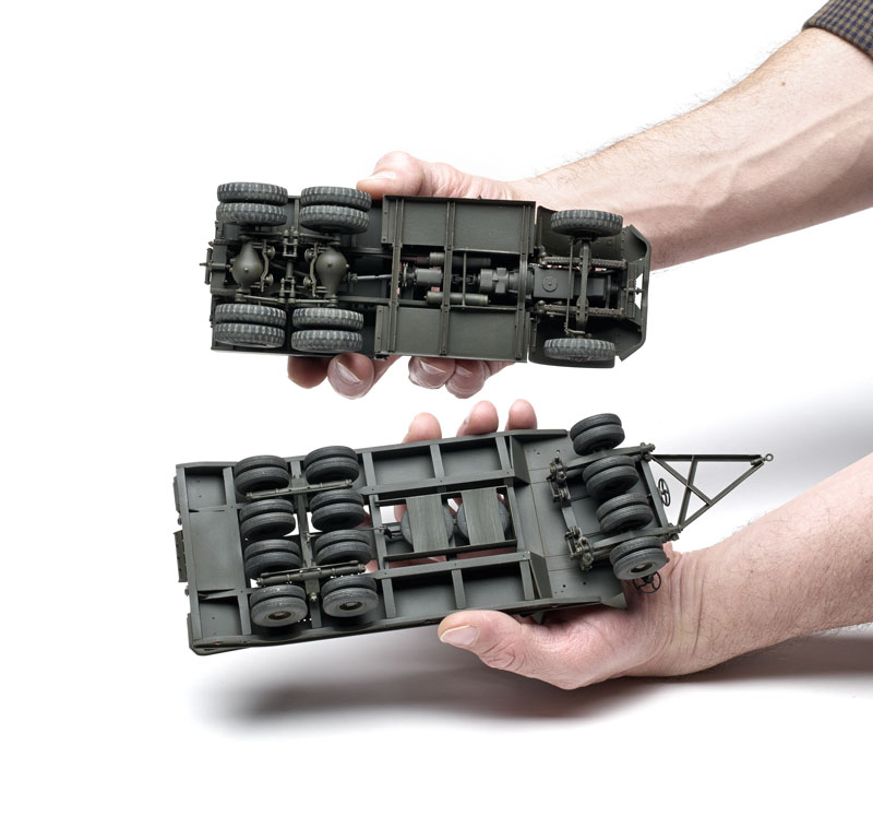

The frame features multiple parts, but the fit is good and the frame square. Make sure you mount the muffler when it is called for; you can’t add it later. I painted the frame interior dark green before adding details to get paint into all the recesses. Leaf springs are molded in halves, leaving a nasty seam to fill.
In Step 5, Part B1 should be marked B2. Sliding the rear differential onto the leaf springs while connecting them to Part B7 and the drive shafts requires at least two pairs of hands. I glued the brake drums to the axles instead of the rims as shown in Step 7.
The vinyl tires have good treads but no trademarks. Photoetched-metal tread plate is provided for the side steps and fuel-tank covers. You’ll need a photoetched-metal rolling set to bend them easily.
String is included for the winch cable, but mine frayed even after clear-coating the spool. Also, it is too short to show a tank being winched onto to the trailer. I recommend replacing it.
A one-piece decal represents all gauges in the cab. Nothing I tried would settle it down over all the irregularities of the dashboard, and I ended up ruining the decal. Better to punch out each gauge separately; there a lot of gauges, but the result would be worth it.

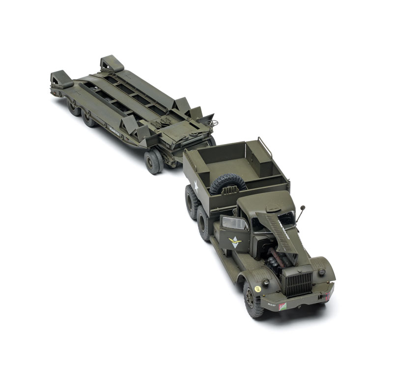

The M9 trailer is a model unto itself. I prepainted the interior of the chocks, rear ramps, and lower cross-member assembly the same dark green to ease painting. Fit of the rear-axle is poor, leaving a bad seam.
Step 16 directs you to bend parts PE-B5 but doesn’t say how. Reference photos show this is a retaining bracket for 10 U-rings on the sides of the trailer. It is a complex bend I was not able to replicate. They are tiny, but Merit does give you an extra four to sate the carpet monster.

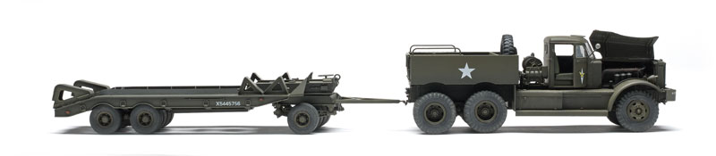

To make moving the model easier, I recommend gluing the tongue of the trailer to the truck as shown in Step 24 and snapping it into place on the trailer when showing the two models together.

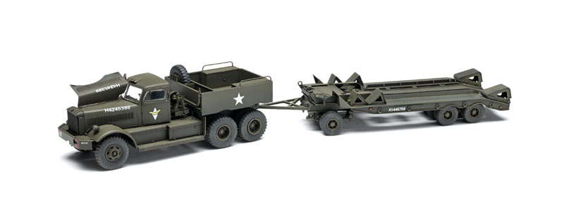

Based on the markings, you have only one color choice — olive drab. British vehicles in the Mediterranean and North Africa had some colorful schemes, but you’d need different markings.
I gave the model a coat of Vallejo olive drab primer followed by Tamiya olive drab for the primary color. Spraying olive drab lightened with Tamiya yellow green imparted some color modulation. On the trailer, LifeColor olive drab provided some variation. I painted details with Vallejo, Humbrol, and Testors Model Master colors and weathered with various Mig and AK Interactive washes and filters.

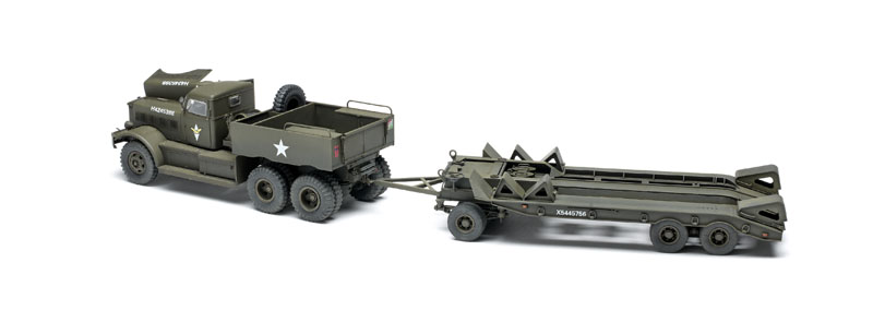

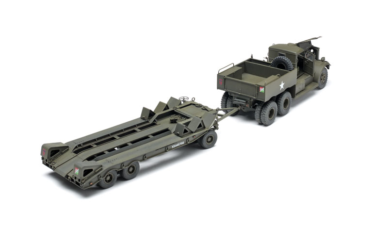

The decals are some of the best I’ve ever used — easy to move without tearing and drying dead flat with no silvering. The finished model is absolutely stunning.
