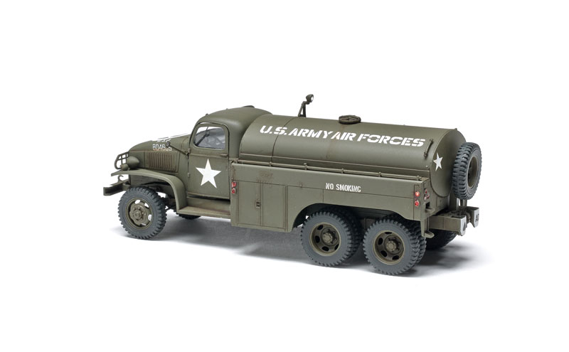

After attaching the cab and tank to the chassis, I tacked all of the doors in place and masked the windows. Vallejo olive drab paints sealed with Pledge FloorCare Multi-surface finish prepared the way for decals. You get a choice of two USAAF trucks in France in 1944. The decals laid down perfectly with help from Micro Set and Micro Sol.
I hand-painted the tires and details, then sealed everything with Vallejo matte varnish.
The wheels attach to the axles solidly and the vehicle sits perfectly on all 10 tires.

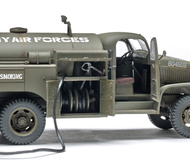

The windshield pops into the cab so well that it didn’t need glue, but the side windows do. Attaching the doors revealed the only fit problem. I could not get them to conform to the frames. I think the problem lies in slight warping of the cab. I left one door open.
The instructions indicate that the upper door of the hose compartment should be closed and the lower two left open with the hose running out of it. I couldn’t find any photos showing refueling, but the placement of the nozzles and the bar on the inside of the cross member made me think the hose is more accessible from the top. So, that’s how I posed mine.
