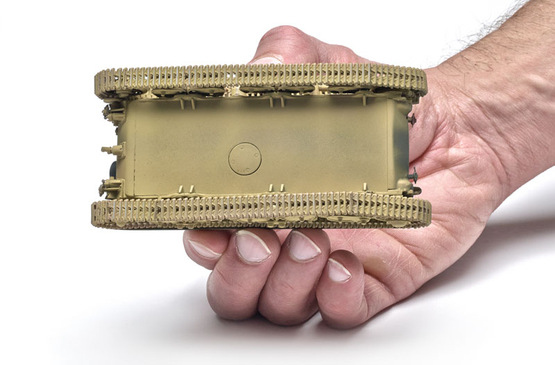

The suspension was a challenge. The photoetched metal is very stiff (it appears to be two layers). I bent parts PE-4 over an artist’s pencil, then folded up the sides; there was no form to check them for accuracy. I super glued them to parts D18 and D27. After curing, they were super glued to the other halves. Because of the poor gluing surfaces, these suspension parts are fragile. I painted the tracks with Floquil mud and dragged a silver pencil over the track cleats.

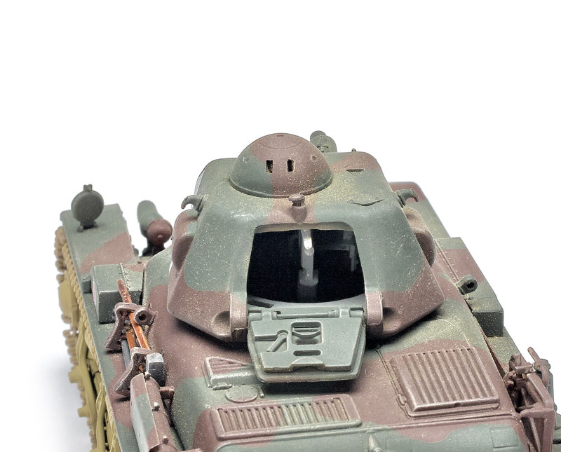

The turret presented no problems. The main armament, the 37mm cannon, does not have a breech. Considering the commander’s hatch can be open and the breech can be seen, I’m surprised it was not included. Three hooks on the commander’s hatch (parts E9, found in a corrected parts map on an enclosed errata sheet) were too tiny to pick up with any of my tweezers, and one went to a galaxy far, far away. I suggest leaving them on the sprue and cutting them apart from one another; use the piece of sprue to hold each part in place to glue.

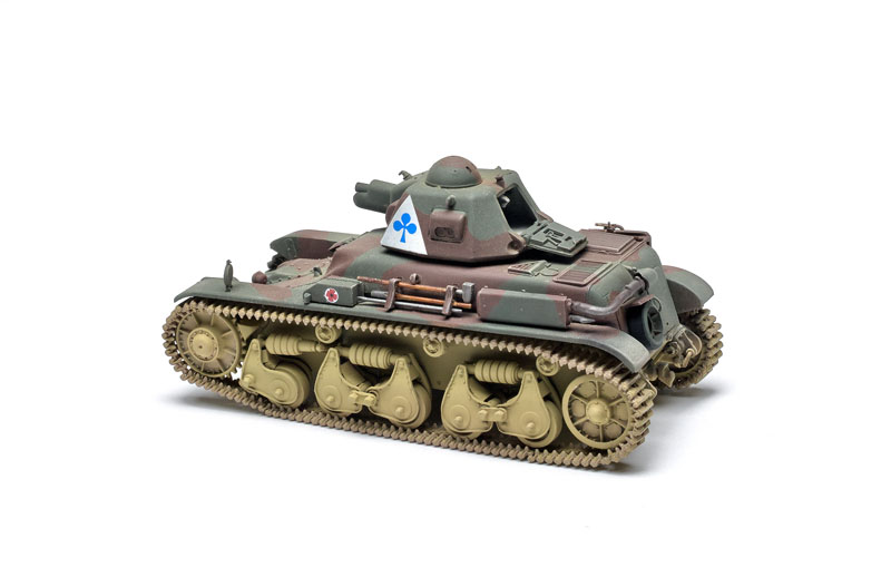

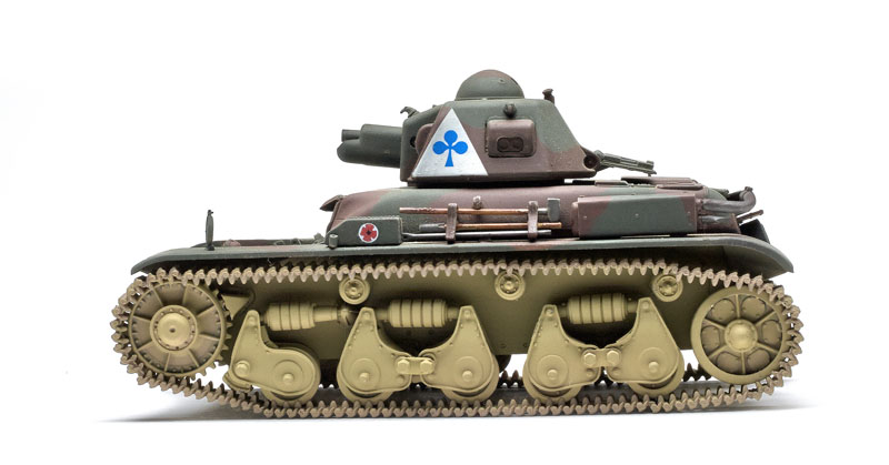

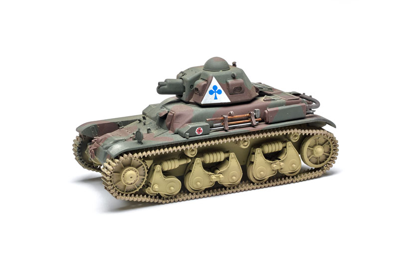

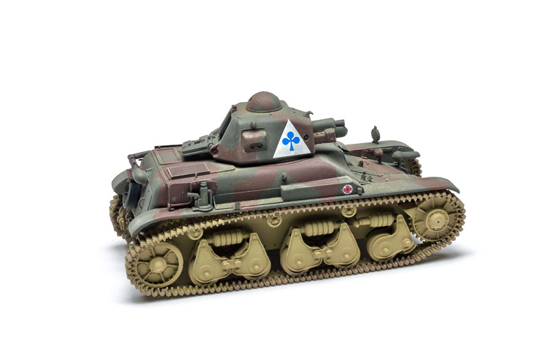

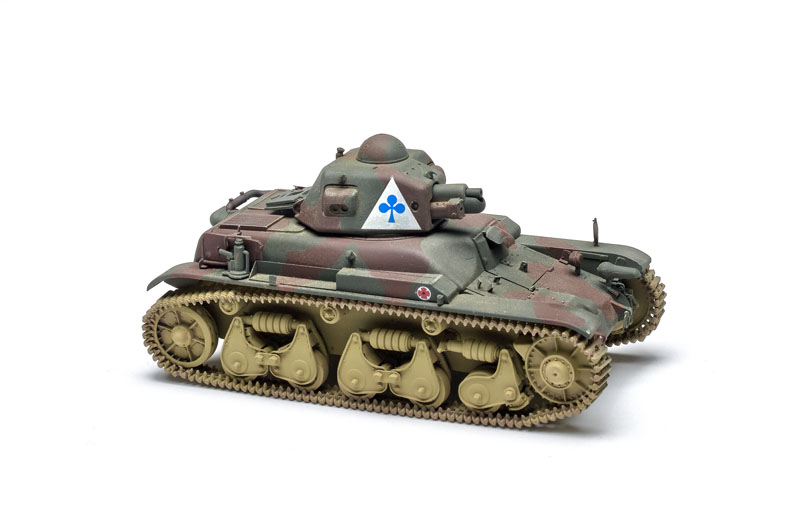

I built the R35 in French markings, painting the camouflage with Tamiya German field gray (XF- 65) and red brown (XF-64) and applying Tamiya weathering powders.
I took 38 hours to build this kit, spending half of that time on the suspension. As complicated as that was, I can only recommend the kit to experienced modelers.
