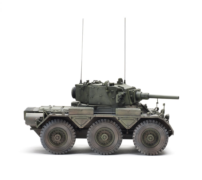

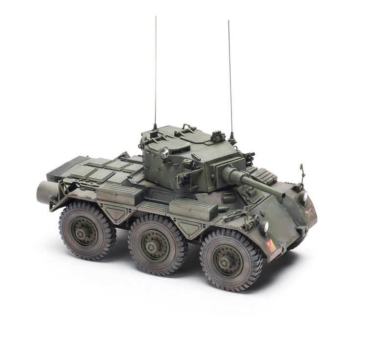

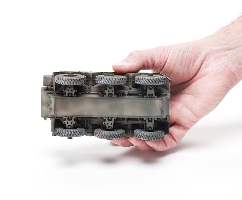

I started by gluing the hull together. Follow the directions carefully as you add the suspension parts. Some look identical — but aren't — so work carefully. It's important to leave the front steering arms movable so you can adjust them later when you add the connecting arms to the wheels. The fenders fit perfectly. I left the wheels off until I finished painting the model.

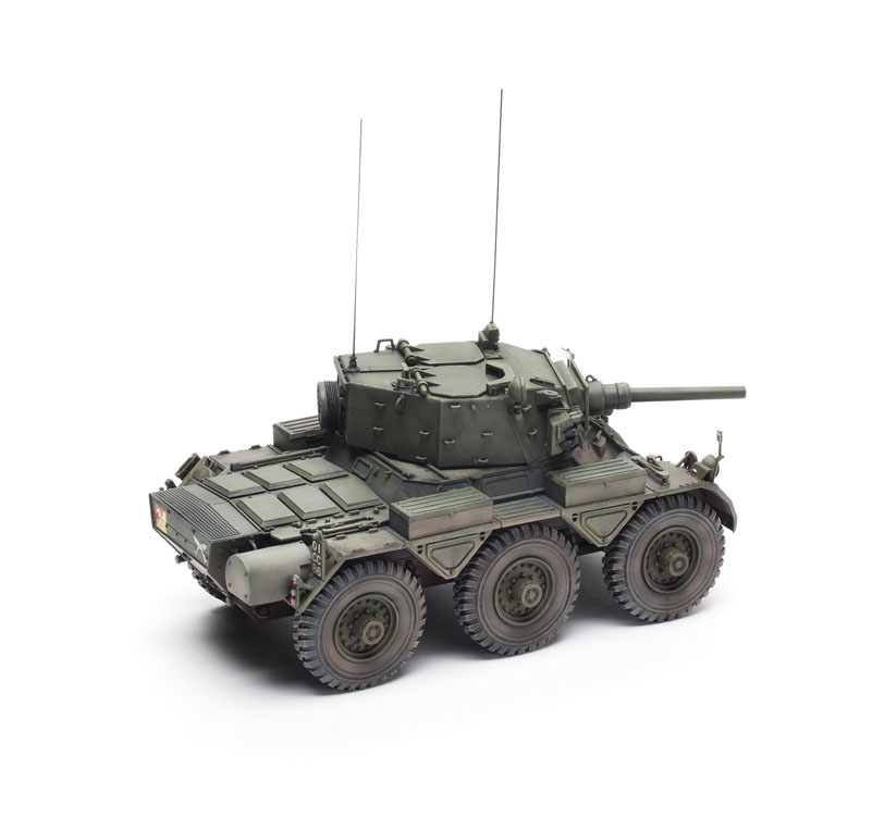

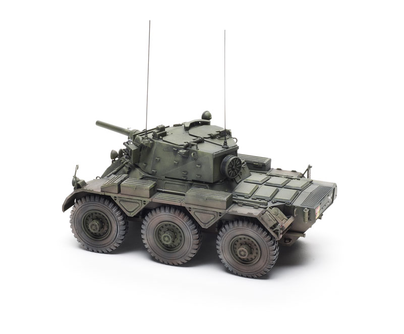

The turret assembled quickly and easily. The only error I found in the instructions was the location of the periscope in Step 15 — it should go behind the commander's hatch. Though it's not noted in the instructions, you could leave this periscope off and close its cover.
While the main gun is designed to be movable, mine was too loose to stay in position. So, I glued it in place. The reel on the back of the turret is for a spool of communication wire, so I wrapped thin lead wire around it. The antennas provided in the kit are thick and short; I drilled out the mounts and added stretched-sprue replacements.
The painting diagrams for the black-and-green vehicles show only three views: one side and the back and front of the vehicles. Complete views really would have helped. When I decided to paint my vehicle in the scheme of the Queen's Royal Irish Hussars (deployed in Brunei in 1966), I found a photo of the exact vehicle which showed it in a solid-green paint scheme instead of the black-and-green scheme on the instructions.
I used Tamiya dark green as my base color and highlighted it with applications of RAF green and NATO green. I applied the decals over a coat of Vallejo clear. A little Solvaset helped the decals conform to the rivets on the rear plate. After adding a light dusting of Tamiya earth and buff to show light road grime, I gave the vehicle a wash of black artist's oil paint, then dry-brushed it with Vallejo dark green lightened with medium flesh.
I spent about 18 hours building my Saladin: pretty quick thanks to the excellent fit and the monochromatic paint scheme. The finished model measured favorably to the dimensions in Ian Hogg and John Weeks' The Illustrated Encyclopedia of Military Vehicles (Book Sales, ISBN 978-0-906286-75-3). Despite some disappointments along the way, the finished model really looks like a Saladin armored car. I think the corrections the model requires are well within the skills of most modelers. After all, isn't adding detail to make your model a bit different from everyone else's what modeling is all about?
