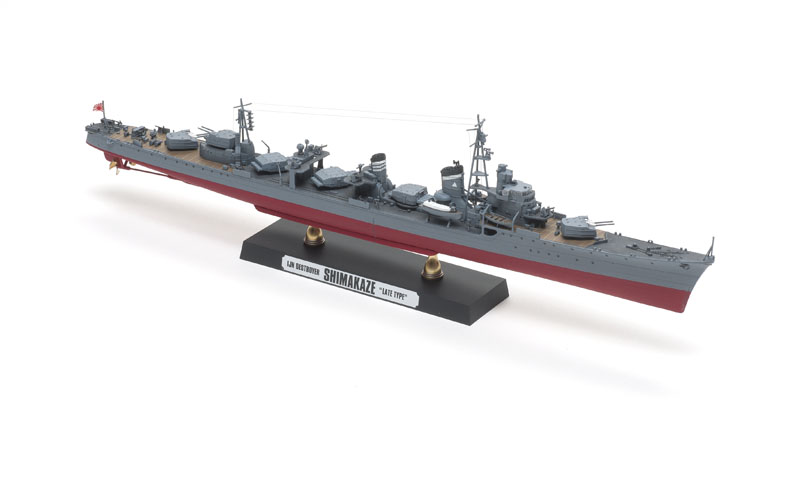

But I did apply Hasegawa’s self-adhesive linoleum deck (No. QG58). Precut sections cover the fore and aft decks and have the brass expansion joints printed on.
Using these decks forced me to rethink my building order. First, the decking can be pulled up by masking tape, so in steps 11 and 15, I assembled and painted the bridge and aft wheelhouse and attached them after the decks were down. Second, I removed the molded lines on the plastic parts so the deck would lay flat and seal.

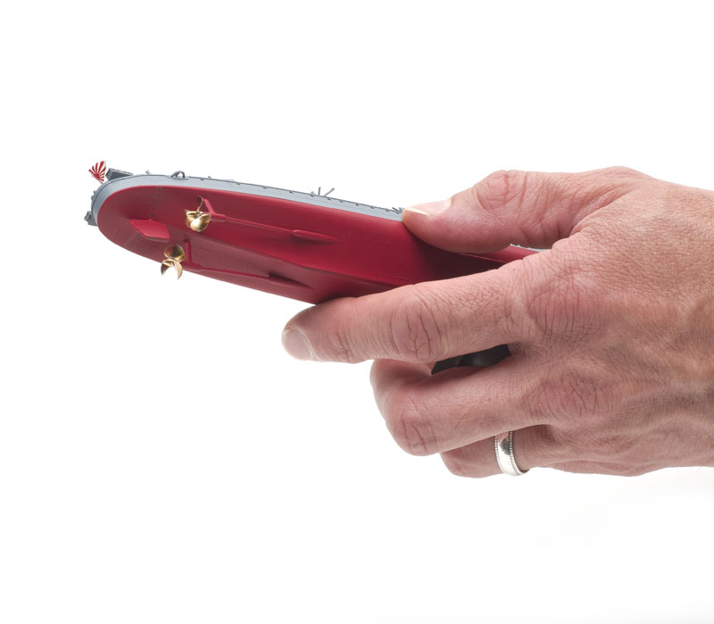

The upper deck curves to match the hull. Five pegs along the centerline attach the upper and lower hulls. The fit is firm and snug and I didn’t need to use glue or filler around the deck edges. Very nice!

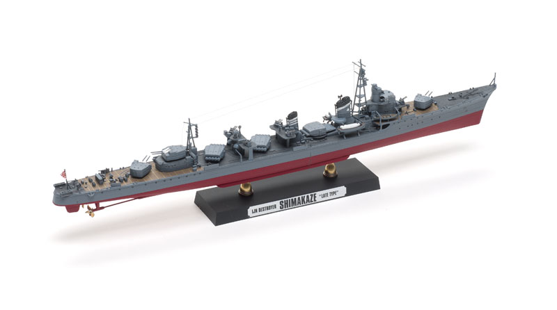

The instructions number the sequence of part attachment in steps and include multiple views of how parts interact, which eases assembly.
The bridge has nine binoculars or binnacles, all of which are undercover but visible through the windows. A decal provides bridge window frames.
The design of the parts for the aft wheel house impressed me. The joints are at the corners, preventing seams often found on the centerline — nice, logical engineering.
Step 22 adds myriad deck winches, depth-charge launchers, and ammo lockers, but a top view aids location.
Assembly of the complex masts span three steps.
I added the 7-meter cutters and 8-meter boat helped by Step 34’s clear instructions for the davits, boat cradles, and boats.

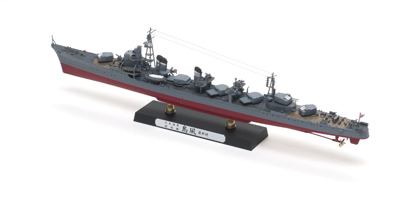

The painting and decal instructions are supplemented by two pages of rigging diagrams. Be warned: To rig as shown, you will need the PE upgrade. Using stretched sprue, I rigged as much as possible without scratchbuilding parts.

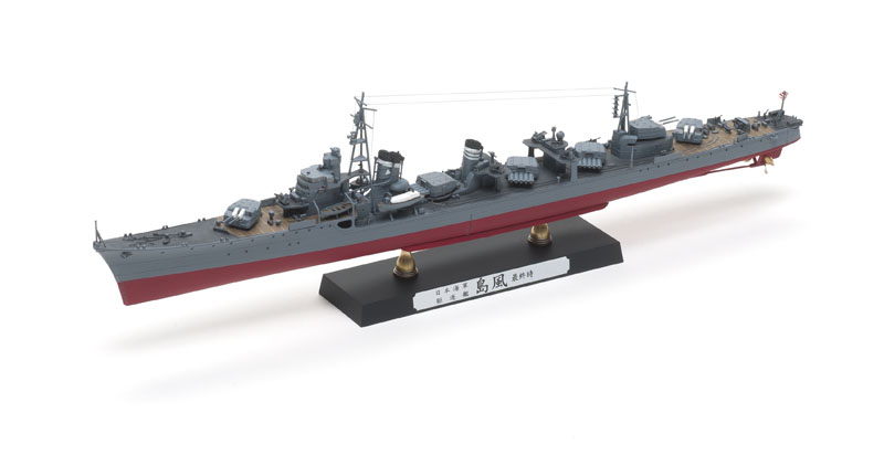

The model measures within 1mm in length and spot on for width.
Hasegawa’a Shimakaze provides a solid foundation for anyone interested in upgrading and superdetailing. I spent 37 hours on mine, a bit more than normal, but that includes time experimenting with the self-adhesive deck.
