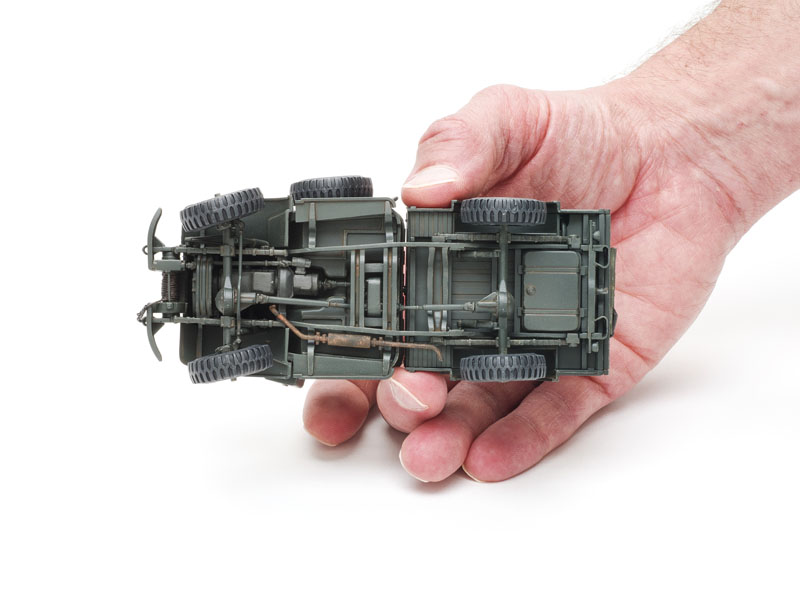

The assembly steps jump around, so study the instructions for the sequence that works best for you. I started with the engine by building the major components first, then adding the detail parts. Make sure to remove the small tabs on Part A13 as shown in Step 9, or A29 will not fit right. If you are building a vehicle without a winch, you can skip adding parts A20 and A35 to the transmission. I left the engine and muffler separate for easier painting.
A single-piece frame is provided — mine showed no twisting — but be careful when cleaning it up to avoid damaging the mounting tabs on the side of the frame.
You can pose the front wheels turned, but they’re not workable unless you add pins to the tie rod. The shock towers should be reversed from how they are shown in the directions; Part A55 is really Part A56. Sidewall detail on the vinyl tires is good, but the four tree attachments and center mold seam are hard to remove, even with new side cutters and a scalpel. My kit was missing the winch string; I replaced it with nylon suture. Connecting the front bumpers and winch to the frame left gaps that needed filling.

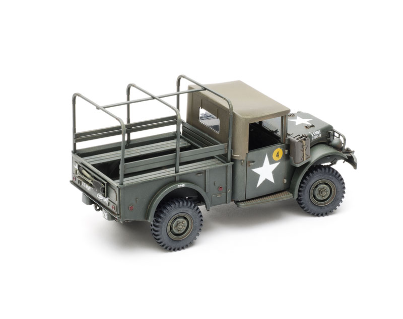

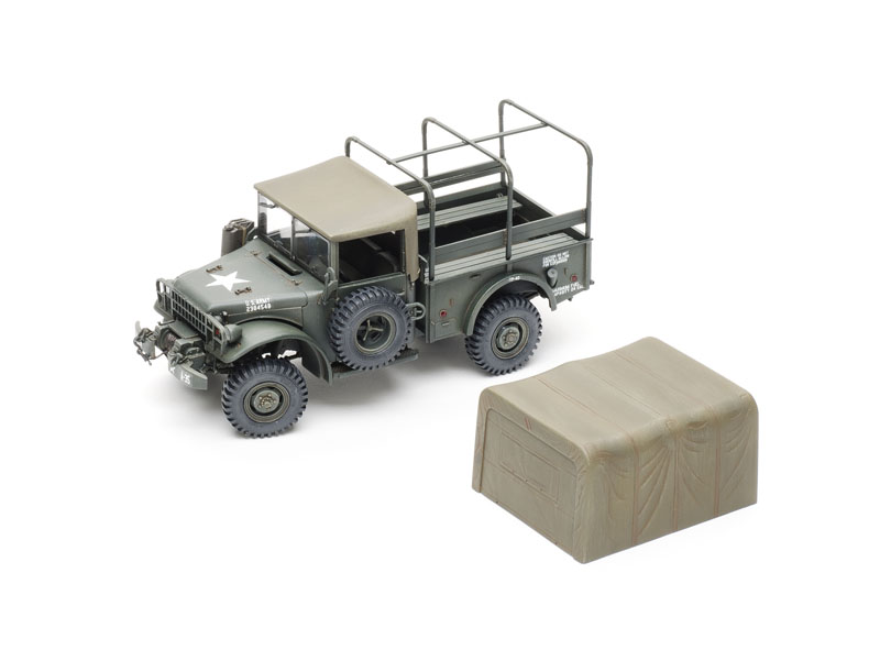

Building the truck bed is straightforward except for the previously mentioned lack of directions regarding vehicle variants. The M37 has a shortened seat on the passenger side to accommodate the spare tire. Part C23 is the shortened seat, and C25 is the spare-tire mount. Depending on which seat you use, the extra hinge molded on the bed’s side (C18), which is not marked in Step 29, needs to be removed. When building the bed, you have the options of raised or lowered seats, canvas frame or no frame, and, if you want, the canvas top. The bed cover provided is the full version, not the one shown on the box top.
The U.S. vehicles in Vietnam were painted a dark olive drab that looks almost black in pictures of the period. To simulate this color, I undercoated the model with Tamiya black green (XF-27) and followed with a primary coat of AK Interactive’s U.S. Army olive drab (AK4011). The highlights are Ammo of Mig Jimenez U.S. olive drab post-WWII (MIG-081).
The decals were the biggest problem in this kit. They are in register. But I had trouble getting them to adhere, especially over irregular surfaces. Neither Solvaset nor Micro Sol had any effect. The bridging symbol showed severe bleed-through of the underlying olive drab color, and the star on the hood was not solid white. Decal No. 7, which was supposed to be placed on the driver’s side rear bumper, was so large that there was no way to make it fit. Most of the decals needed excess film trimmed to get them into their allotted space; the dashboard gauges were the worst.
