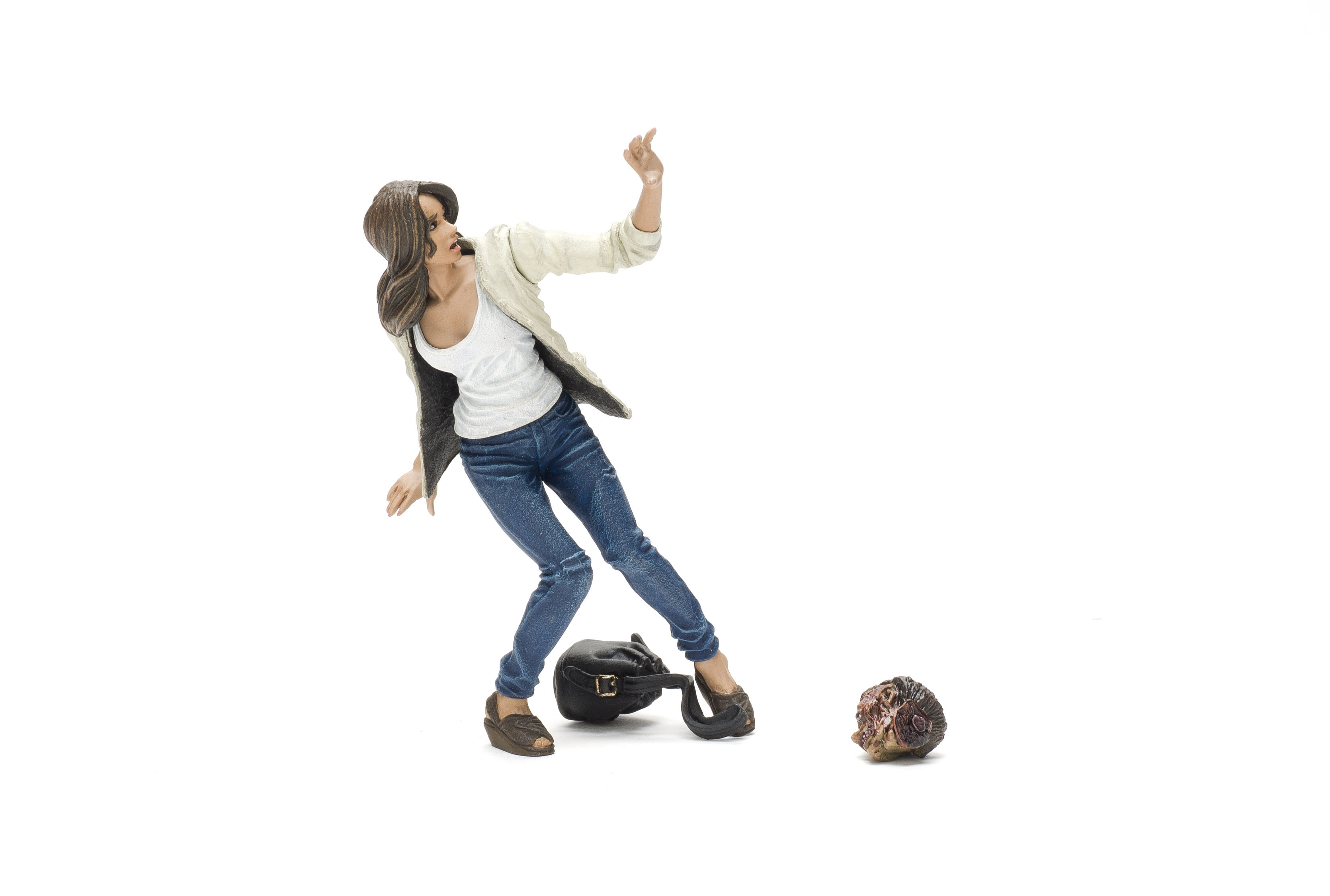

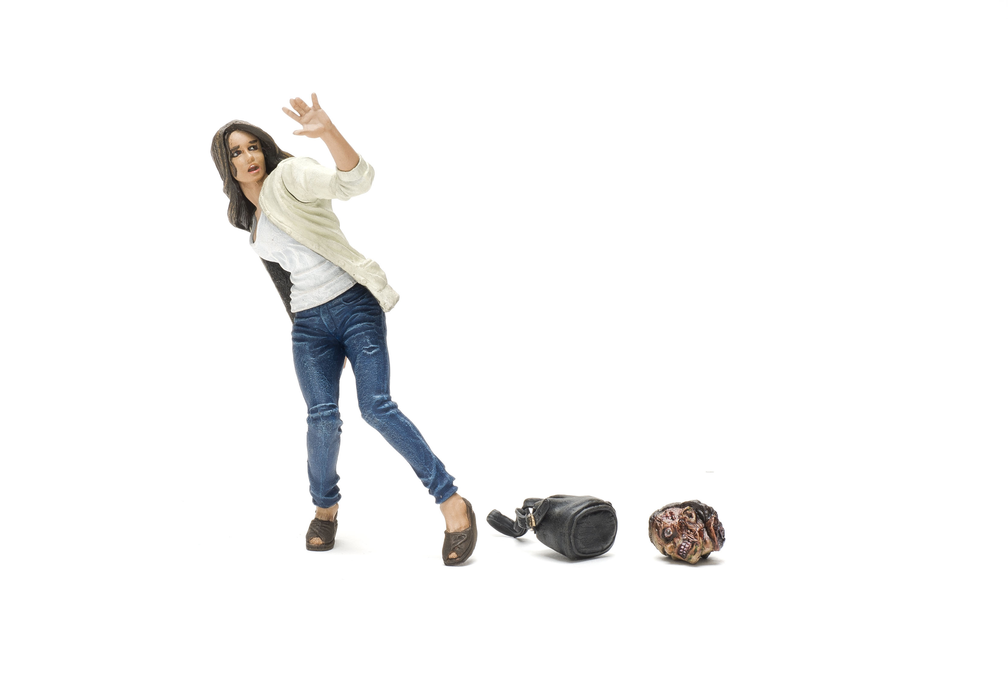

On the heroine, I glued the face to the upper part of the torso and filled a small seam under the chin. But I might not have needed to, because the kit is engineered so you don’t really see the join.
I dry-fitted the woman’s head and torso to get the hair aligned. This was the only tricky part of any of the kits. I glued two of the three hair parts together, painting the inside of the hair pieces black before attaching them to the body as they would be hard to reach after assembly.

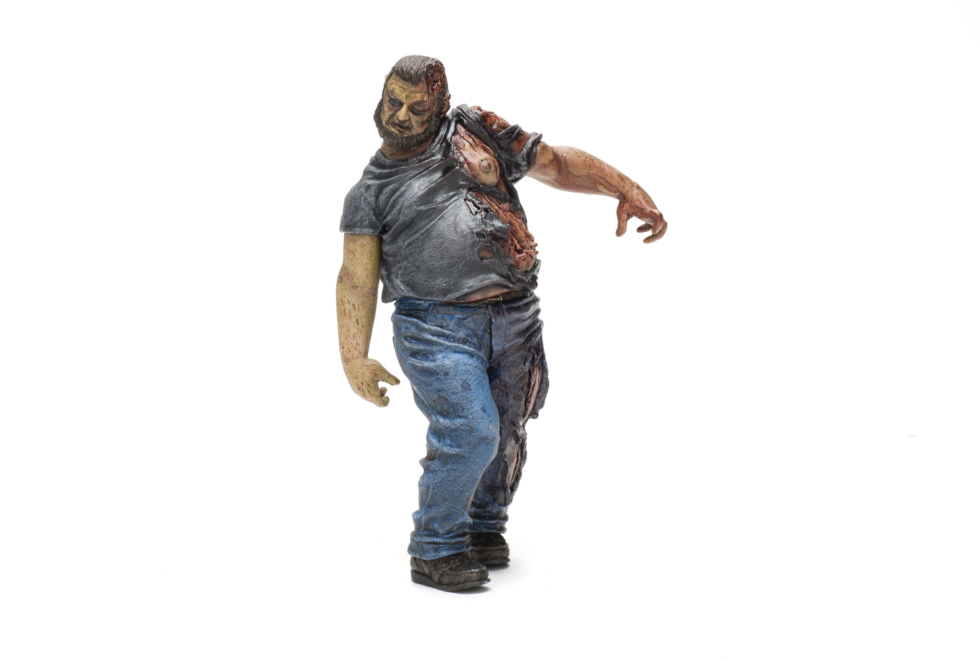

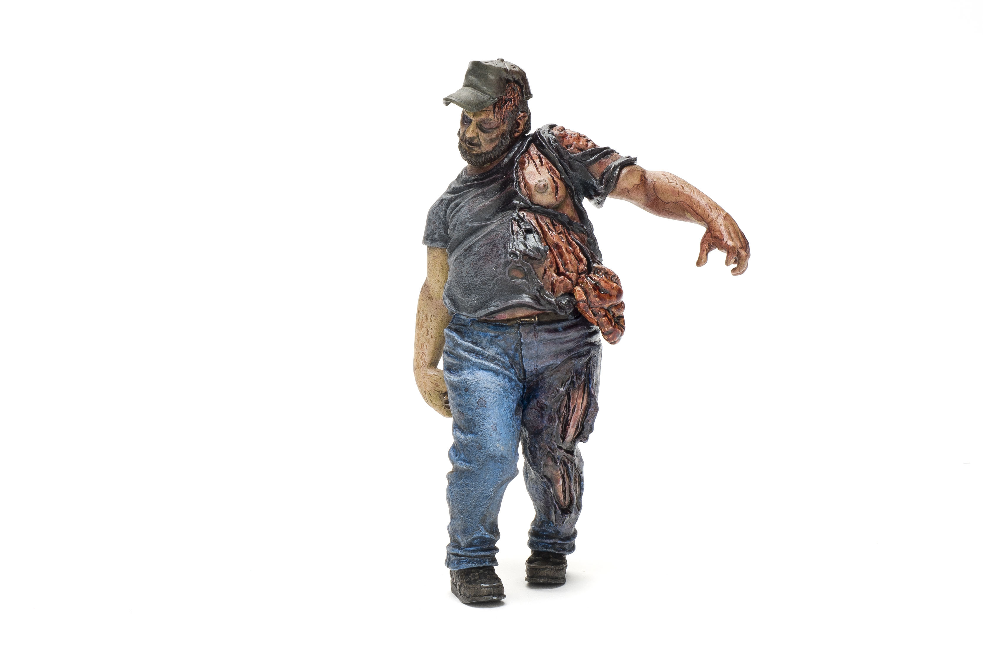

I filled tiny gaps on the truck driver’s wrists. He comes with an optional cap and some intestines if you want extra gore; the part snaps on so you can take it on and off.

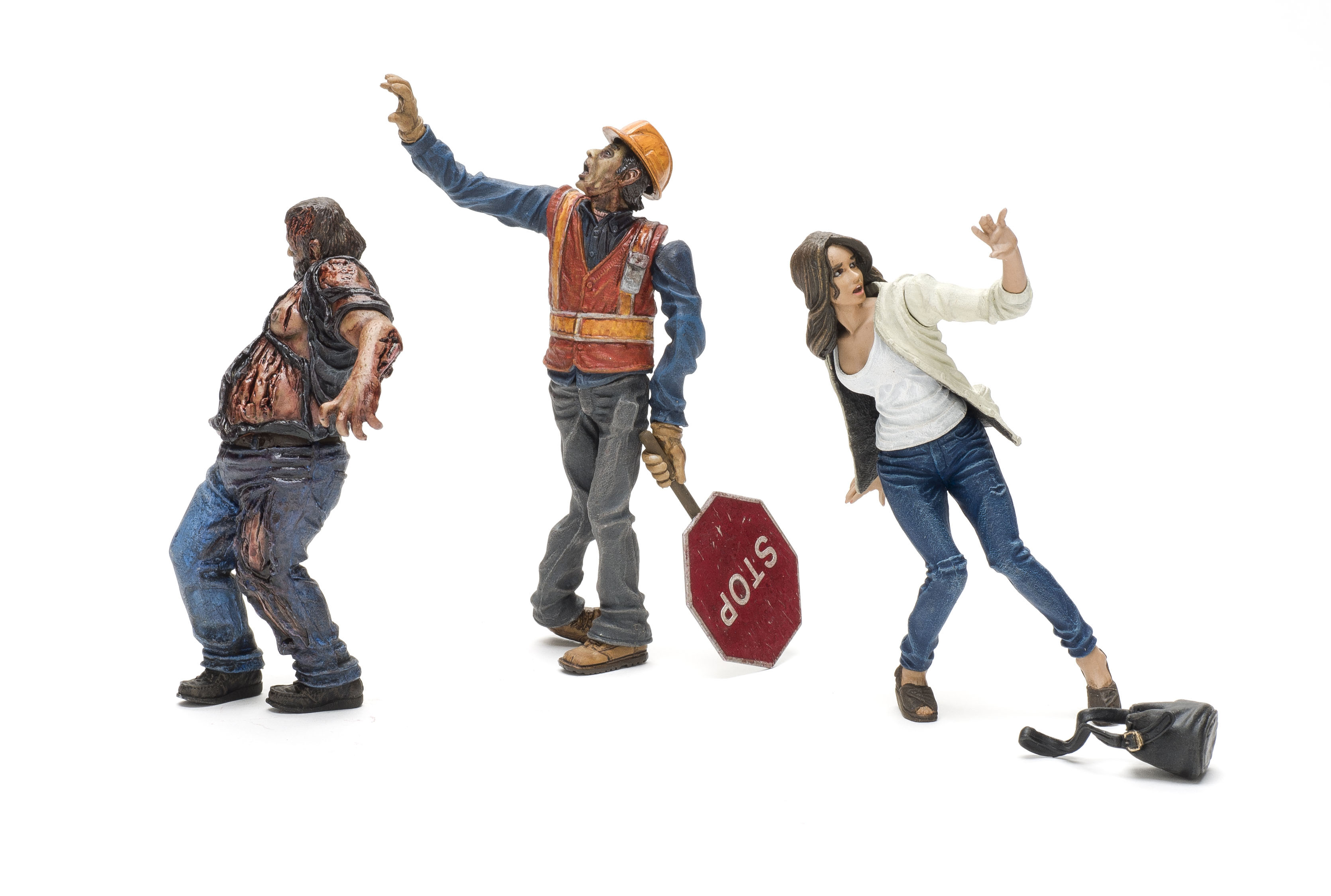

Building the traffic guard was straightforward, and the kit includes optional left arms and a hardhat. I wanted to leave the head off for painting, but it locks into the torso halves. So, I just trimmed the front part of the mounting tab and was able to snap it into the torso afterward. I wish the kit included decals for the stop sign; I used dry transfers from a craft store.
