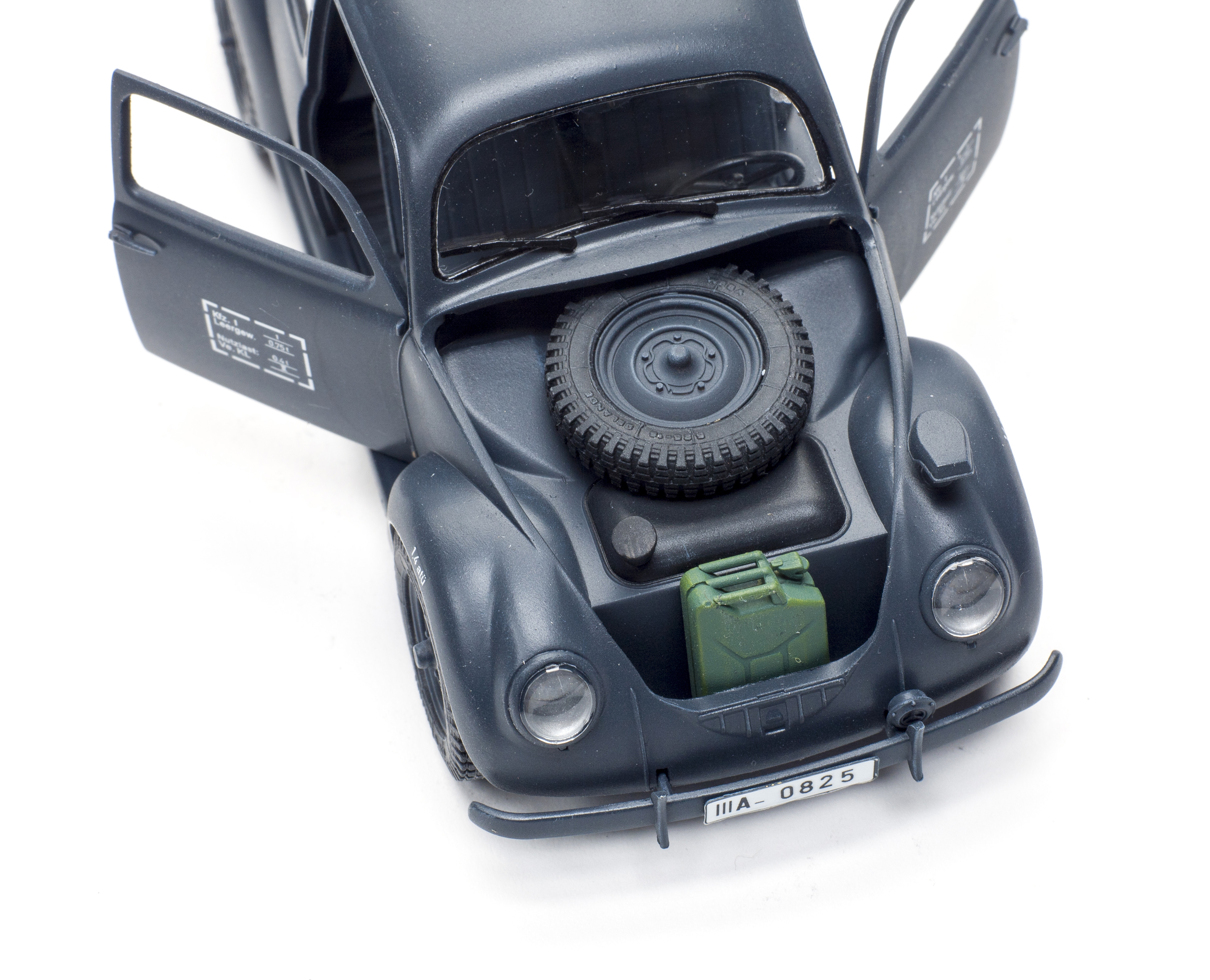

Underneath the car, the exhaust and heater shrouds are finely molded with sharp details. Cement the torsion bars right side up; I didn’t and the final model has a raked look. Kronprinz wheels and Continental balloon tires are provided if you choose to replicate the Afrika Korps vehicle.

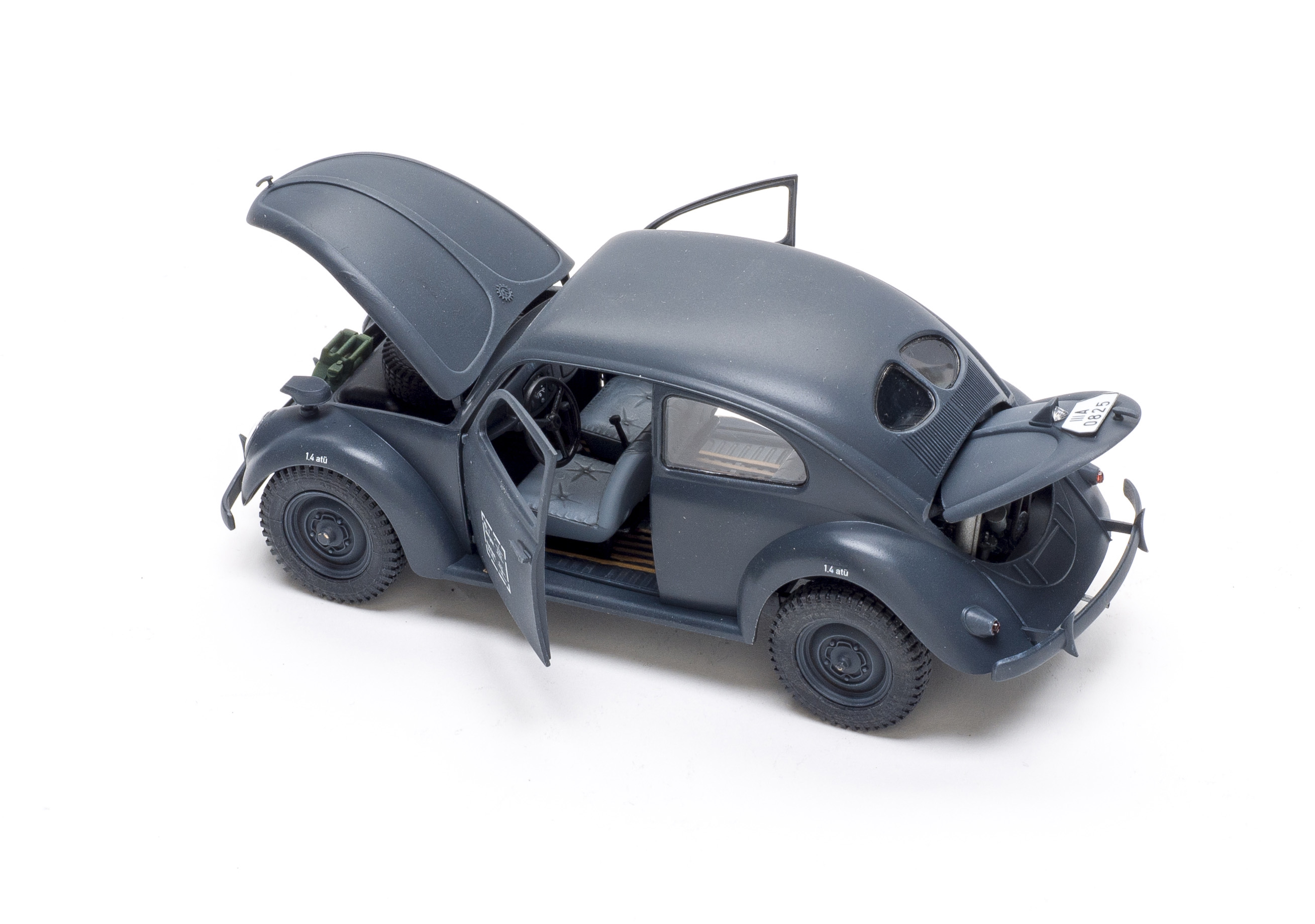

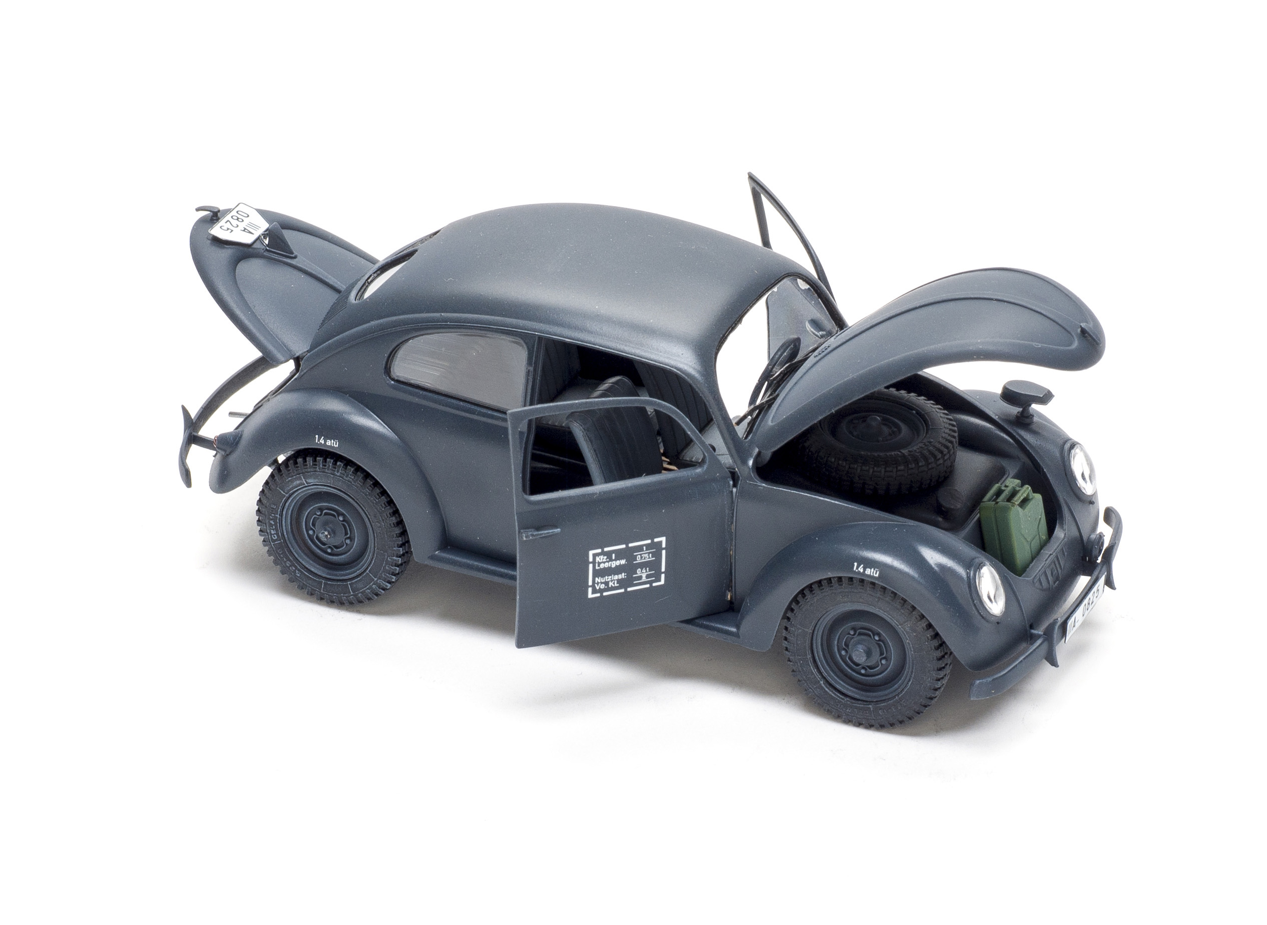

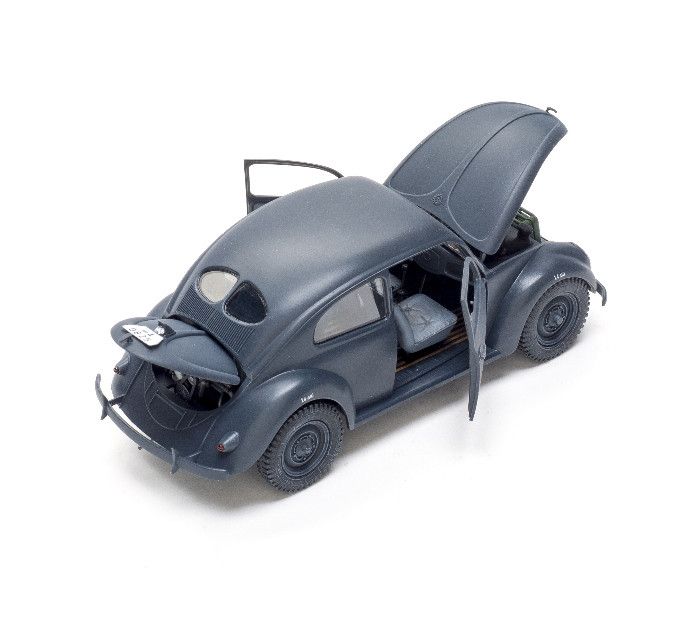

The trunk and hood can be posed open with optional hinges. The front trunk lid fit fine up, but the rear engine cover hinges were too long; I trimmed them for fit. There are no hinges for the driver and passenger doors, but they can be posed open with careful gluing on the door jams. Test fitting showed the doors, hood, and trunk fit fine closed. I appreciated that the kit has separate inner door panels, which makes painting easier. All of the door handles and wiper arms were separate.
The kit’s three options are a desert tan vehicle with balloon tires, dark yellow with dark green, and dark gray, which I went with. The only diagrams and color callouts are on the back of the box.
