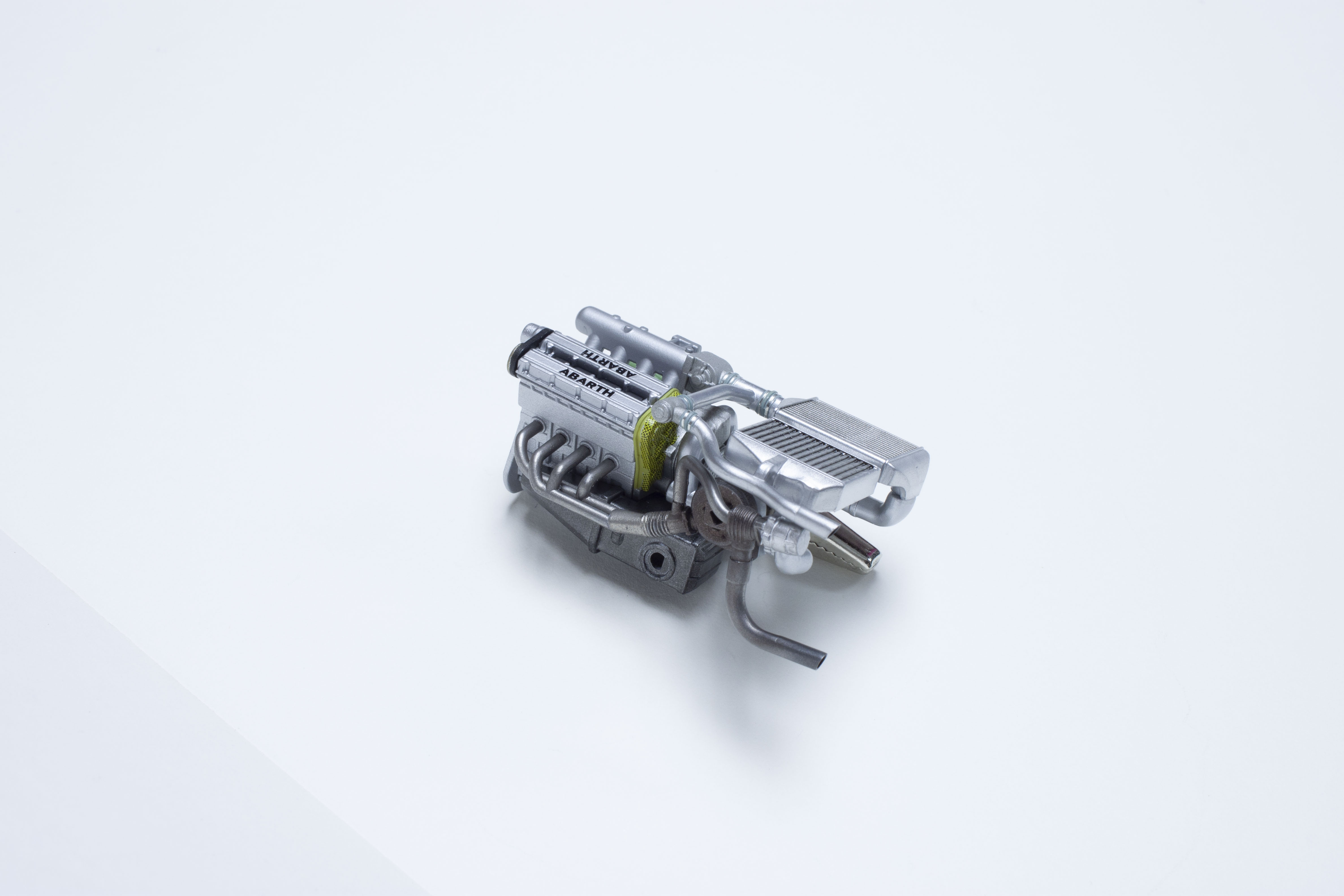

I used various Testors Metalizers, Alclad II, and acrylic paints to get different shades and textures to add visual interest to the engine and its components.

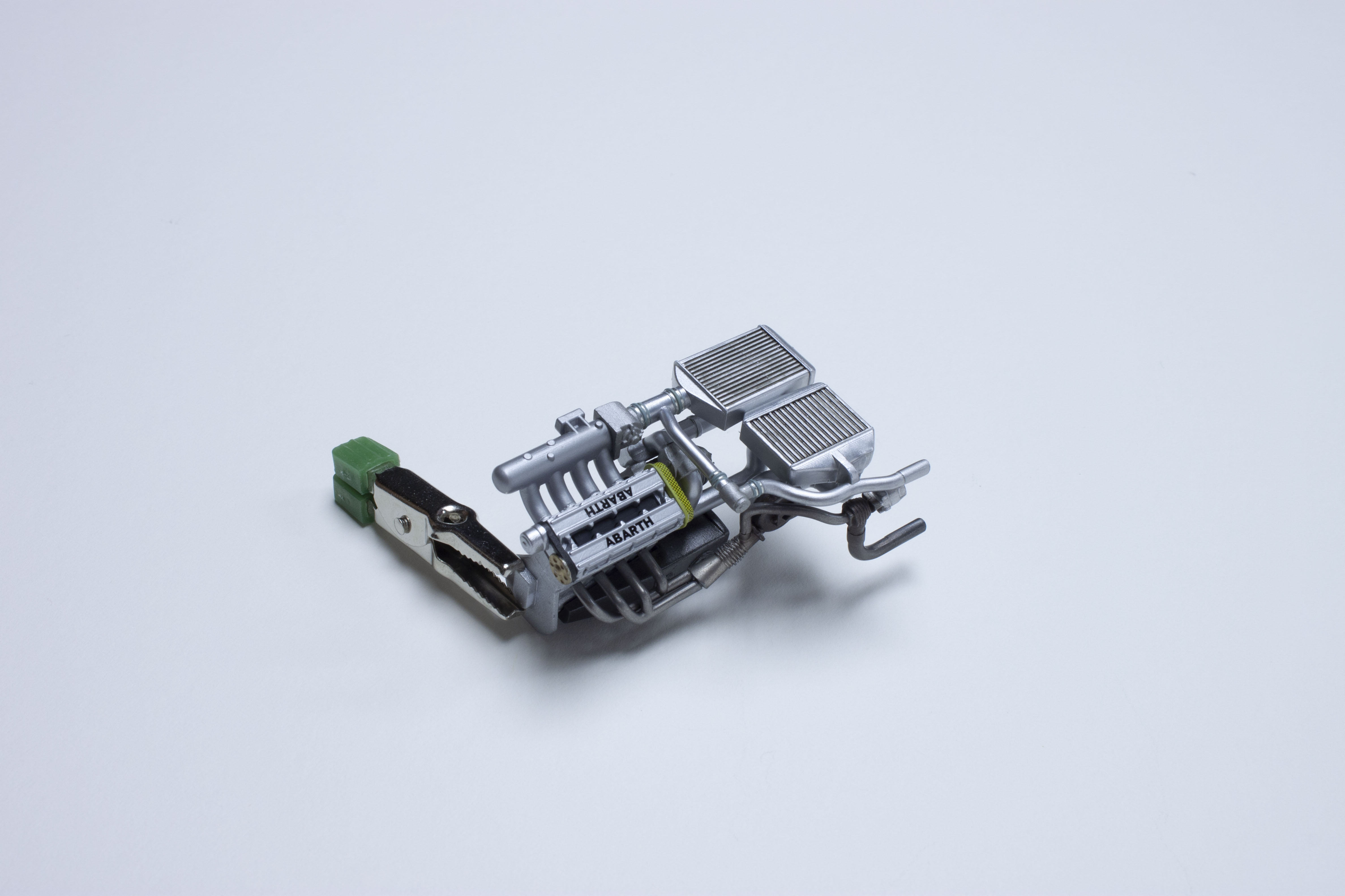

Careful alignment of the intercoolers and piping is necessary for proper fit. I built them as a sub-assembly and then attached it to the engine.

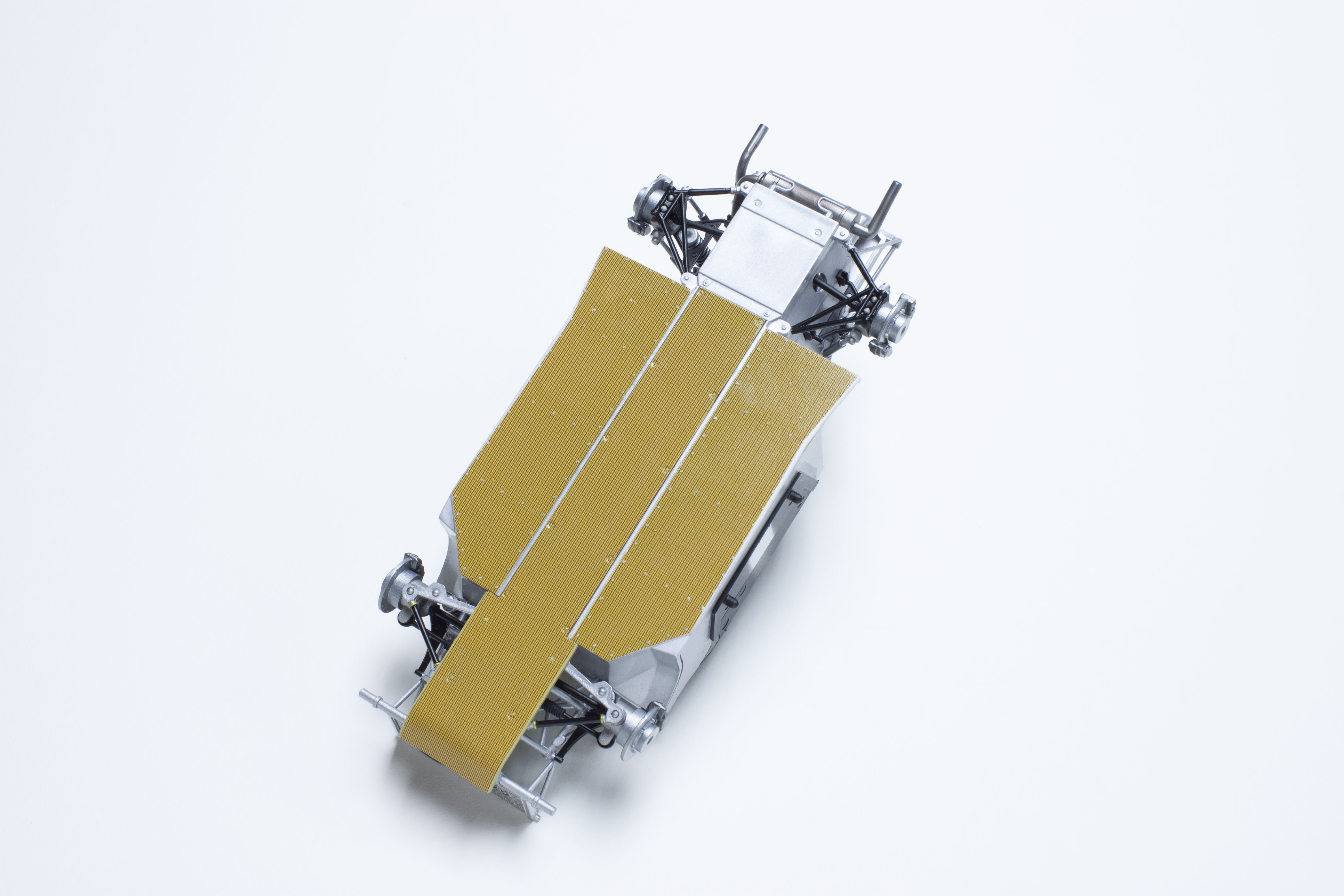

NuNu_Lancia_03
I made my own Kevlar decals from an old sheet from my spares box. I found a picture online of an aftermarket set and used that to make my templates.

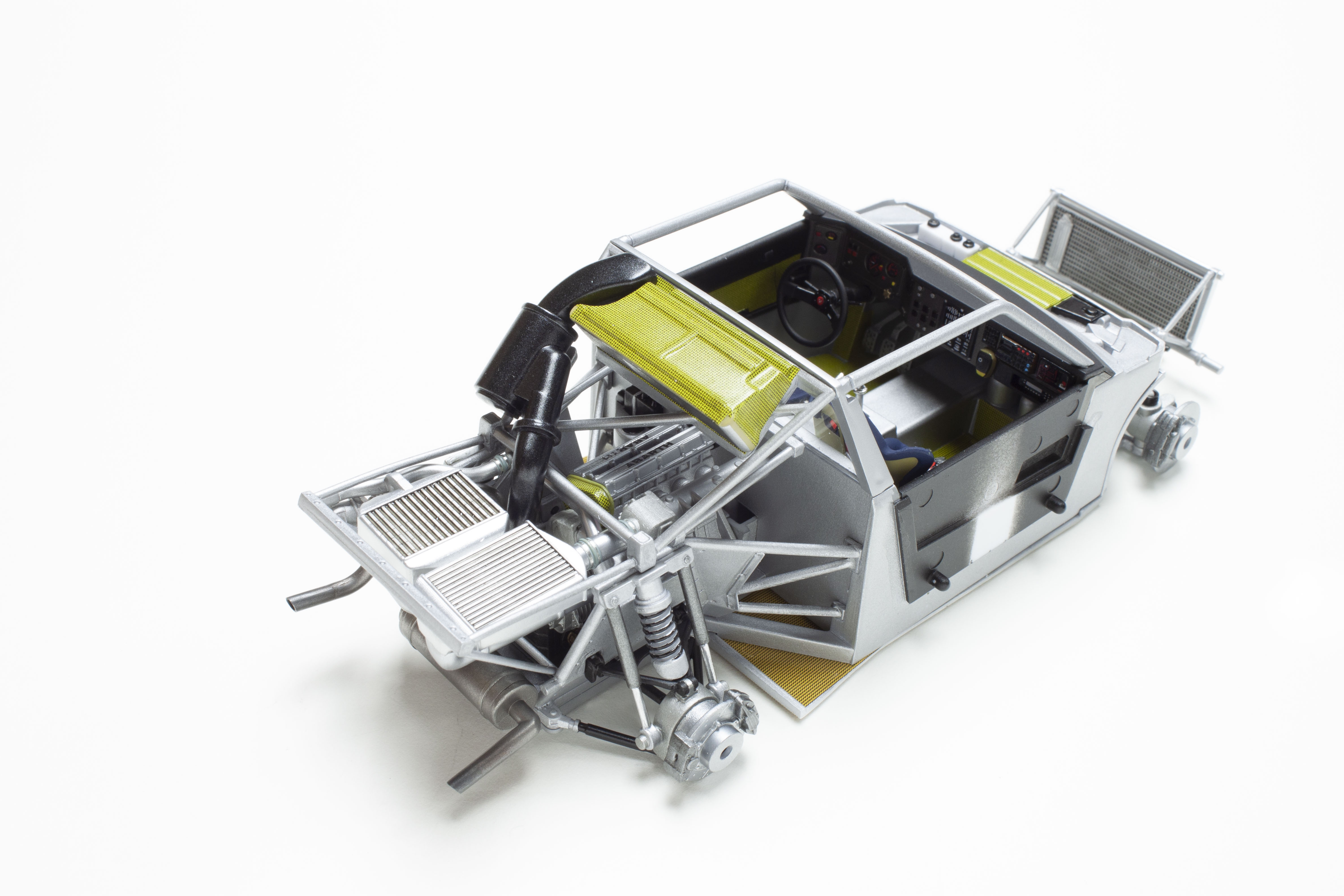

The completed rear chassis is ready for action! Some added plumbing and wires would really bring it to life.

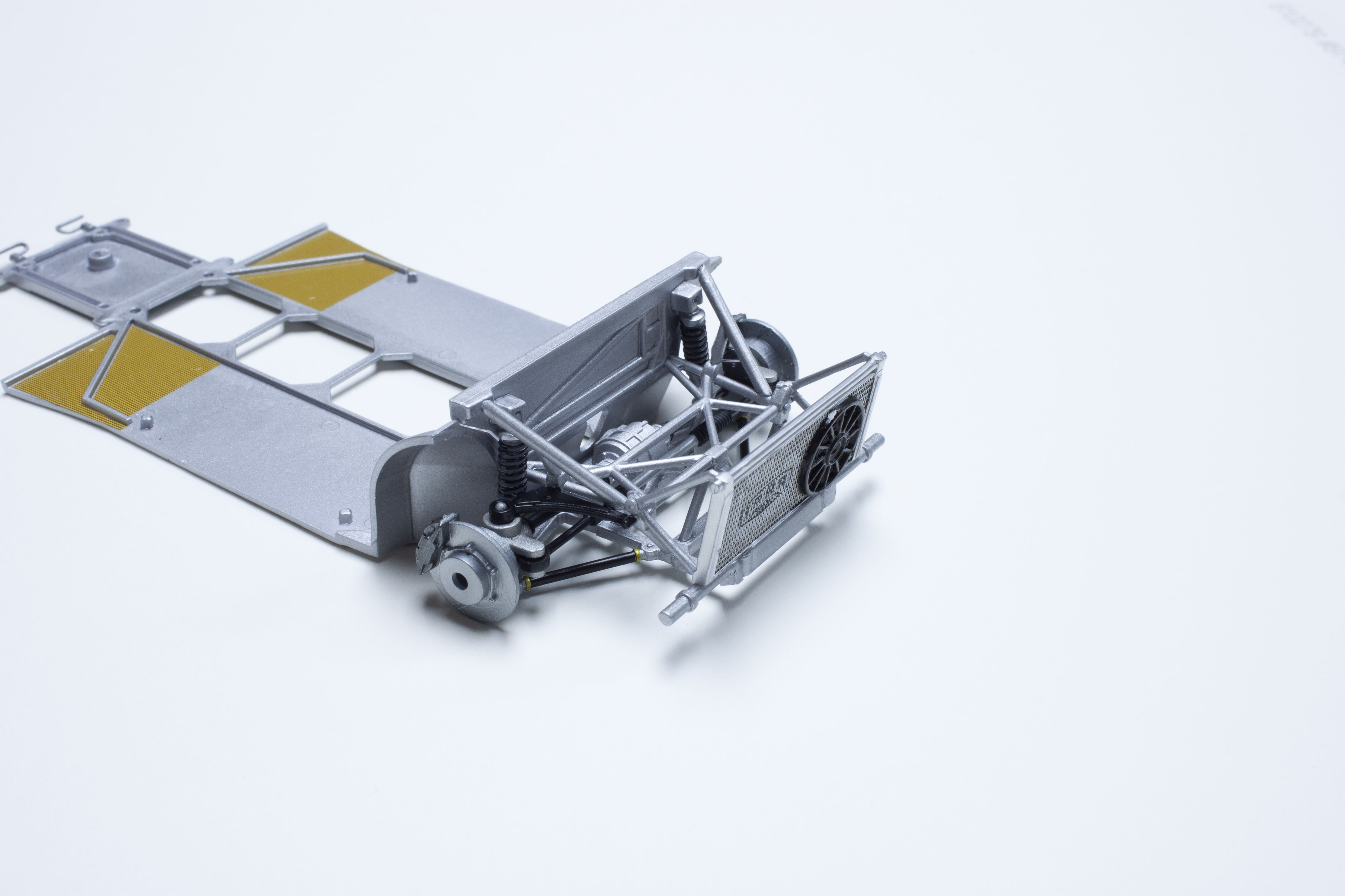

NuNu_Lancia_05
About all that’s missing from the front space frame are the radiator hoses. Be sure to test fit parts; I found some of the locator pins were too big for their mating holes.

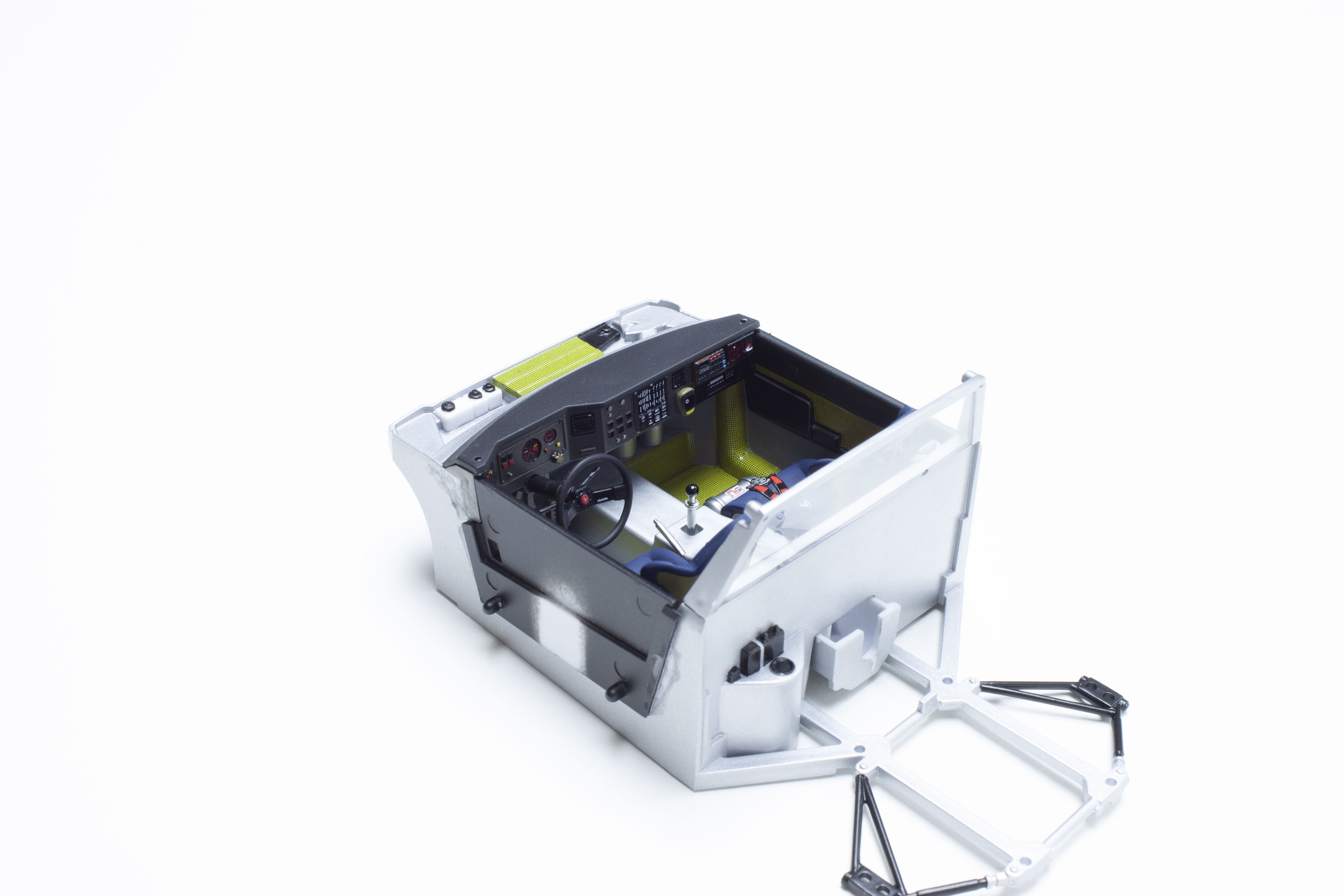

The gauges and rally instrument decals settled beautifully with a little Micro Sol.

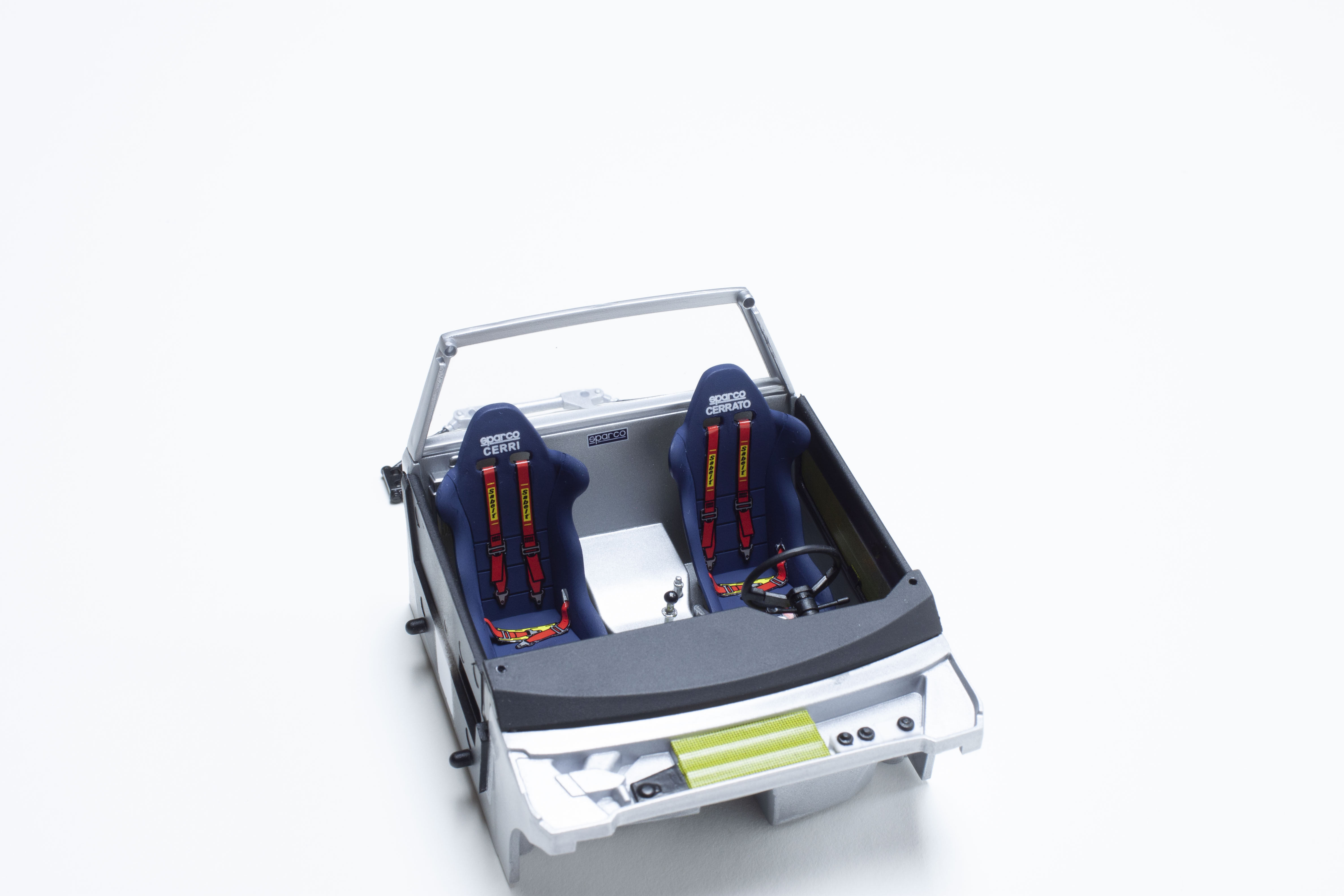

NuNu_Lancia_07
I’m not a big fan of decal seat belts because they sit too flat. I cut them out as close as I can and color the edges then attach them with white glue.  It gives them at least a little more dimension, and they drape more realistically.

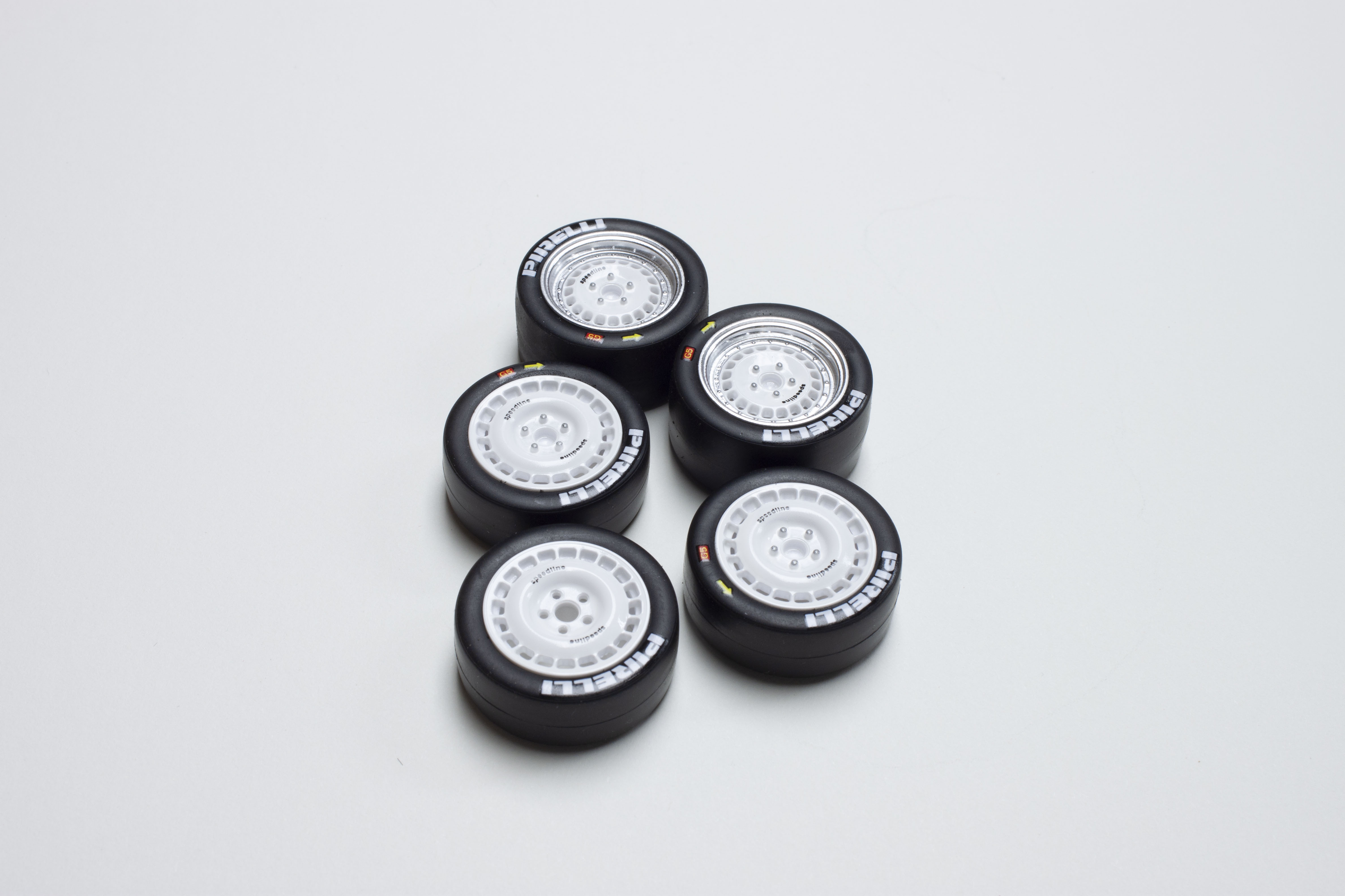

NuNu_Lancia_08
The chrome rim for the rear wheels is a separate part, so no masking needed! I would typically sand the tread area, but the tires were so soft and gummy it just made a mess. Instead, I left them as new “sticker” tires.

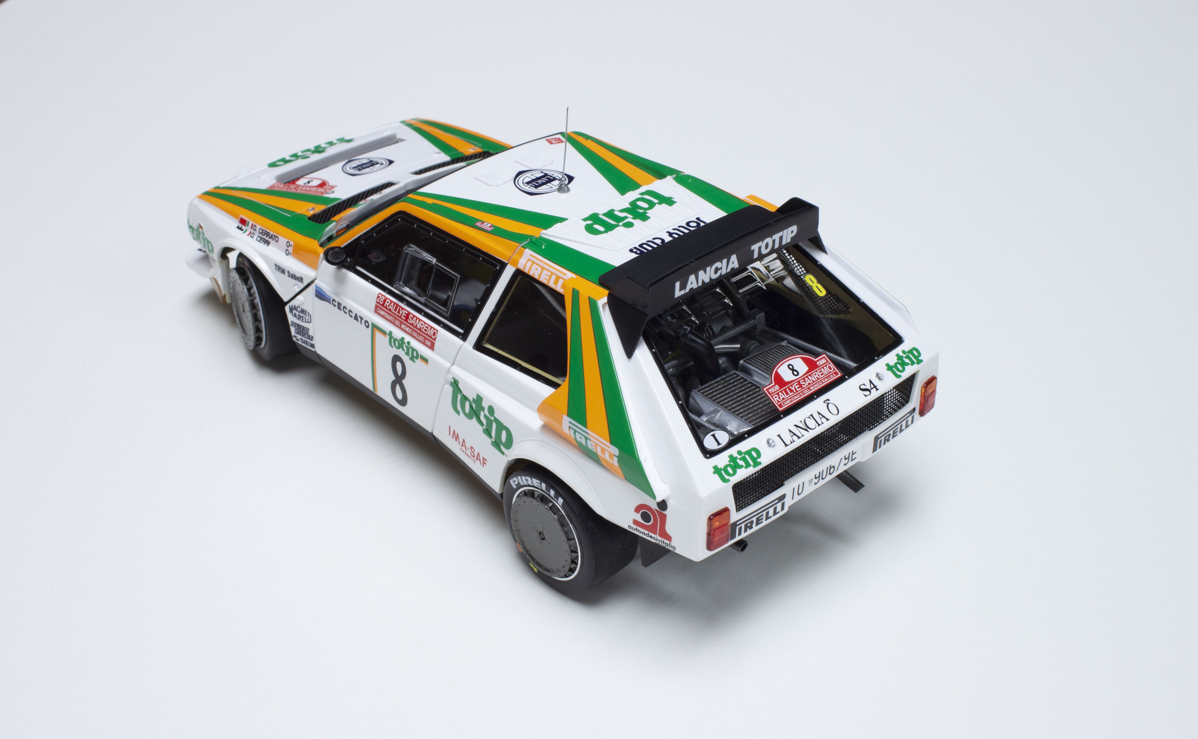

NuNu_Lancia_09

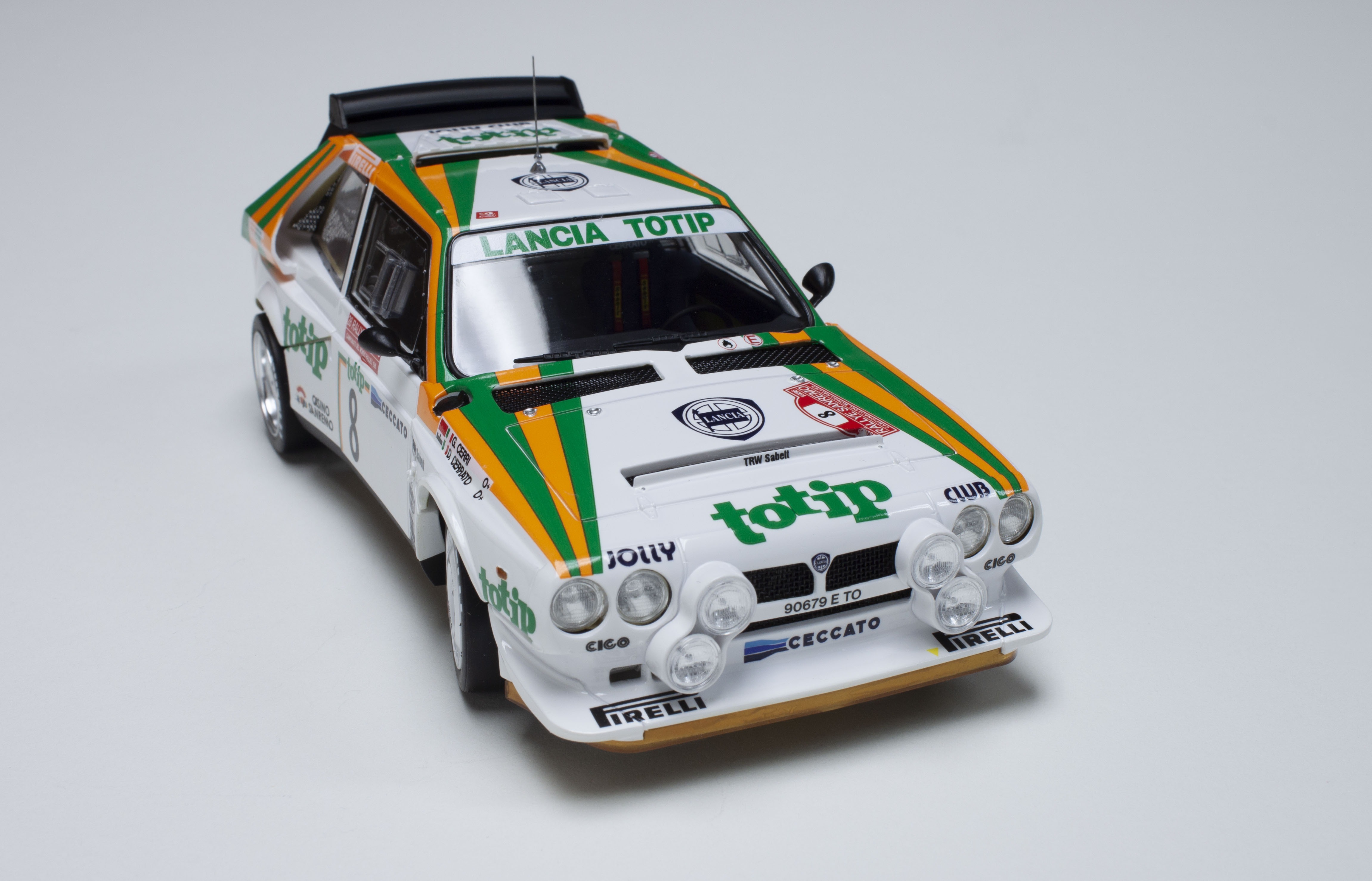

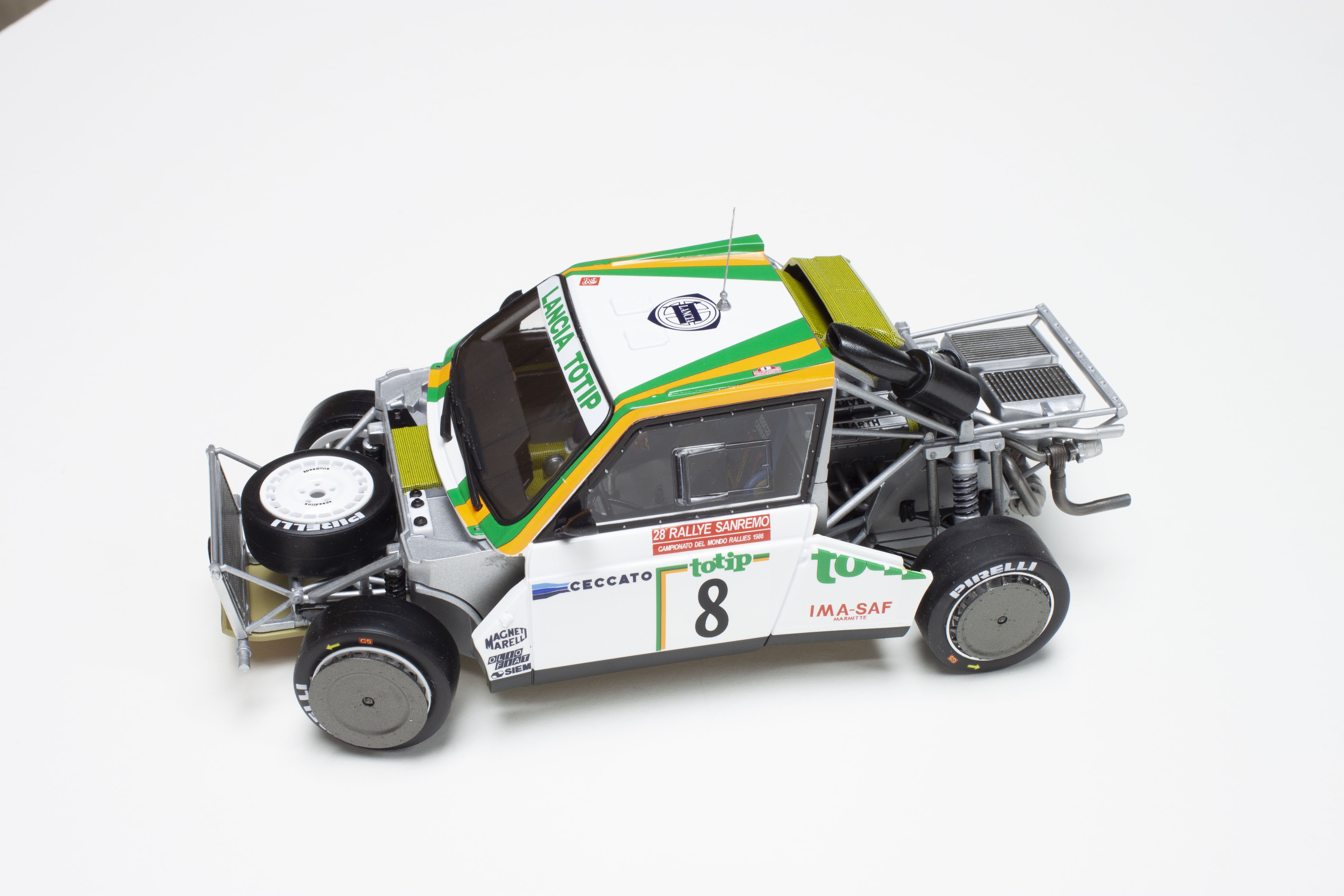

The body snapped onto the chassis without issue and revealed a near perfect fit. The colorful decals were an absolute joy to use; they fit perfectly and conformed easily over contours.

The instruction’s first three steps cover the construction of the turbocharged and supercharged engine and all the associated plumbing for the intercoolers. Assembling the engine itself is straight forward, but the only the pipes support the intercoolers. The parts fit fairly well, but the play in the joints make careful alignment critical. I used various metallic colors to get slightly varying shades and textures to help add some visual interest.  Pipe couplings were picked out in light blue; thin strips of Bare-Metal Foil make convincing clamps.
The tubular space-frame chassis and front and rear suspensions look good with plenty of detail. For ease, I gathered all the components and sprayed them Tamiya gloss aluminum (TS-17). Kevlar panels cover the bottom of the chassis; if you buy the optional detail-up set, you get templated decals for the task. I made my own using a picture I found on the internet as a pattern. NuNu provided a clear panel to cover the transmission tunnel, but there really isn’t much to see, so I covered it, too.
As always, it’s a good idea to test fit everything. I found several spots where the locator pin was larger than the mating hole or slot, but they weren’t difficult to fix.
Decals are provided for the instruments and rally gear for the dash and with a little Micro Sol settle into the details beautifully. There are several Kevlar panels in the interior that I made decals for too.  I’m not a big fan of decals for seat belts, they’re just too two-dimensional.  I cut them out as close to the image as possible, color the edges with a Sharpie to hide the “white” and then use white glue to attach them.  It gives the belts at least a little more thickness and they drape more realistically.  When attaching the door panels, be sure they sit all the way down flush at the bottom edge as this will determine how the body shell fits to the chassis.
The body shell is broken down into three main components: the front clip, main cabin, and rear clip.  The front needs a little sanding to remove seam lines around the headlight area; otherwise, cleanup was minimal. Finished with the prep work, I sprayed on a couple coats of Tamiya pure white (TS-26) and  waited a few days before  placing decals. I don’t know who prints NuNu’s decals, but they are absolutely fabulous! Colors are vivid and cover well with crisp printing and perfect fits. When necessary, the decals responded well to Micro Sol and conformed to every bump, dip, and compound shape. NuNu even provides decals for the black window trim.
The transparent parts are thin and crystal clear. The borders have a ridge molded in to aid painting if you decide not to use the decals. When installing the lights, be sure to check that the two styles of lenses are properly placed.
The kit includes fine mesh for the grilles with templates printed in the instructions. The photo-etched metal parts from the detail up set may look a little more finished when viewing from the inside, but the supplied mesh looks fine. The kit’s molded antenna is a bit too thick, so I cut it off, drilled out the base, and replaced it with a piece of wire.
