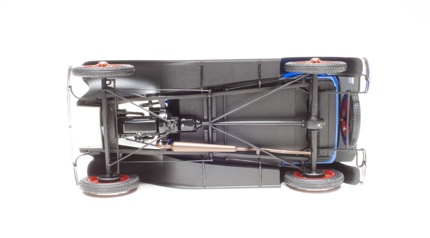

The frame comes in multiple parts, so be sure to work on a flat surface and have a square to help make sure everything stays, well, square. I found the parts fit to be excellent, but some of the locator pins are tiny and don’t offer much support.
Every single component of the suspension is accurately reproduced. In some cases, the sprue gates were nearly as large as the part itself. Be careful, because some of the parts are extremely delicate. I ended up replacing the brake rods (parts D2, D3, and D17) with pieces of wire because I snapped the first one while trying to clean up the gate stubs. Some of the parts are keyed with a square locating pin, but because they’re so small, it’s sometimes hard to tell if you have it positioned correctly. Use a glue that gives you some working time in case some adjustment is needed.

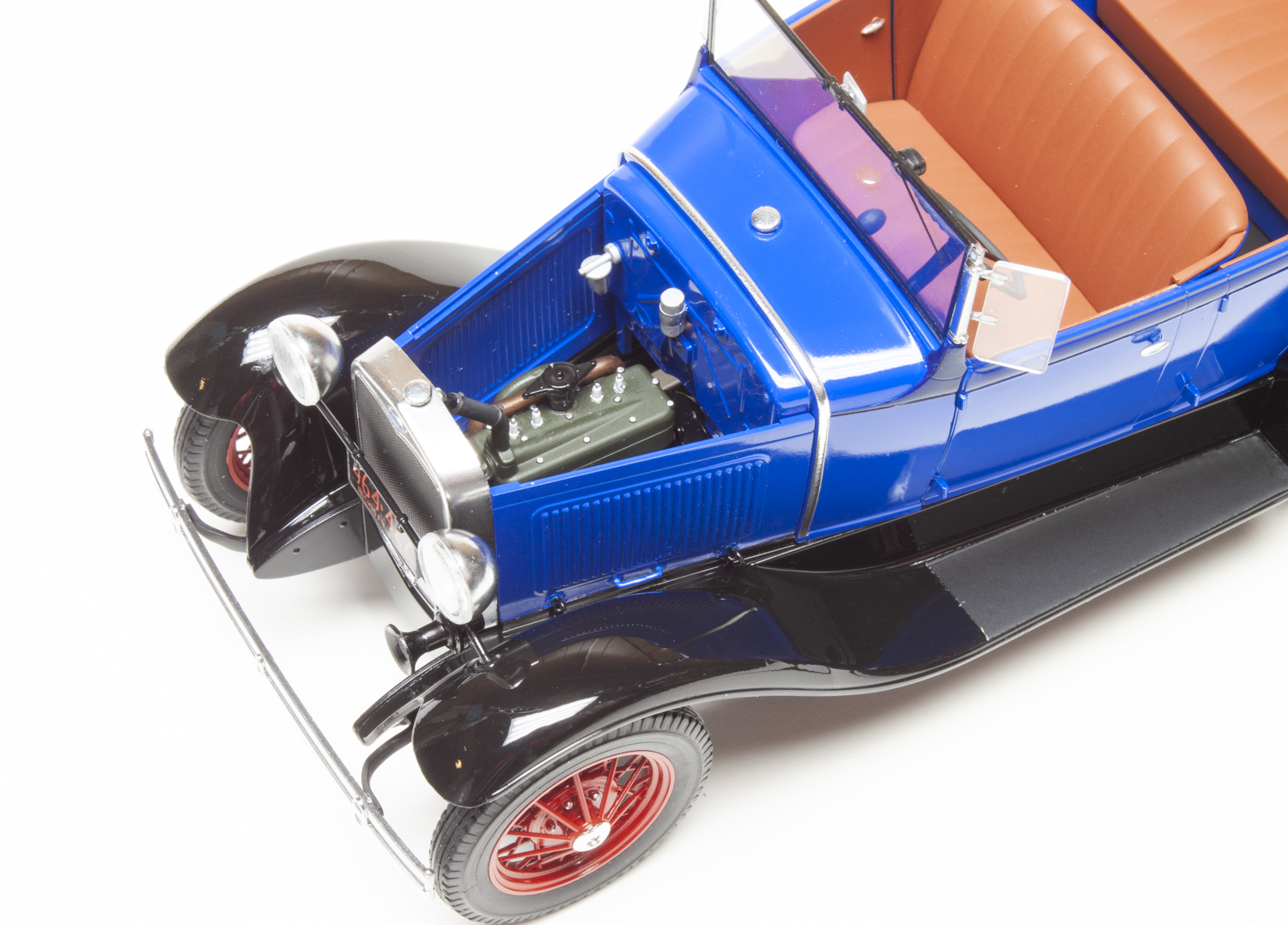

The four-cylinder engine is faithfully reproduced, right down to the individual 1/24 scale spark plugs! The engine itself is pretty simple, but so is the real thing. I suggest you leave the upper radiator hose off until the engine and radiator are mounted to ensure they mate properly.

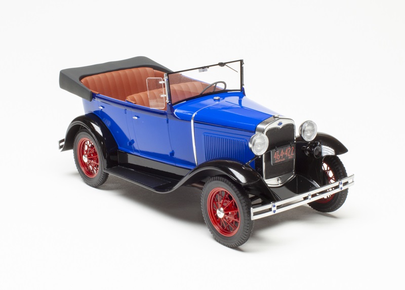

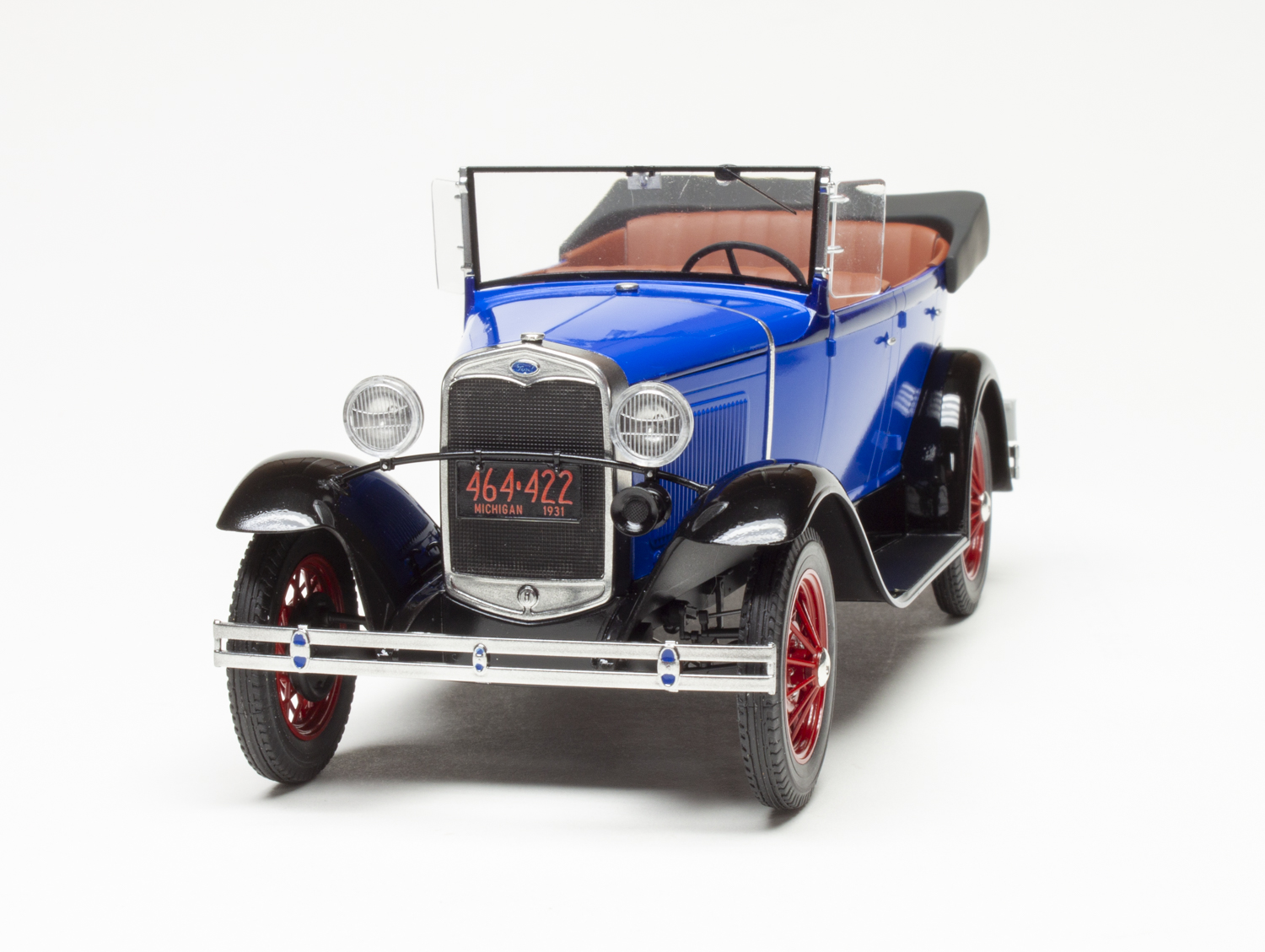

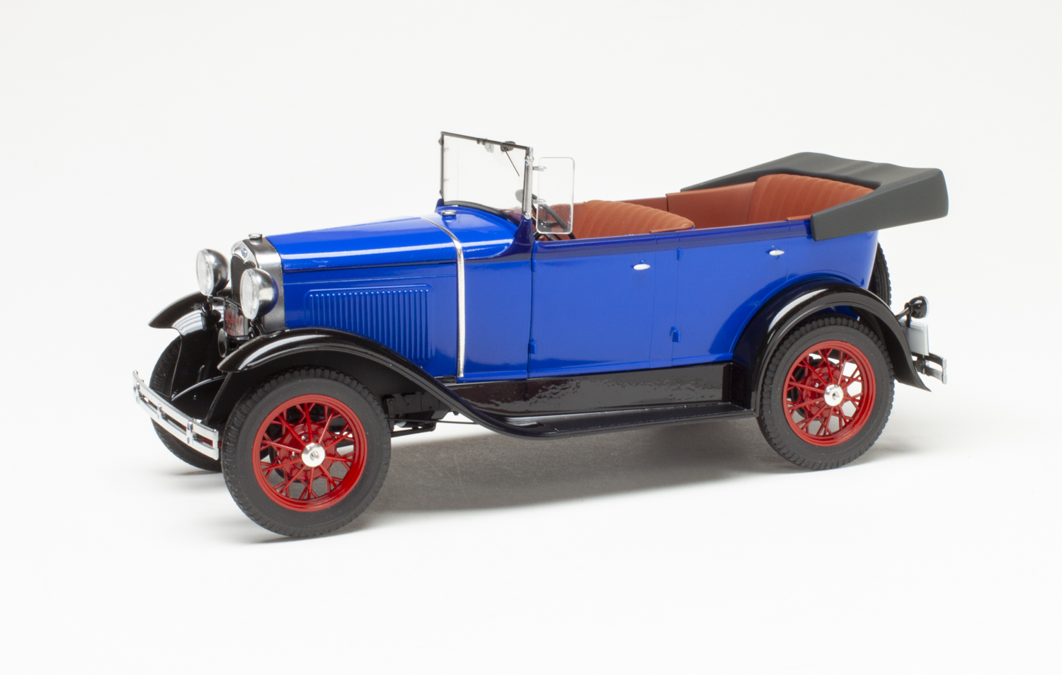

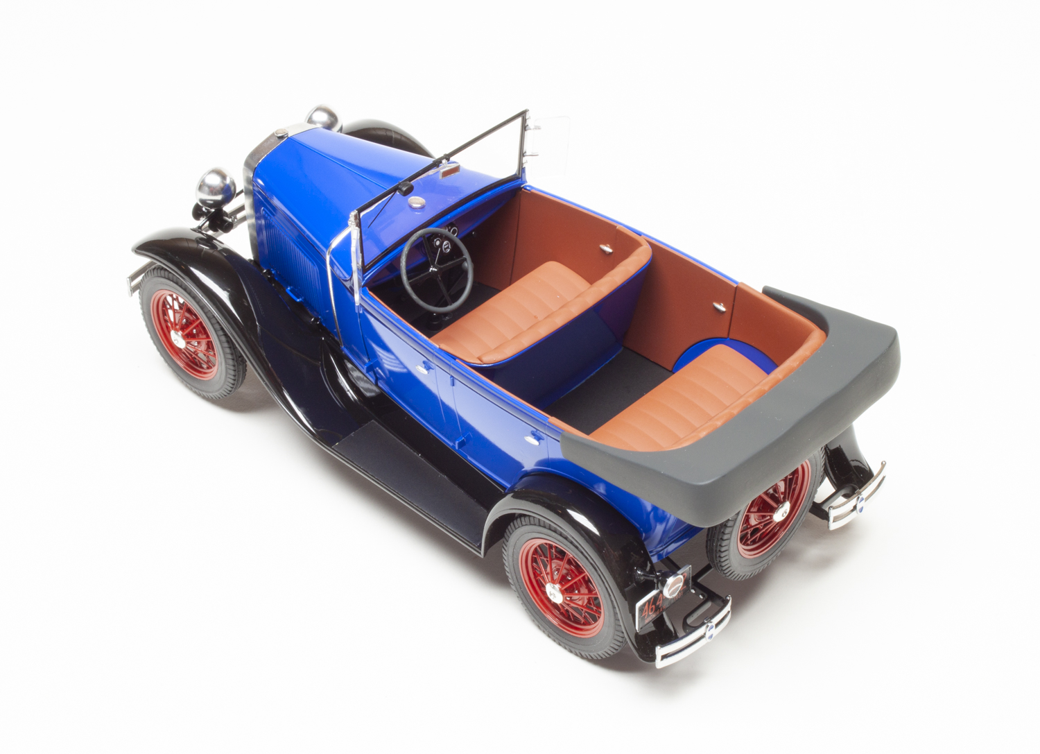

I liked the blue body/red wheels combination best of the three depicted in the instructions, but switched it up slightly. I used Mr. Color Thunderbirds Red (No. C327) and then used a sharpened piece of brass tubing to cut out discs of Bare-Metal Foil for the hub centers.

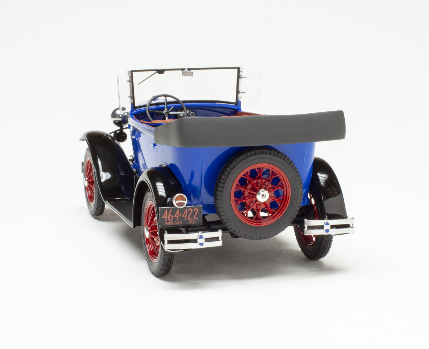

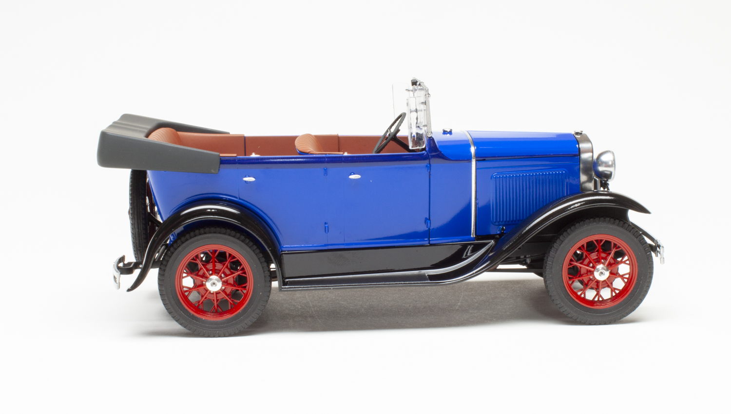

Next, I assembled as many parts of the body as I could prior to painting, using the floor/fender assembly as a jig. The fit was good, and assembly went smoothly. Tamiya Pure Blue (No. LP-6) was used for the main body color with Tamiya Royal Blue (No. X-3) for the trim band. I deviated from the instructions slightly by gluing the body to the floor before adding the interior panels, eliminating the chance of marring them.

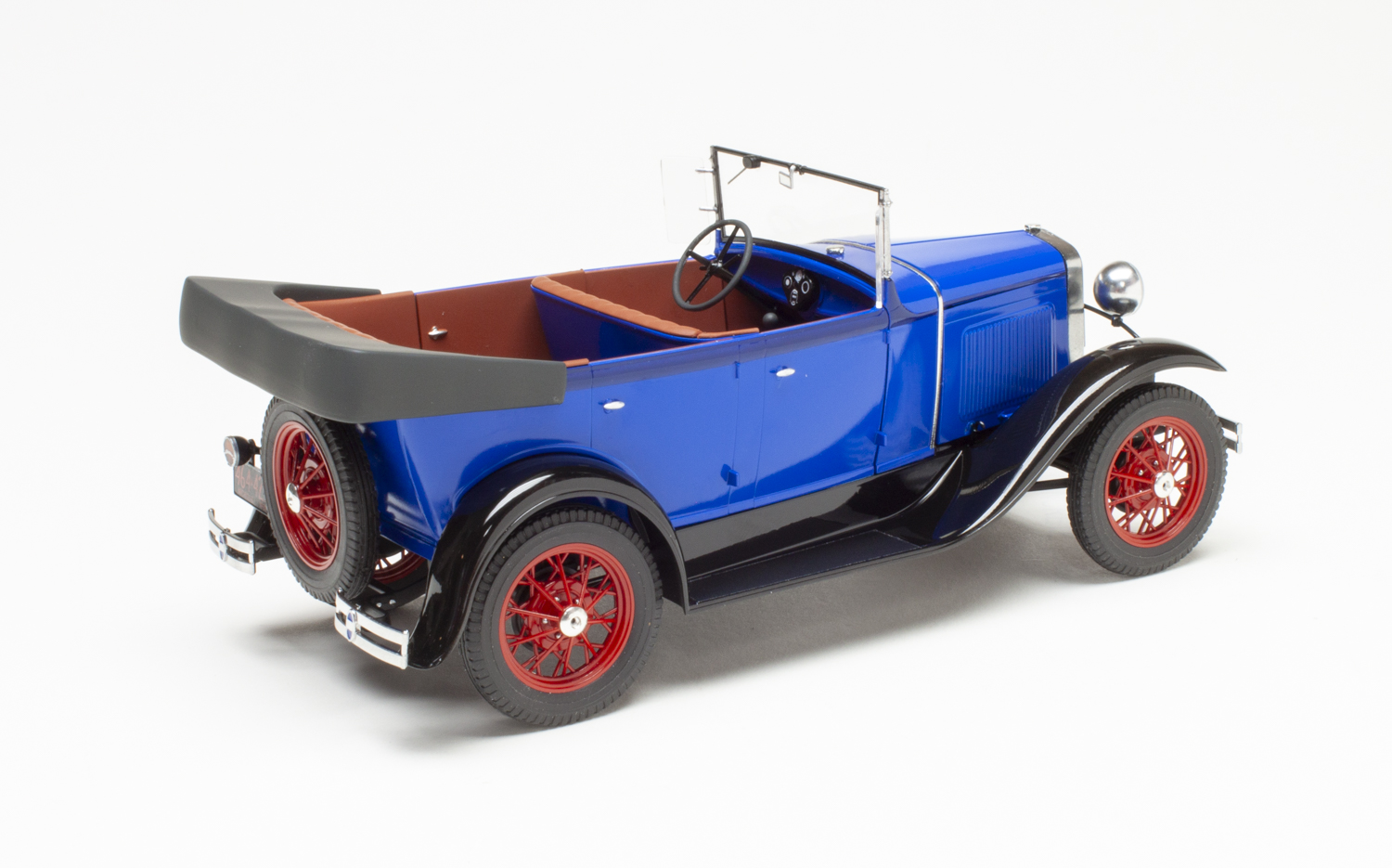

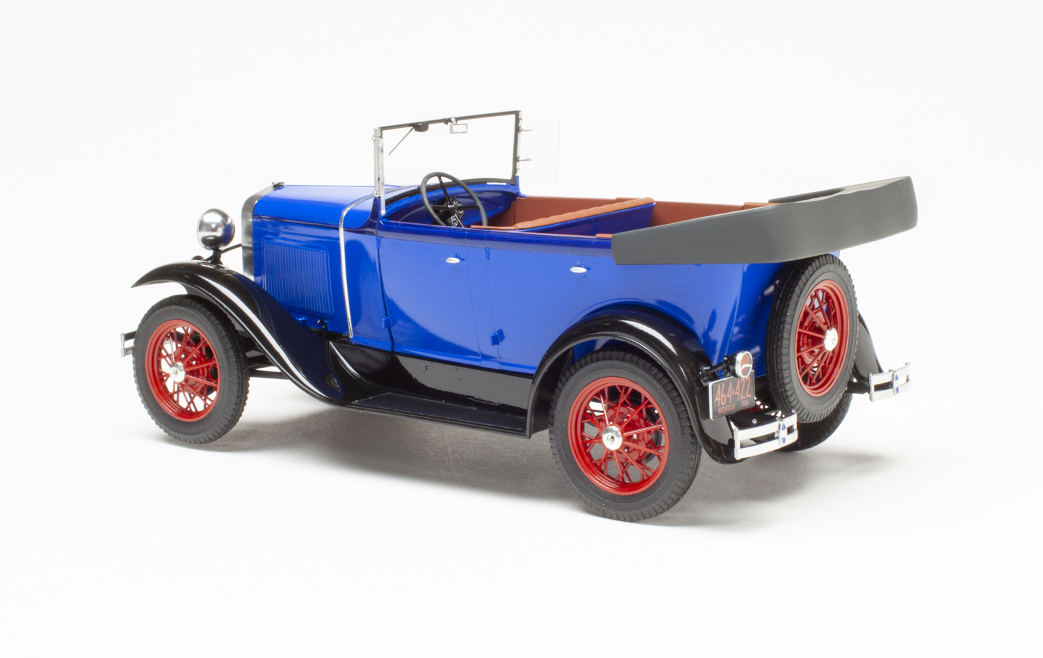

The interior panels and seats were painted Cobra Motor Paints Reddish Leather (No. A.Mig-0318). I had a little trouble getting the rear seat back down flush to the body. My guess is that I probably didn’t get the bottom cushion snapped all the way down.
You will need to mask the windshield to paint the frame. Templates are provided in the instructions, but it’s easy to just tape it off. The wiper blade is molded into the windshield, too. With everything else being separate, this choice didn’t make sense to me; it should be an individual part.
