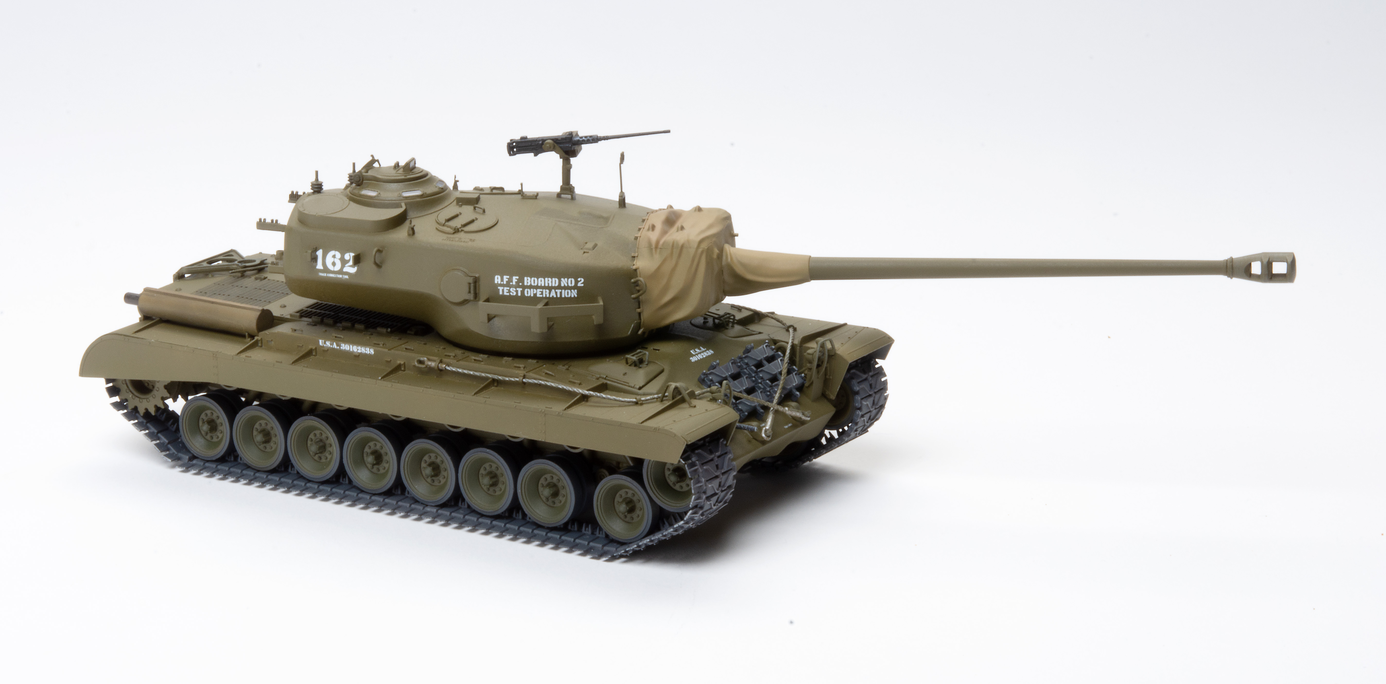

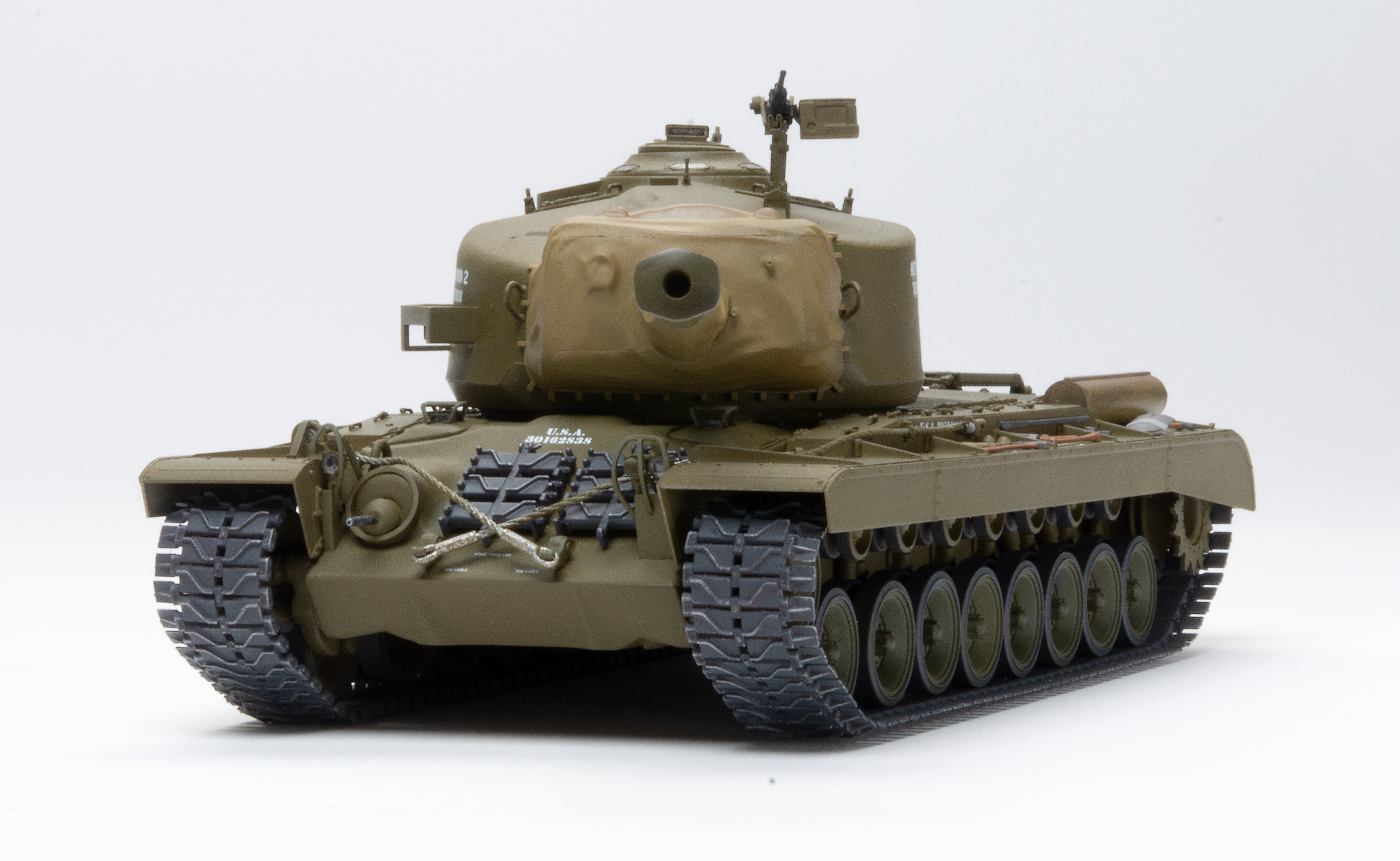

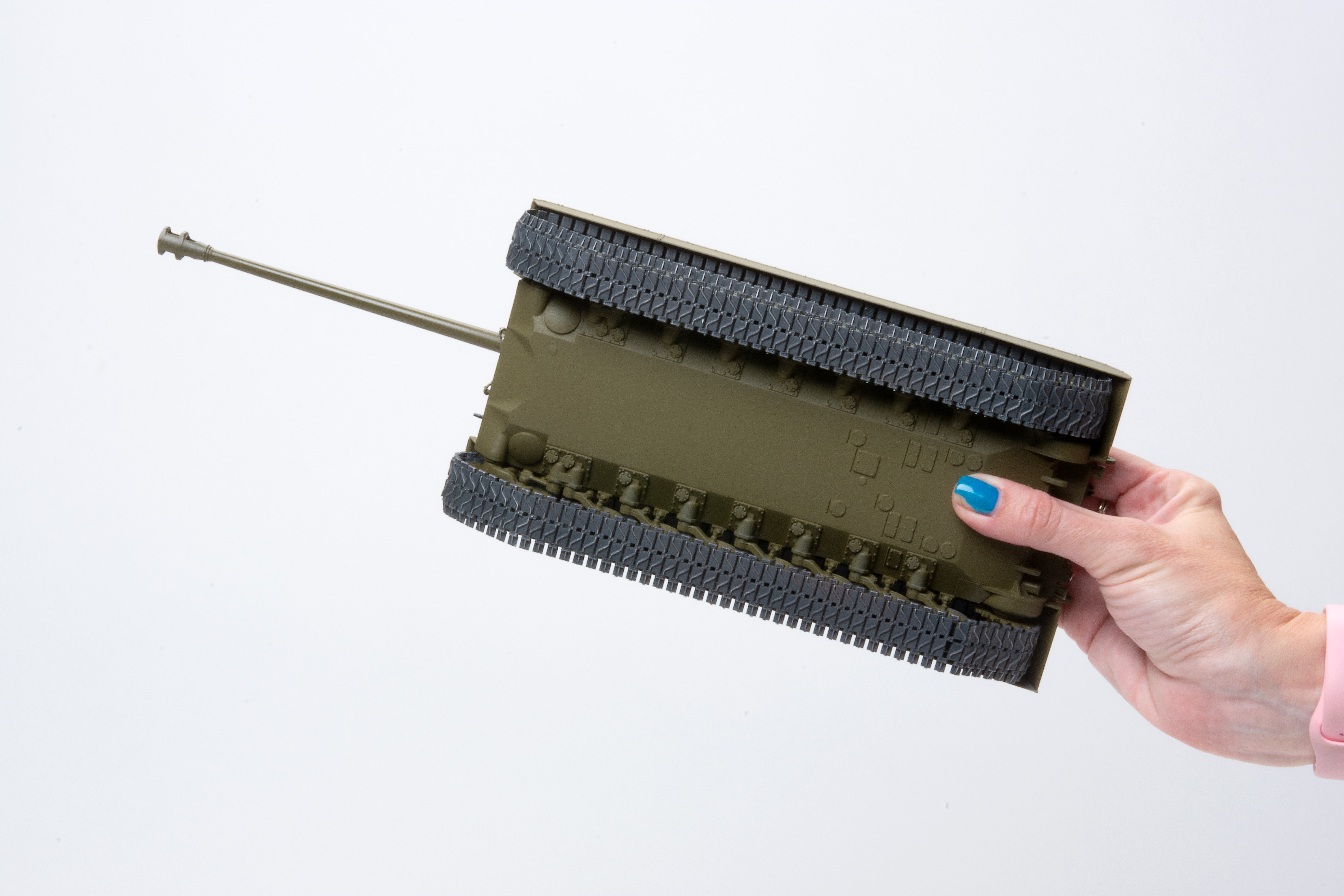

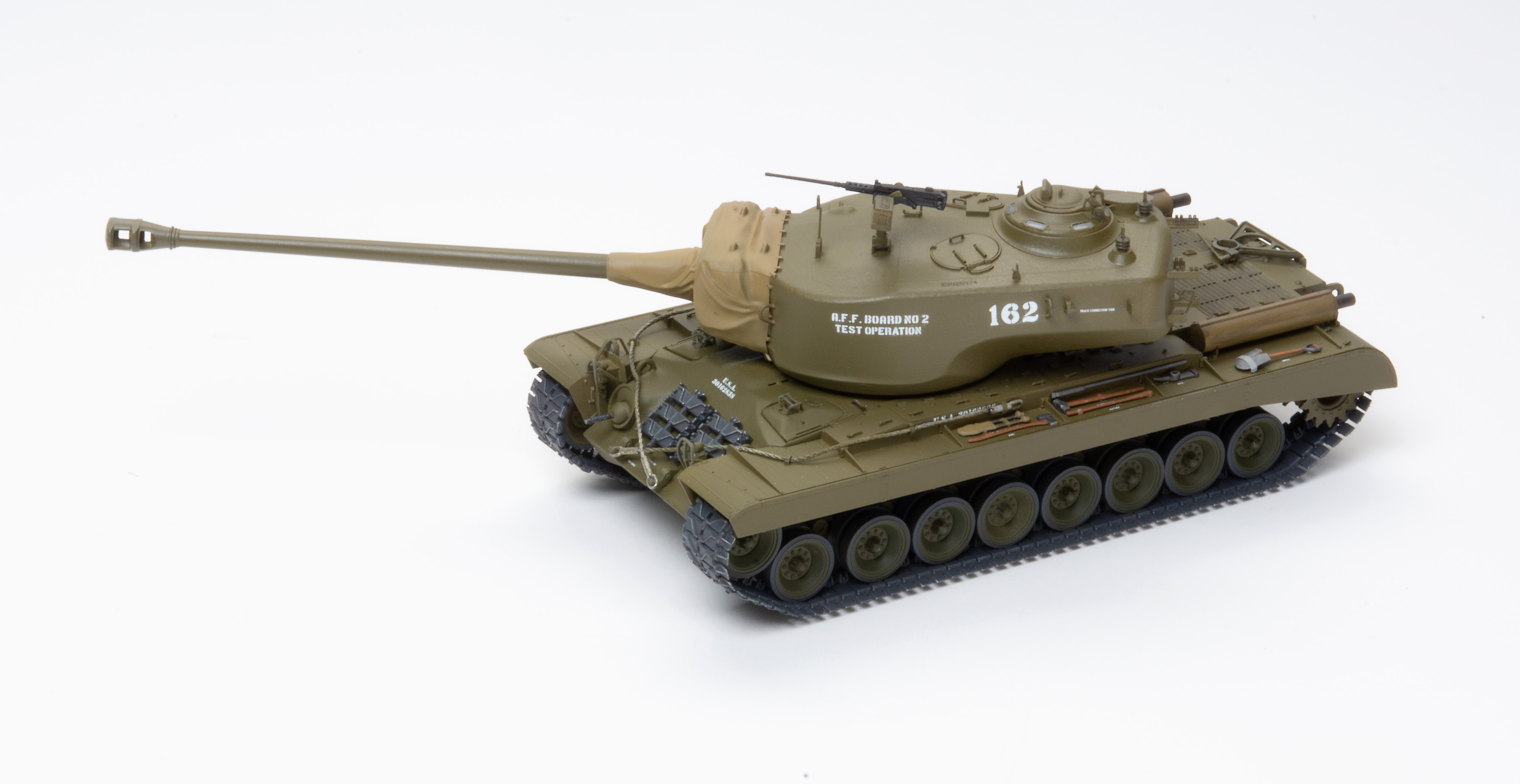

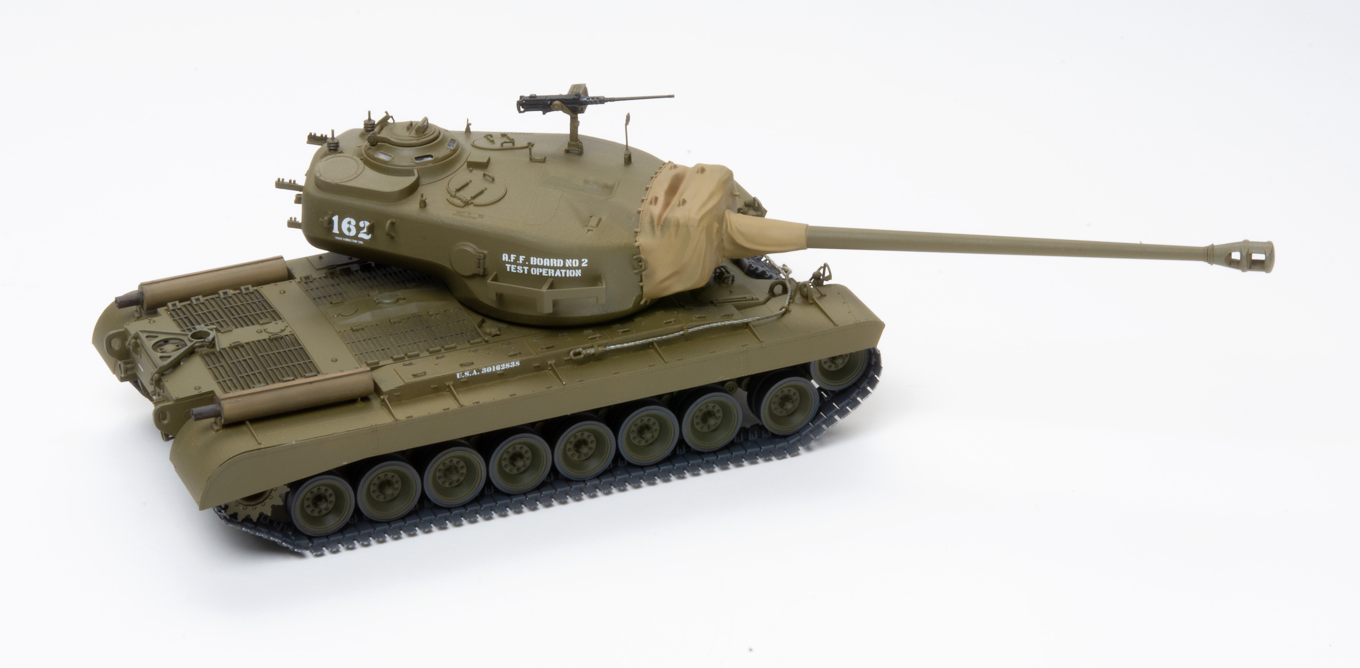

Many of the 407 parts go into the suspension, and I spent a good deal of time masking and painting the 32 wheels and assembling the link-and-length tracks. After painting the lower hull, I attached the wheels to use as jig to build the tracks. I carefully glued the links together but not to the wheels. I left the final join loose so I could slip the track onto the model after painting.
You get a choice of posing the periscopes up or down; I chose the former. I masked the periscopes, cupola vision blocks, and headlights with a mix of equal parts white glue and water.

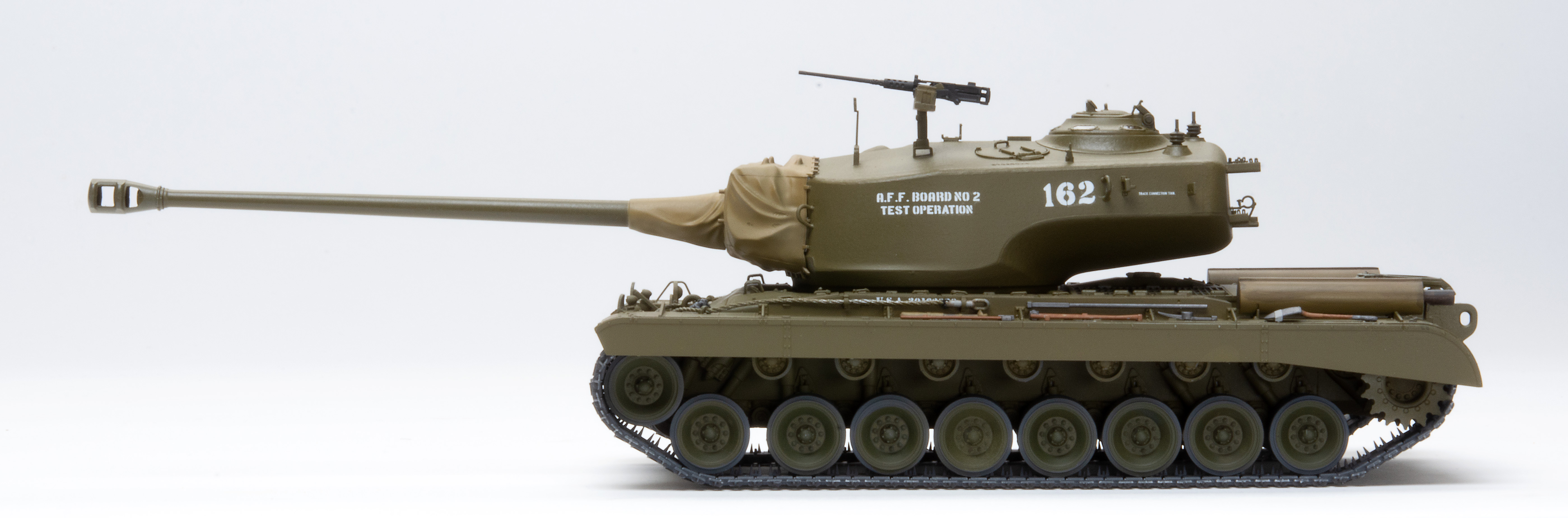

The kit also offers optional 105mm main guns and mantlets either with or without the canvas mantlet cover. I used the canvas cover option, painting it Tamiya Khaki. I left the fender skirts separate and painted the tank with Testors Model Master Olive Drab. The decals were opaque and went on nicely over a little clear gloss.
Takom’s T29 was a trouble-free build and looks impressive when done. I spent 35 hours on mine and can easily recommend it to anyone with one or two armor models under their belt.
