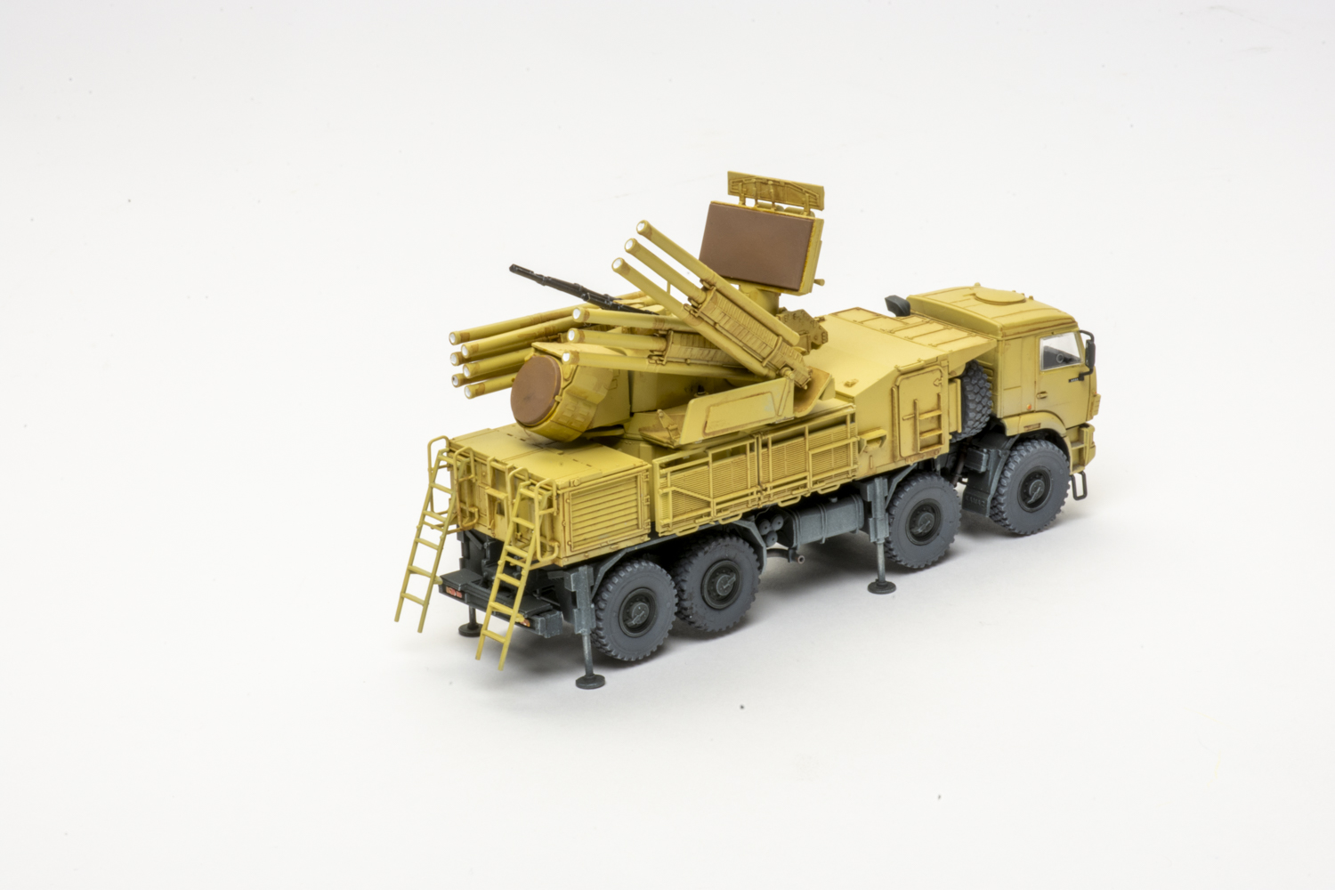

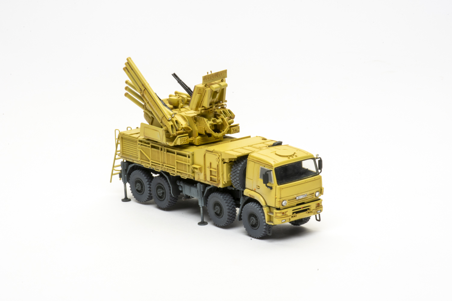

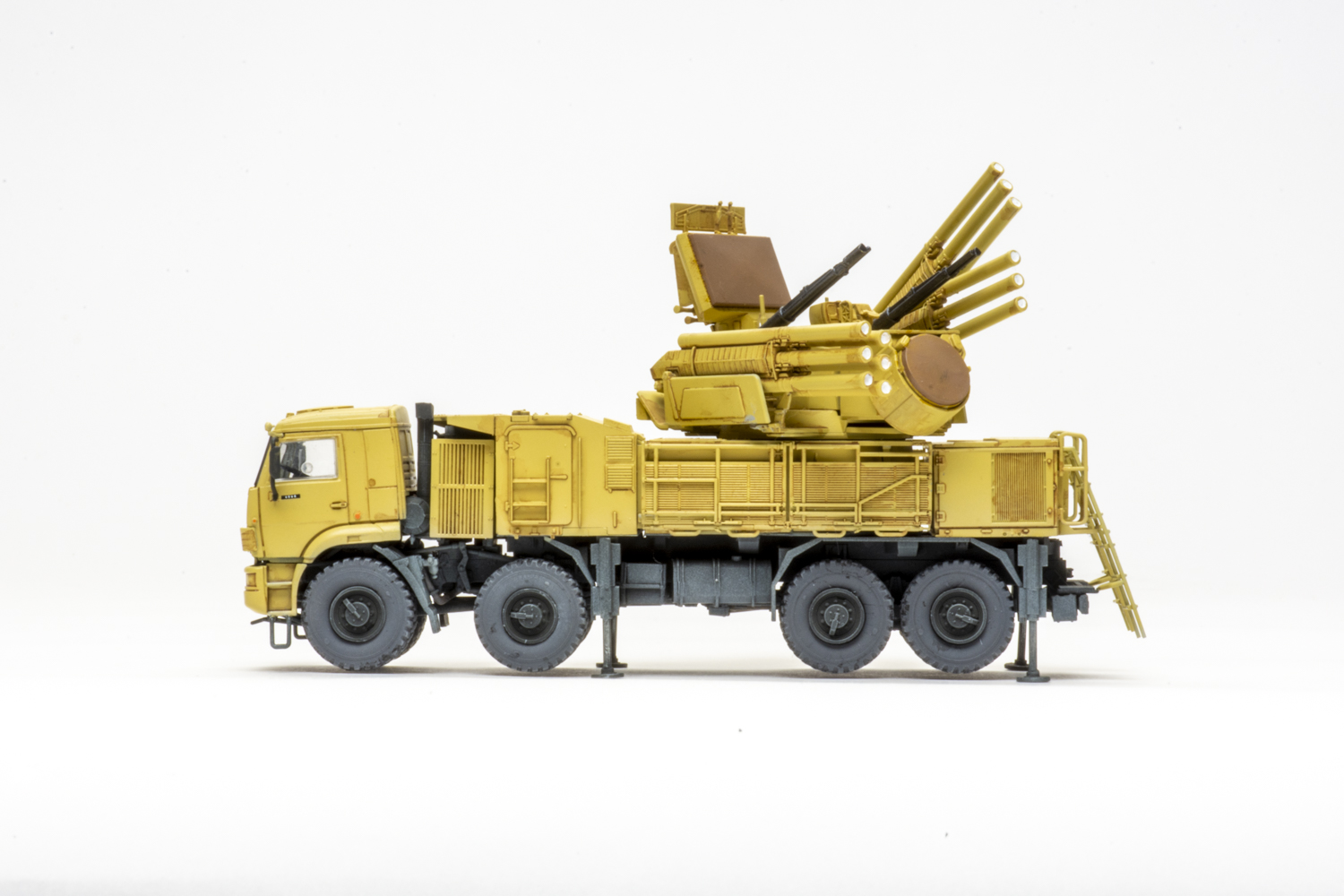

The cab features all of the basic interior detail. Decals provide instrument panel details. Sadly, the kit lacks windshield wipers. I left off the clear parts and the small exterior details until the final assembly and moved on to the chassis.

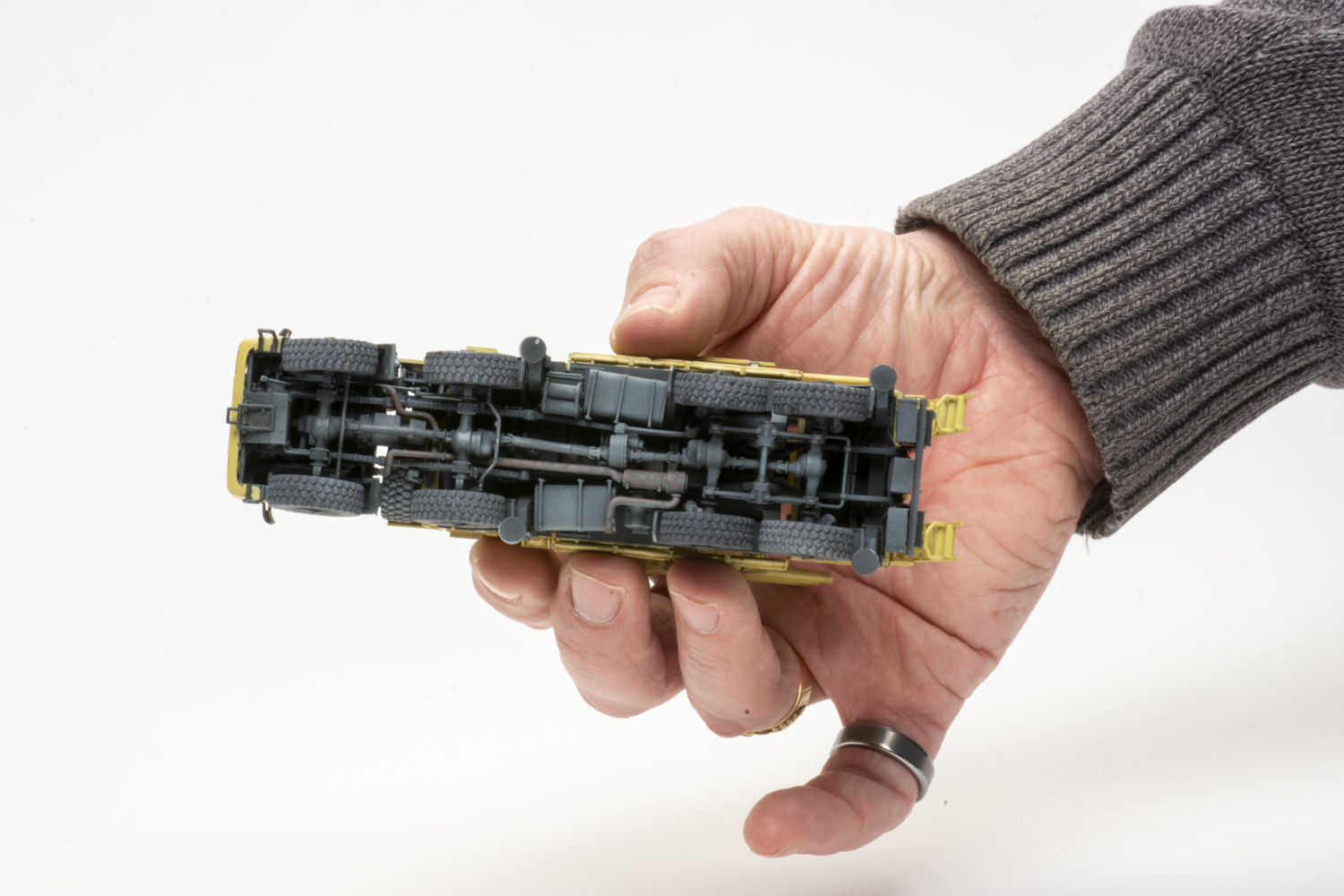

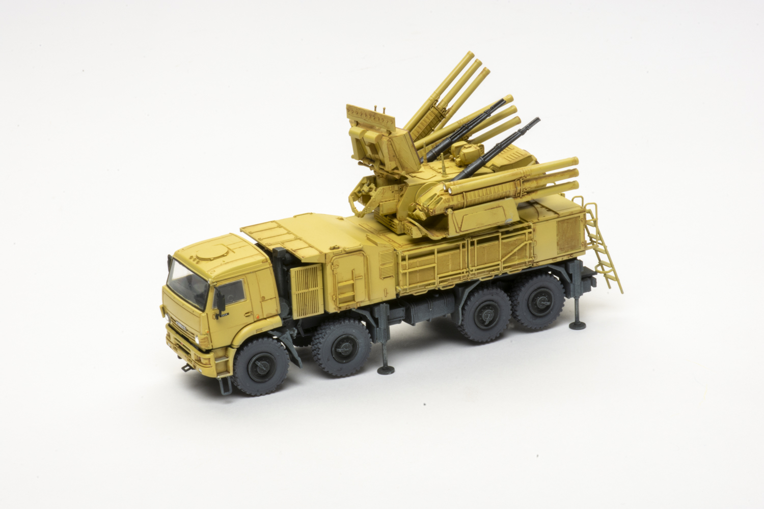

However, the kit includes a basic engine that is more than adequate because only the bottom can be seen. The parts-fit is excellent overall, and I decided to build my vehicle in the deployed position with extended jack stands. I left off the tires and the front axle assembly until everything was painted.

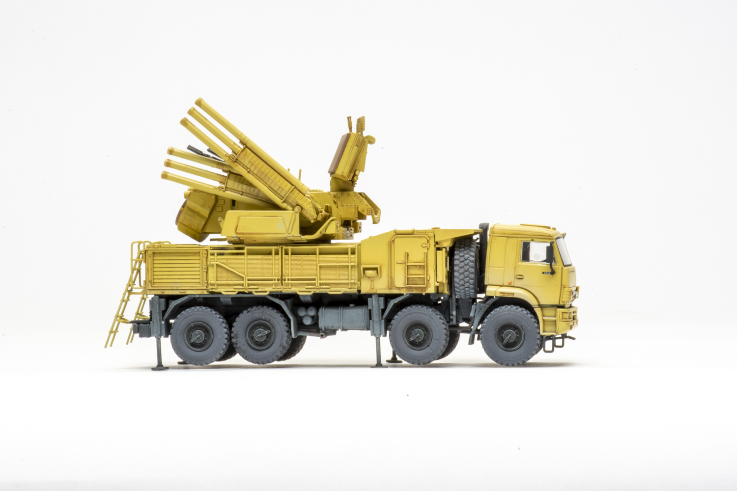

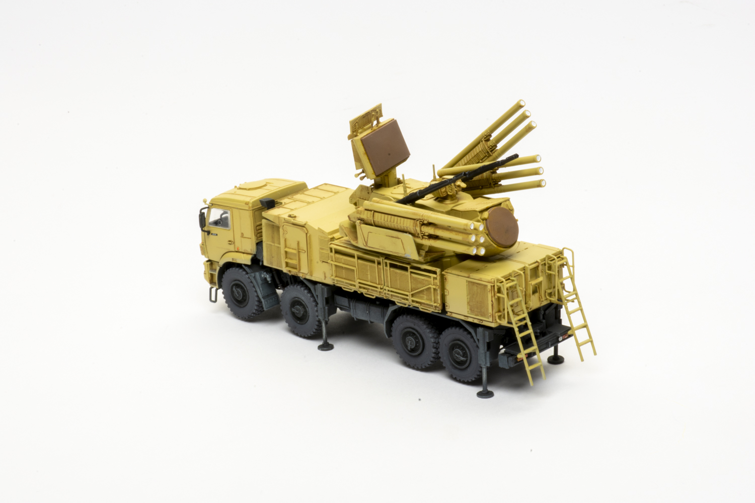

I assembled the main boxes of the Pantsir and left them removable to make painting easier. The turret is perhaps the most difficult section to assemble, especially the radar unit. If I were to build another one, I would build and attach the radar pedestal but wait to add the radar unit after painting. Also, the missile tube pivot pins are delicate. One broke off when I was playing, I mean, testing it. Fortunately, I could drill a small hole through the broken pin and reinforce it with a length of wire.
Choosing the Syrian scheme, I thought the recommended Tamiya Desert Yellow (No. XF-59) was a bit too dark. Instead, I mixed Syrian sand (60% White [XF-2], 30% Buff [XF-57], and 10% Yellow [XF-3]) from a formula online. After a coat of gloss clear, decals went down without issue using Microscale Micro Set and Micro Sol.
A liberal coat of brown Tamiya Panel Line Wash popped details, and when the wash had dried, I removed excess with a cotton swab dampened with mineral spirits. After a coat of flat clear, I added the clear parts, mirrors, and ladders.
I spent about 22 hours building and painting my Zvezda 1/72 scale Pantsir S-1 (SA-22 Greyhound) kit. The model matched the dimensions I found for the Pantsir KAMAZ truck on the internet. Because some parts of the build were challenging, I would only recommend it to experienced builders. However, the Pantsir is worth the effort: It is probably the most detailed and one of the best-fitting kits in my growing collection of 1/72 armor.
