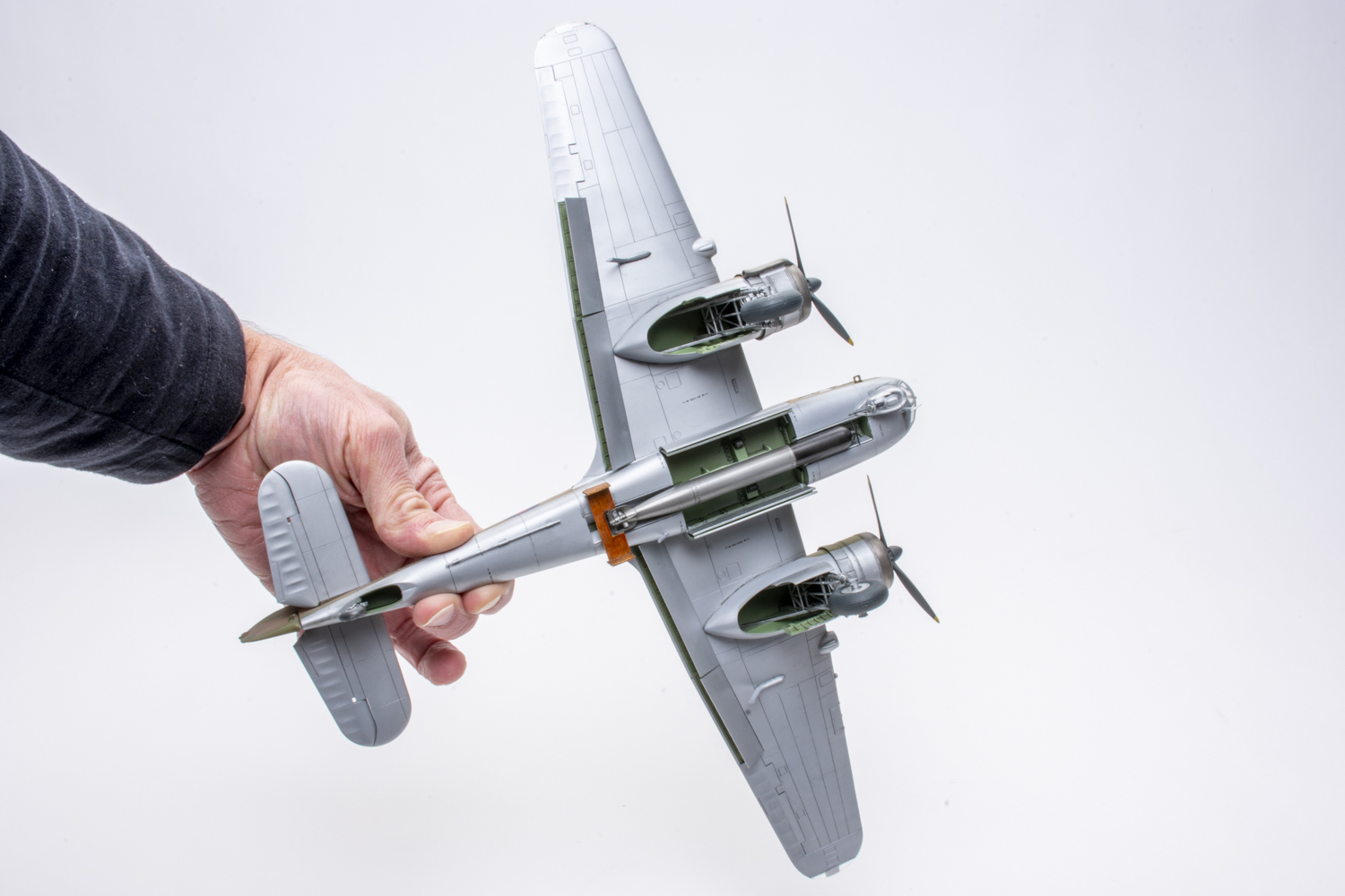

I added the tail surfaces to the fuselage and opted to complete the nacelles before installing the wings. The fit was excellent.
Adding all five of the clear parts that make up the canopy and nose at the same time was difficult. You may want to add styrene strips to the interior to aid placement.
The beautifully-detailed main gear and engines can be added after the airframe is painted. I stuffed soft foam into the large turret opening and used Microscale Micro Liquitape to hold the closed bay doors in position during painting.

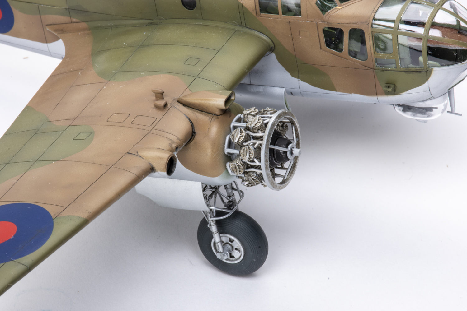

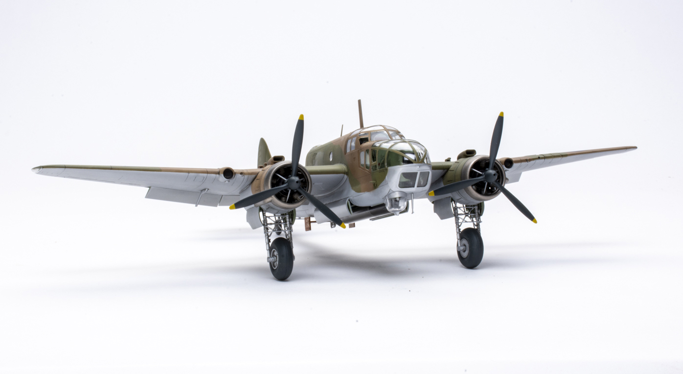

The instructions show the cowls wrapped around the engines after they are mounted. I found it much easier to remove the obstructions from inside the cowls, complete their assembly, including the cowl flaps, and slide them over the engines. I did not glue the cowls down. The props hold them in place with the help of a dab of Micro Liquitape.

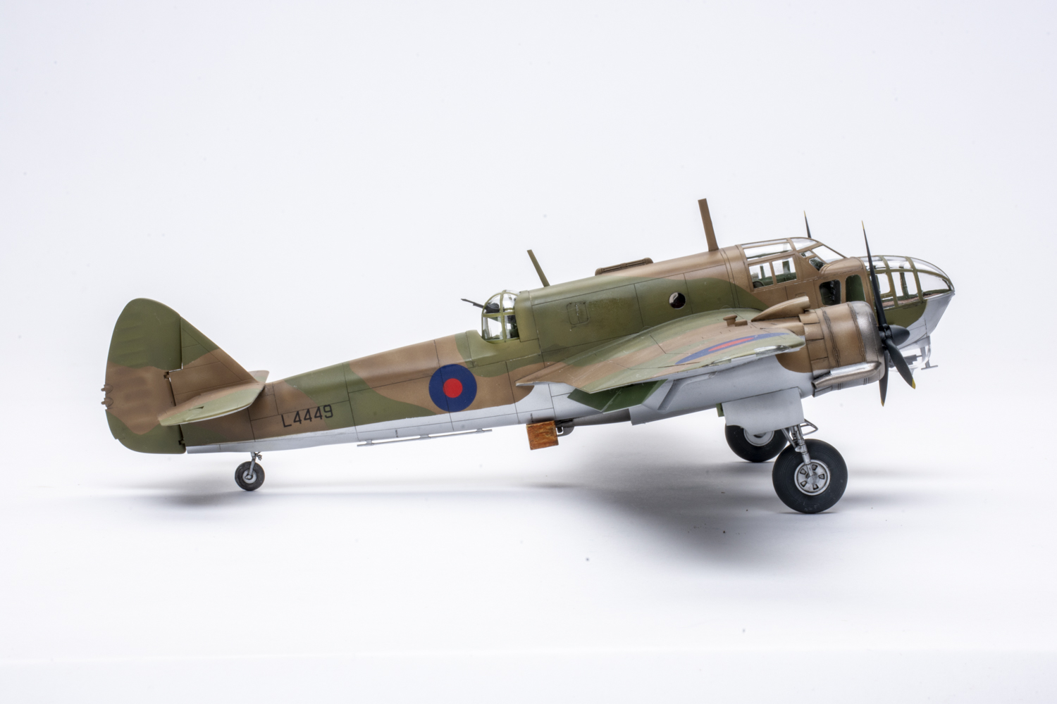

Consult your references regarding the position of the exhaust pipes. The location pins on the cowls and flaps allow different alignments. I was confused until I found a three-quarter view confirming the asymmetrical positions of the exhaust stacks.

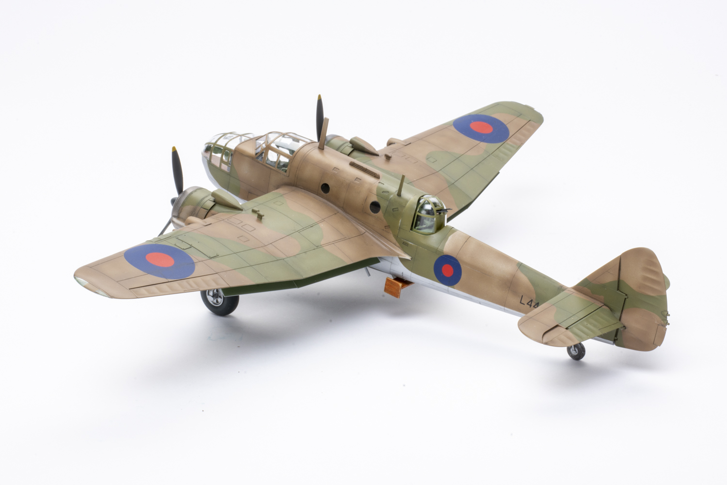

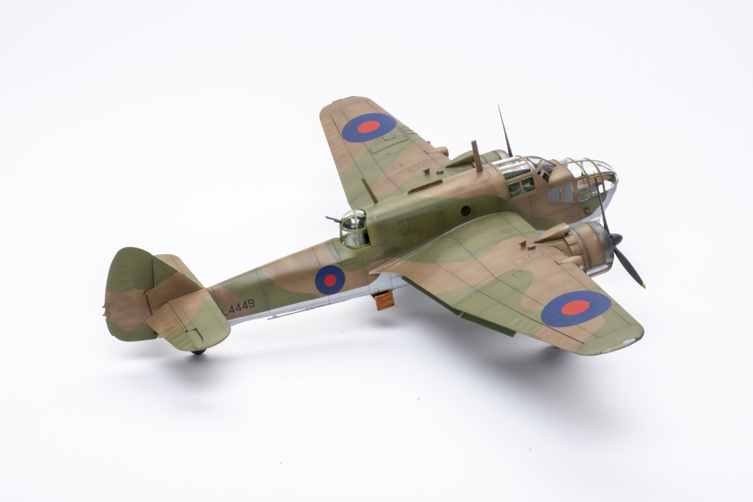

For the exterior, I used Mr. Color lacquers and Alclad II clear coats, altering the camouflage pattern slightly to keep the turret all one color. The decals conformed to the panel lines with a little prodding. I then added the turret and combing, replaced the closed bay doors with open ones, and added the main landing gear. The separate torpedo is beautifully detailed, and the trolley is a nice touch.
