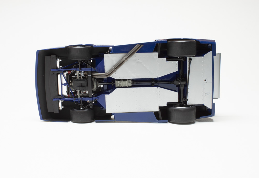

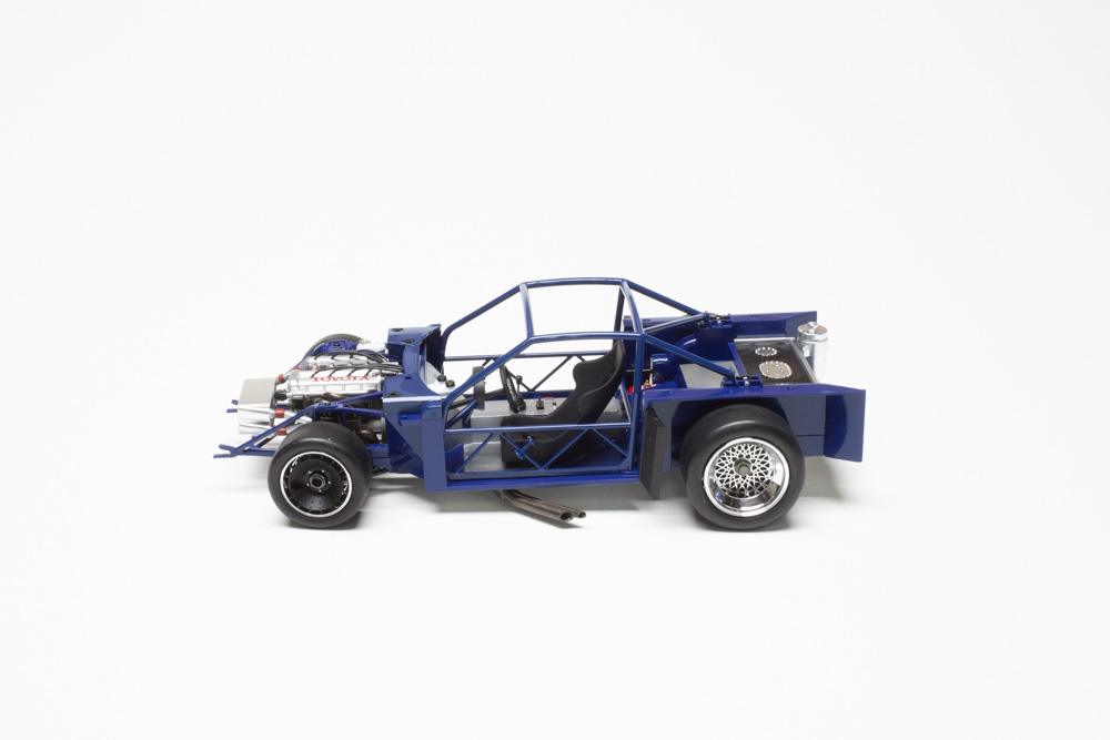

Starting with the chassis, the first challenge is cleaning up the several ejector-pin marks on the interior floor. Thankfully, most are above the surface, so it’s just a matter of shaving and sanding to get them flush.
After that, I jumped ahead to attach parts B26, B27, and B30 to the chassis. I painted this assembly to make sure they wouldn’t interfere with anything later in the build. While at it, I completed the front and rear suspension. Everything fits well, and I only made modifications to remove the tab on Part B32 that ratchets the front tie rod (a holdover from its motorized roots) and slightly tapered the pins for the front wheels to make them easier to insert.

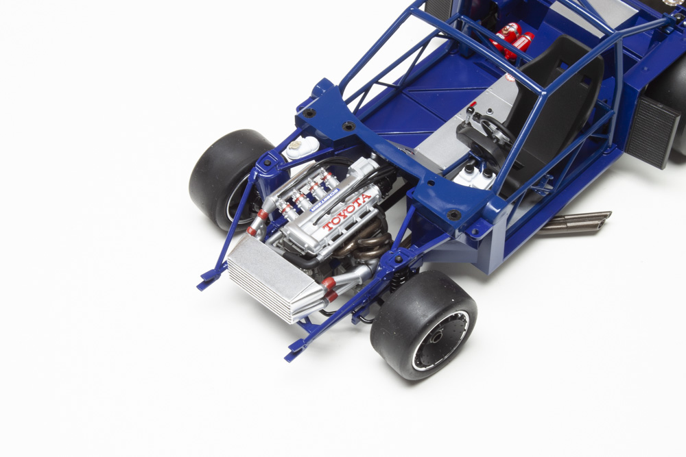

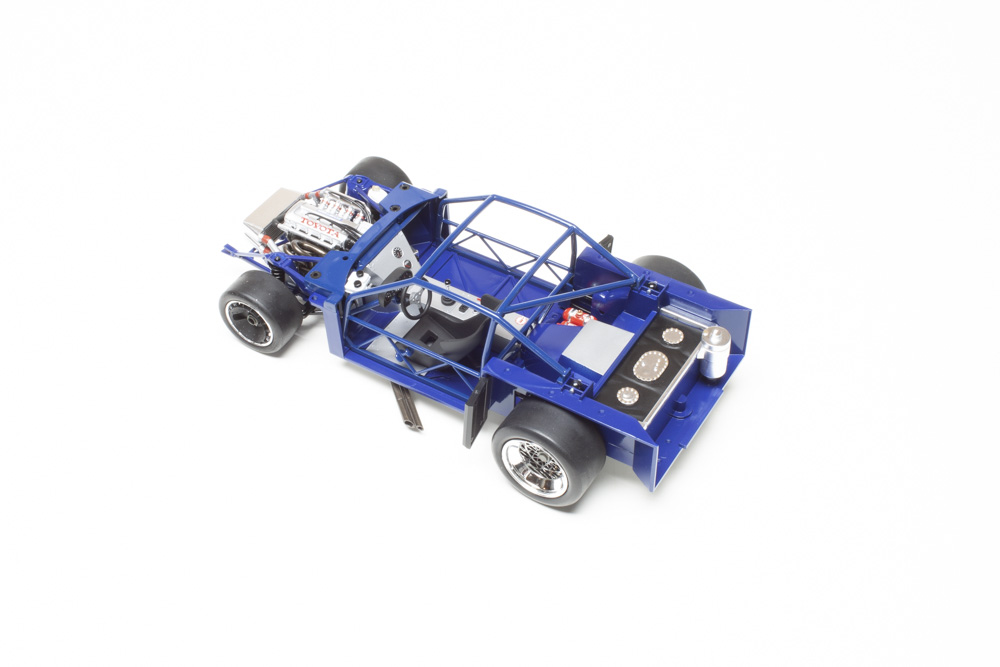

Because I left the driver figure out of my build, I built the roll cage and painted it as a unit. If you don’t plan on using the driver, you will need to source your own seat belts, as none are provided. Decals provide the gauges for the dash, center console, and fire extinguisher.
Seventeen parts comprised the nicely detailed, inline, four-cylinder, turbo engine. The kit also supplied wire for the spark plugs and fuel injection lines. I either stripped chrome-plated parts or coated them with a flat clear to tone down the shininess. I varied the colors slightly from the instructions to add more visual interest.

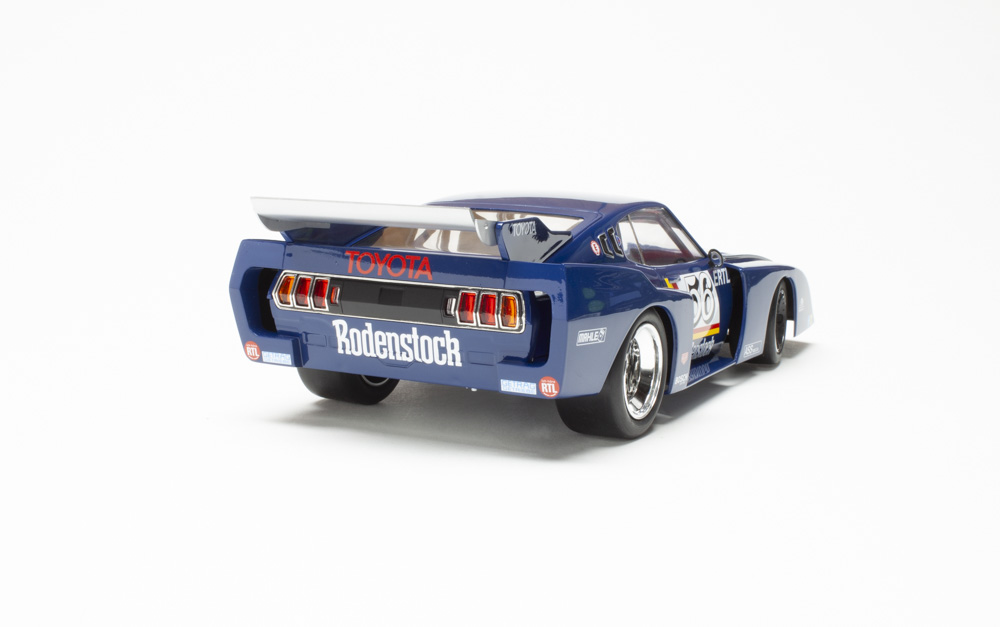

The main body section has a mold seam that runs through the C-pillar and over the top of the fenders. Though not too bad, it required some effort to clean up. I glued the rear wing supports in place before painting. In hindsight, it may have been better to leave them off because they made fitting the rear wing a struggle.

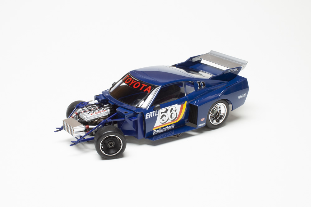

After a few coats of paint and polishing out the inevitable dust bunnies, the car was ready to decal. The decals went on beautifully! They fit perfectly and the colors were appropriately opaque. I finished with 2K clear to seal and give it that final shine before installing the glass and mirror parts.
The main body clips to the chassis in the back and uses a poly cap to secure it in the front, which works really well. The front clip mounts in a similar fashion.
