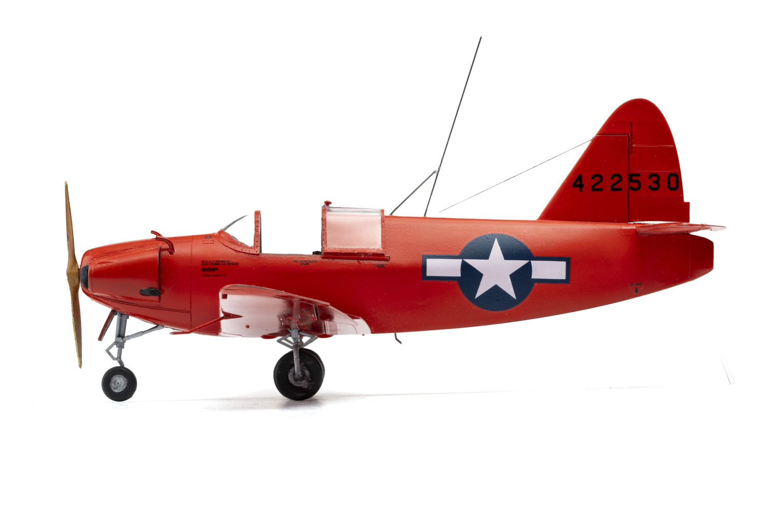

Keeping the nose wheel on the ground was the biggest headache of the build. Step 11 called for 8 grams to be added above the nose wheel well. I added 10, and that wasn’t nearly enough. So, I filled the wheel well with lead, but still no joy. In the end, I propped up the rear with a piece of stretched clear sprue. Not ideal, but at least it’s not popping a wheelie in my display case.

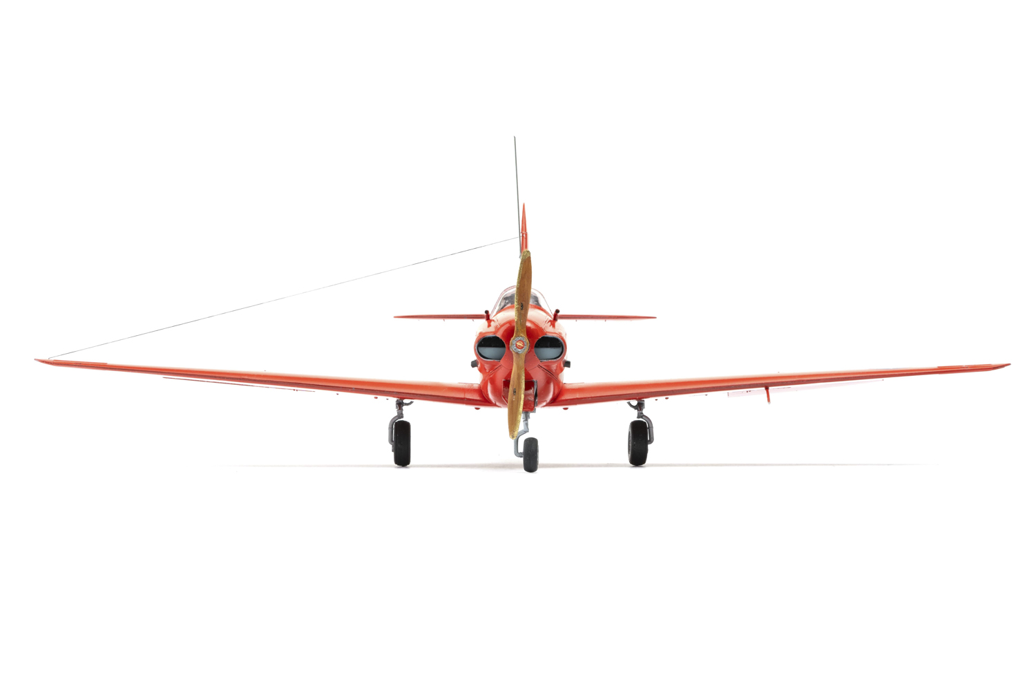

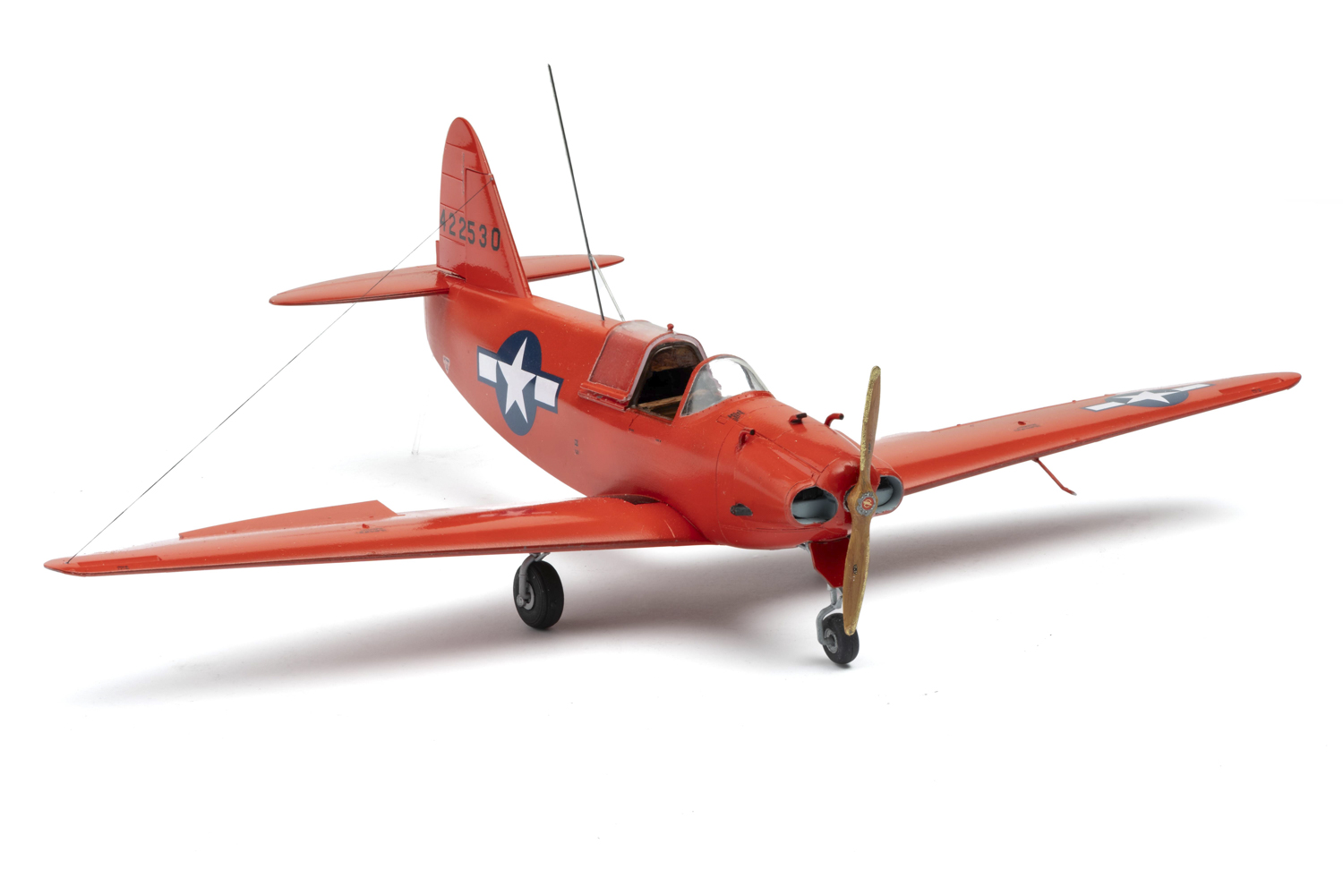

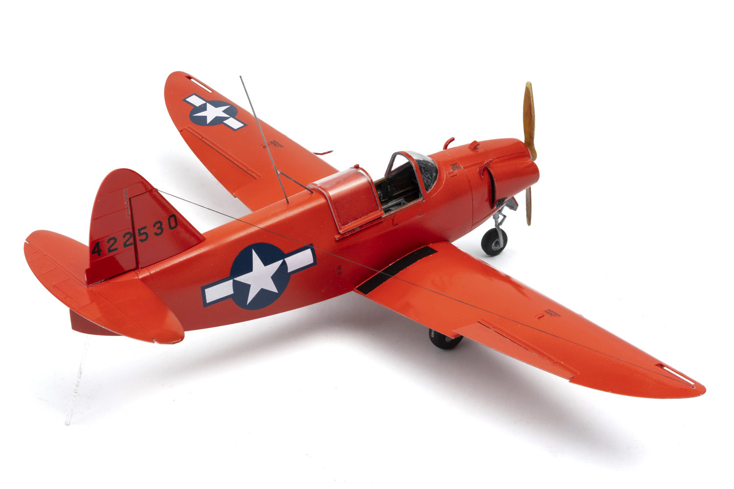

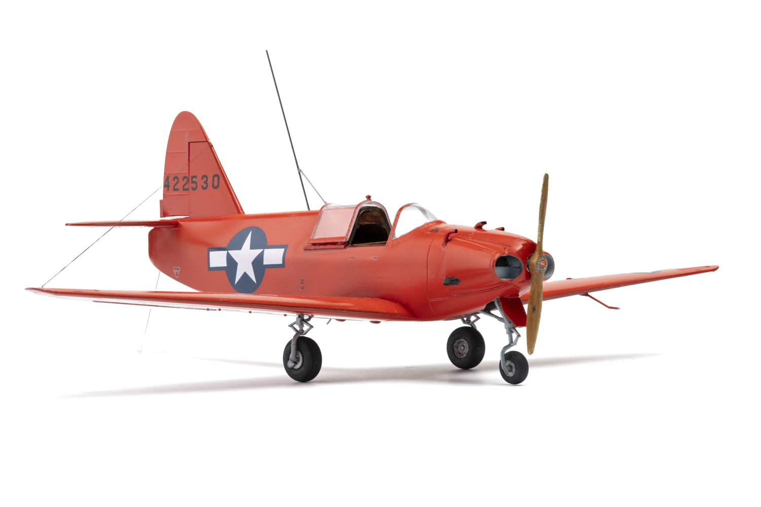

I held off attaching the undercarriage, prop, and small exterior parts until after painting. I painted the aircraft Tamiya Bright Red (No. LP-50), and the decals laid down perfectly without solvent. The aircraft I modeled featured a whip antenna that needed to be scratchbuilt, and the instructions provided a detailed drawing and measurements. I added the antenna wire from the starboard wingtip to the tail with thin elastic thread.
The finished model of this unique, albeit tiny, aircraft looks great. The Clear Prop! 1/48 scale Culver PQ-14A plastic model kit is not for a beginner because of the small parts and scratchbuilding involved. But anyone with some experience should be able to handle it without a problem.
