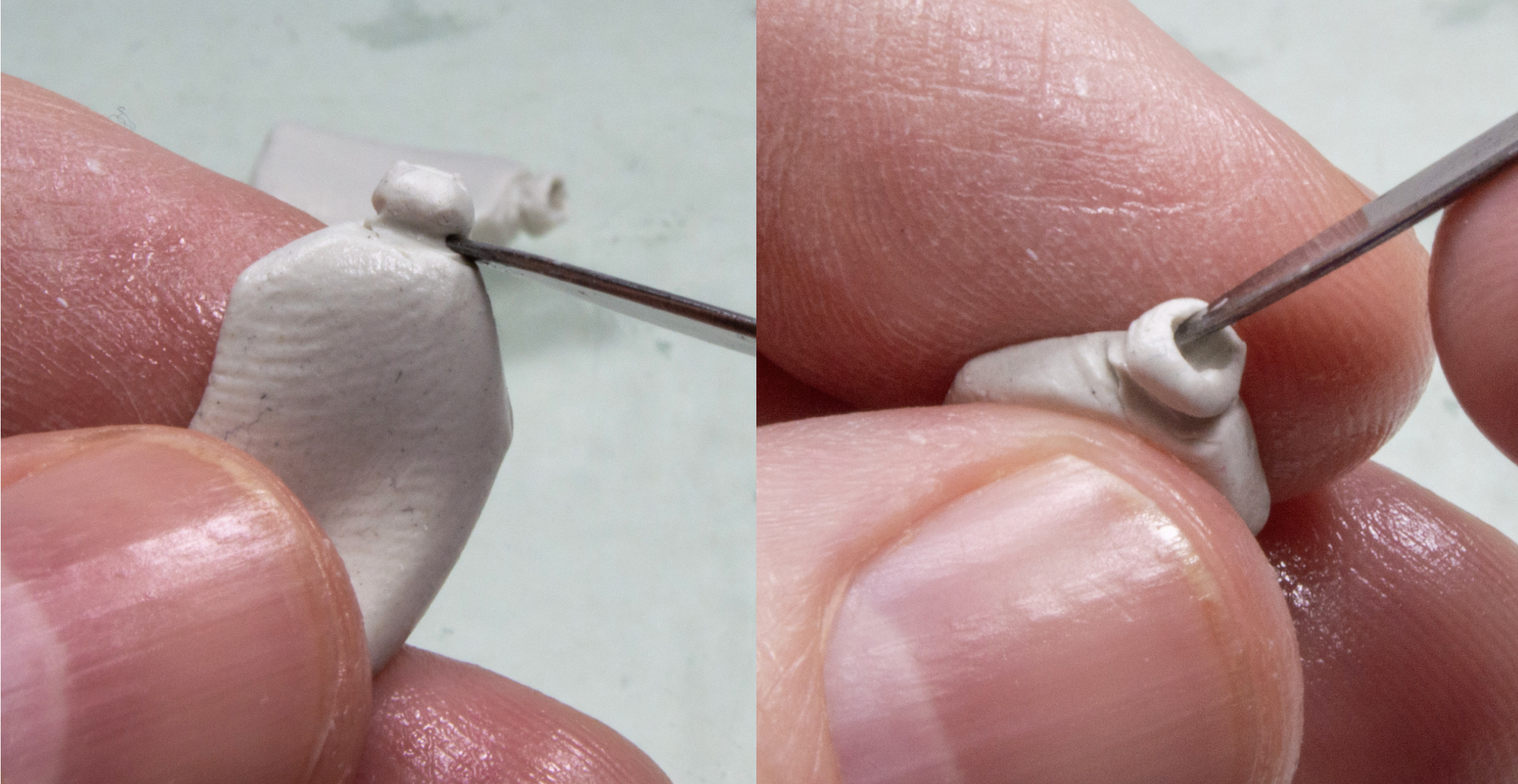

Next, with a bladed sculpting tool, define the basic shape of the tied-off end of the bag. It does not have to be too precise at this point; the final shaping will happen once the bags are placed where you want them.
FSDSNAP031_04cropped

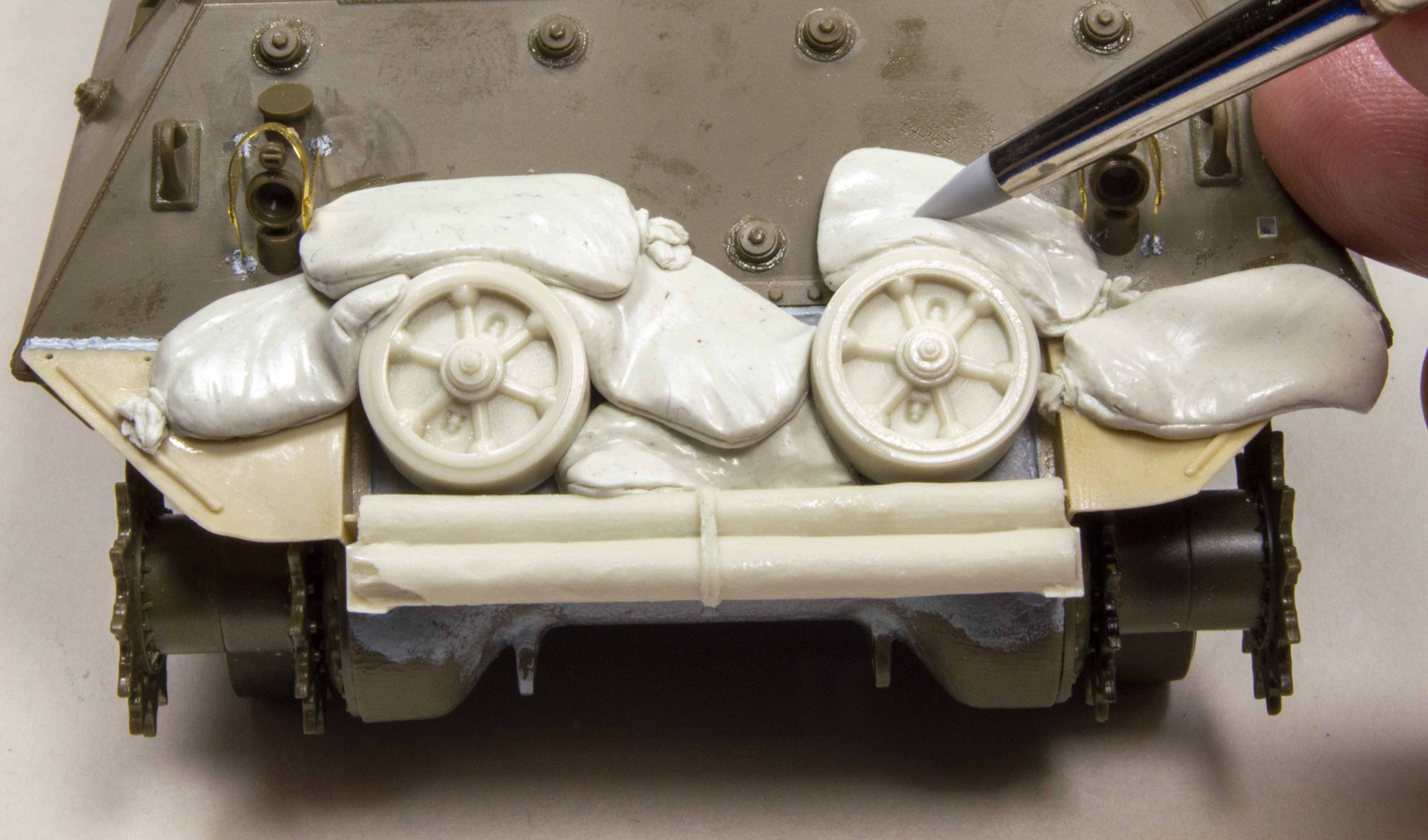

Position the bags considering how you want them to realistically sag. If you’re placing more than a few, work in layers to avoid ruining the details when placing one sandbag on another. Once placed, you can further work the shape of the sandbags with a rubber shaping tool.
FSDSNAP031_05cropped

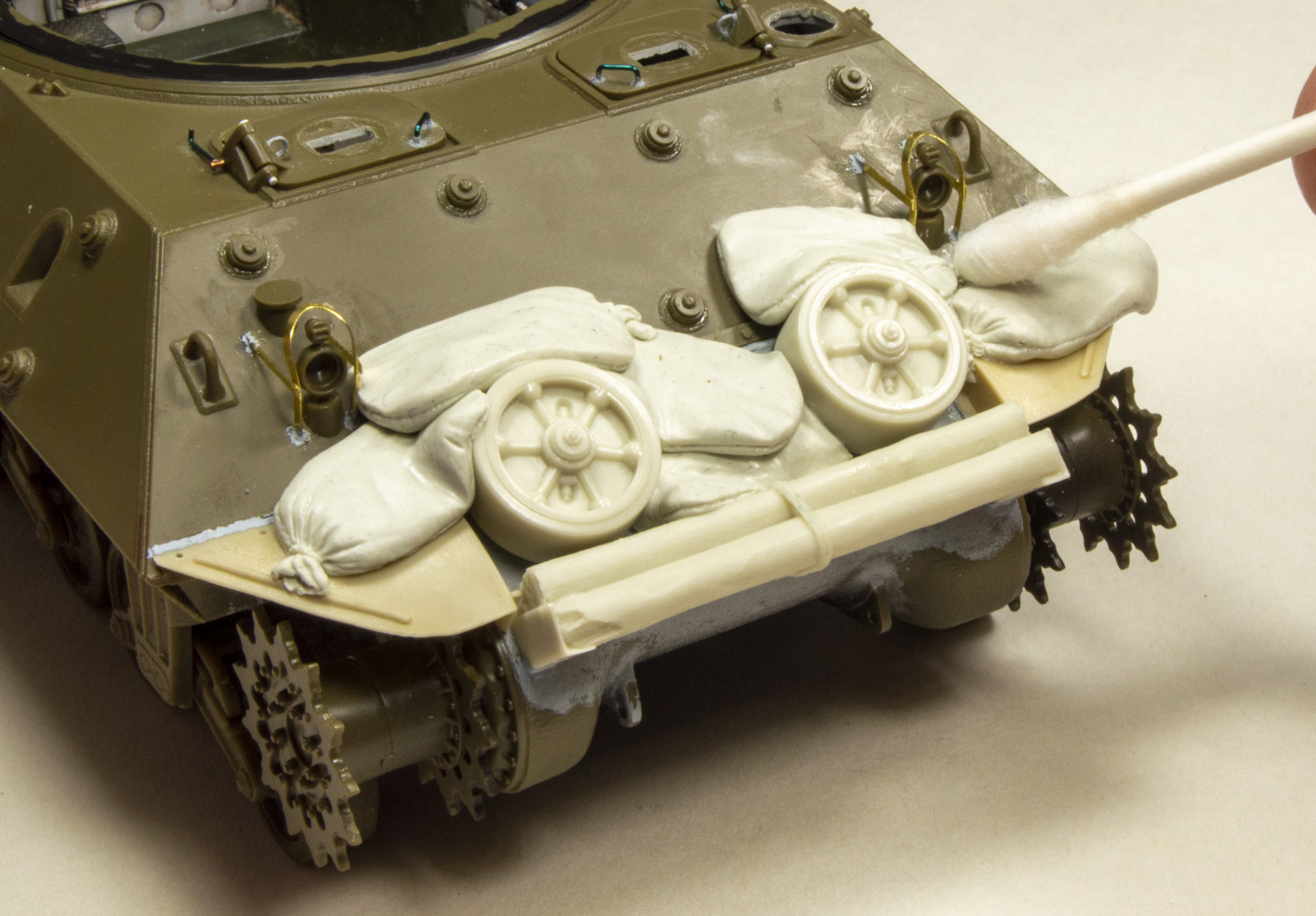

Once the first layer of bags has dried, clean them with a cotton swab coated in isopropyl alcohol to remove residual petroleum jelly. Doing this will allow the next layer of bags to stick in place and will allow primer and paint to adhere without interference.
FSDSNAP031_06

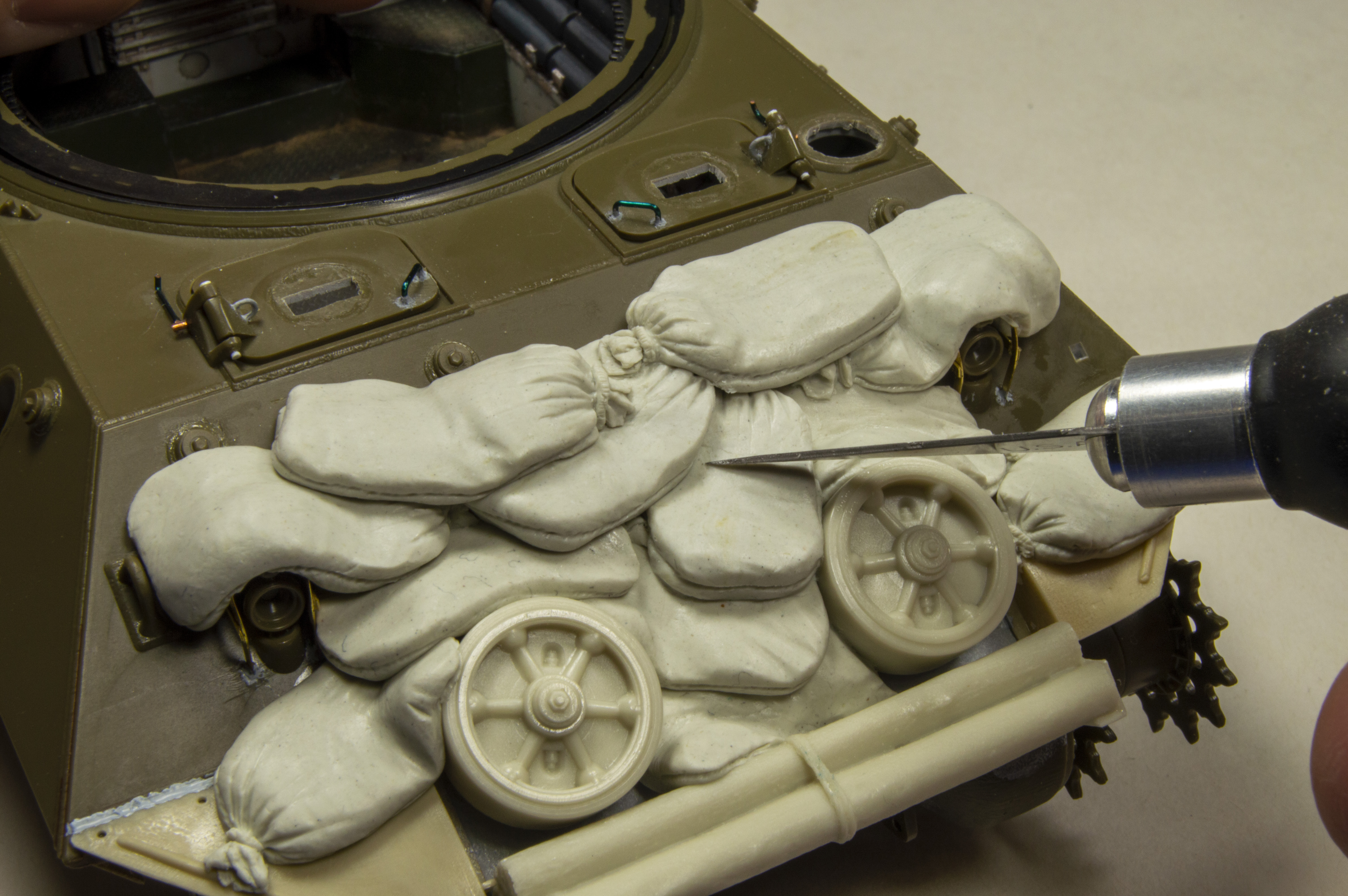

Repeat the process as many times as necessary. When the putty sandbags are completely dry and cleaned, you can do additional shaping with a hobby knife to sharpen details or smooth surfaces—like removing pesky fingerprints from initial sculpting!
