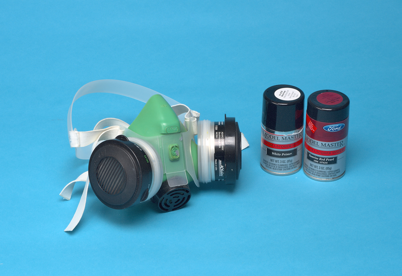

Speaking of ventilation, whether you are sanding plastic or spraying paint, an OSHA-approved respirator mask is recommended. Remember this rule: If you can smell it, you’re breathing it.

Most expert modelers prefer an airbrush, but you can get good paint finishes with spray-can paint. No matter how you paint, wear a respirator mask to protect against irritating and/or toxic fumes.
