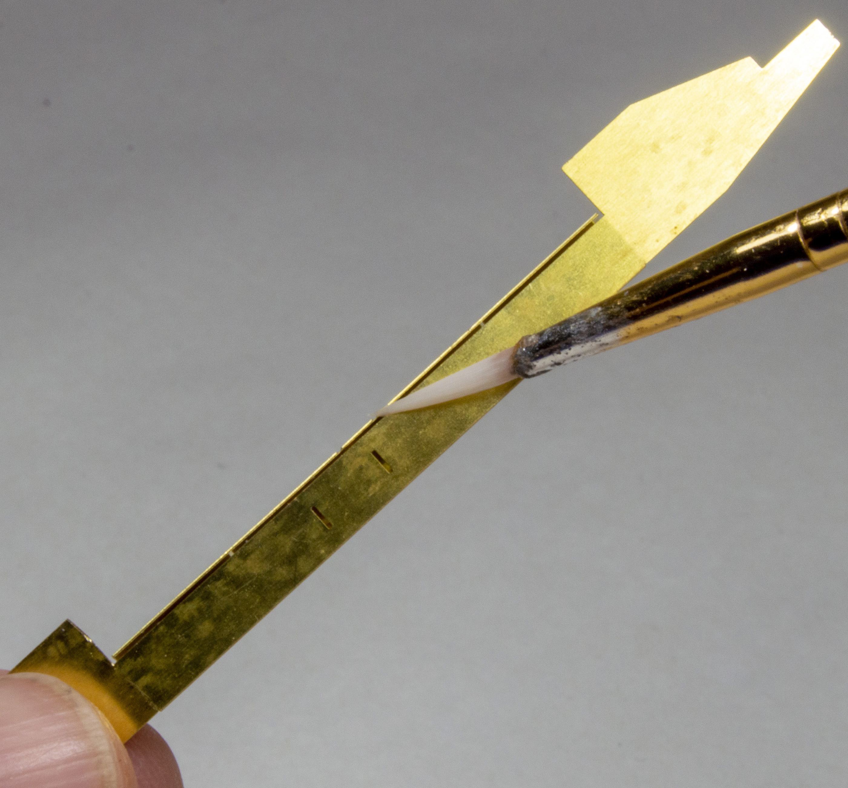

For a hedgerow cutter on the front of a tank, the seam where the pieces join needs to be strong for handling during the rest of assembly and attachment to the model. First, brush liquid flux along the seam where the solder needs to flow.

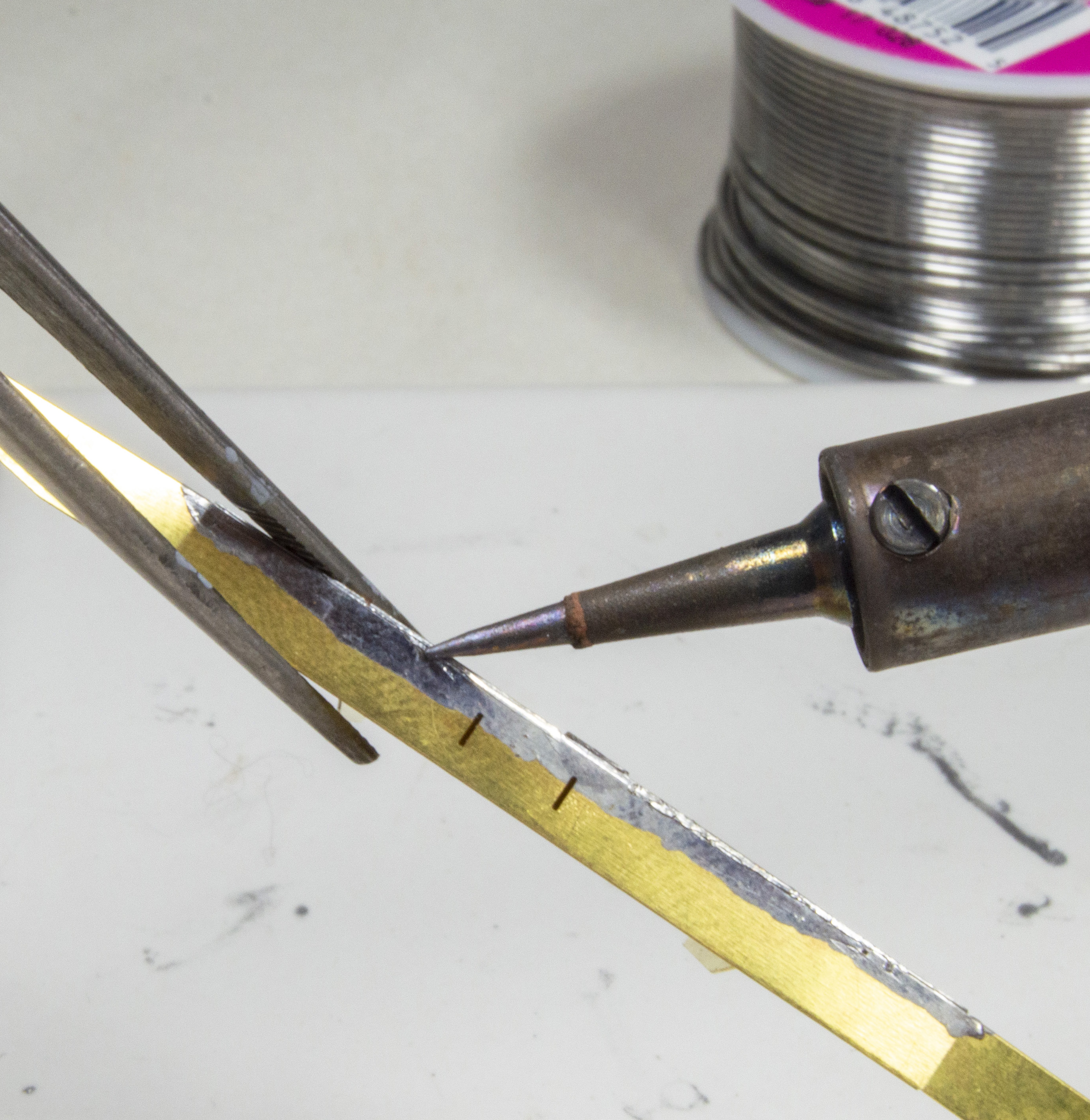

Move the iron across the join allowing the solder to flow off of the tip and onto the part. The solder will flow onto the part where the flux was applied. The initial pass maybe slightly rough, but the goal here is to get the solder to flow into the right spot to hold the piece together.
FSDSNAP029_04cropped

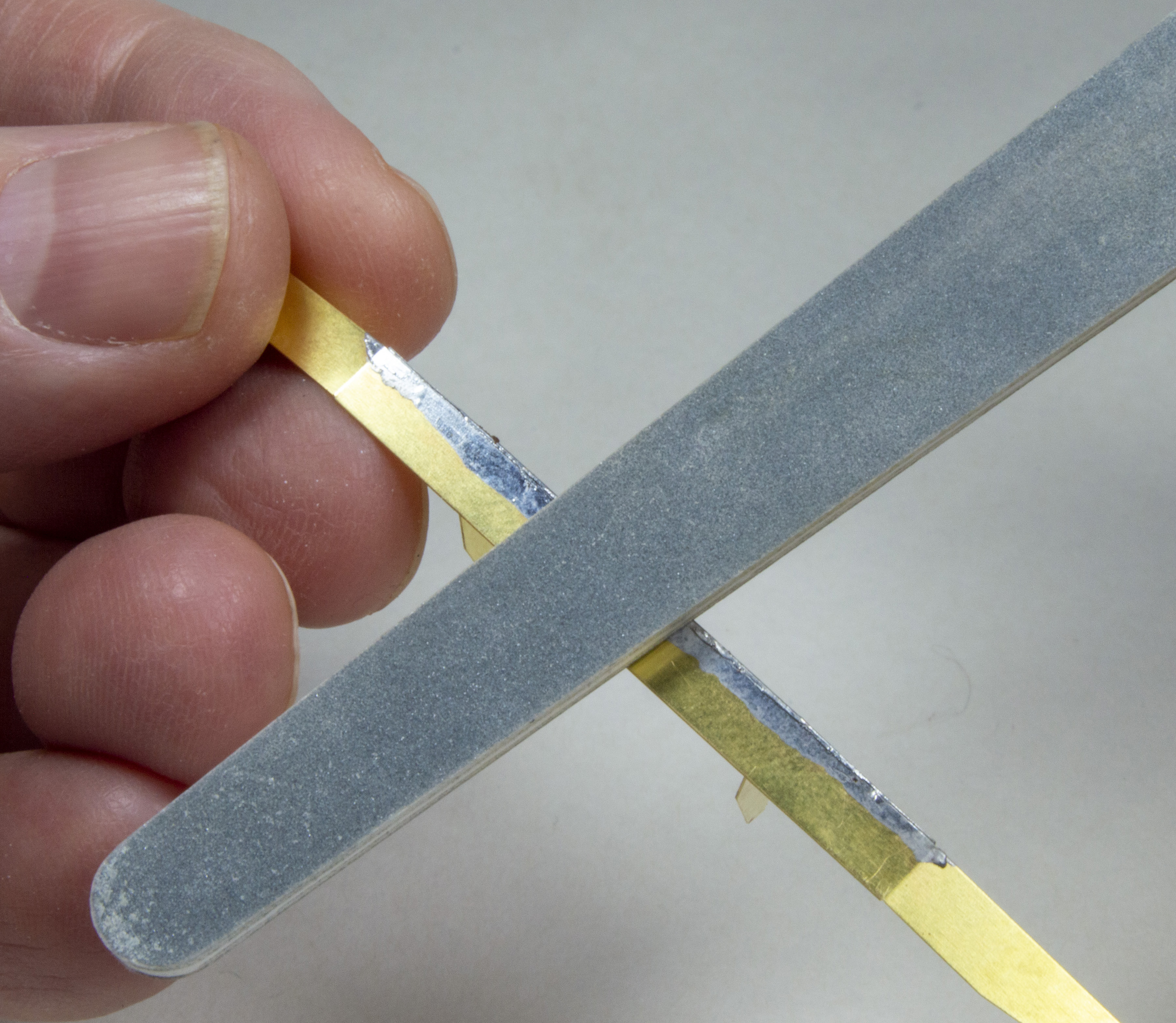

Another quick pass over the join with the edge of the tip helps to smooth out the solder.  Don’t linger, because if the solder melts completely the join will open up. Once the solder cools, clean up the join with a sanding stick or file if you need to make it smoother.

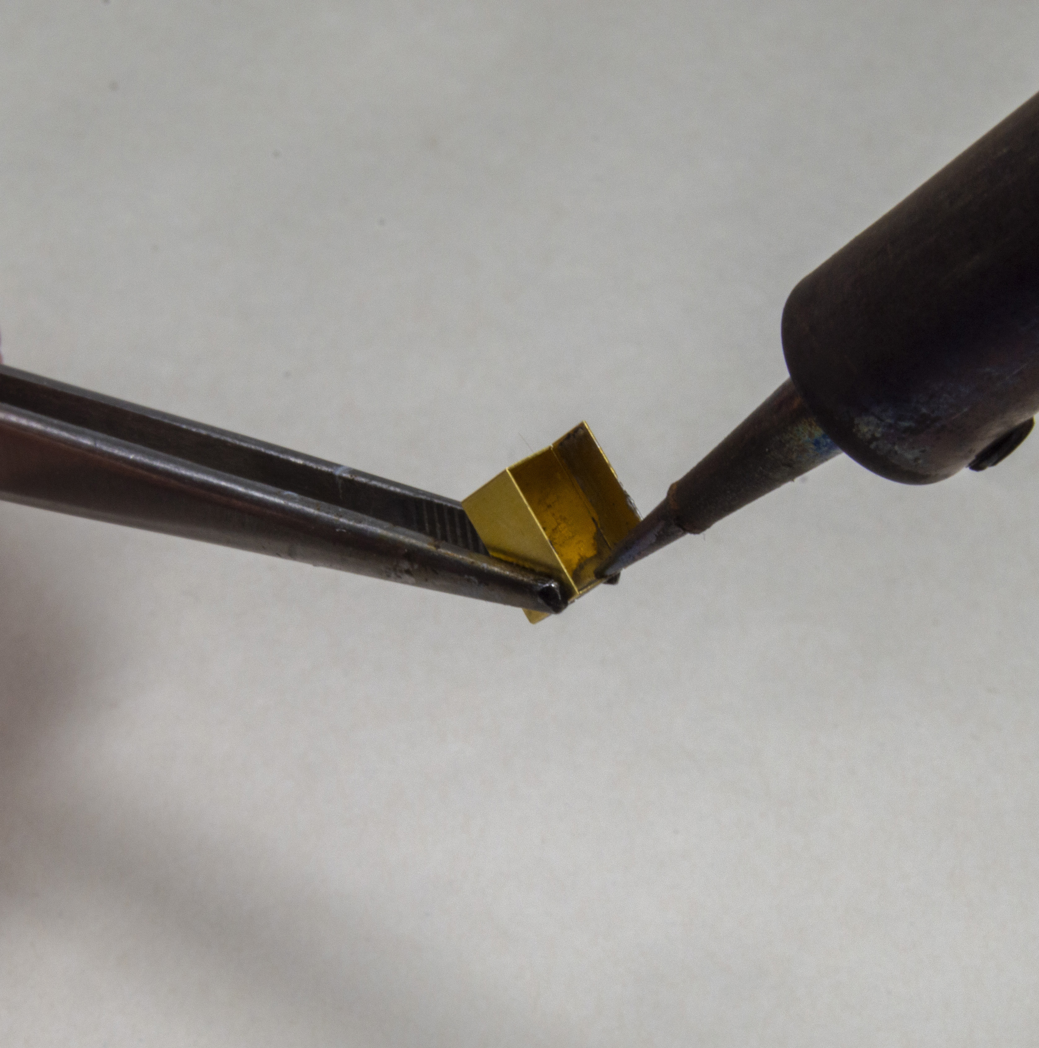

When soldering an interior join, apply flux to the seams where the sides connect. With a small amount of solder on the tip, touch the iron to the seam; the solder will flow down the join for a strong bond. This box would have likely come apart if assembled with superglue.

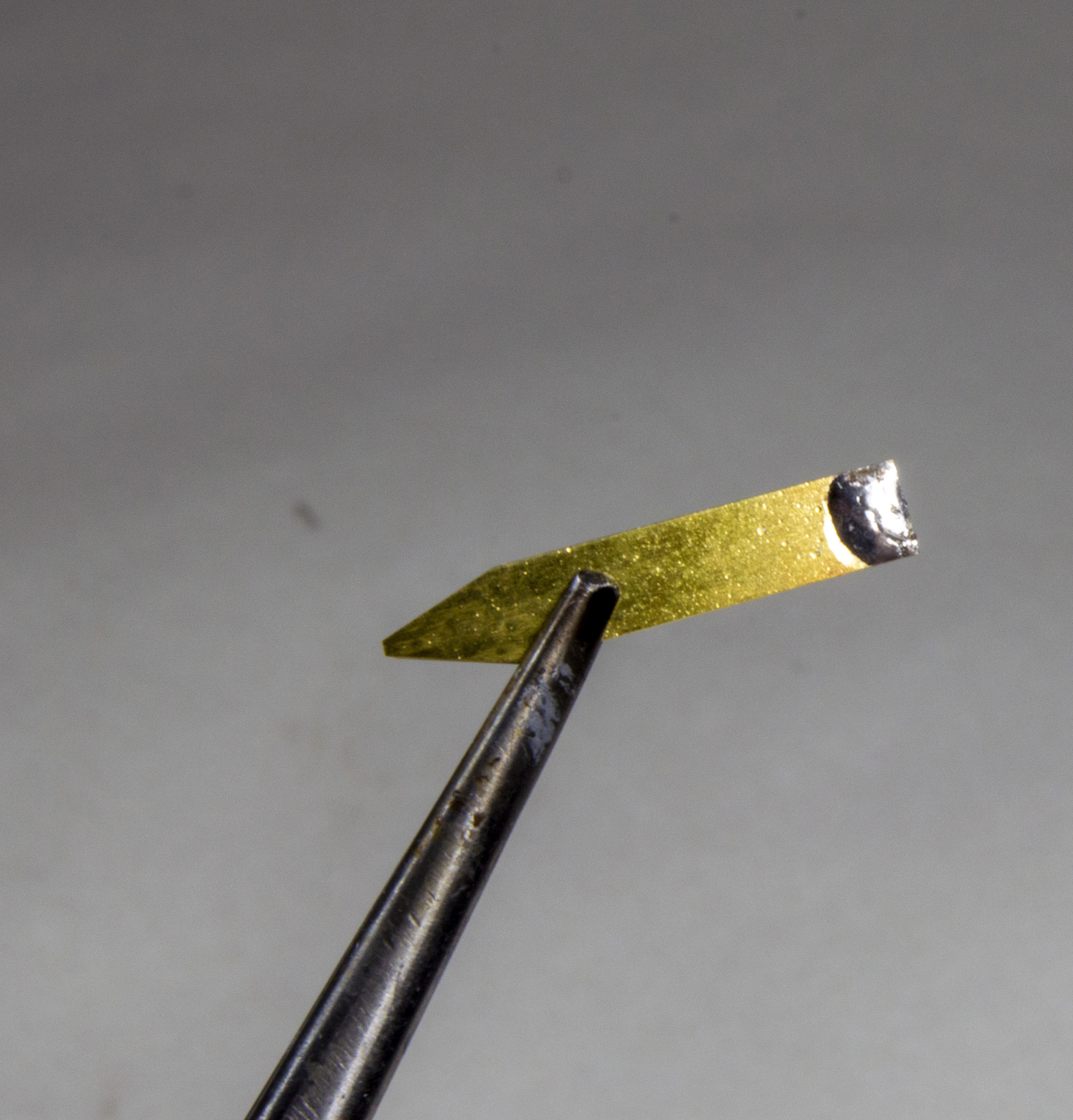

For single parts to be joined into a larger whole, you need to “tin” the parts, which means applying solder to where they will join. As before, brush flux onto both parts where the join will be and then melt a small amount of solder onto them.
FSDSNAP029_07cropped
Then hold the parts together and use the iron to heat the metal to melt the solder. A variable temperature iron is useful for this: Turn up the heat to make sure the solder melts. A larger solder tip will work, too. When the solder liquefies, remove the iron.
FSDSNAP029_08cropped

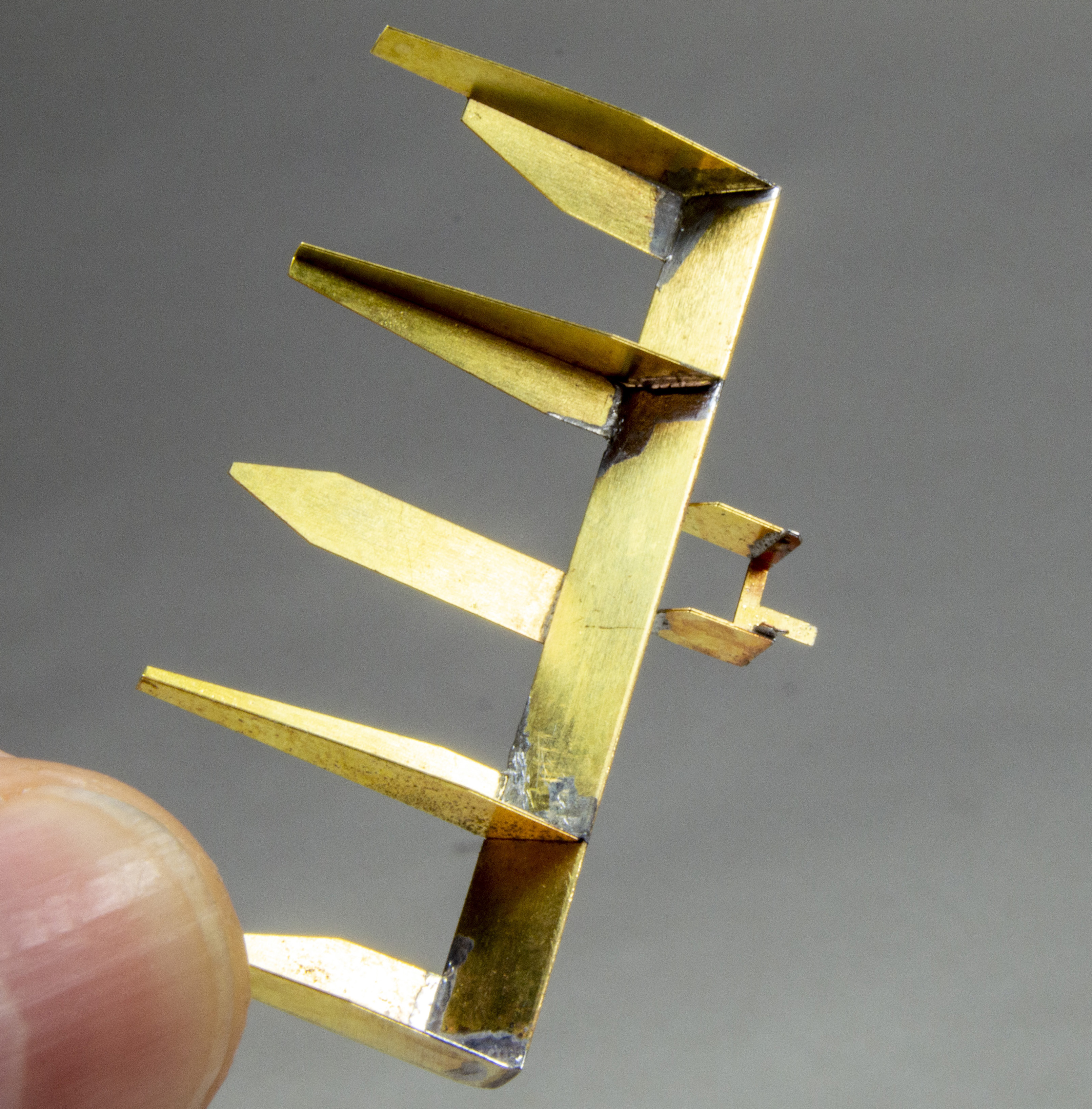

Here is the finished hedgerow cutter. While it could have been built using superglue, it likely would have come apart causing rework and unnecessary frustration. Instead, solder created nearly indestructible joins and allowed for a detailed, complex PE subassembly.
