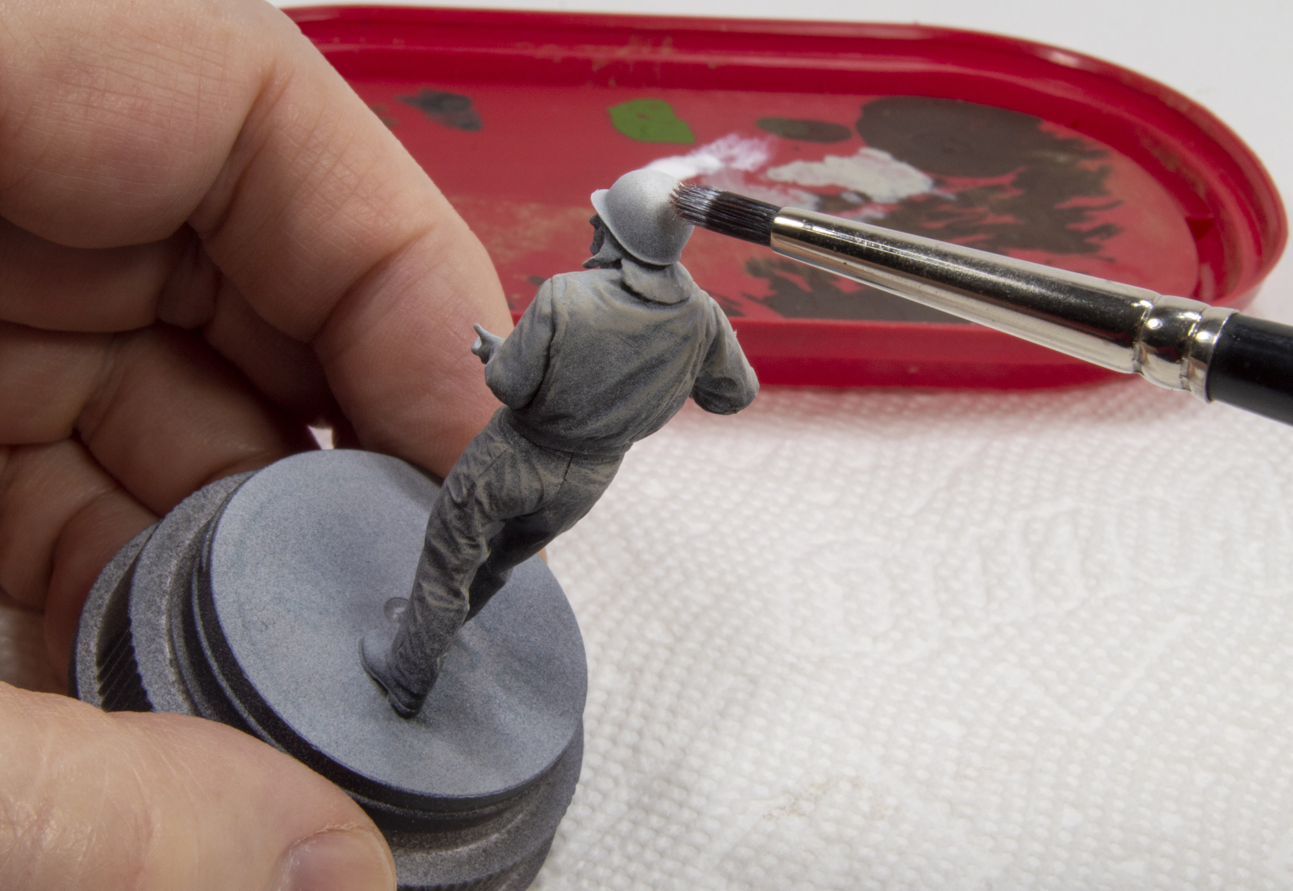

For primary light and shadow, spray the figure with black primer, and then, when dry, spray white primer from the direction of light (e.g., overhead). Dry-brush Vallejo Deck Tan (No. 70.986) and Gloss White (No. 70.842) to strengthen and blend the highlights.

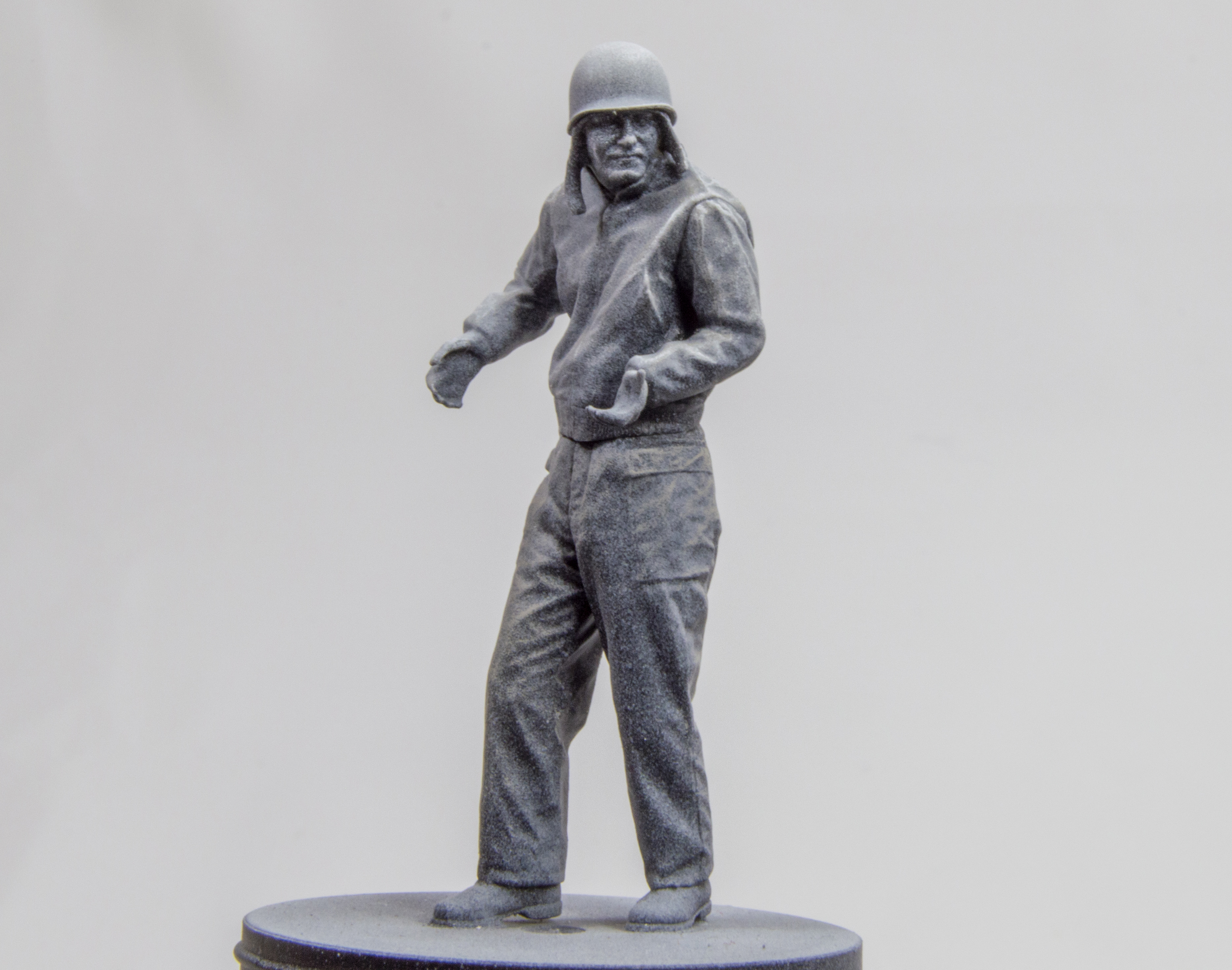

Here, you can see the light and shadow have been quickly established as a starting point for the application of color. Next, you’ll want to pick base and shadow colors and a single color for highlights, along with the Vallejo Glaze Medium (No. 73.596).

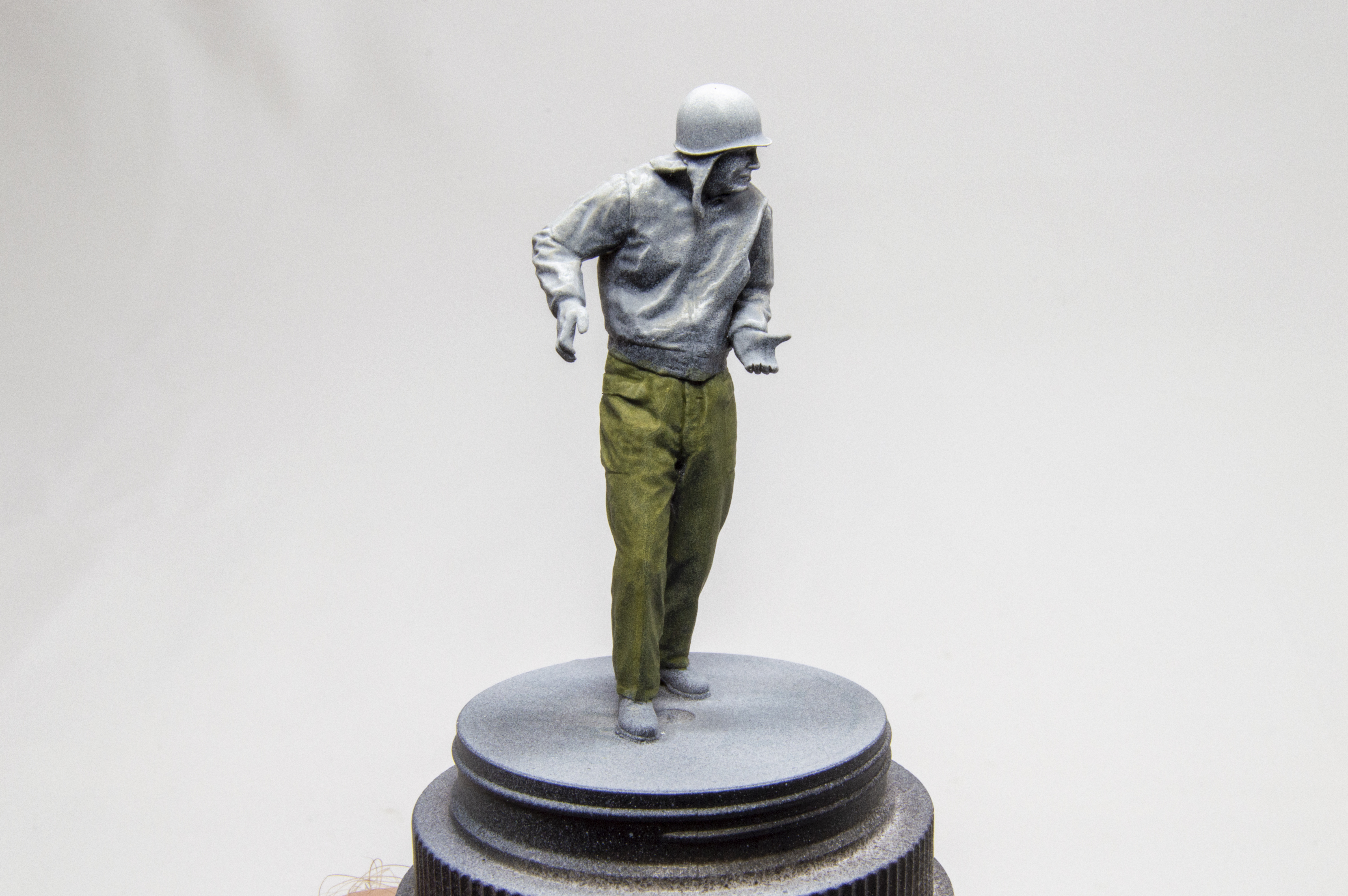

Apply three or four base-color coats. Use a hair dryer to speed drying time between coats. You can already see that highlights and shadows are retained due to the transparency of the paint.

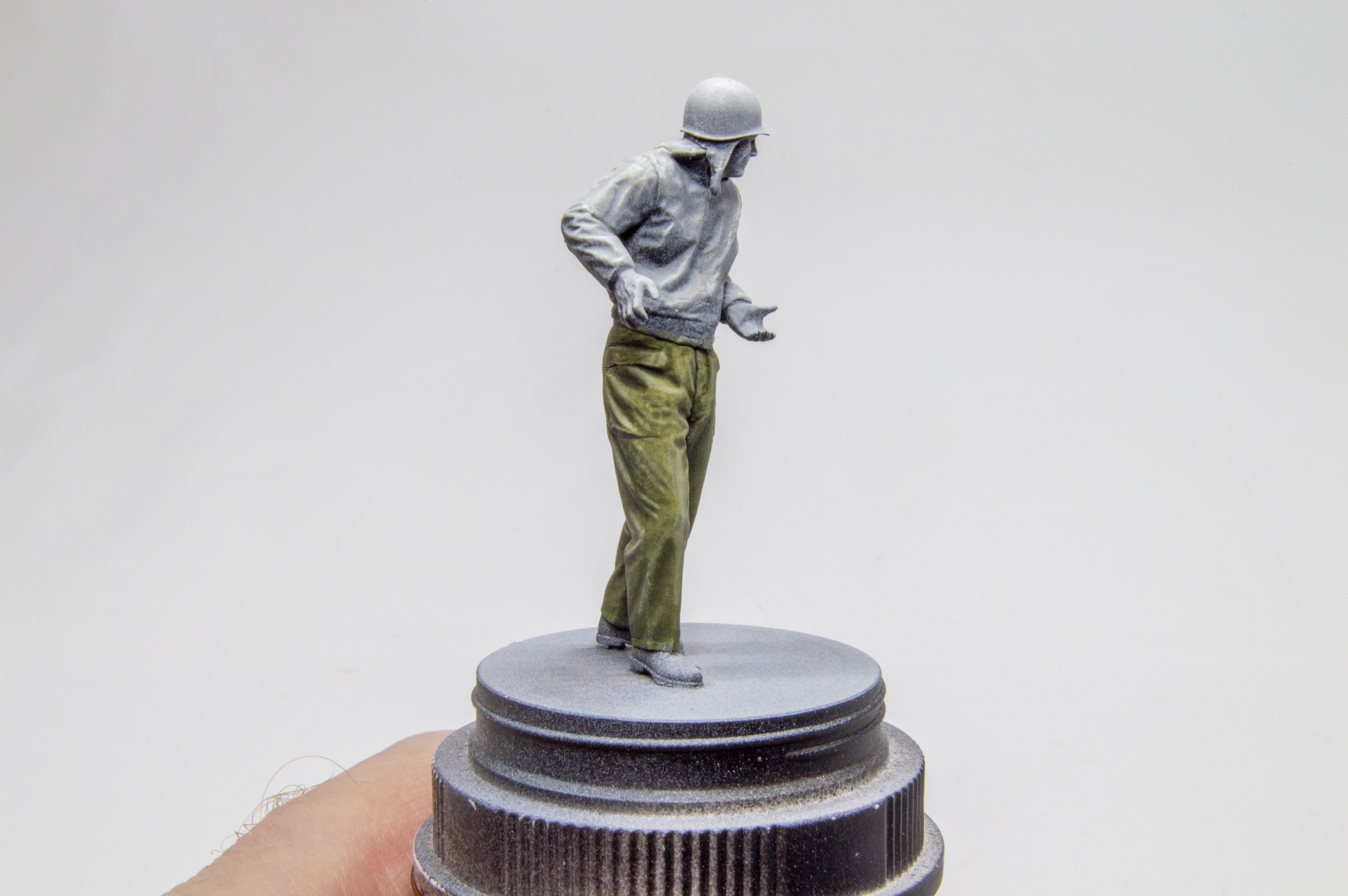

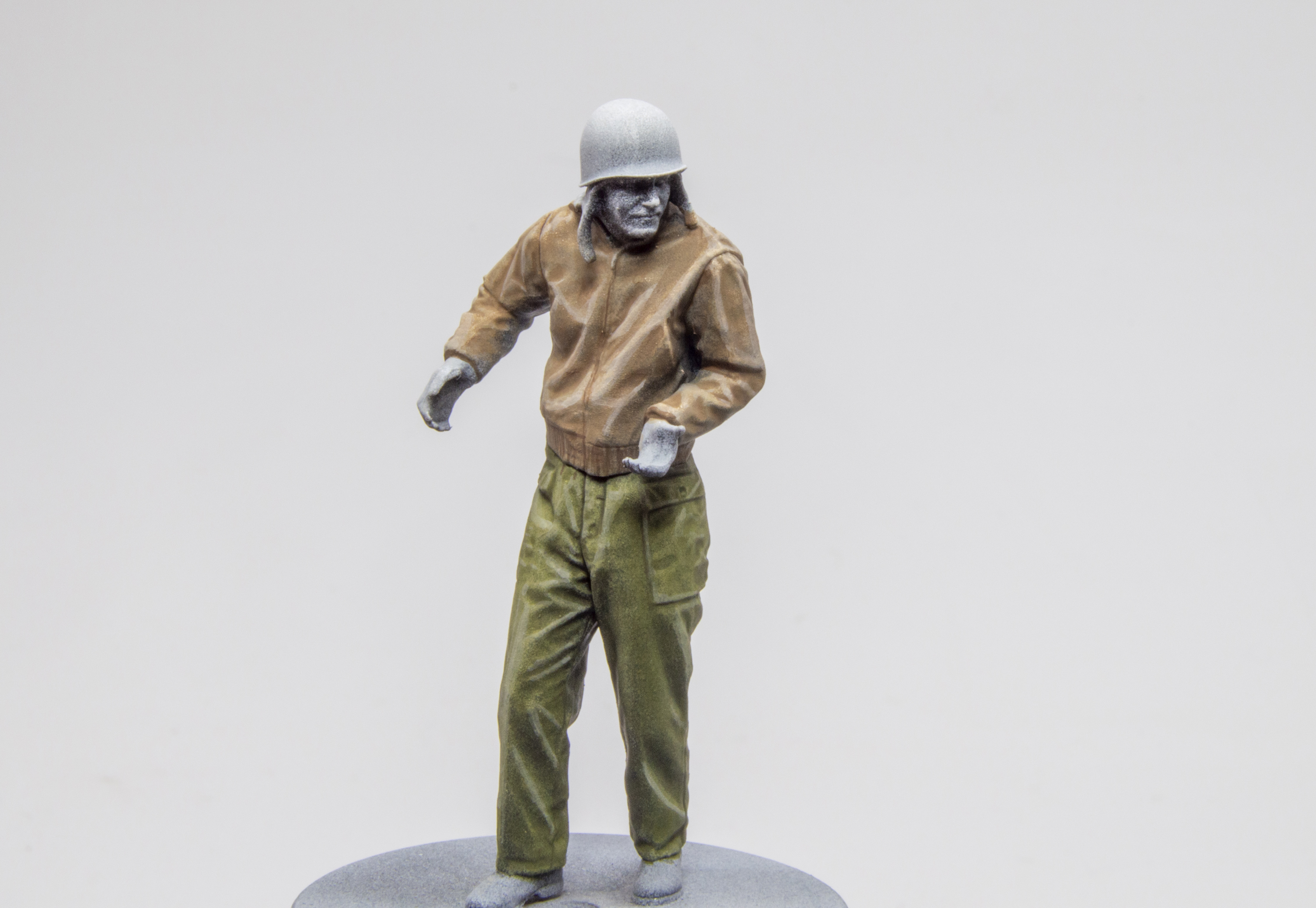

Using the same ratios as the thinning solution in step 4, mix the shadow color with the base color and accentuate folds; repeat the process with the highlight color. Here you can see the completed trousers.
FSDSNAP034_07cropped
Paint the jacket using the same techniques, allowing the zenithal primer effect to deepen shadows and pop highlights. At this point, I spent two hours on this model — about half the typical time I’d spend.

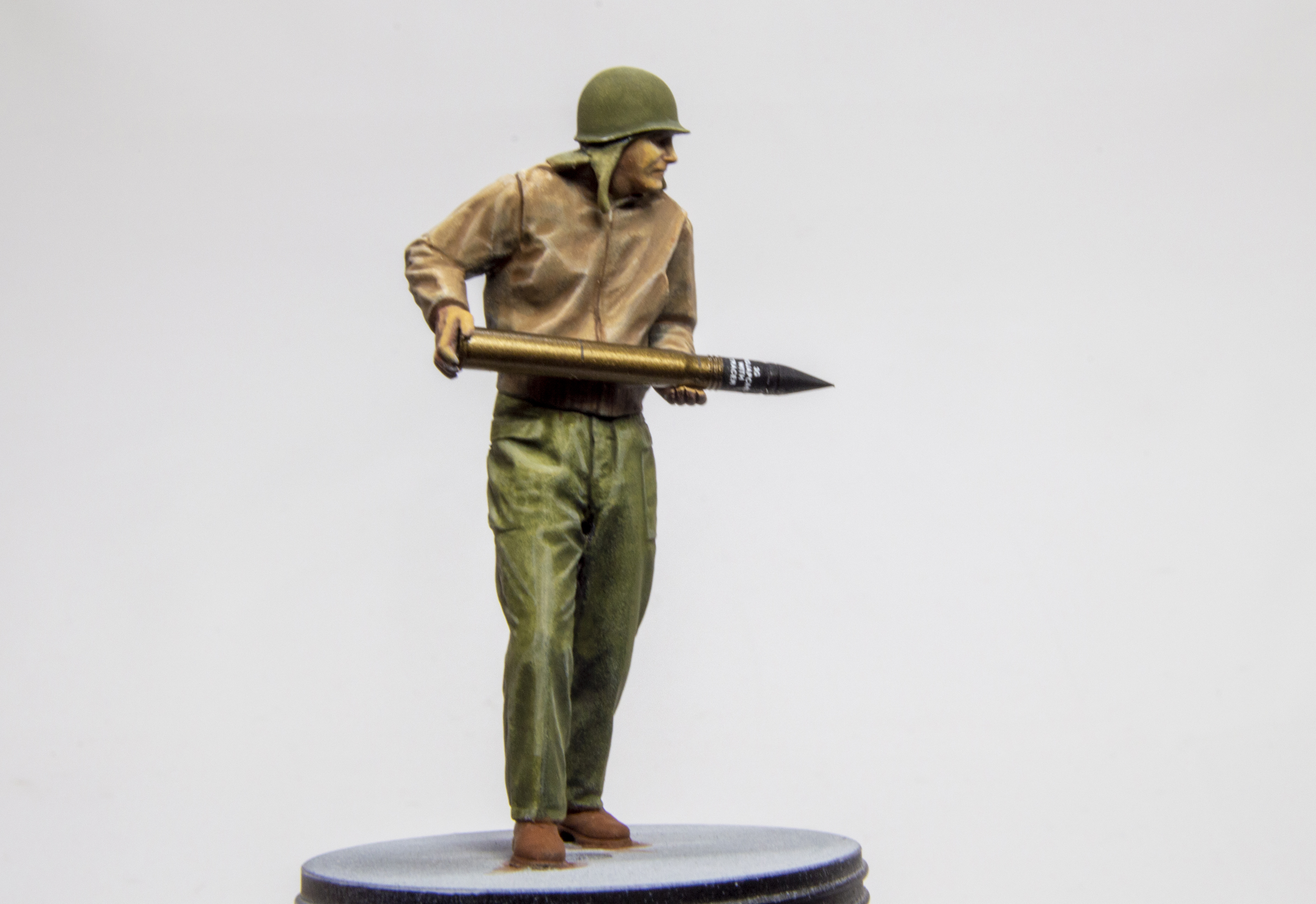

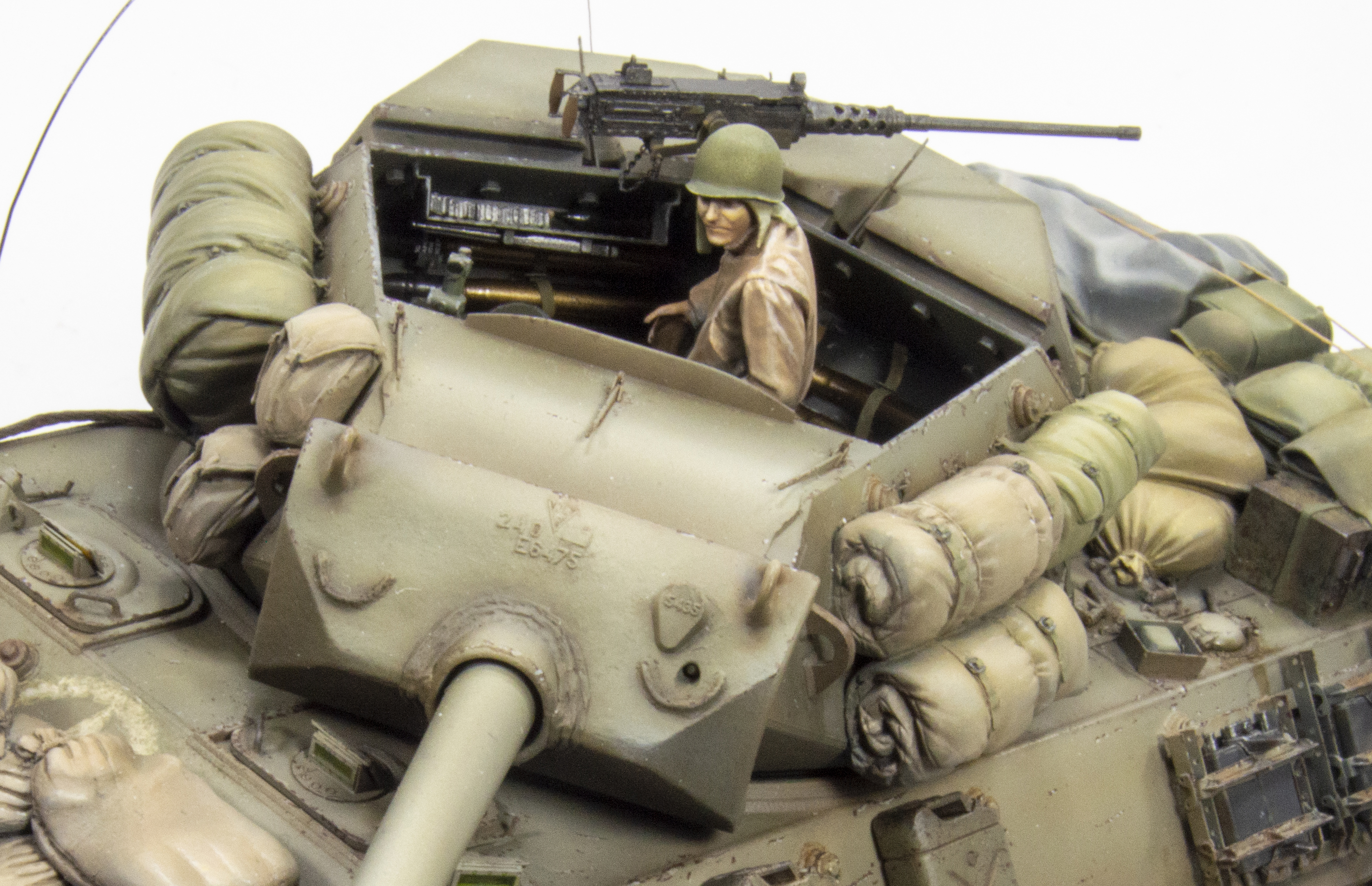

A few touch-ups and the figure gives the vehicle some life and a sense of scale. The goal with this technique is not an award-winning figure, but a quicker way to obtain a result that complements the model.
