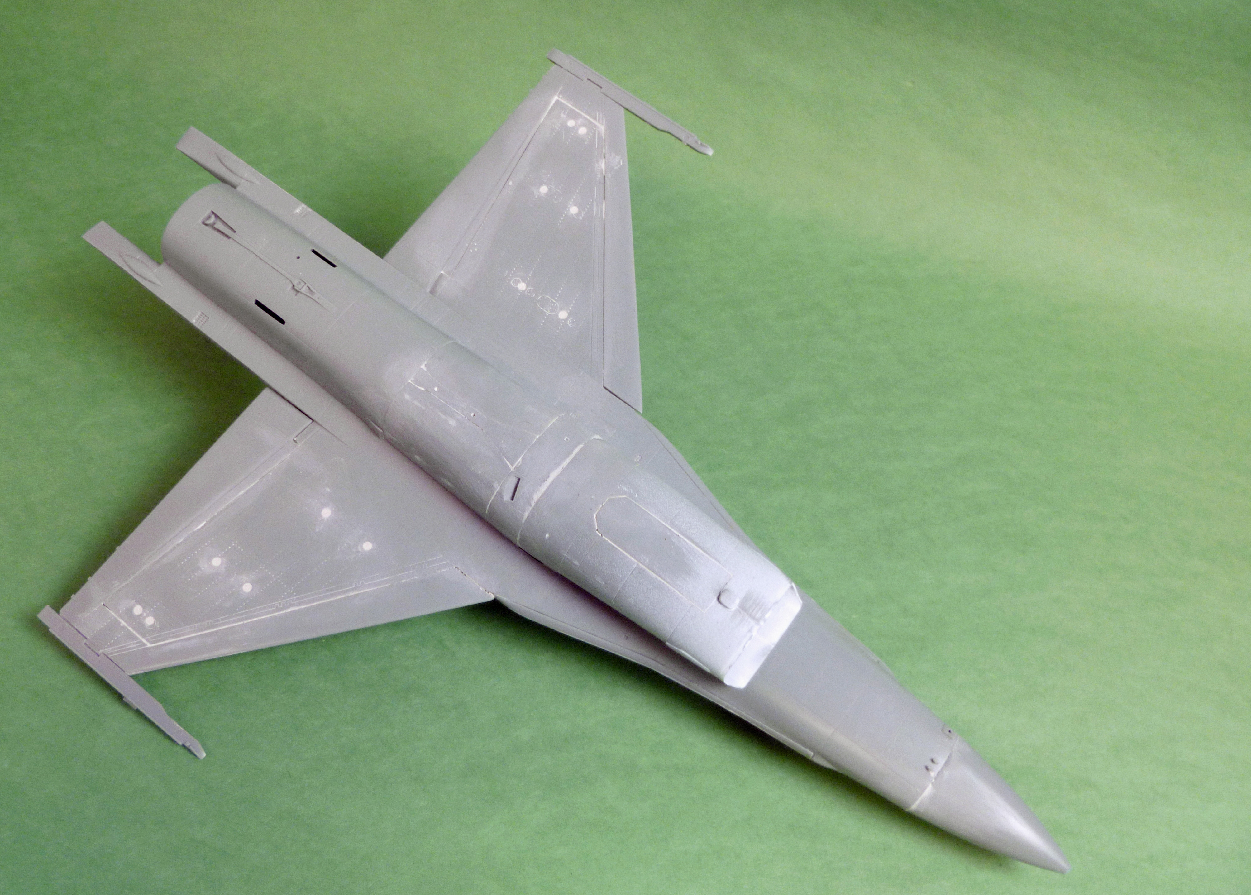

Wheels up, doors closed: As you can see, a fair amount of filler was needed to smooth everything out.

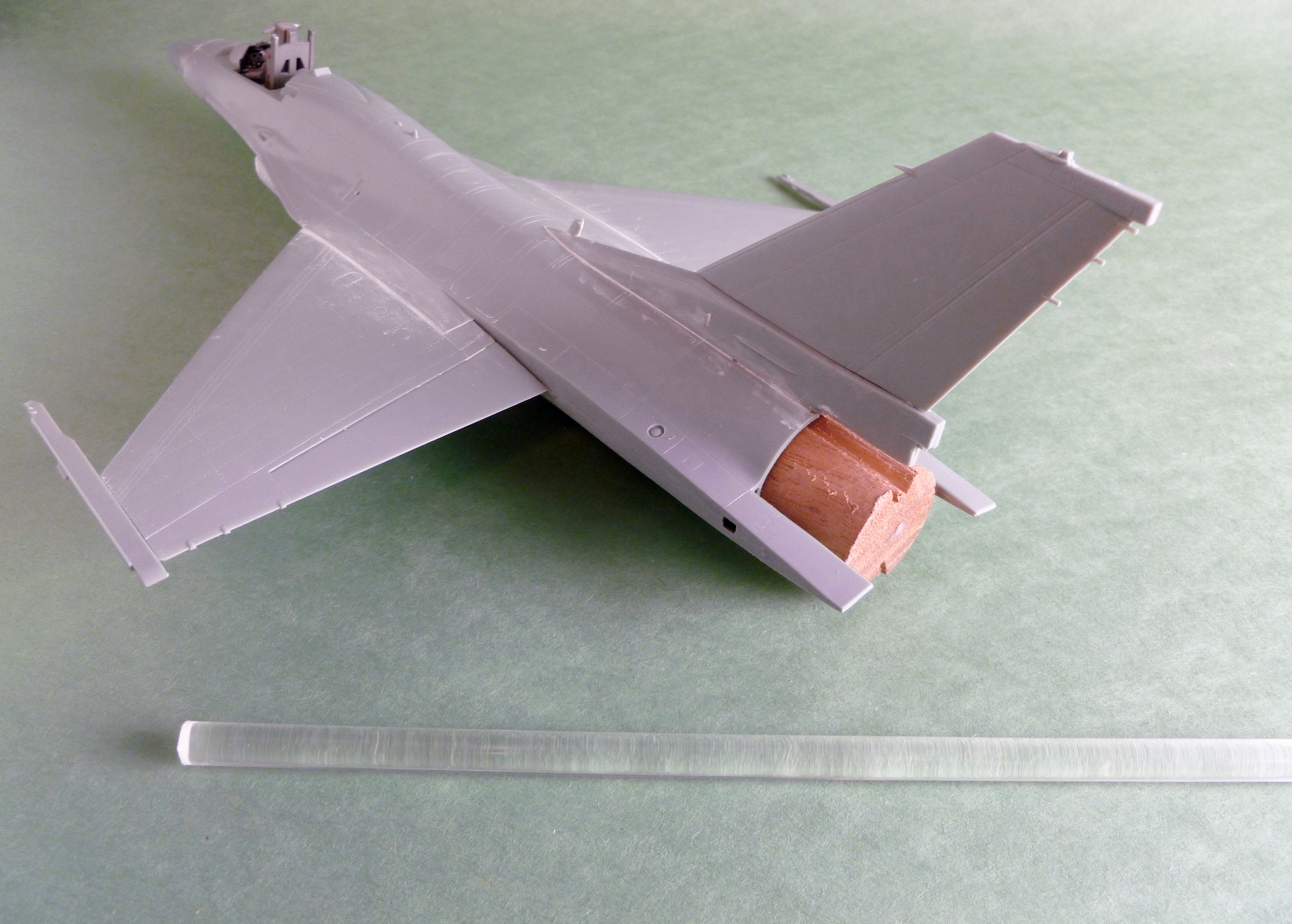

A 1/4-inch clear acrylic rod holds the aircraft aloft and is anchored in a wood dowel in the model. The grooves were cut to allow the plug to clear internally. I used epoxy to attach the plug before installing the tailpipe — but make sure everything fits before applying epoxy.

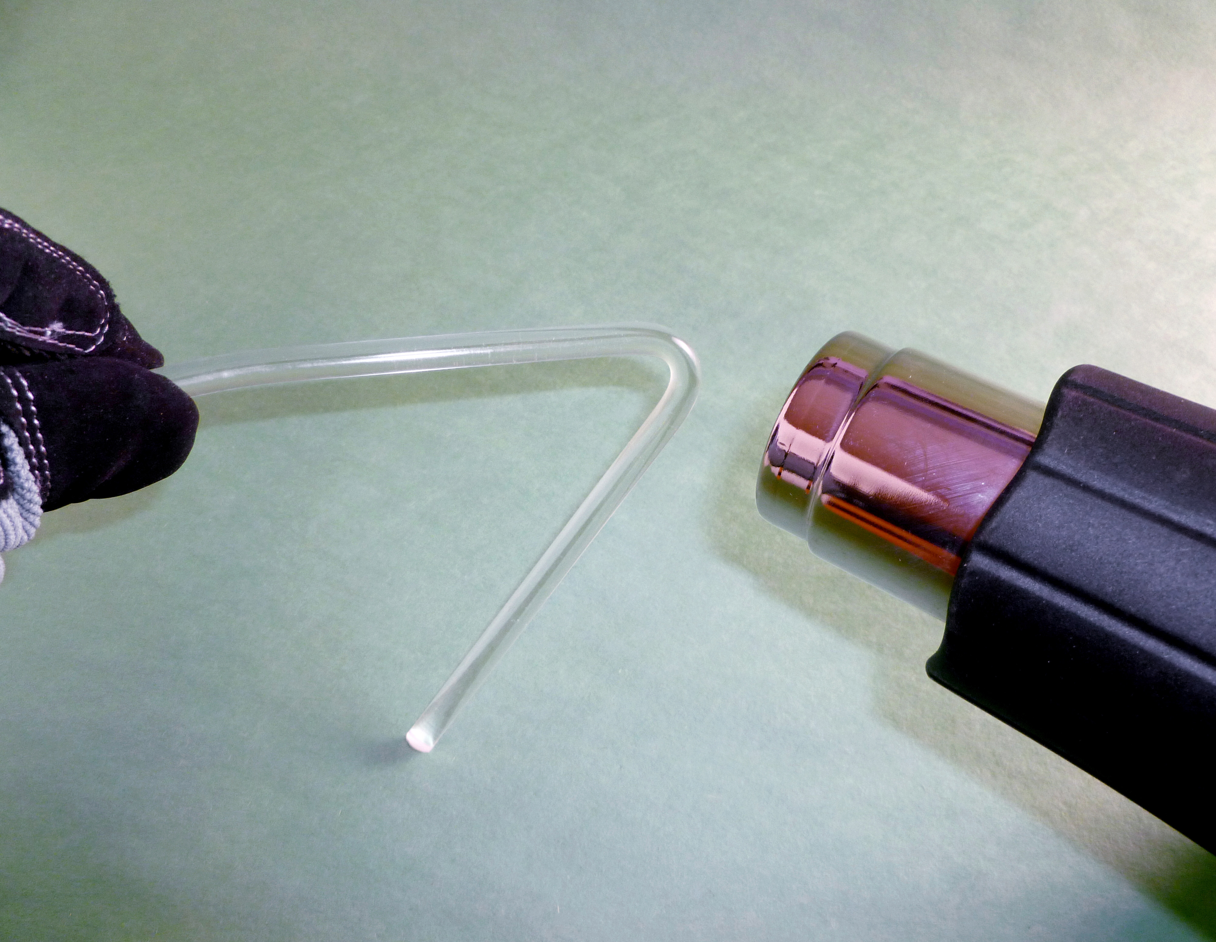

To bend the rod, I clamped a heat gun to a table and, wearing heavy-duty gloves, heated the rod in one spot until I could bend it. If you want a gentler curve, heat a larger portion of the rod and bend it around a round object.

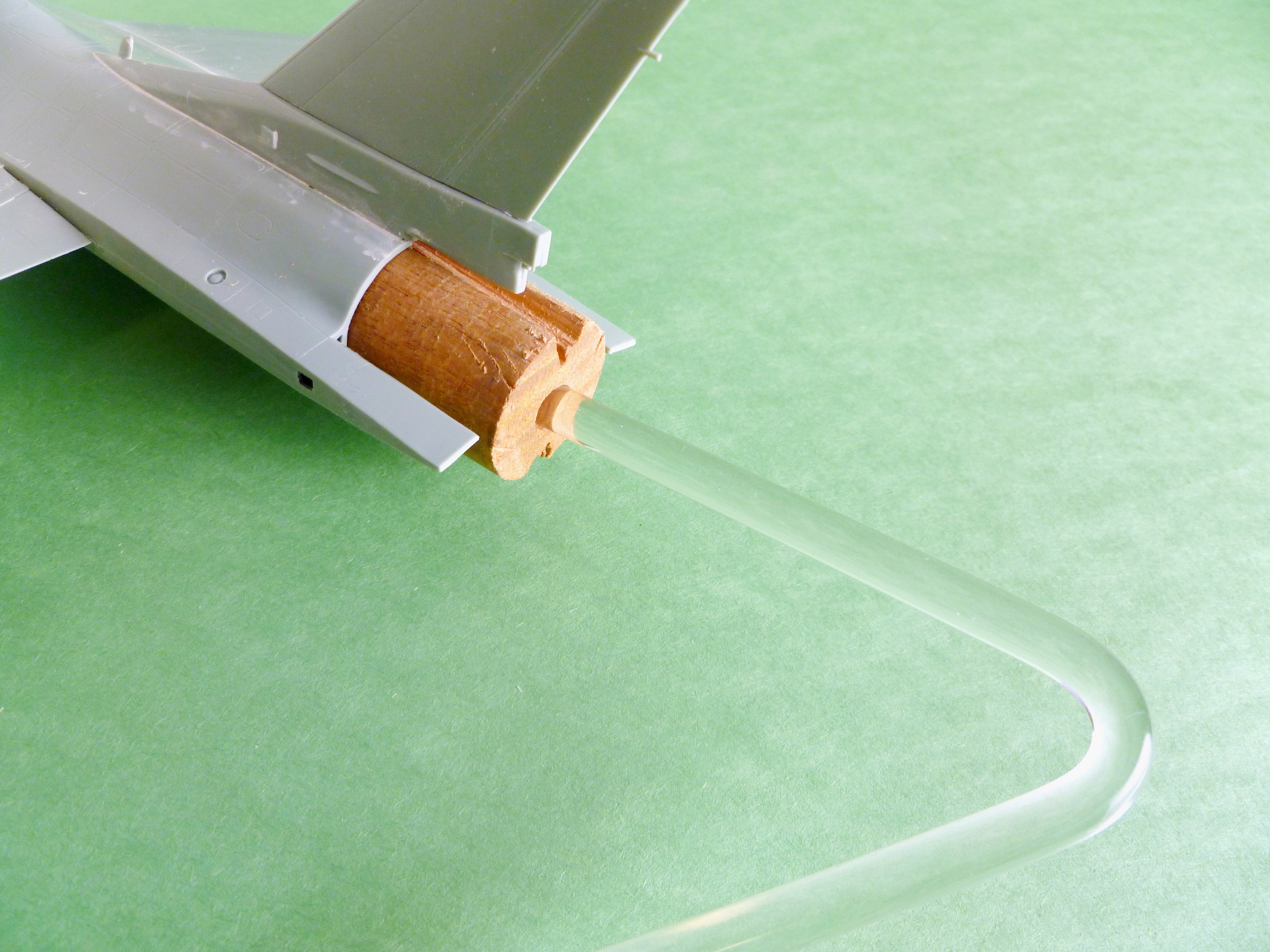

I drilled a hole in the wood plug to receive the rod. It’s a friction fit, so I can remove it from the model for transport. It also made a good grab handle during the decal process.

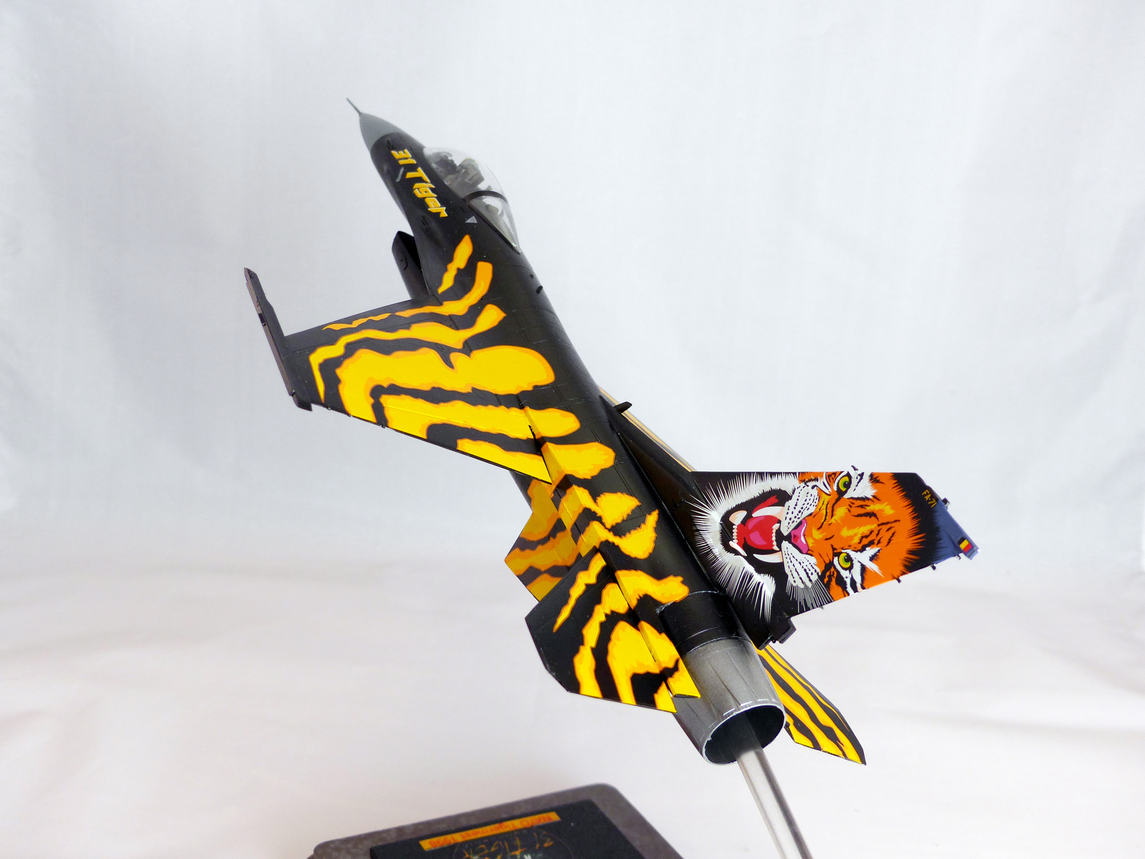

Epoxy holds the other end of the rod in a hole I drilled in a sufficiently weighty wood base. After a coat of Tamiya white primer, I sprayed Testors black gloss acrylic. Each tiger stripe is a separate decal; overall, it took eight hours and a lot of decal solution.
FSMTS0517_06
The finish coat is Microscale satin; a clear gloss would have looked toylike. No need for weathering — these aircraft were kept immaculate during the meet. I sprayed the base with metallic paint, mounted a home-printed 31 Squadron decal on a sheet-styrene placard, and my tiger was ready to pounce!
