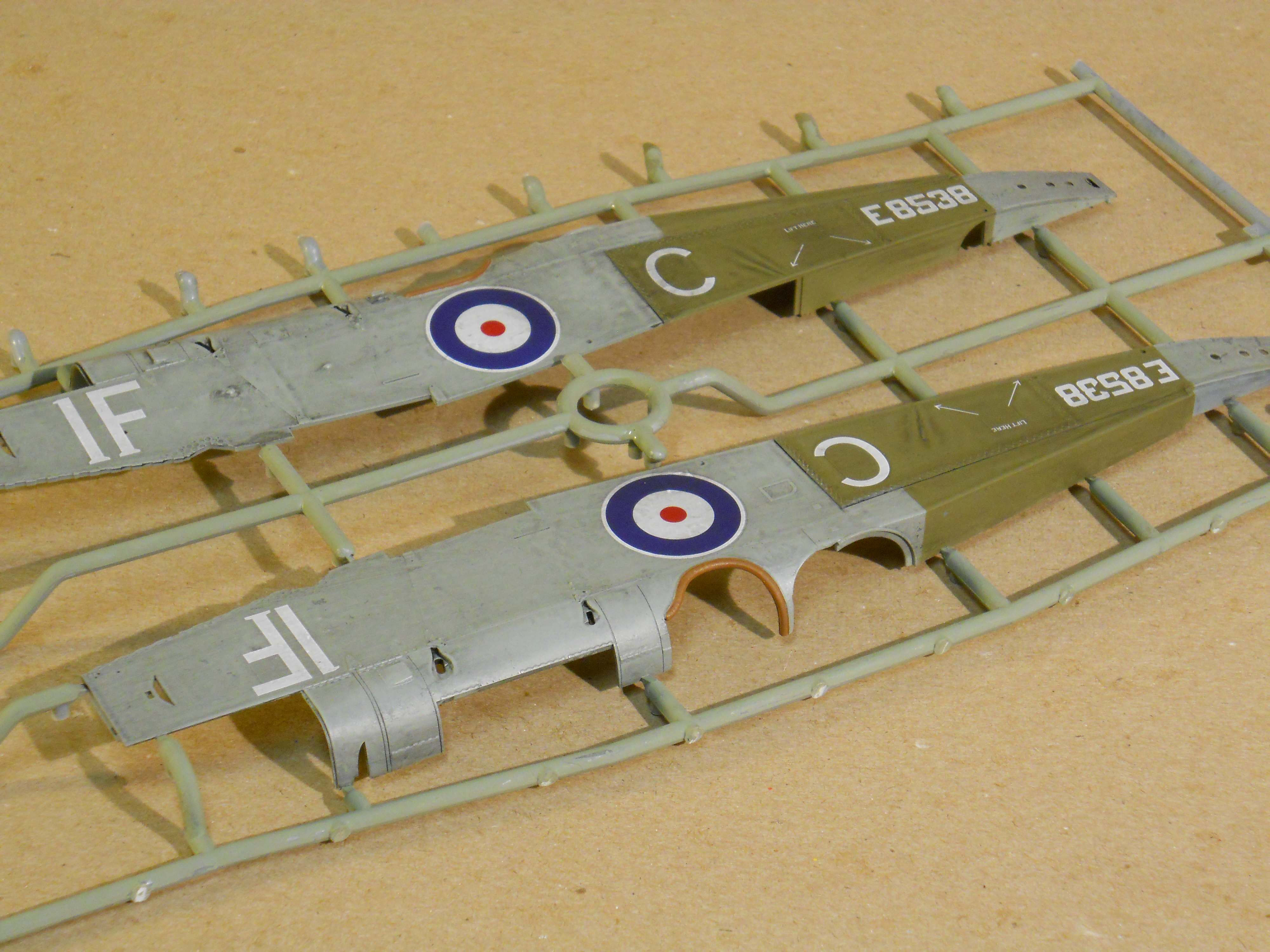

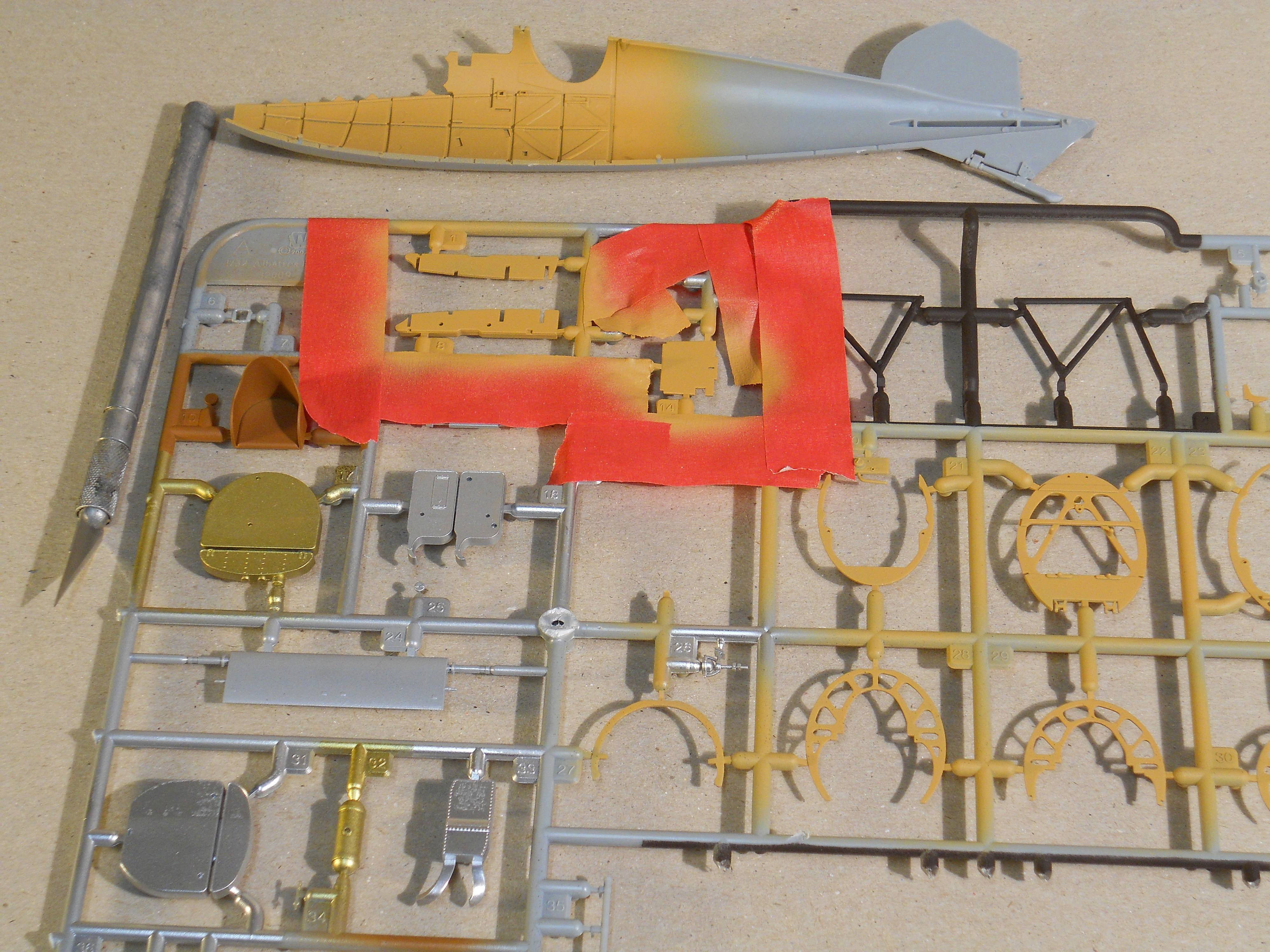

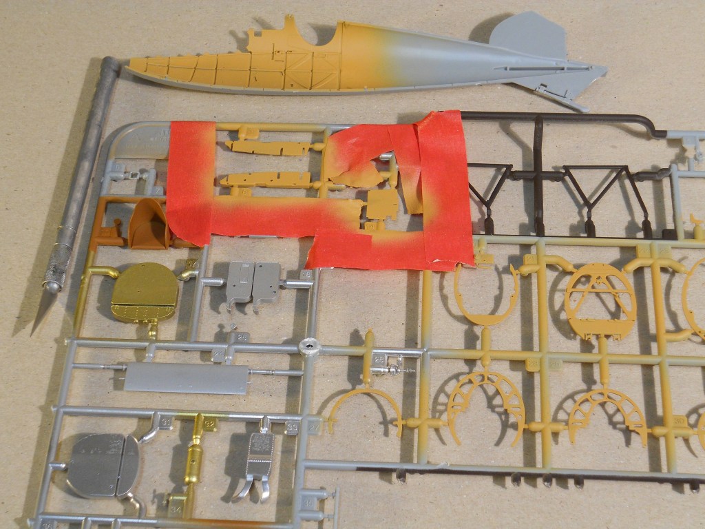

Sprue trees provide the best handle for painting and detailing parts.
I’ll mask off one section at a time, airbrush, remove the tape, and then cut the parts off the tree with clippers or a razor saw. The separation points are easily touched up afterward.
