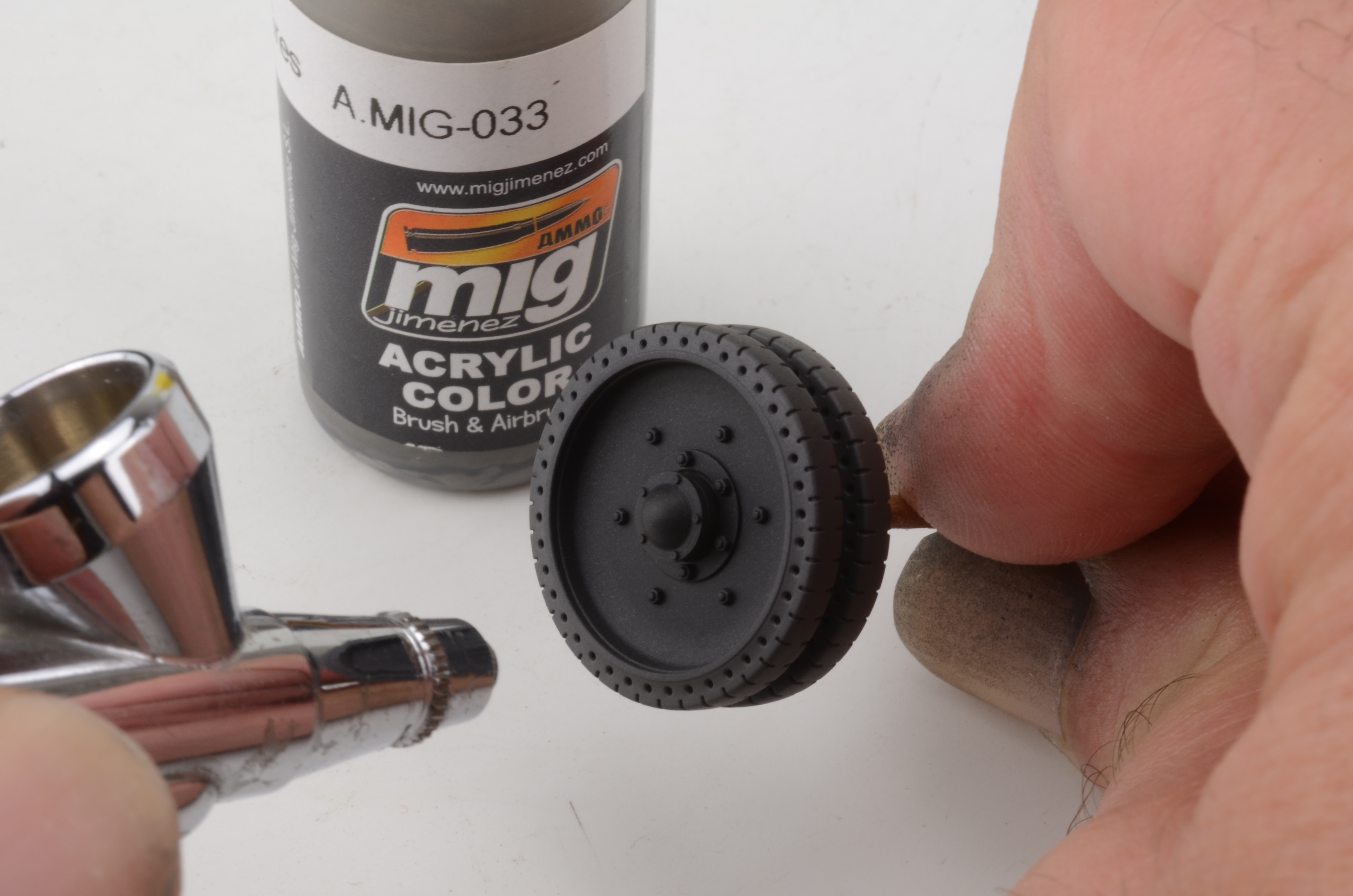

The road wheels were first painted with Ammo by Mig Jimenez rubber. I used Ammo products throughout.

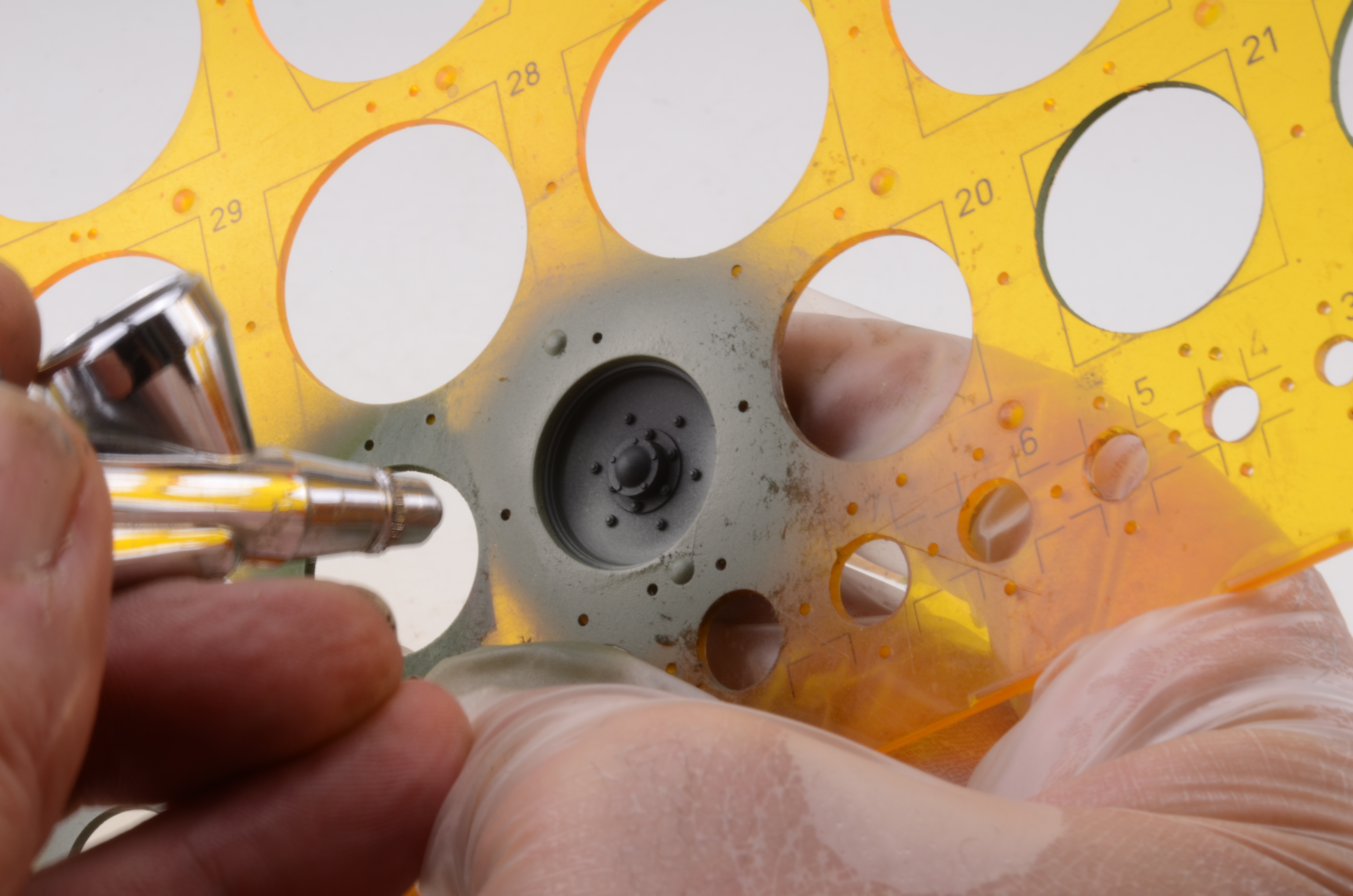

When dry, I masked off the tires using a plastic round template. This type of mask is easy and quick to use and produces sharp-enough lines between the colors.

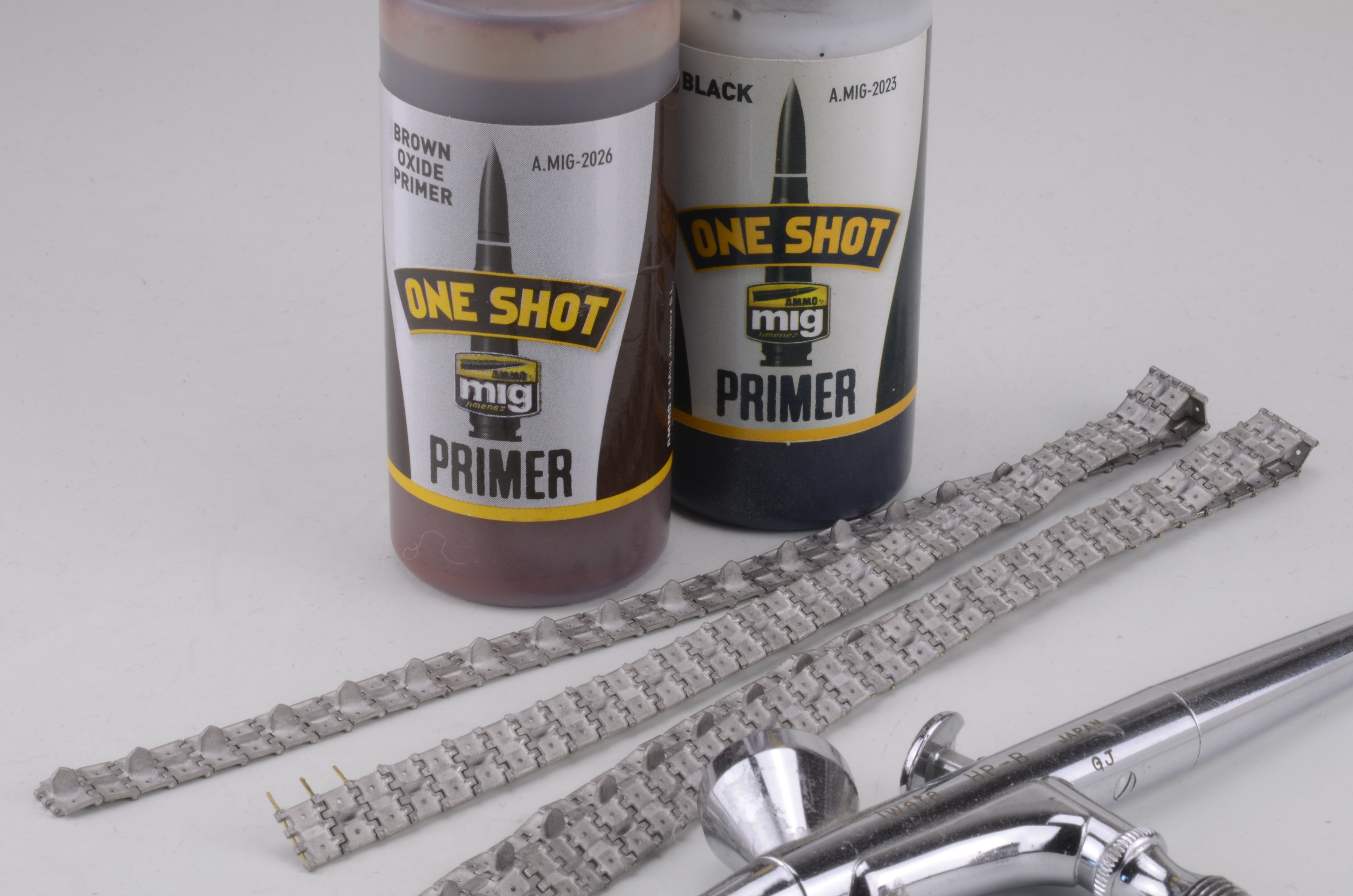

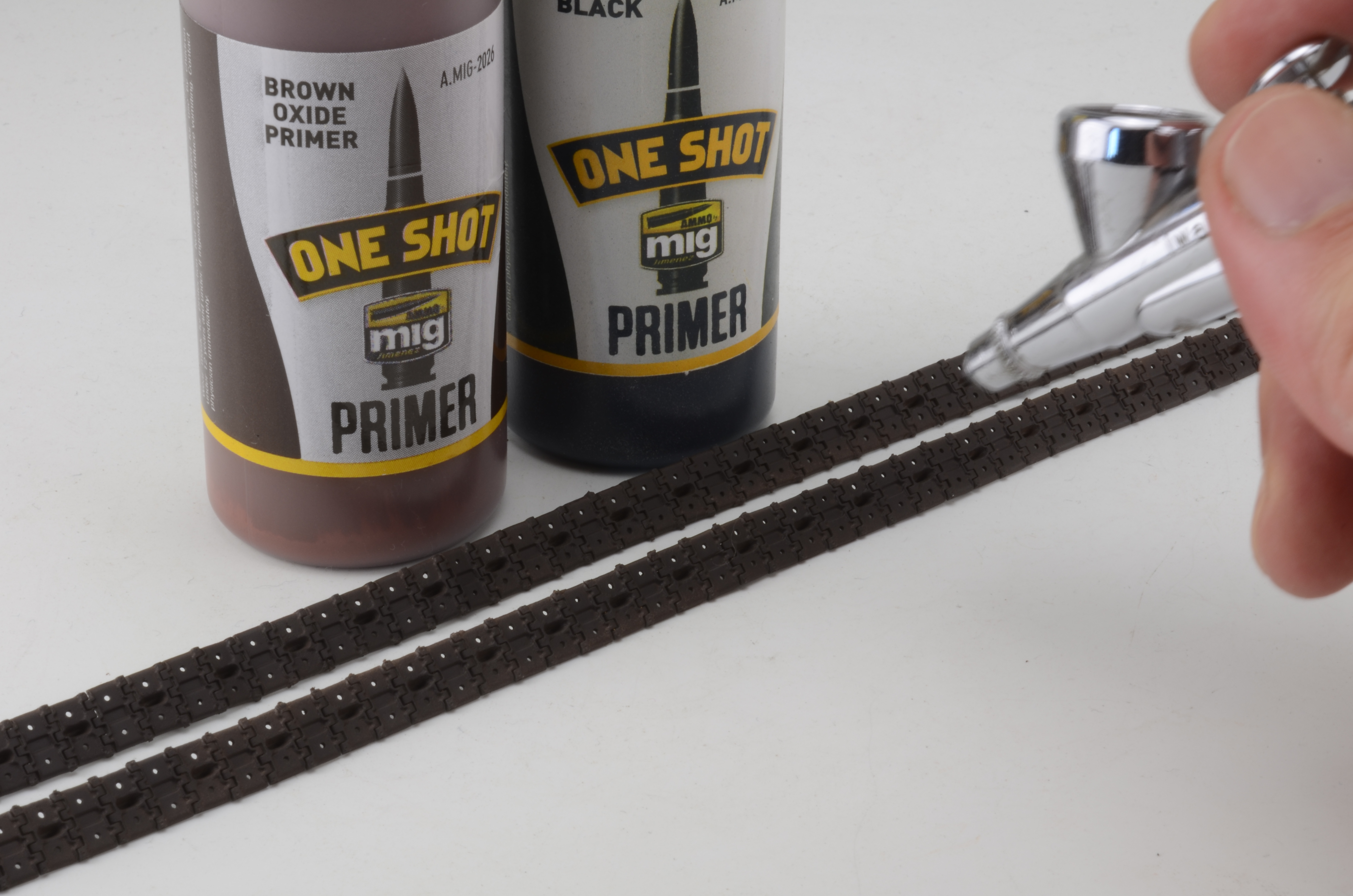

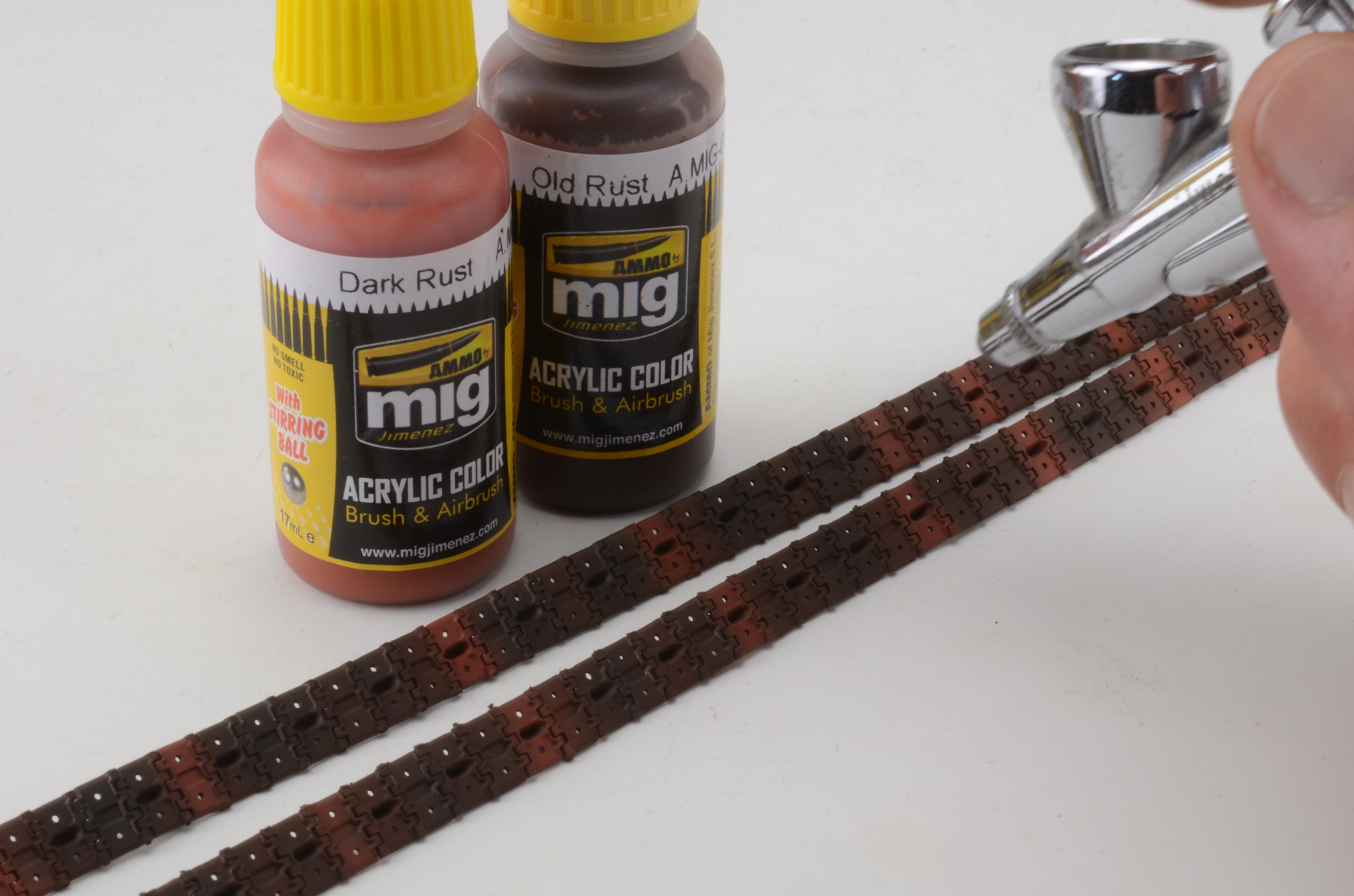

I sprayed them with a dark rust mix of brown and black Ammo One Shot primers.
05WeatheringTamiyaFinnishBT42
After cleaning my airbrush thoroughly, I mixed old rust and dark rust and sprayed this in a random pattern across the entire length of track.
06WeatheringTamiyaFinnishBT42

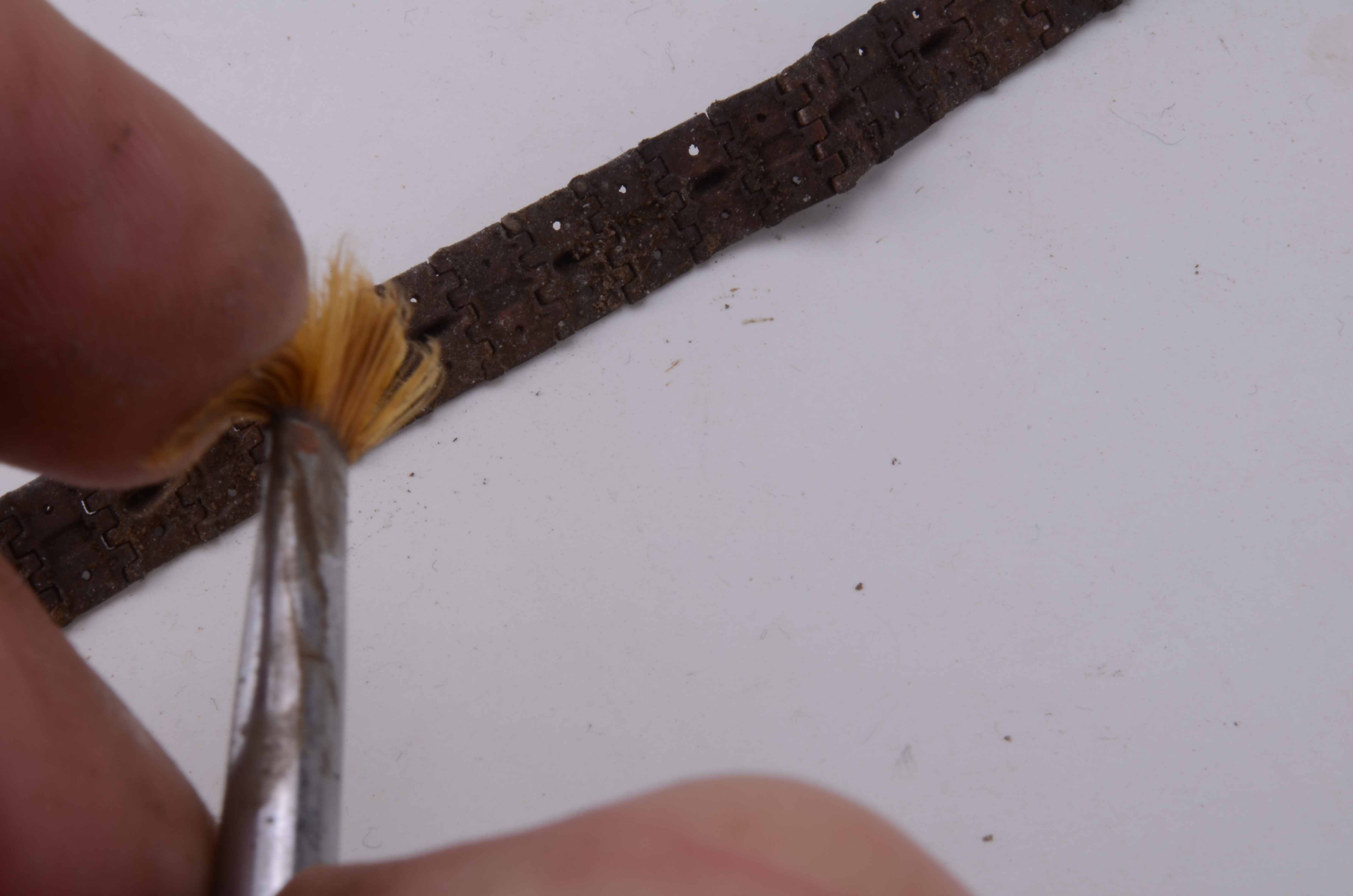

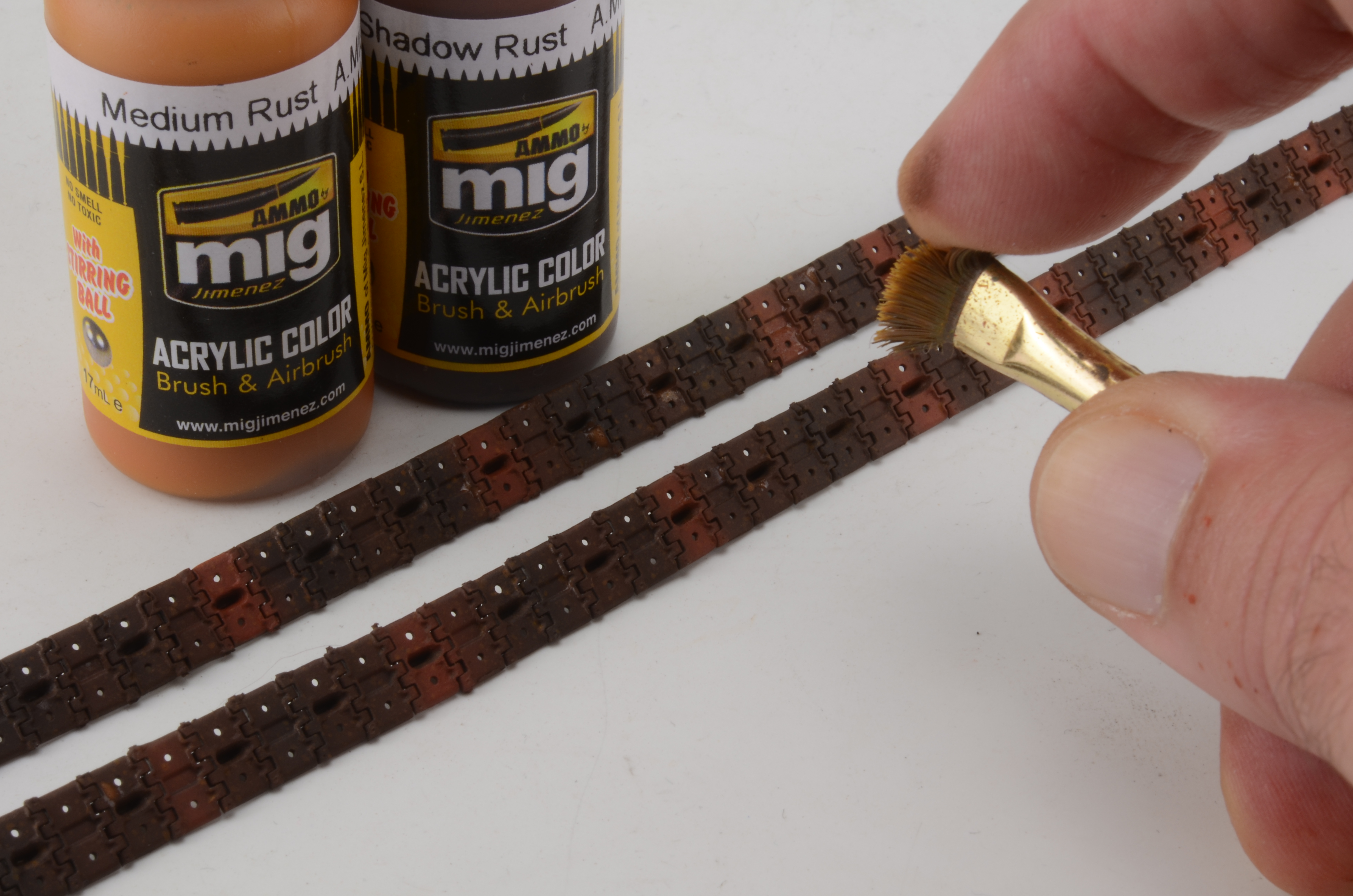

Medium rust and shadow rust on a short-bristled brush were flicked over the tracks by moving my finger through the bristles. This softened the harsh look of the previous painting steps.

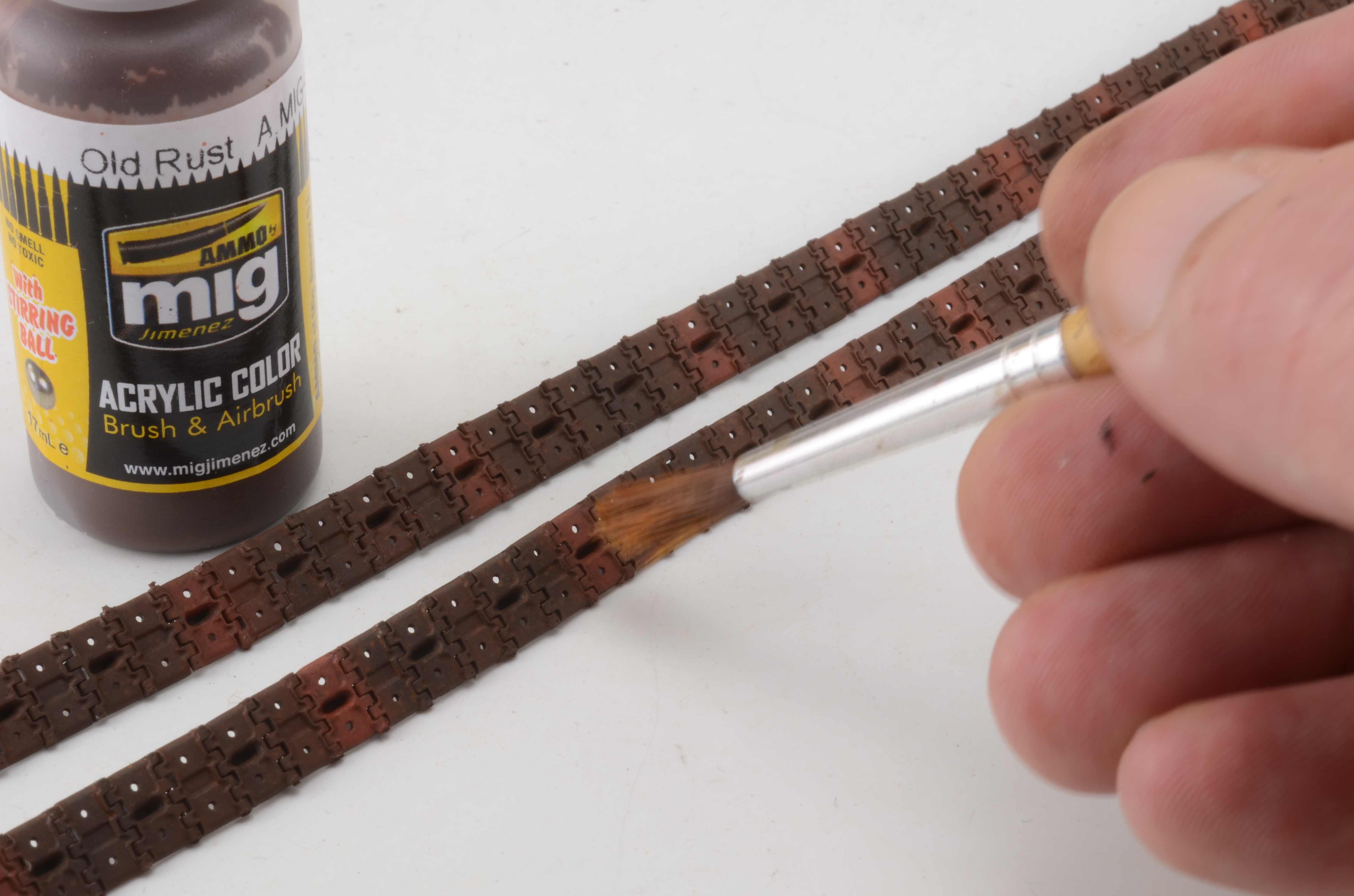

A wash of old rust came next. I diluted the paint 3:1, water to paint.

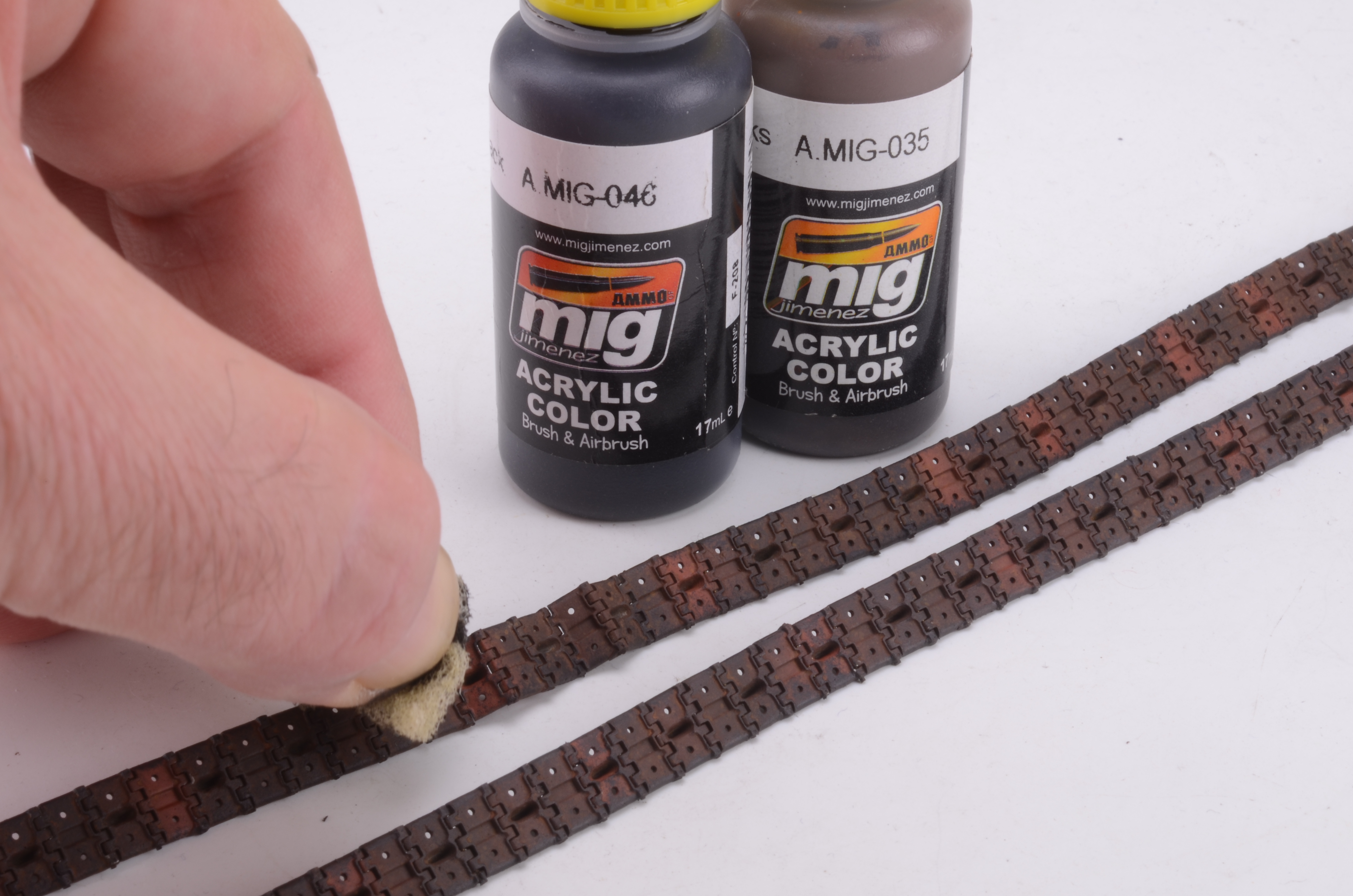

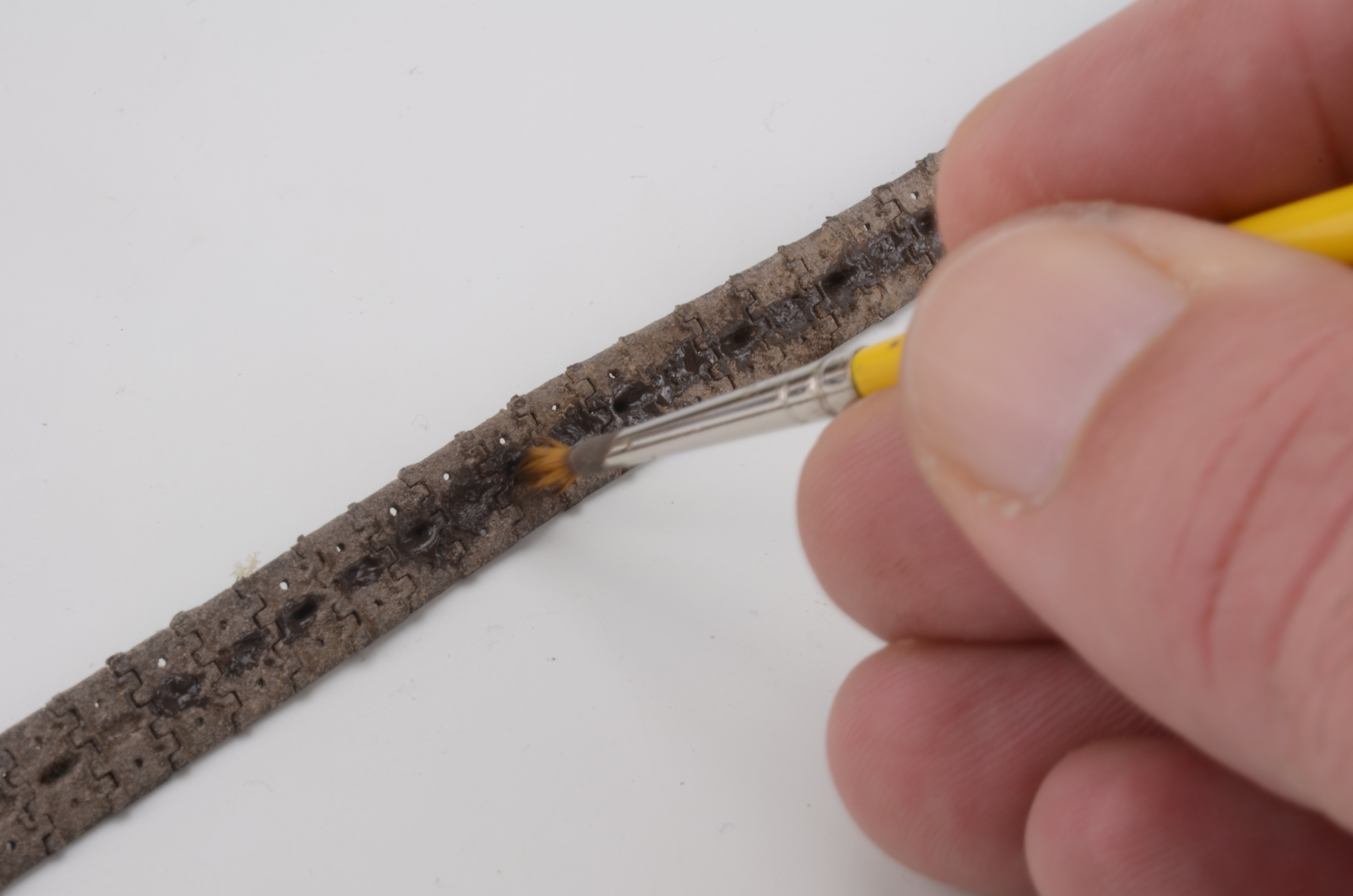

After the wash was dry, all of the raised details were picked up with a small sponge dipped in a dark rust color.

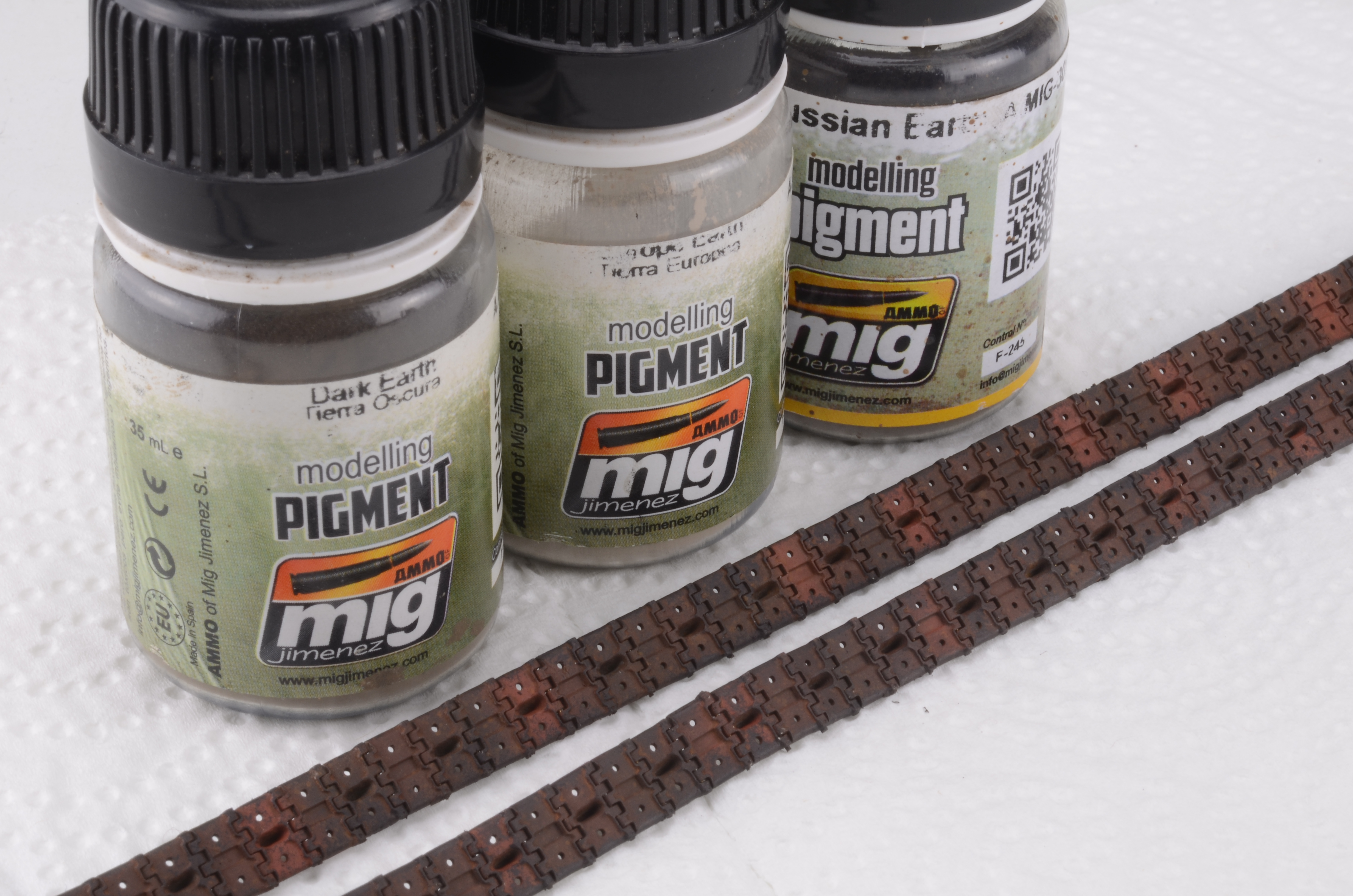

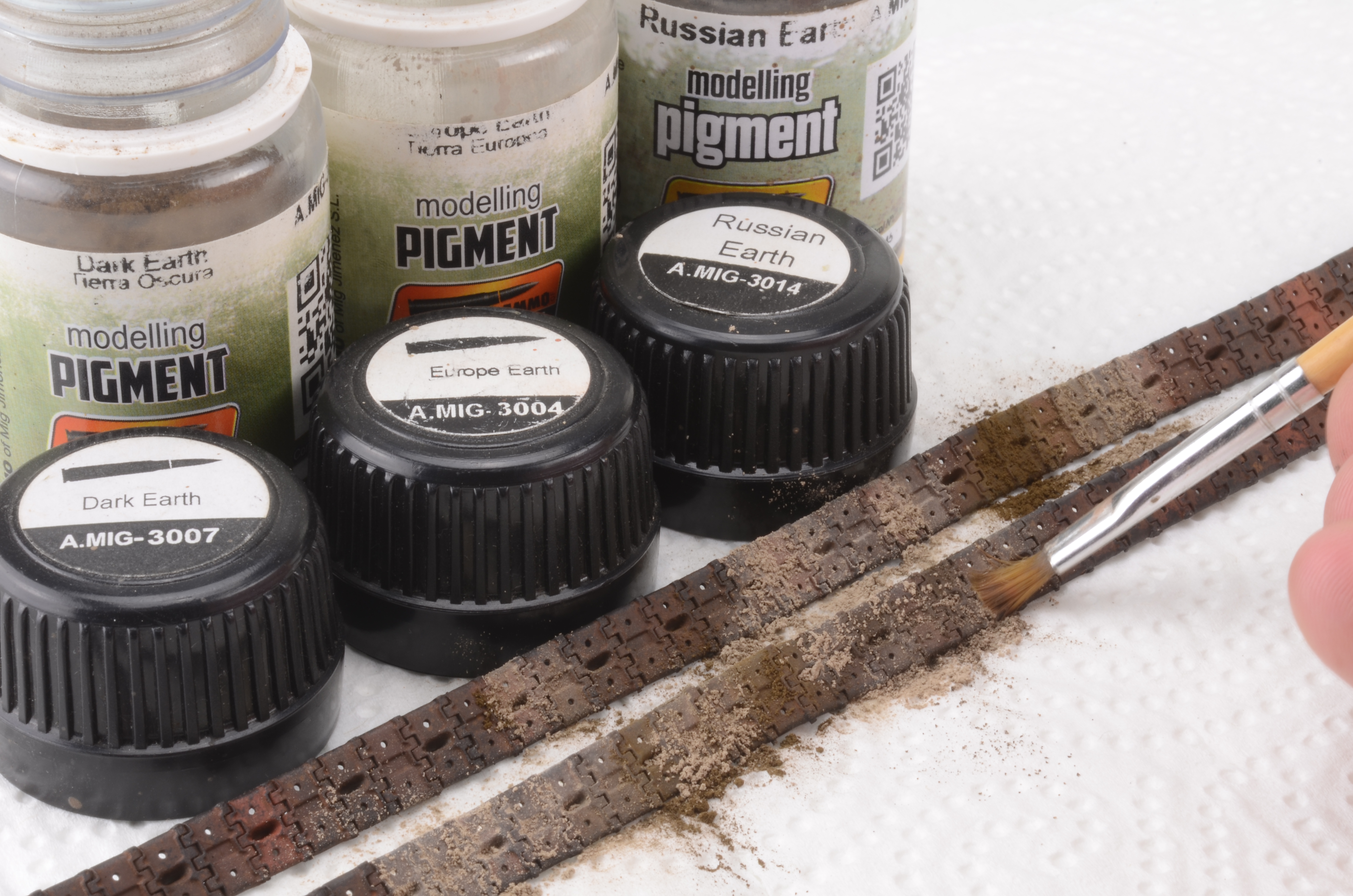

Here are the tracks so far, before I began weathering with three different tones of pigments. I worked with dark earth, European earth, and Russian earth.
10WeatheringTamiyaFinnishBT42
I applied these pigments randomly around track with an old, but still soft brush. While I did work them in, I did not blend the three colors together completely.
11WeatheringTamiyaFinnishBT42

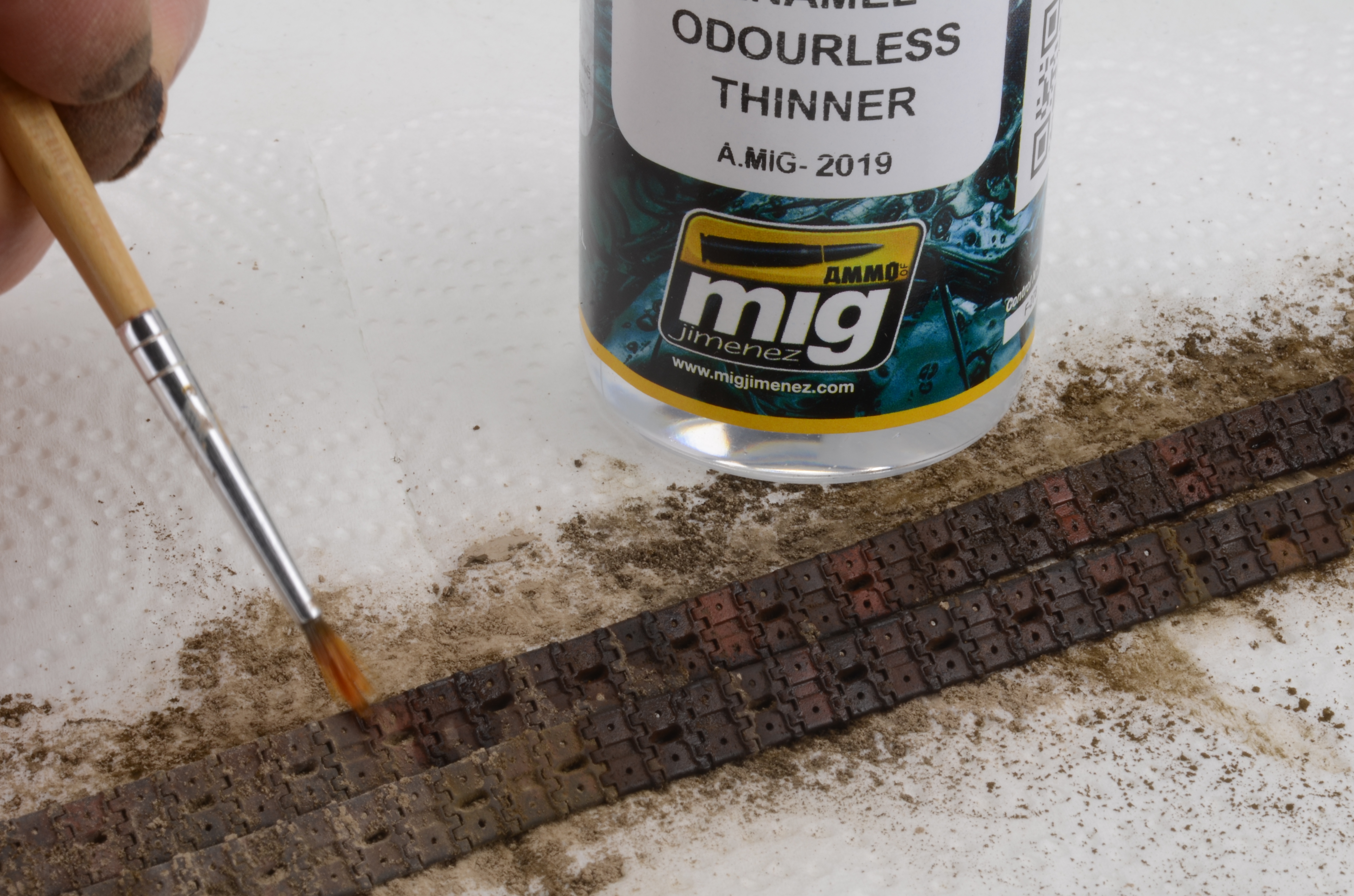

Enamel thinner fixed the loose pigments in place. I let drops of thinner fall from my brush to avoid touching and moving the pigments. I then let them dry.

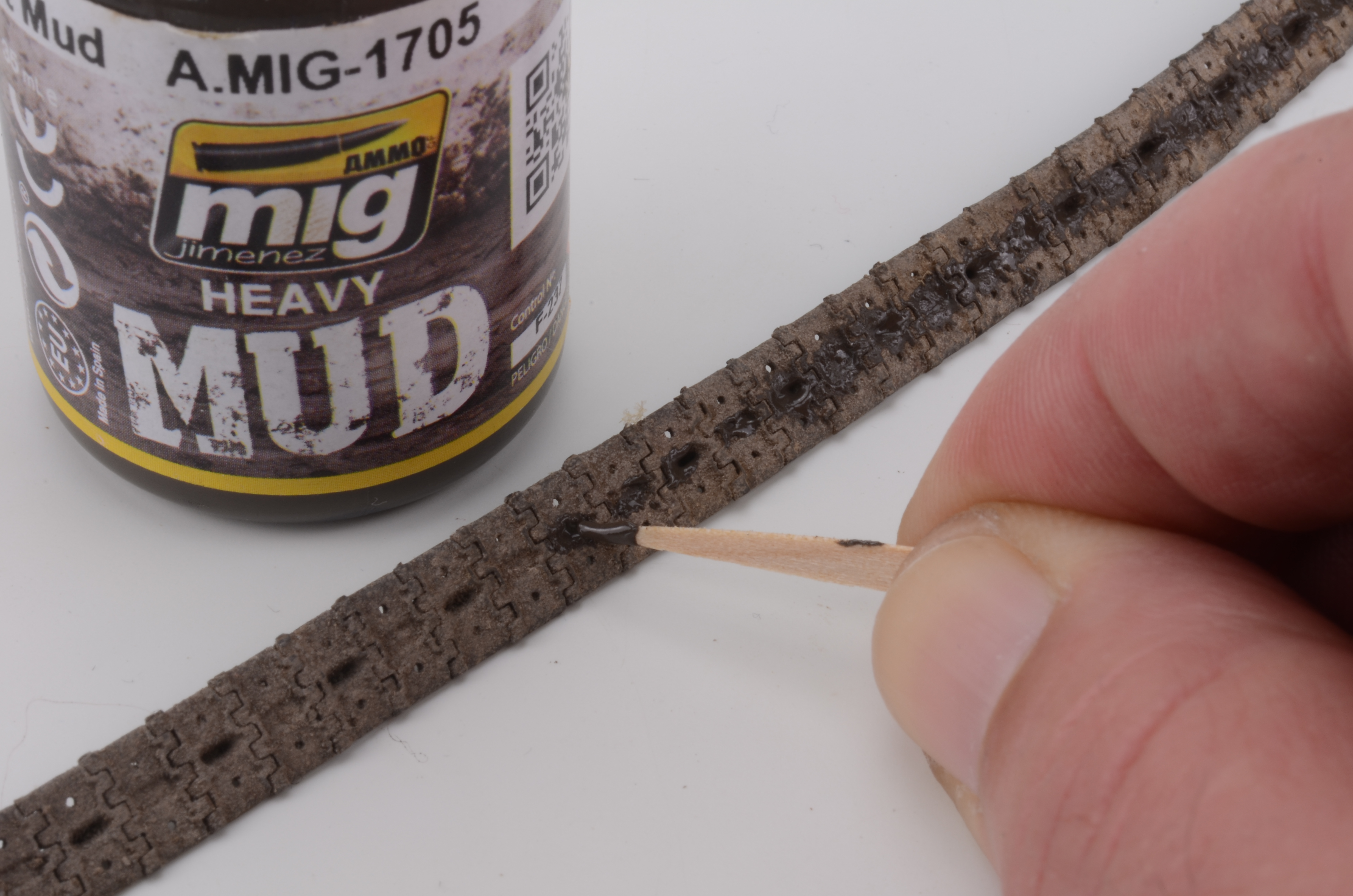

A small spatula or toothpick helped apply wet mud down the centerline of the tracks.

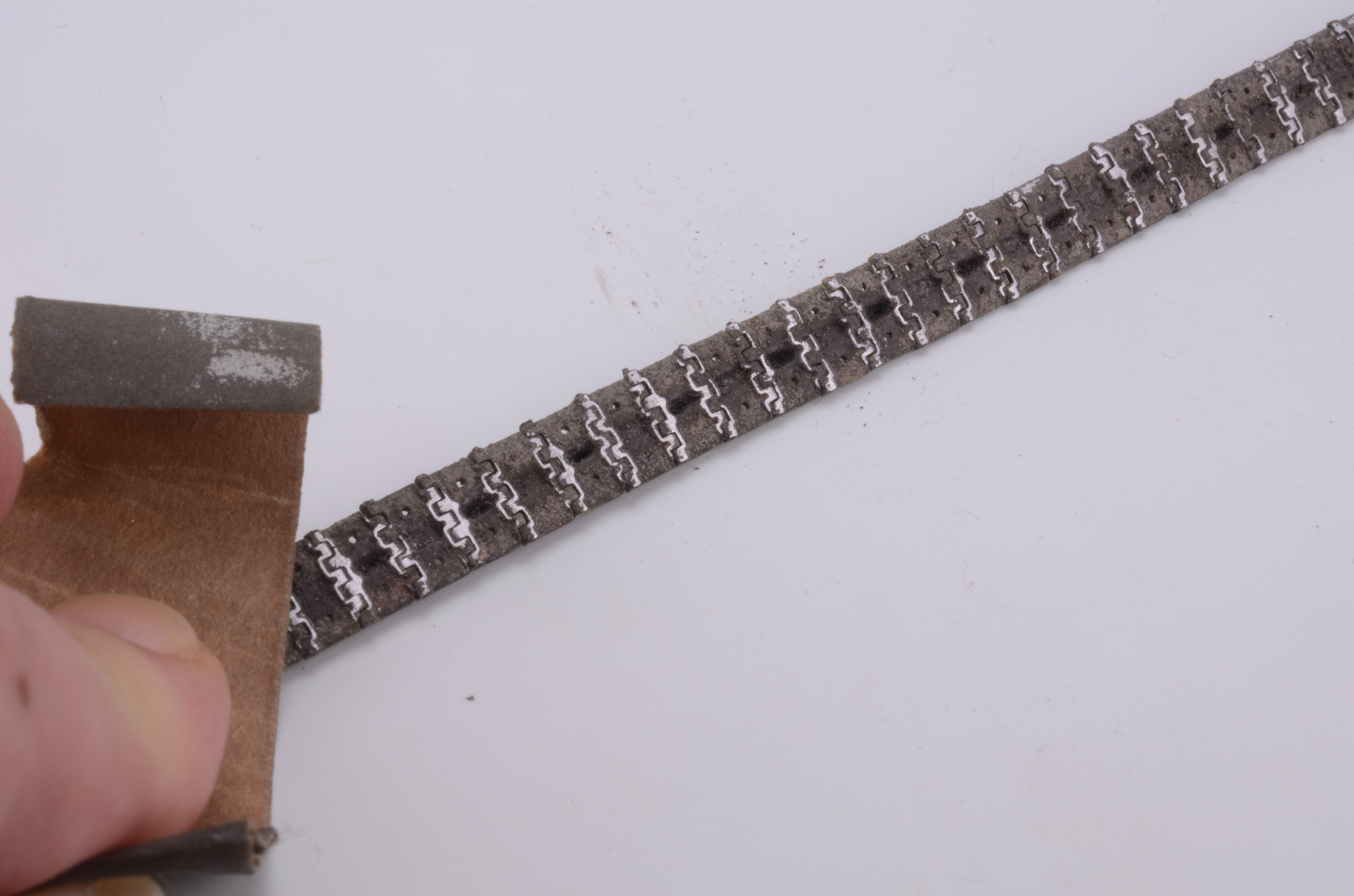

Even with the mud and dirt, the raised areas on the tracks and where the wheels hit would still gleam metallic. To bring this out, I sanded the raised areas with sandpaper. The natural white-metal now shines through. The tracks and wheels were now ready to be attached.
