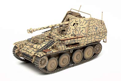

I like to build as much of a model as I can before painting, but open-top vehicles present special challenges. I added as many of the details as I could, but left off the running gear and most of the tools so they could be painted off the vehicle.
The fighting compartment comprises several complex panels, but each fits tightly. I left off most major details to make the fighting compartment easier to paint. Tamiya provides a few ammunition rounds (and a few spent casings), but they don't fit in the ammo racks. You could pare down the shells and fill a few of the spaces with ammo, but I left mine empty.
The gun assembly went smoothly. I left off the shield for easier painting. I rolled the photoetched steel muffler guard around brass tubing to shape it. Tamiya's steel is harder to shape than brass, but it is less prone to distortion. The shaped guard was attached to the muffler with the fine enameled wire provided.
With the major subassemblies built, I sprayed the vehicle with a mixture of Tamiya's dark yellow, desert yellow, and white. I've airbrushed several camouflage schemes on German armor lately, so this time I brushed on a field-applied scheme. I tack-glued the forward gun shields (E3 and E7) in place with spots of super glue; they must be removed to install the gun, but I wanted them in place while applying the camouflage.
I carefully brushed the irregular rectangular scale-like pattern on the lower hull, using Tamiya's dark green lightened with a little white. The pattern on the upper shields was small crescents. When the paint was dry, I applied the decals over a brushed-on coat of Future floor polish and treated them with Solvaset. A coat of Polly Scale clear flat blended the decals into the paint.
Adding the detail parts to the fighting compartment after painting was a bit trickier than I had expected, but with careful use of tweezers I eventually had them all glued in place. The model was given a wash of a mixture of burnt umber and black oil paints, then dry-brushed with the base yellow lightened with white.
The forward armor panels were popped off and the gun installed in its mount. Finally, I added the tracks and running gear to the hull. One track had two attachment links broken from one end, but the damage was easy to repair because the tracks are the type that can be joined with glue.
The finished model matches the dimensions in the Encyclopedia of German Tanks of World War Two by Peter Chamberlain and Hilary Doyle. Photos of many of the vehicles specified on the decal sheet can be found in Squadron/ Signal's PzKpfw 38(t) in Action.
The Marder project took 24 hours - a little longer than a usual armor kit because of the complexity of the open top and the camouflage. Although nothing was particularly difficult, I recommend this for modelers with at least some experience. Once again, Tamiya has provided a great kit of an interesting vehicle. Now that Tamiya has kitted the M chassis, I'm hoping we will see a Flakpanzer 38(t) Ausf M, or maybe a Grille.
