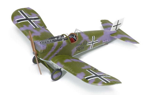

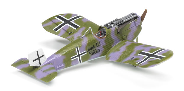

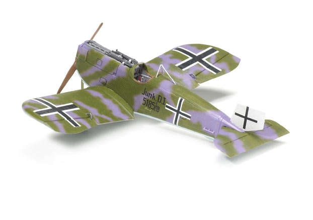

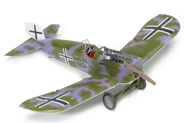

Perhaps the most difficult assembly occurs in Step 3, where the seat back (Part 20A) must be bent around and attached to the seat bottom (Part 6A). I placed the seat bottom on cellophane and, after bending the seat back around a hobby-knife handle, super glued the back to the bottom. The glue ran all over but did not stick to the cellophane, which I pulled free after the glue was set.
In Step 5, pay special attention to aligning the engine mounts (parts 3C), cockpit floor (1A), gun-mount base (7A), and the two forward bulkheads (parts 4C and 4A). These parts need to line up with grooves inside the fuselage (parts 1C and 19C) in Step 10; I glued them too early and had problems installing the gun and ammo canisters in Step 8.
All control surfaces are poseable, and the upper and lower wing panels fit perfectly. However, the corrugations on the wing don't line up with those on the ailerons. I used a bit of glazing compound filler along the seams of the aft fuselage deck (Part 16C) and the fuselage sides.
After assembling the plane and mounting the main landing gear parts, I added stretched-sprue wire bracing and painted with Testors Model Master enamels. Box art and my reference indicate the green in the instructions may be too dark. Period descriptions suggest "pale green" or "forest green." I used Model Master forest green.
Repeated applications of Micro Sol and Solvaset failed to make the decals conform to the model's surfaces. I pressed the decals into the corrugations with both soft cloth and paintbrush bristles, but they still managed to lift. The national insignia decals match the box-cover aircraft but are too small for No. 5185/18. On my plane, I'll replace them by masking and painting new markings.
The model is close to scale and looks right according to Windsock Datafile 33: Junkers D.1, by Peter M. Grosz. Edges look scale thin, and the printed windshield is as good as it gets.
