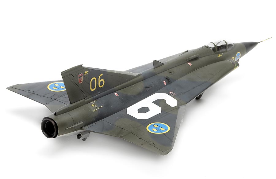

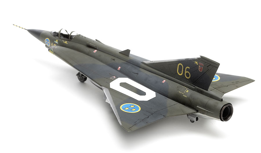

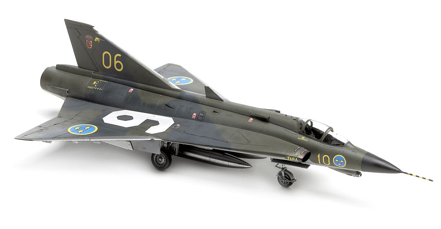

Construction was straightforward. I used the decals for the cockpit; they settled well over the detail with help from Micro Sol. The four-part ejection seat is installed at the end of the build.
Major components went together well. However the leading-edge inserts (optional parts are provided for a cannon-armed version) were too narrow; I needed filler to blend them well. There was a small gap at the join between the tail and the spine, as well as where the tail cone meets the fuselage.
Watch as you go: You need to add nose ballast and open holes for weapon pylons.
With the airframe cleaned up and primed, I painted the neutral gray underside, masked, then sprayed the upper surfaces green. The instructions call for olive drab (1). After looking at photos on www. airliners.net, I decided a darker color was more appropriate. I settled on Gunze Sangyo RAF dark green.
(In the photos I looked at, no two Drakens were the same, and it appears the the colors faded a lot. I recommend looking at references before painting.)
I used midnight blue for the second color, and airbrushed the soft-edged camo freehand. The natural-metal leading edges, belly, and fuel tanks were painted with Alclad II polished aluminum. I masked the canopy with a precut set from Eduard (No. EX249). The clear parts are thin and distortion-free, but the hinges are extremely fragile - I lost two of the three during construction.
The complex landing gear is fiddly but strong and well detailed.
The model captures the stance and look of the Draken perfectly. I spent about 20 hours on my Saab, much of it masking and painting.
