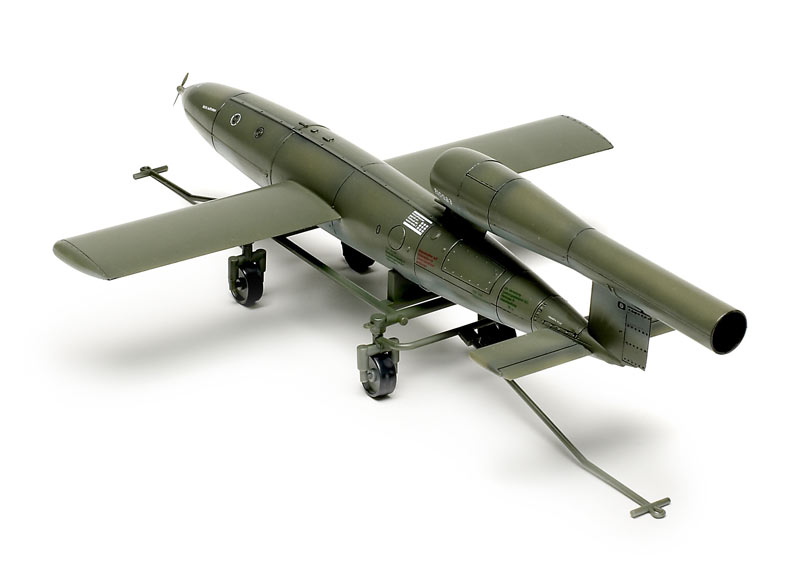

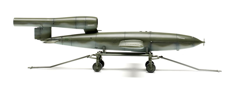

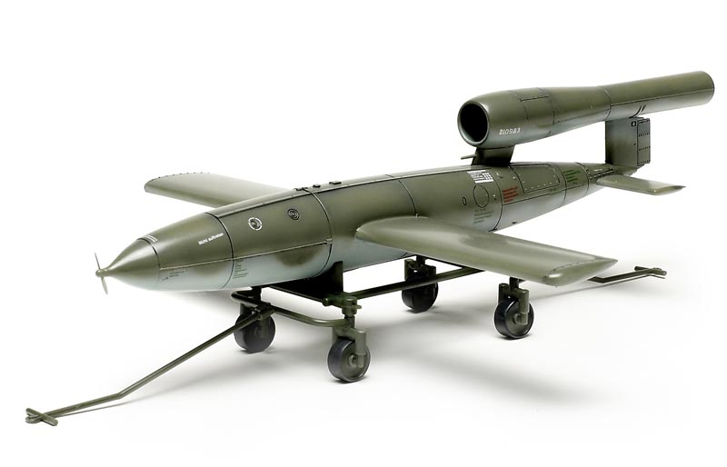

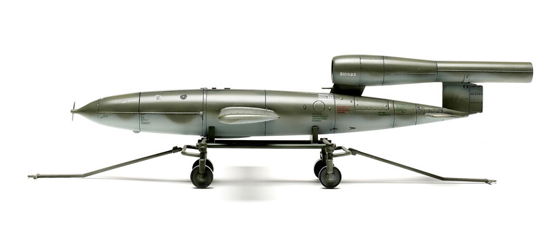

The fuselage halves didn't line up correctly, but I simply cut off the locating tabs and glued the halves together with no problem. Wings and tail stabilizer fit fine, though I added a touch of filler to the wing roots and sanded them smooth to ensure a smooth fit.
Paint the engine intake's screen (Part A6) steel before installing the intake cover. This makes painting easier later on. I would also wait until the very end of the build to add the prop on the tip of the warhead - it's a tiny, delicate, and fragile part.
I painted my V-1 Testors Model Master Acryl hellblau (RLM 65) and dunkelgrun (RLM 71). Decals went on with little difficulty - Micro Sol solved a slight silvering.
Keeping in mind that V-1's flew only once, I skipped weathering and merely added a dark wash to define recessed details.
The inclusion of a cart for the weapon was a pleasant surprise. Again, it was an easy and straightforward build. However, the instructions give no hints on color; I painted it Testors Model Master Acryl olivgrun (RLM 80). The completed V-1 fits perfectly on the cart.
