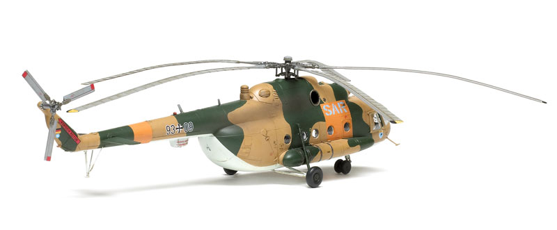

Based on photos, I painted the interior a combination of Russian interior blue/green and light gray. Building the cockpit and cabin structure seemed awkward at first, but the assembly fit perfectly when I sandwiched it between the fuselage halves. Take time to align the floor and ceiling with the lines engraved in the cabin halves and you shouldn't have any trouble.
The only fit problem I had was the oil cooler intake (Part B12). It was too small, requiring sanding to blend it into the body.

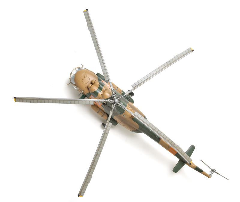

The windscreen went on well, needing just a little super glue around the bottom to fit perfectly. I glued the rotors together. There is no droop in the main blades, so I placed the rotors upside down on a plate and heated both the plate and blades with a hairdryer. This worked well, but be careful not to overheat the blades - they are thin and easily distorted.

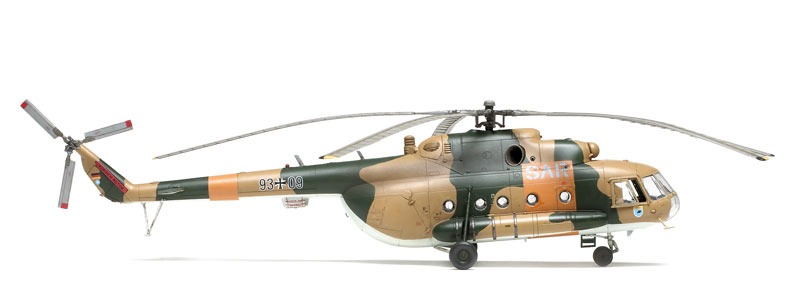

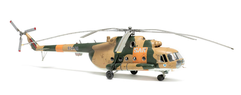

I masked the windows and airbrushed the German Mi-8's three-color camouflage with Gunze Sangyo and Tamiya acrylics. The decals are thin, opaque, and settle in with a little Micro Sol. An artist's oil wash brought the fine panel lines to life.
Final assembly went quickly. The finished model looks like a Hip, including the correct butt-down stance, and it measures closely to published dimensions. The kit includes an IR jammer molded behind the engines, a detail I couldn't find on any of the German Mi-8s I saw. Also included are filters on the intakes, another piece of equipment not used on German helicopters. There is no provision for the weapons pylons commonly found on Hip-Cs, but a couple of unused parts are add-on cockpit armor used on some Mi-8s and Mi-17s.
