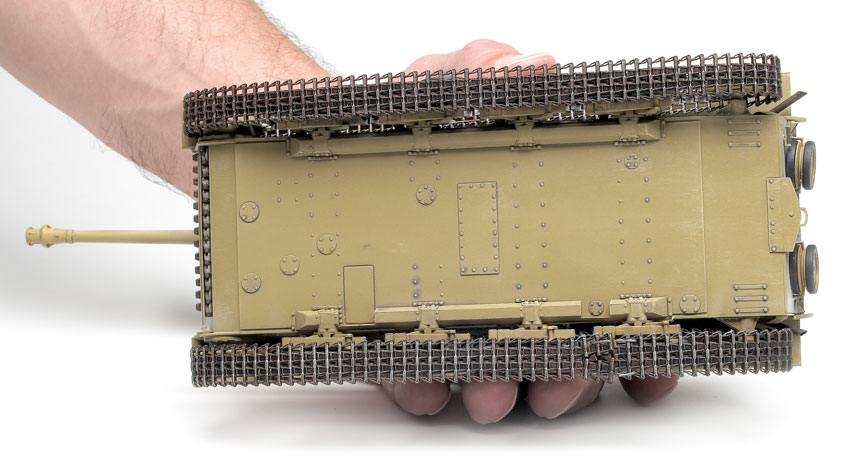

The fit of the drive sprockets was poor due to imperfections where the halves meet, leaving gaps that needed filler. The tires for the road wheels are separate with the tire company logo printed on the outer surface. I left these off for ease of painting. The suspension is movable if you’re careful gluing the parts together. (They are very fragile.) I broke two of the suspension units handling the kit during construction and painting. The tracks are one-piece vinyl that are supposed to be glued together. Both of mine broke at the glue joint and had to be stapled together. (Consider a set of aftermarket tracks.) A set of individual track links is included for the spare tracks, but there are no assembly instructions for them.

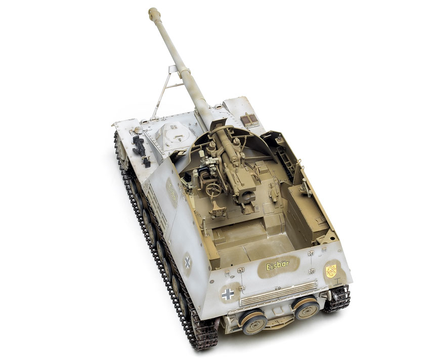

AFV Club gives you the option of assembling the ammo lockers open or closed; same goes for the tool locker. In Step 25, the photoetched-metal gun racks are misnumbered. (They should be O17.) I left the rear panel (Part A5) off until after painting the interior. The directions do not show how to fold the photoetched-metal stowage rack (Part O11); a photoetched-metal bending tool is a must to make the complex folds. In Step 27, the antenna mount should be numbered D37 and the antenna should be numbered D27.
I left the gun-barrel assembly off the carriage to make painting easier. Do not glue the elevation gear (Part E36) if you want the gun to move up and down. Glue Part D29 to Part D28, but leave it free to rotate around the barrel. This will allow you to align the gun barrel with the travel lock when the gun is installed.

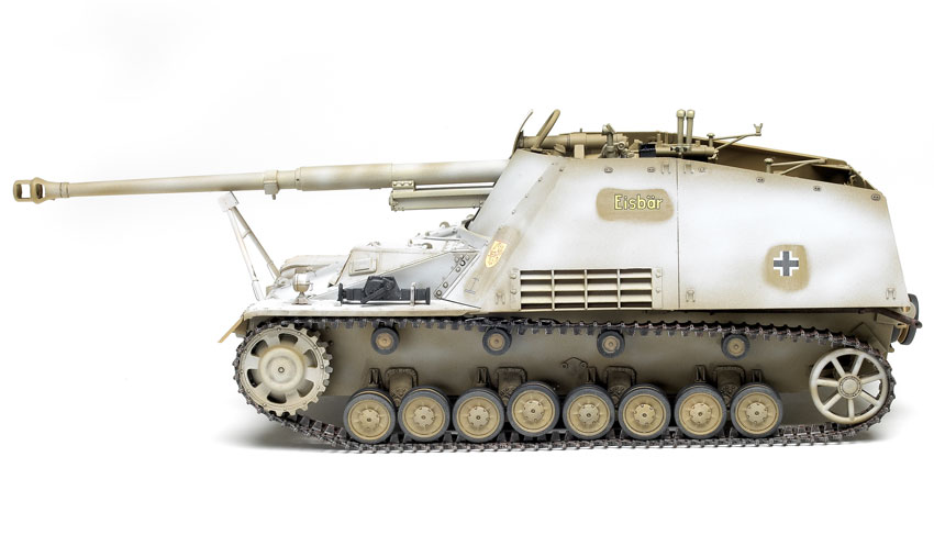

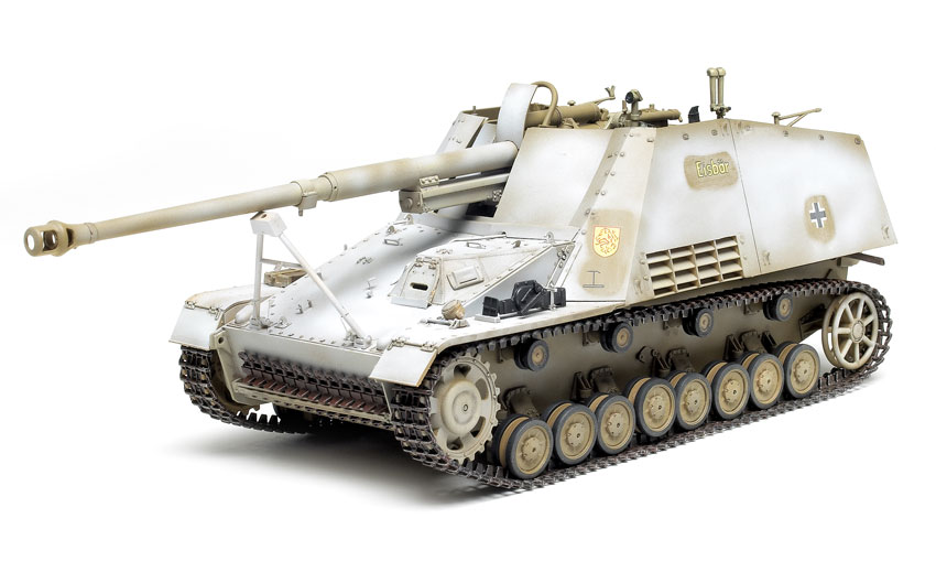

Five marking options are included. Option E is mislabeled as being part of sHPzAbt 88; the markings are for a vehicle of sHPzJgAbt 519, and this is the vehicle I chose to model. I painted the model Tamiya dark yellow. The decals are very thin but are strong enough to be moved around for proper placement, and there was no silvering after they were dry. After applying several coats of Dullcote, I used Silly Putty to mask off the markings. I dusted the upper hull with DOA white to replicate a winter whitewash. Mig washes, dry-brushing, and MMP powders finished off the weathering.
The finished kit’s high degree of detail shows what AFV Club put into the engineering of this model. It took 40 hours to assemble. Two sources that come in handy are Allied-Axis: The Photo Journal of the Second World War, Issue 16 (quarterly magazine from Ampersand Publishing) and Nuts & Bolts Vol. 14: Nashorn (by Tony Greenland and Detlev Terlisten; no ISBN). They both include pictures of the interior, and the Nuts & Bolts book has a detailed history and plans.
