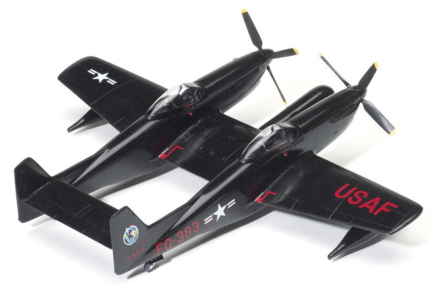

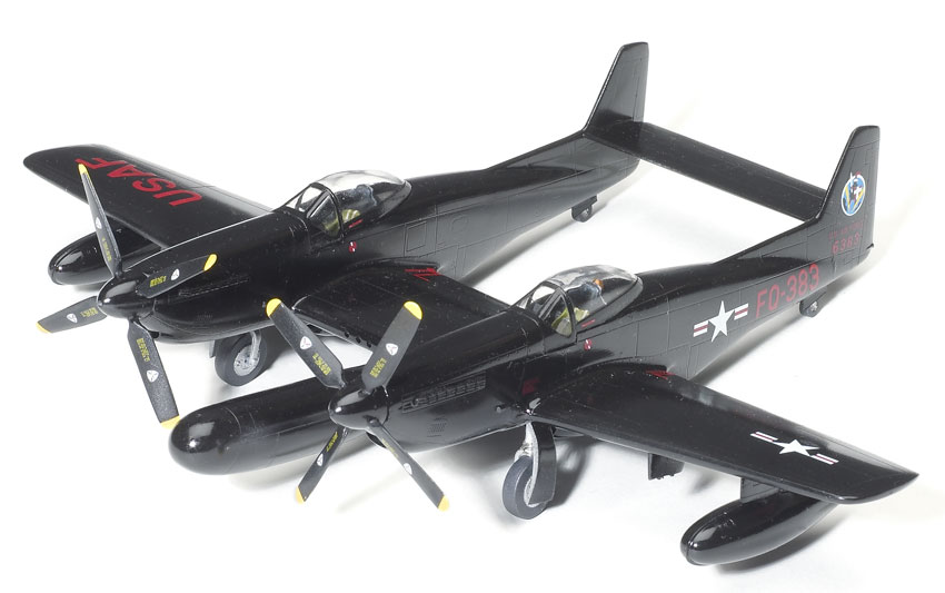

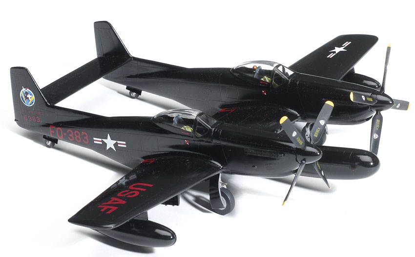

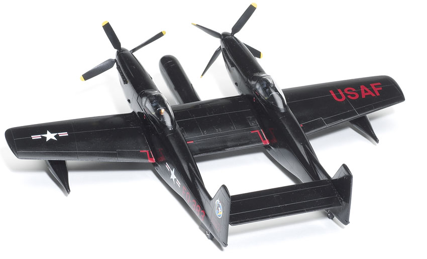

The finished model looks menacing in its gloss black night-fighter scheme, but some of its dimensions are off. The oversize props and undersize radome are part of the problem. The tail fins are undersize, too, most noticeably where the stabilizer’s leading edge fits right into the “elbow” of the fins’ leading edges. The noses of the fuselages look right, though. Consulting photos, the underwing tanks look about right but the noses appear too blunt.
