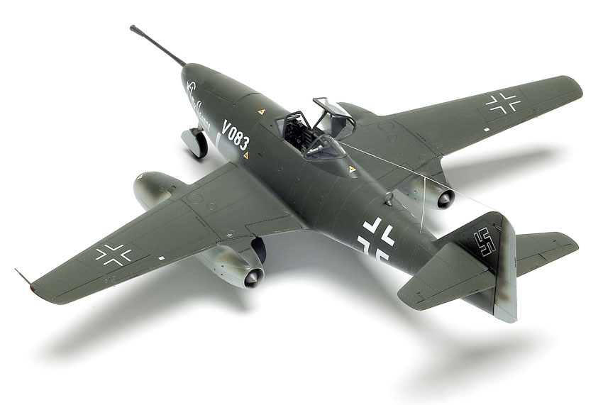

The decal sheet includes swastikas, the instrument panel, and side panels in the cockpit. Considering the big bubble canopy, it is a shame no seat harnesses were included. (I added photoetched-metal parts from my spares box.)
Parts are cleanly molded and nearly free of mold lines and flash, the engraved panel lines are consistent, and the detail is good. Optional parts include a metal or plastic nose-gear well and two styles of nose wheels; I installed the metal well, which helps keep all three wheels on the ground.

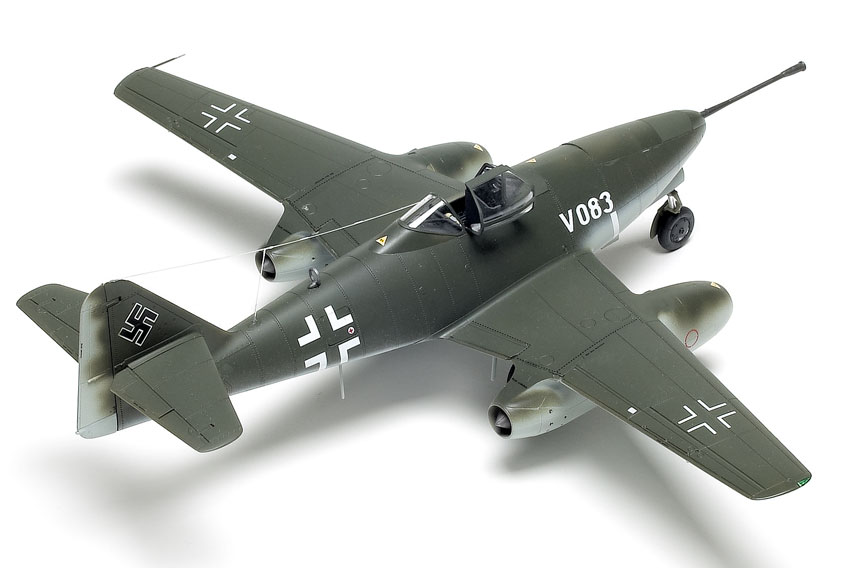

The instrument and side console decals required several applications of Micro Sol to settle them over the parts’ raised detail. The finished cockpit, gun tray, and rear fuselage equipment made the fuselage halves a very tight fit. I used rubber bands, bar clamps, alligator clamps, and lots of solvent to join the halves.

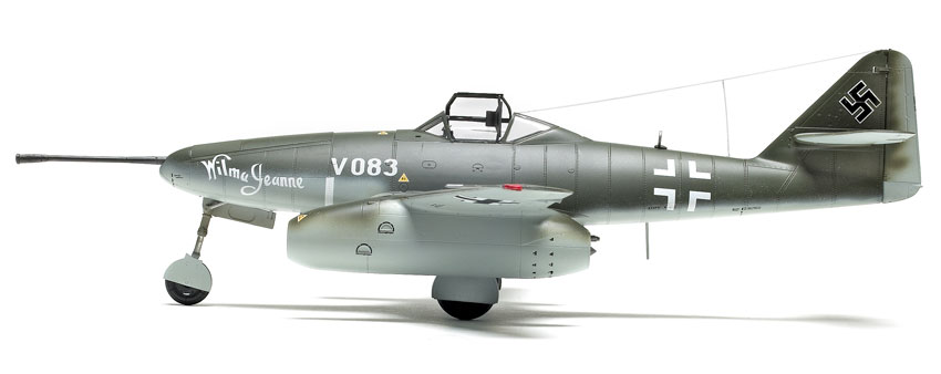

The gun cover, fuselage hatch, and windshield were poor fits. The first two fit below the surrounding surface, and the windshield sits too high. I shimmed the gun cover but missed the fuselage hatch by gluing it from the inside, not noticing its incorrect position until too late. I left the windshield as it was.
The upper wing panel was slightly off, but the horizontal stabilizers fit perfectly. Wing-to-fuselage fit was good, and there were no problems with the landing gear or their doors. The R/JATO pieces (Part G15) were unexplained and not in my references. Tabs on the canopy go into slots in the starboard canopy rail for open display. The tabs are easily removed if you want the canopy closed.
The decal images are exceptionally thin and tend to curl under the backing paper during application. (Sliding the image into a puddle of water on the model solves that problem.) Instructions call for Decal 14, a fuel triangle, to be applied to the nose wheel; it probably should have said Decal 30.
I painted with out-of-production Floquil Military and AeroMaster Warbird colors. References leave doubts about how this particular plane was painted; I followed the instructions with RLM 83 dunkelgrun. In detail painting, some parts have no color callouts (G37 and G21 for example).
