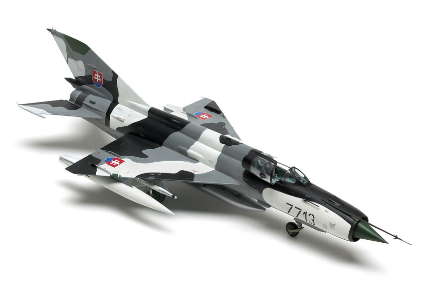

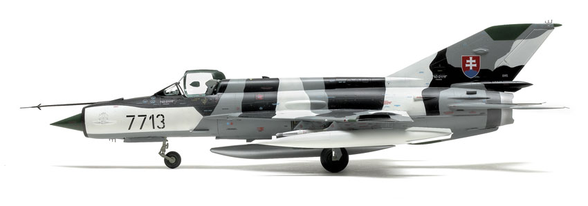

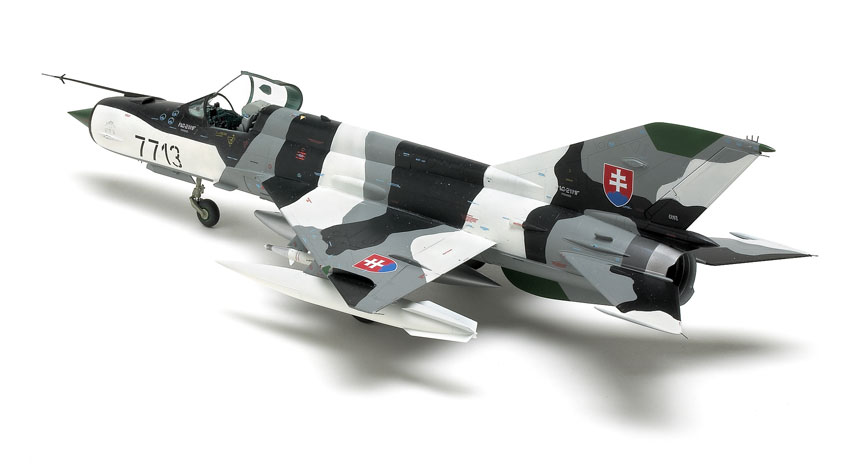

Choosing to build a MiG-21MF of the Slovakian air force, I started by carefully studying the 10 pages of instructions. Assembly is straightforward, but there are places where decisions must be made and confusion can occur. For example, on the first page of drawings, you must decide whether to show the canopy open or closed by choosing whether to install Part D20 to the cockpit floor or not.
The nose gear well is installed on the underside of the cockpit floor. I had to shorten the gear well side walls (parts C49 and C52) about 1/32" for proper fit.
The pre-painted photoetched-metal instrument panel assembly is a work of art, and an obvious improvement on the alternate plastic part. However, because of the curve of the inside of the fuselage, I had difficulty installing the cockpit side consoles with their photoetched-metal upper panels. Fit was vague and was never completely satisfactory.
I used the photoetched-metal template to scribe in the missing panels on the wing upper surfaces, rather than use the decal provided. (This process is described on Page 7 of the instructions.)
I was careful to delay vulnerable parts, such as the landing gear struts, various antennas, static eliminators, etc. until all painting, decaling, and assembly was otherwise completed. For once, I did not break anything on this model through handling.
Mounting the photoetched-metal blades to the nose probe was the most frustrating sequence in the assembly. However, I must tell you that I discovered, while writing this review, I had failed to decal the small rockets. The instructions are on the supplemental sheet. The markings simply did not register in my brain before finishing the model … a lesson in being careful and checking everything.
I airbrushed my MiG with Testors Model Master and Floquil railroad enamels. Testors Model Master gloss clear lacquer provided a receptive finish for decals; I followed with Testors flat clear lacquer finish. The decals are thin and require careful handling, but they behaved well enough with a little Micro Set. Of the more than 80 hours I spent on my model, 12 hours went to the stencil decals.
The model measures out very close to specifications I found at Wikipedia. But will I build another? You bet I will! There are five more sets of markings in this version, and others are on the way.
The kit requires some modeling experience. Modelers will be challenged, but it’s worth the effort.
