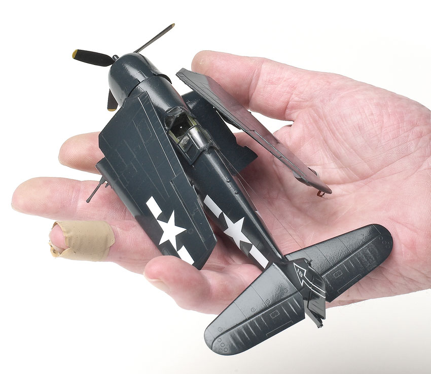

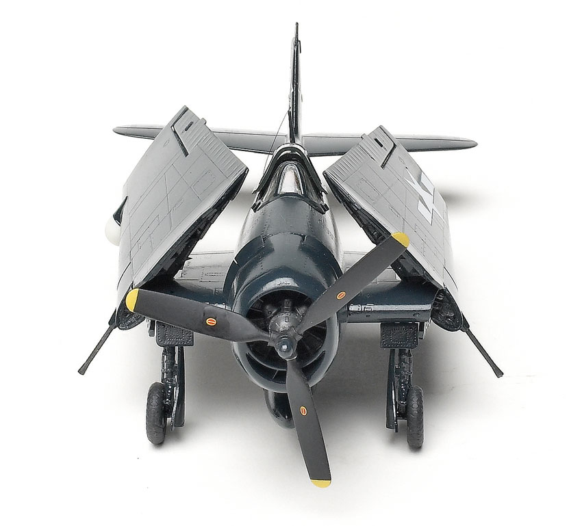

The highlight of the kit is the folded wing. Alternate sets of hinge-point inserts are used, depending on whether you want the wings folded or extended. The diagrams don’t clearly show how the fingers of the inserts fit into the wing’s center section, so, once again, dry-fitting is recommended. I didn’t try to build the extended wings.
The Hellcat’s wings had an unusual set of panels and drop-down doors on their undersurfaces, outboard of the main-gear wells and along the wing-fold separation line. Panels B7 and B8 (mislabeled B5 and B6 on the assembly diagram) mount only to the forward end of the opened wheel bay, and the drop-down doors mount to them. They just stick out with no support at the rear when you have the wings folded. It looks wrong, but it’s correct.

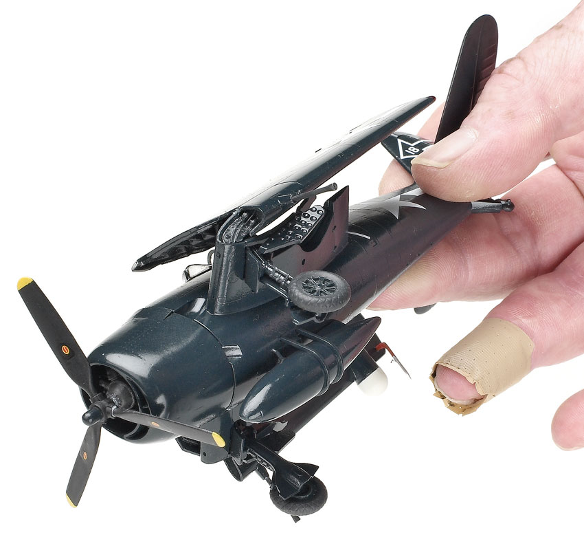

I left the outer wings off until final assembly. The radar pod is molded in three pieces and attached to the wing. Compared with photos, the pod is much too small, and it looks even smaller next to the oversize pitot tube provided in the kit.
