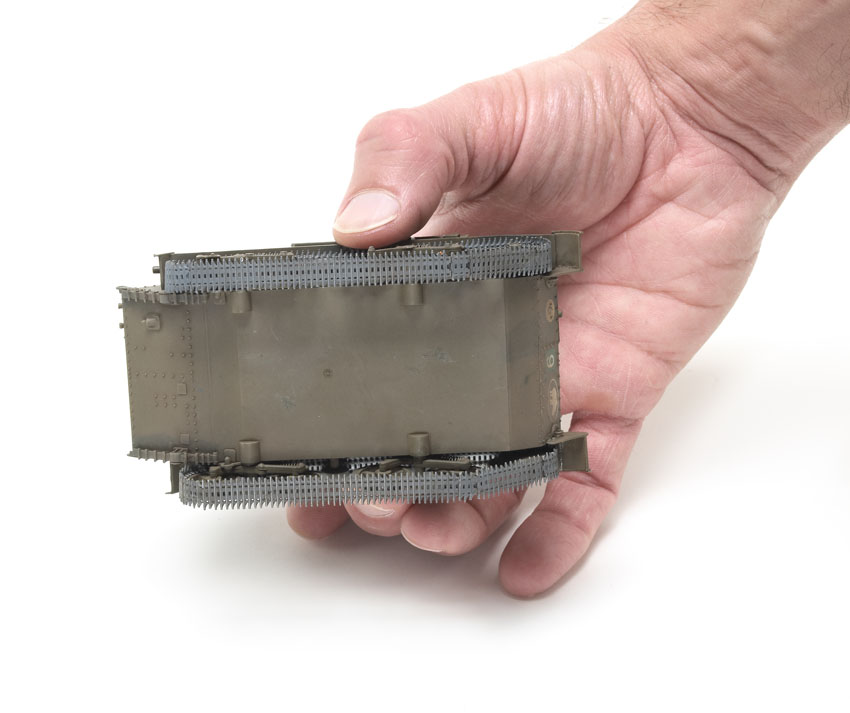

The most difficult part of the model was installing the tracks. I had to trim the bogie-unit attachments slightly to get them to sit properly. The drive-sprocket attachment point is weak; were I to build another kit, I would modify it for a more-solid attachment. Trying to get all the track and suspension pieces to fit was a real juggling act, as nothing can be set solid until all is in place. The tracks do fit well, but they are a challenge.
