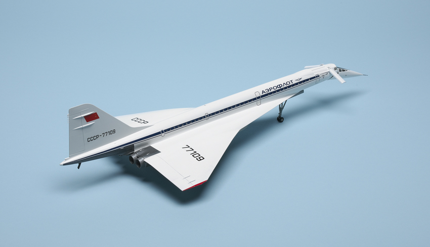

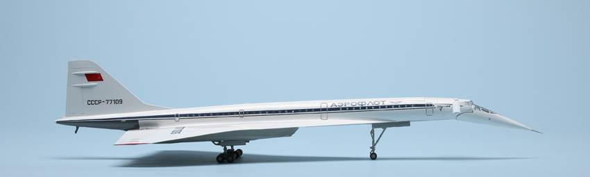

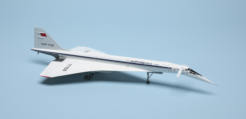

Construction is straightforward with good fits. But the airliner’s unusual structure creates challenges. I left the cabin windows out for ease of painting — I filled them with Microscale Kristal Klear at the end of the build — and glued the fuselage together. The nose and tail fits are nearly perfect. But the large wing opening causes the halves to bow in the middle, creating a difficult gap. I tacked it together with super glue and accelerator, then flowed liquid cement along the seam. To prevent splitting, I reinforced the inside of the seam with a bead of 5-minute epoxy.
After painting the inside of the engines white and metallic gray, I glued the two nacelles together. Pay attention to the part numbers in the instructions; the parts are not interchangeable.
My advice for assembling the wings: Be careful, take your time, and dry-fit often. There are ejector-pin marks inside the wings that need to be removed for proper fit, but don’t remove the small raised circles molded outside the engine opening on the lower wing (Part D5) — you can see them on the instructions — because they help align the parts. I needed to sand the tab that locates the wing and engines to get everything flush.
I left the landing gear, exhaust nozzles, and nose separate for painting.
After several coats of Tamiya spray-can white primer and masking, I painted the lower surface with Testors Model Master Fulcrum gray (No. 2133), then painted the wingtips with Model Master insignia red. Pledge Future floor polish followed.
The decals are very thin and fragile; a couple fractured during application. A coat of Microscale Liquid Decal Film corrected the problem. I was impressed by how well the windows in the decals matched the molded openings (they don’t always). Pay attention to the decal numbers: Several markings, such as the cheat lines, are common to both aircraft, but the Aeroflot titles and wings are slightly different.
Final assembly went well. But be careful with the landing gear. Follow the addendum in the kit and you shouldn’t have any problems. I modeled mine with the nose drooped and the canards deployed.
