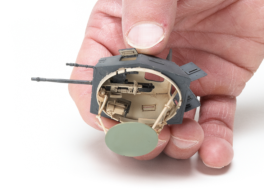

The turret is a little gem. Included is the turret basket and most of the major interior details; I posed all the hatches open to show it off. While the photoetched-metal hinge parts for the rear hatches are not numbered in the instructions, you’ll see how they go. The tiny hinge pins (F3) jumped from my tweezers into oblivion, but I just glued the hinges together with super glue once the hatches were attached.

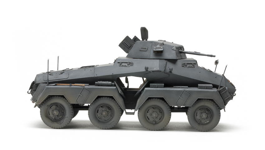

I painted my 8-Rad with Tamiya German gray, then post-shaded using a lightened shade of the base. Applied to a gloss coat of Pledge Future floor polish, the decals settled with a little Micro Sol. I airbrushed thinned Tamiya earth on the undercarriage, then applied a wash and dry-brushing with artist’s oils.
On the fenders, I roughly shaped the guards, concentrating on getting a good fit where the rim of the guard met at right angles, then secured this joint with the tiniest bit of solder, being careful to keep it from flowing into the mesh (paste flux is your friend). With that secure, I worked on the mesh seam until it was almost invisible.
The finished model matches the dimensions in David Doyle’s Standard Catalog of German Military Vehicles (Krause, ISBN 978-0-87349-783-1), except it was a little tall; I think the body sits a little too high over the wheels.
