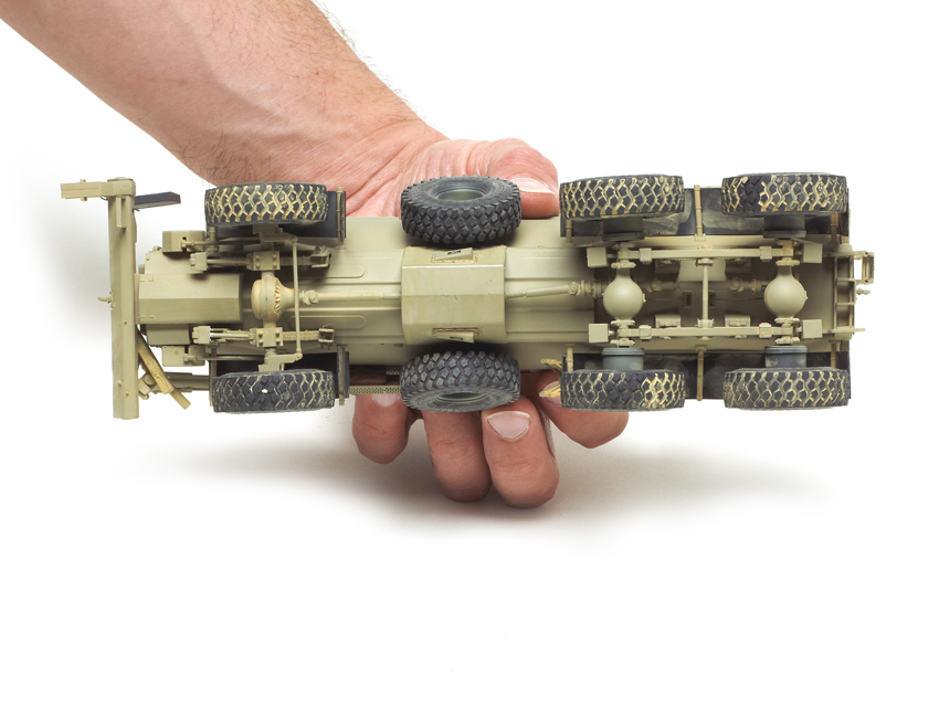

The first 12 steps are dedicated to the chassis and suspension. Detail here is superb and really pops out on the completed model.
The wheels are a three-piece styrene assembly (treads and two sidewalls). The tread detail looks like the reference photos I have seen. Fit of the sidewalls to the tread is superb, and the detail there appears accurate as well.

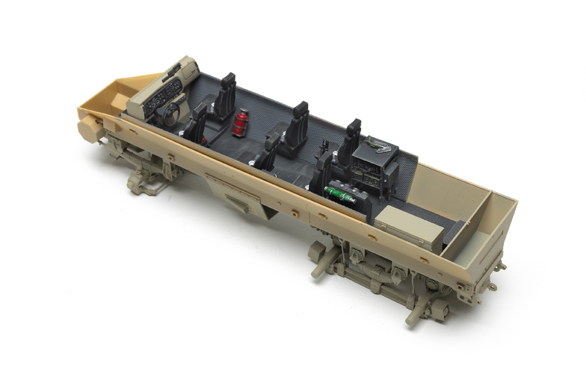

The interior is fantastic. All six seats have molded-in harnesses, and the instrument panel and steering wheel are fine moldings. Individual decals are provided for each gauge. An air-conditioning unit and radio equipment help make the interior look busy. Sadly, most of this great detail will be hidden once the roof is on.

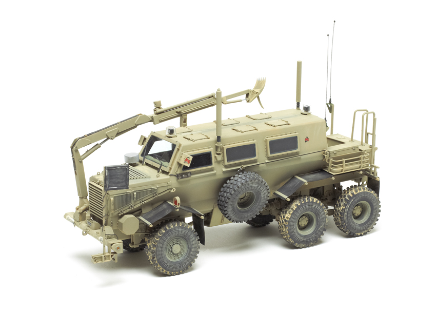

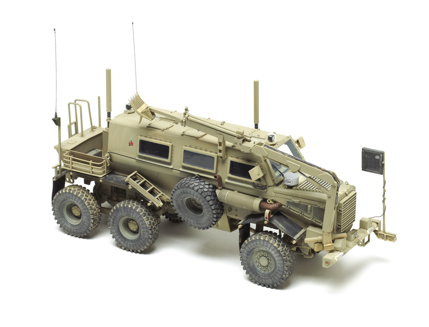

I ran into a minor fit issue installing the roof; it was extremely tight, yet I found a slight gap that needed filling. All the antennas you need are included, but mind which Buffalo you are building — the layout is different on each one. The photoetched-metal parts really stand out on the exterior, especially the top grille on the hood.

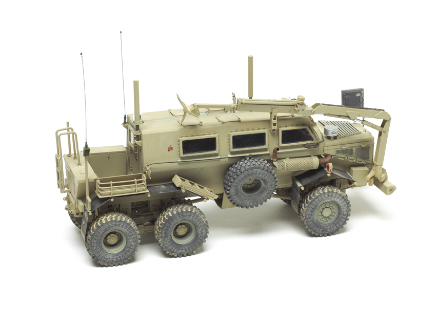

The robotic arm is a kit of its own, and it looks like the real thing. Close attention to the instructions is needed here: Many of the parts are not to be glued, which gives the arm full articulation (a nice touch). However, much of the linkage is absent; I decided how I wanted to mount the arm, then glued the pieces together.
I painted with Testors Model Master U.S. Army/Marines sand; the tires are Floquil grimy black. I used a mix of pastels for weathering, but went easy because these vehicles are still new.
The few decals included were no problem. I tinted the windows with a mix of Tamiya clear green and clear blue to depict the vehicle’s ballistic glass. I kept these pieces for the very end, making painting much easier.
