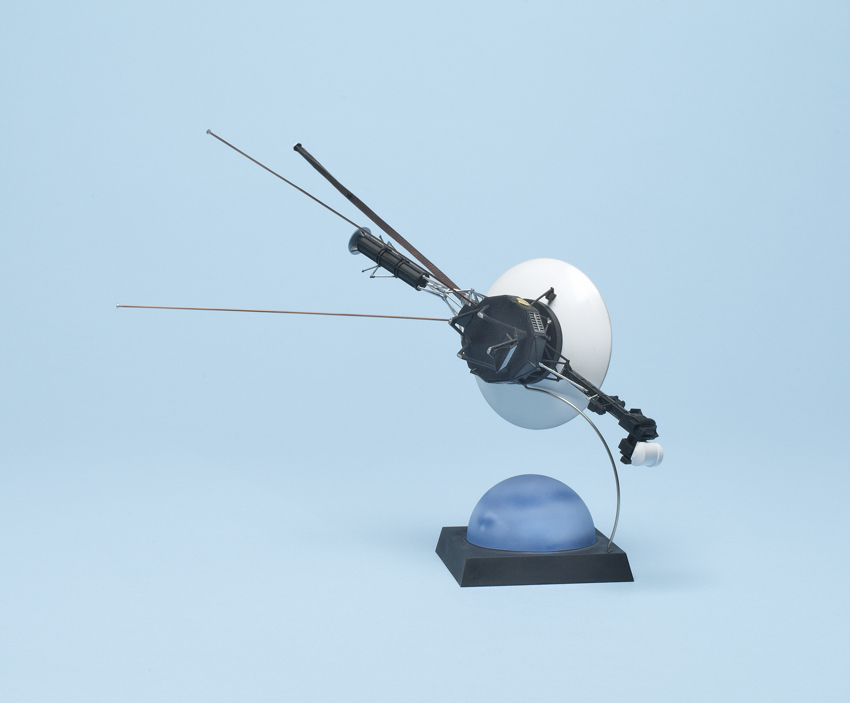

I studied the instructions, then built as many of the subassemblies as I could before painting, starting with the bus housing (Step 3); I filled small gaps between the halves (parts A3 and A4) with a touch of Mr. Surfacer 500. While test-fitting the legs (parts A11, A14, and A15) to the bus housing, I noticed gaps where the legs met; I glued them together with Weld-On 3, being careful not to glue them to the housing. After that dried, I was able to gingerly remove the leg assembly from the housing to fill and sand the gaps. The only other filler required was for a small gap in the high-gain antenna feed-horn base (C5, C8). Sanding eliminated other seams.
I painted the infrared spectrometer and high-gain antenna parts with Testors gloss white enamel, and other parts Tamiya satin black acrylic and Vallejo Model Air silver, both by brush and airbrush as needed. Rather than paint the exhaust vents on the bus housing solid silver, I dry-brushed them to impart more depth.
The base shows Earth’s northern hemisphere outlined on the inside with raised lines. Not confident in painting a good likeness of Earth, instead I painted with various blues to represent the planet Neptune. With paint on them, some parts were difficult to insert. But with just a touch of Weldon 3 on the pins, they slid in perfectly.

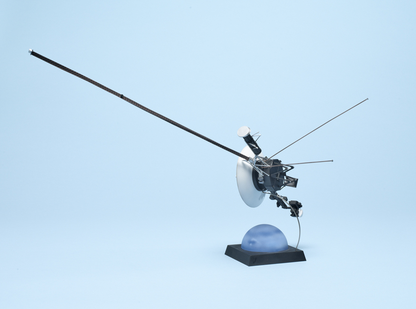

The most disappointing parts were the meter unit and low-field magnetometer booms. They are molded solid, rather than as open trusses. (Photoetched metal would look better, but that long, twisted magnetometer boom would be a bear to build.) To improve the magnetometer boom, I painted it flat black and dry-brushed it with copper paint taken from a Krylon copper leafing pen I found at a craft shop.
