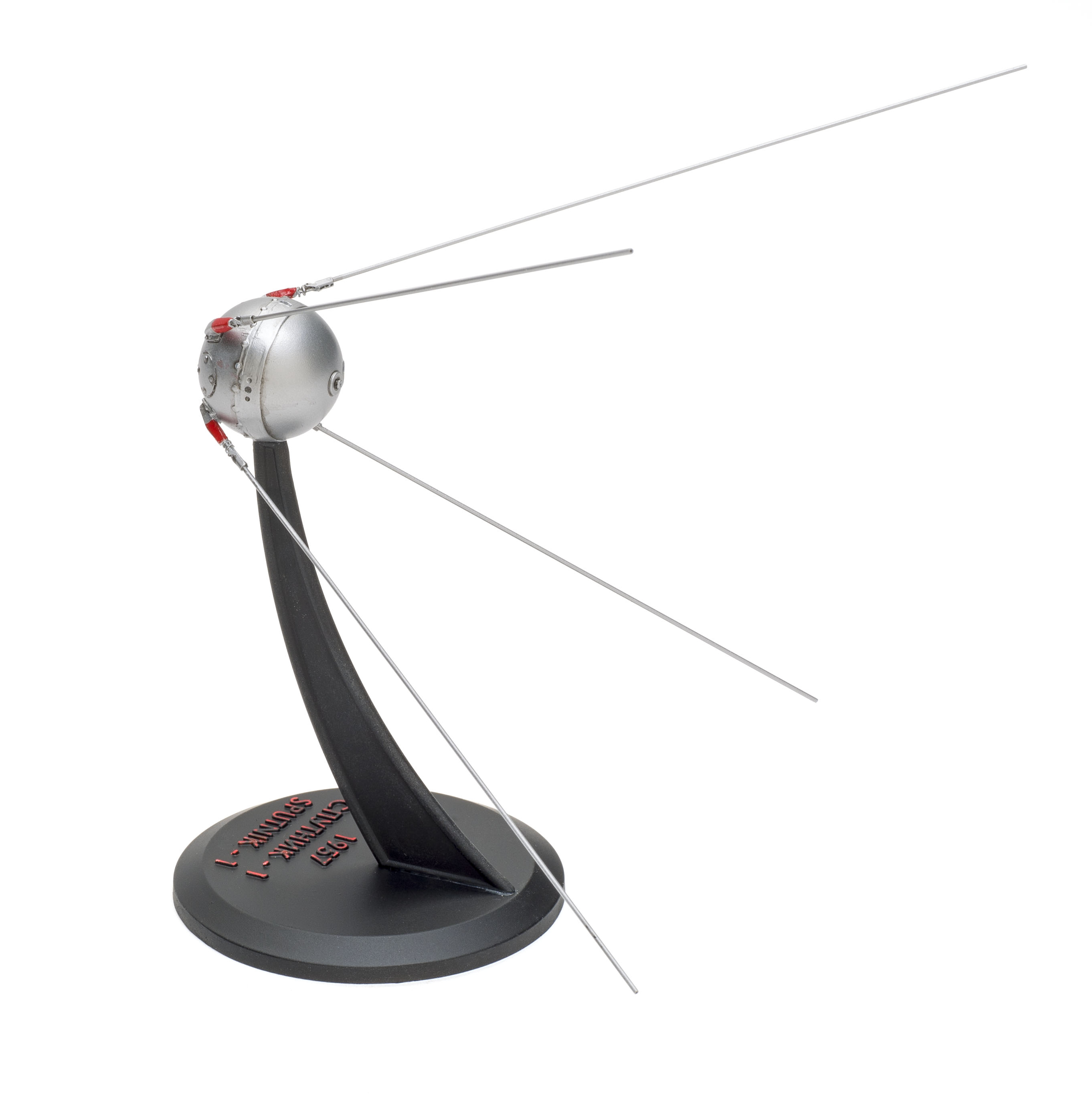

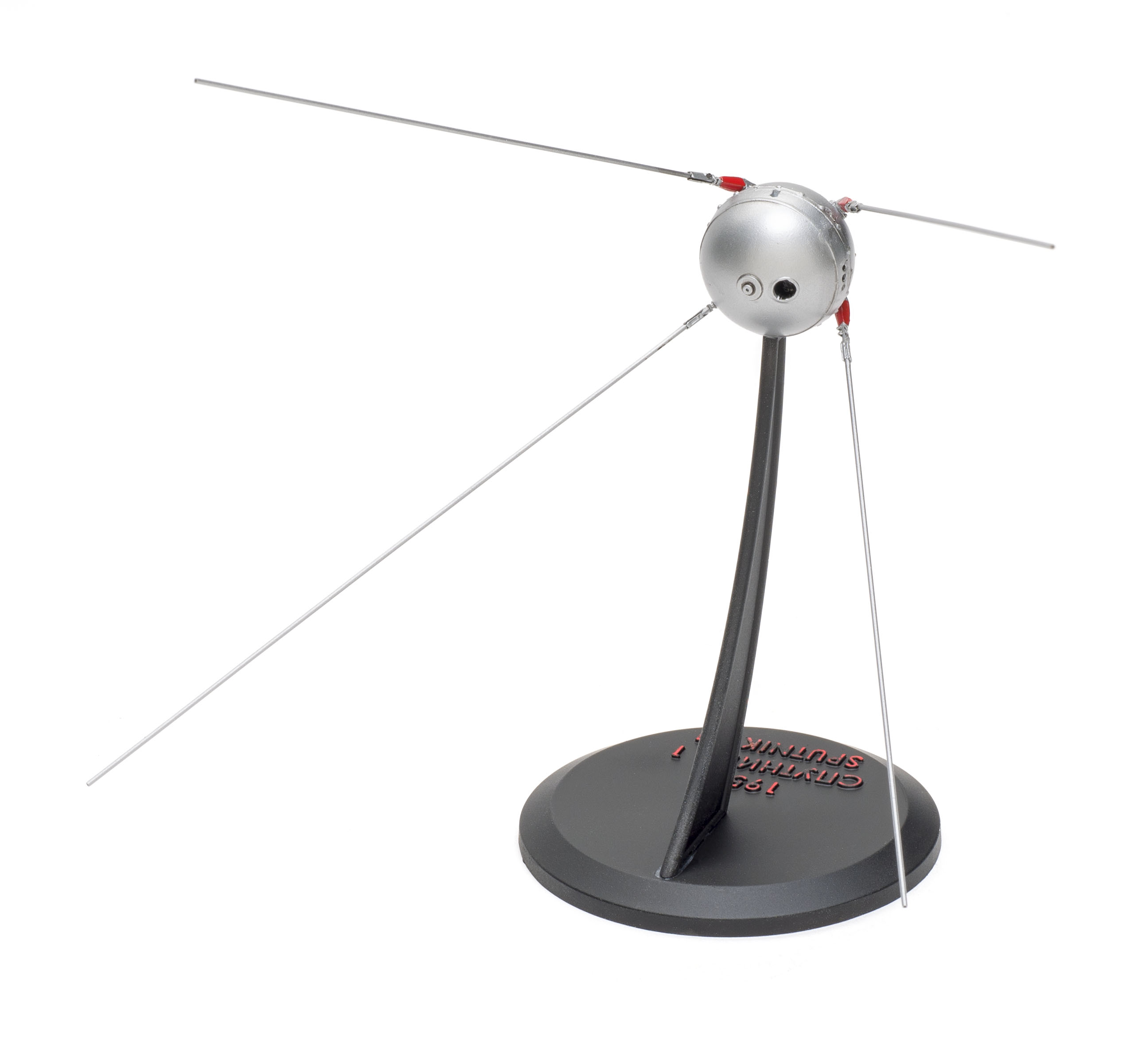

The hemispheres that make up the body of the satellite fit together well but pay attention to the way it is keyed. I almost lined the small tab up with the slot for the stand.

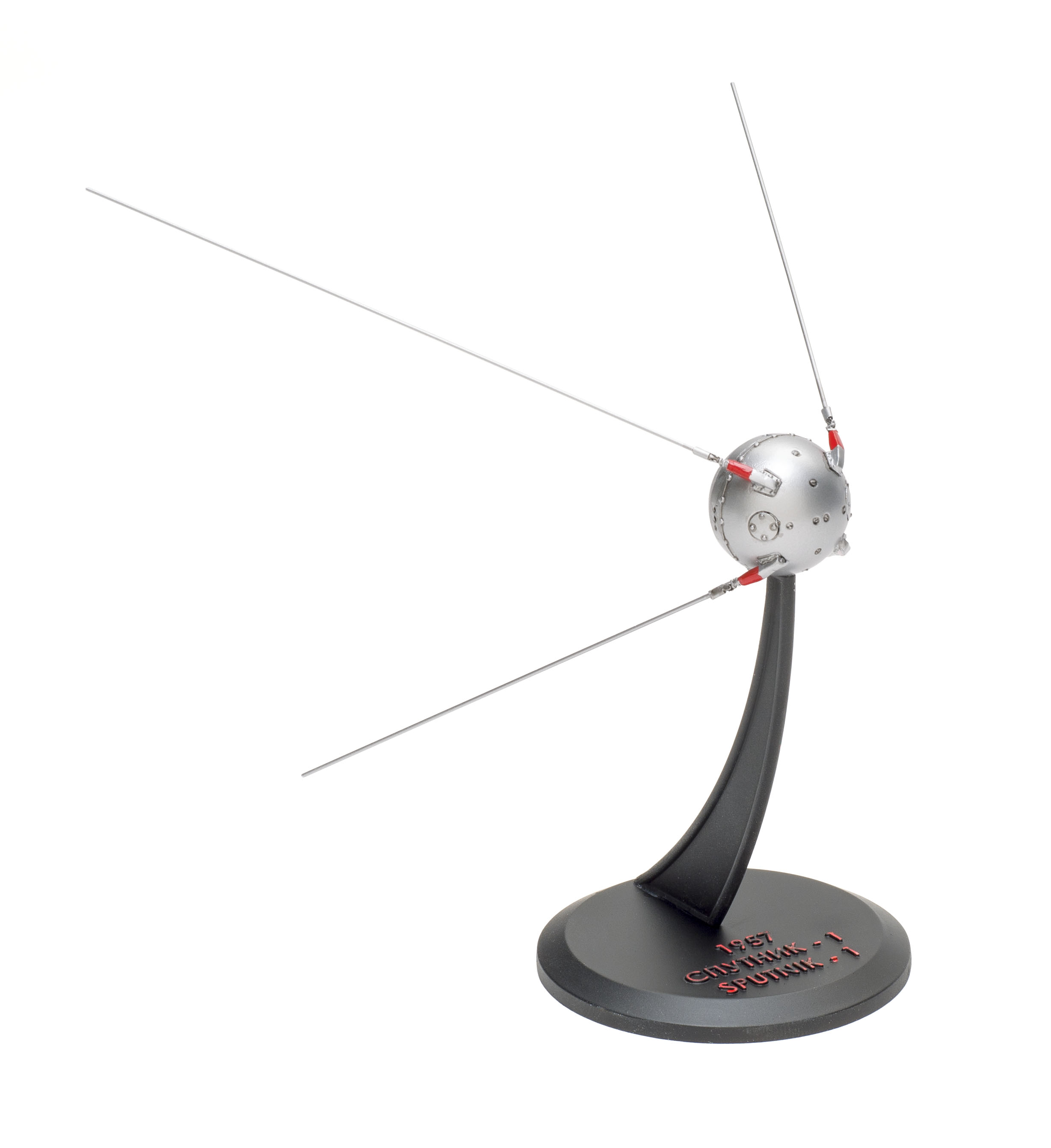

I found that the two circular panels that fit on the front sat a tad too high and seemed loose in their depressions. I sanded the tabs on the rear considerably for a more positive location. I also had to sand the ends and sides of the pieces that insert along the equator for a flush fit.
I was impressed by the PE screw heads that fit into small depressions on the body. Each includes a ½-inch handle that makes it easy to place them with tweezers. I removed the handles with nippers after the superglue dried.

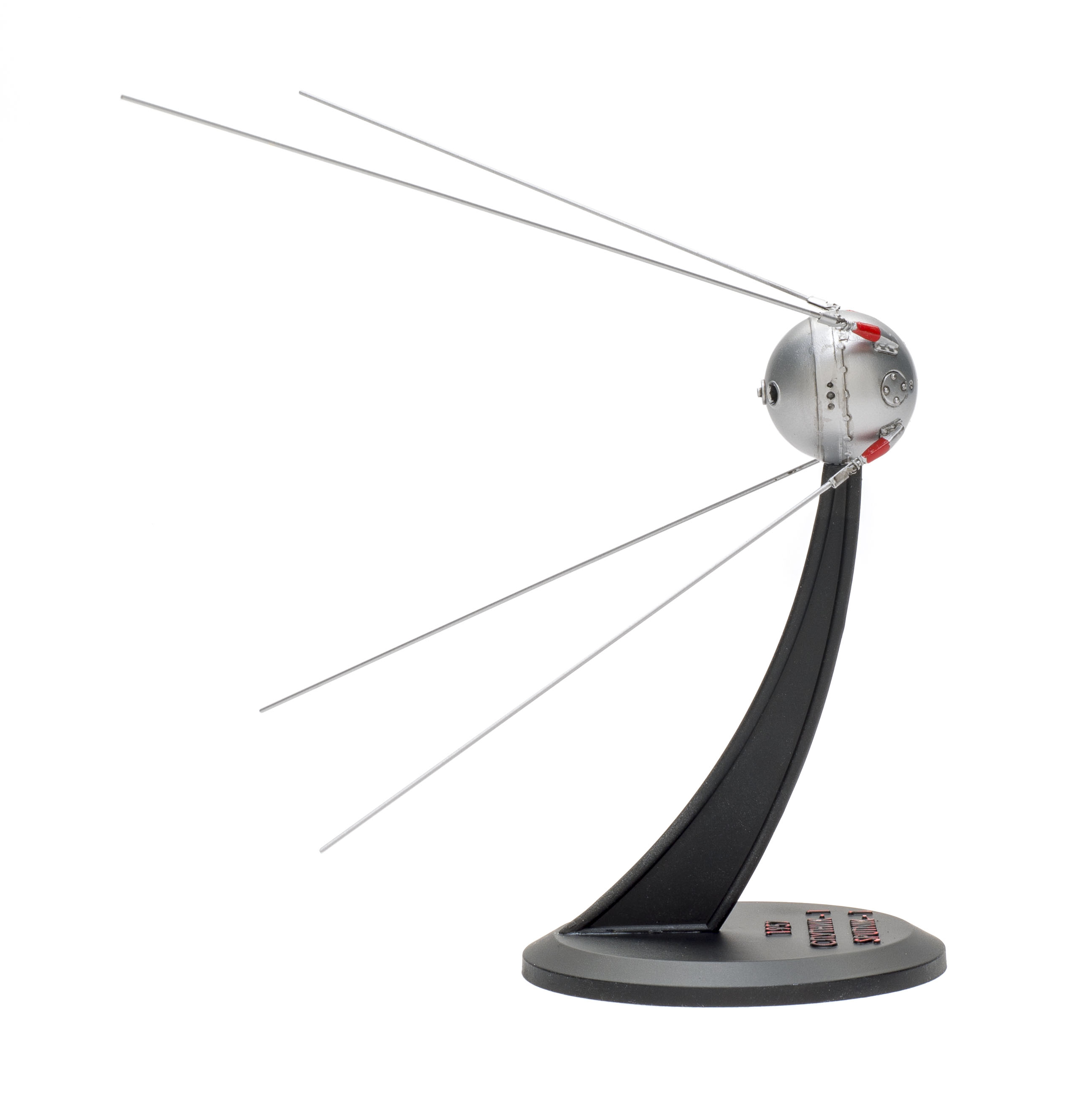

The instructions would have you build the four antennas — mount and all — then attach them to the body. I recommend attaching the mounts (Part 6) first as they need refinement to fit. Then I glued the antenna bases (parts 7 and 8) together, attached them to the mounts, and used a drill bit in a pin vise to enlarge the holes in the mounts to better accommodate the brass rods.
Before gluing the antennas, I formed the PE bases around them by taping the rods to a flat surface with a gap between the tape wide enough to accommodate the PE parts. Then, I carefully folded one side up with a knife blade while holding the other down with tweezers. It took careful work, but once they were folded, I superglued the antenna into its mount. Then I slid the base against the mount and flowed thin superglue around it.
Pay attention as the antennas are different lengths and they go in specific locations.
I painted the model with Tamiya Bare-Metal Silver (No. AS-12) from the spray can over Tamiya white primer. The actual satellite was highly polished so chrome might be a good option. The plastic is smooth enough to make that work with little prep other than primer or a gloss black base. I picked out the mounts with red and a depression on the rear black.
To pop the molded lettering on the base, I airbrushed red over white primer. After spraying black, I lightly sanded the lettering to expose the red underneath.
The tab on the stand is small, so the model must be glued to it.
Red Iron’s Sputnik-1 is a neat little kit of an important milestone in human history, and I appreciate that is designed to appeal to relative newcomers and experienced builders alike. It does take a little extra modeling work to take care of fit issues for the inserts. The PE is fiddly, but well-engineered and takes the detail to the next level. I definitely recommend it for any fan of space exploration history.
