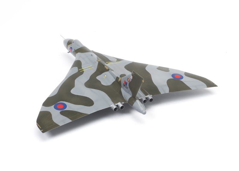

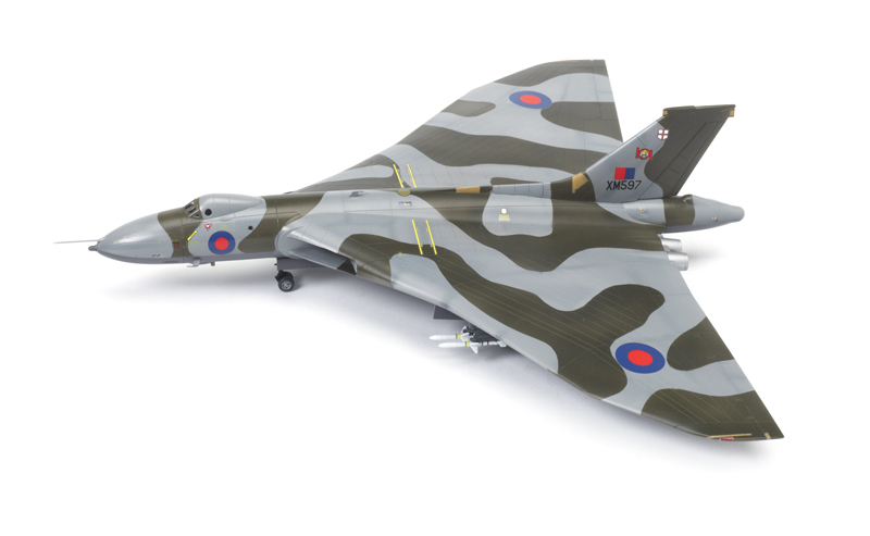

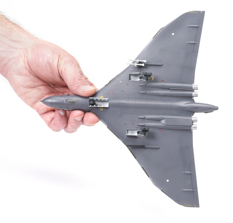

Construction couldn’t be easier, with single pieces for the upper and lower fuselage and wings. Slide-mold techniques for the one-piece intakes apparently eliminated the internal seam lines. Parts engineering and fit are excellent throughout. You’ll need a touch of filler around the leading edges of the intakes, vertical stabilizer, and lower tail-cone insert. Separate pieces for the bomb bay doors and the lower tail section hint at future versions — a tanker or a Blue Steel missile carrier, perhaps? While surface detail is exceptional, there is no detail in the wheel wells.

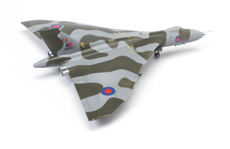

Basic construction moved briskly, but I spent a lot of time painting. After priming and pre-shading, I sprayed the surface antennas with Tamiya XF-59, desert yellow, and masked them off. To achieve an accurate camouflage pattern, I made a photocopy of the upper surfaces from the painting guide and transferred it to friskit paper for the hard-edged paint job. This method worked much better than my initial attempt with masking tape. I used Gunze Sangyo paints throughout for the standard RAF colors.

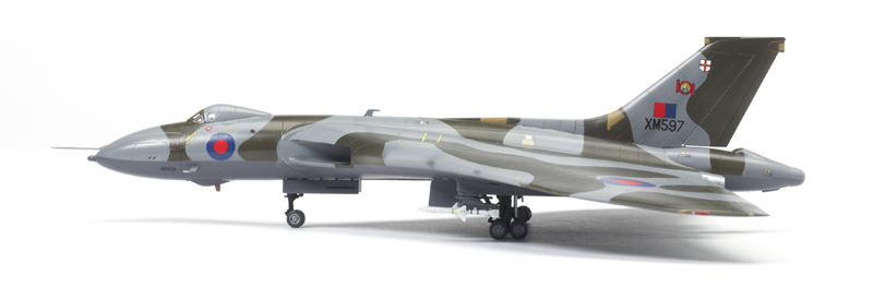

I’m not sure this is explained in the Chinese captions of the instructions or decal guide, but XM597 was the only Vulcan to carry Shrike missiles. Aircraft XM607 flew only bombing missions. You’ll have to coordinate your choice of weapons with the markings. On the actual combat raids, the aircraft were devoid of unit markings. Squadron and wing badges were reapplied after the war when the bombers returned to England. Also, my references did not show the port ECM pallet between the engines, so I left off Part A25.
My only complaint with this kit is the decals have a flat carrier film that remains opaque, even after several coats of gloss varnish and decal-setting solution. This is evident on the stencil data and serial numbers.
Still, my 25 hours on this kit were satisfying. Without great difficulty, you can produce an attractive and accurate rendition of the Vulcan. I hope Great Wall Hobby will present us with a Victor and a Valiant in this scale, too. They would make a great display lined up next to a Cold War B-52. To encourage G.W.H. in this endeavor, I would urge modelers of all skill levels to buy one of these. You will surely enjoy the build and your finished model of this historic bomber.
