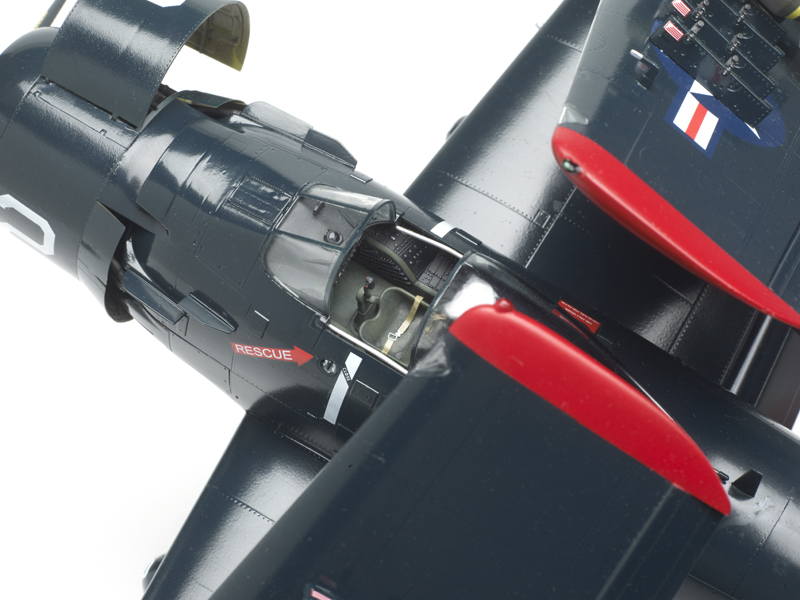

After identifying these issues, construction was a breeze. I used very little filler; what I did use was my own fault. The only fit issue was the inspection hatch just in front of the canopy. There was a large gap and small step that would have been difficult to fill without destroying the adjacent hinge detail. So, I cut a piece of .005" styrene to size, scribed the door line down the middle, and placed it over the gap.
A set of photoetched-metal seatbelts is included, but these seem very narrow for the typically burly Spad driver. To show off all the engine detail, Trumpeter provides two clear fuselage side panels. Left as they are, these panels would allow viewing of the nice engine accessory bay. But I left all these parts out, as I intended to paint the panels (which would hide the accessory bay). Thanks to the wonderful fit, I was able to quickly close up the fuselage and concentrate on the flying surfaces. Trumpeter has included separate controls for all flying surfaces. Other than the dropped flaps and ailerons, which are correctly drooped for the folded-wing option, the mounting tabs are all molded in the neutral position. Fit is exceptional and sturdy. The wing center section carries detailed gear bays and the inboard cannon. Wing hinges are well executed and strong. I folded the wings on my AD-4, but if you plan to have them extended you might want to beef up the mounts.
Just like the fuselage, the wing center section fit like a glove. I was also thrilled to see I didn’t need any filler to blend it into the fuselage, not even at the complicated joint near the cowling. The wing roots were nice and tight as well. I left the sturdy gear off until after painting.
Trumpeter has included rubber tires and, while I’m not a big fan, these look nice. The outer wings include optional open ammo and cannon access panels. Again, the fit is exceptional in the closed position. After painting, I did a trial fit of the folded wings, and they stayed so nicely I decided not to glue them in place.
I had left the engine until last, fearing the spaghetti of exhaust tubes would do me in. But, here again, Trumpeter comes up in spades for its Spad. I was able to test-fit by fully assembling the engine without glue, then disassemble, paint, and reassemble it with no issues. Nicely done!
After painting the aircraft blue — so much blue — I began decaling. The decals have a spotty finish, with inconsistent gloss and flat areas. They go on all right; however, the white is a bit translucent. Good thing I remembered to leave off all the pylons to allow placement of the underwing star — there would have been a lot of cutting involved otherwise. But, try as I might, I could not get the yellow nose bands to fit on the 500-pound bombs.
After decaling, I started attaching all the many assemblies and parts that I had left off. The fit was exceptional for all the accessories, including the landing gear.
