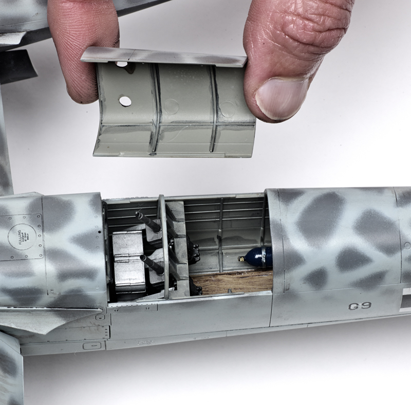

To save time, I opened just one side of the aircraft. This allowed me to leave out numerous engine details, most of the weapons, and even some of the rear fuselage details that cannot be seen once the kit is assembled.

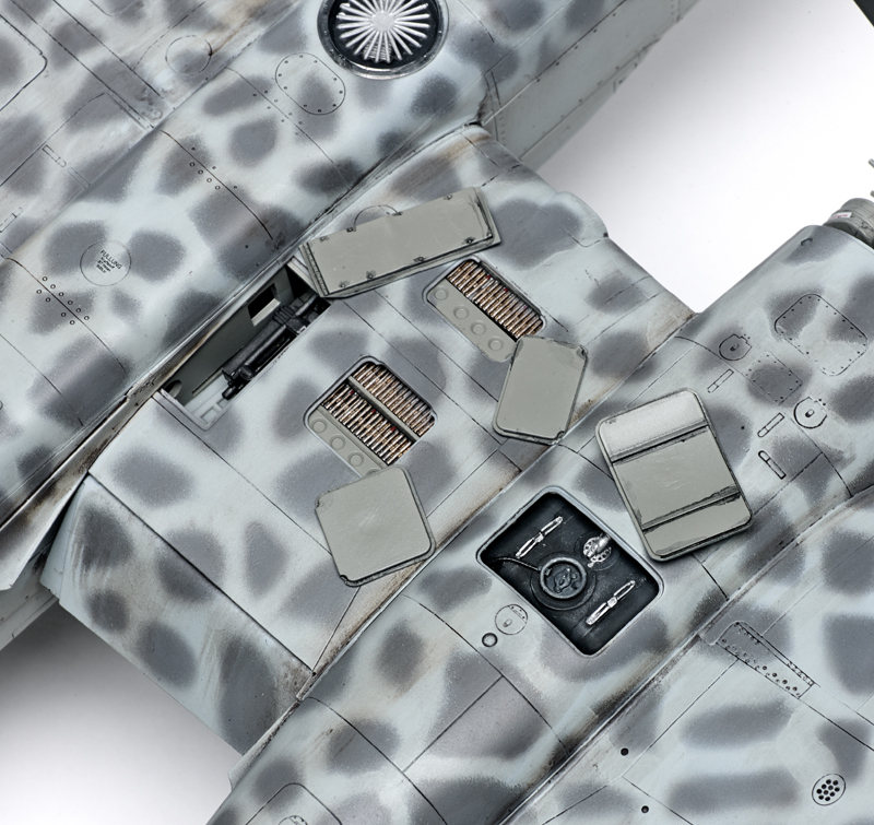

The center section rivals the cockpit for complexity, including a mechanic’s jump seat (complete with molded seat belts) and the entire 30mm inclined cannon (known as Schräge Musik, or Jazz Music). I deviated slightly from the instructions by installing the guns on the bulkhead to obtain the correct angle, rather than floating in space on the ammo cans.

The forward bulkheads, F-2 and F-8, are also keys for strength. This is where I got bit by my Owl — the forwardmost bulkhead, F-2, must be placed far enough away from the edge to allow tabs on the cockpit to slot fully. Remember my warning about building multiple sequences at once? If you install the oxygen bottles in the rear fuselage, make sure they are far enough below the attachment plane of the fuselage molding or they will interfere. I toyed with the idea of opening up the under-fuselage cannon tray, but the structure has numerous mold-line mismatches and flash. In the end, I kept everything closed and added more nose weight to assuage my fear of tail-sitting.

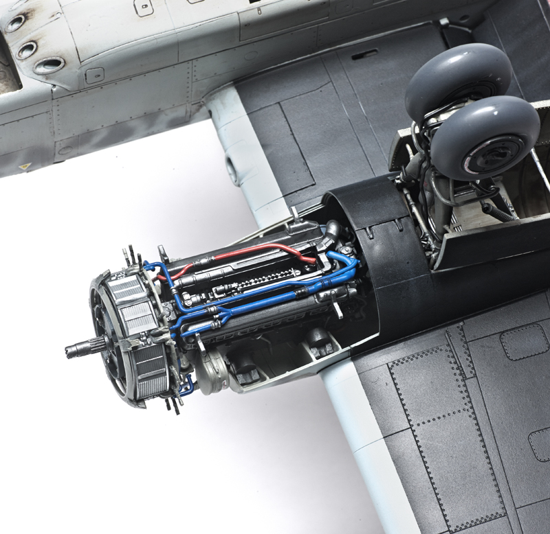

Detail on the engines and landing gear is astounding. Spark-plug wires and brake lines are included. The high fidelity extends to accurately lapped panel joints instead of simple scribed lines. Thanks to careful fuselage alignment, the wing mated perfectly with the fuselage. Applying skin to my Owl, I was pleased to see the wing panels fit perfectly to the fuselage and cowlings. I did have to clamp the wing-root fairings to the fuselage to get them to fit.

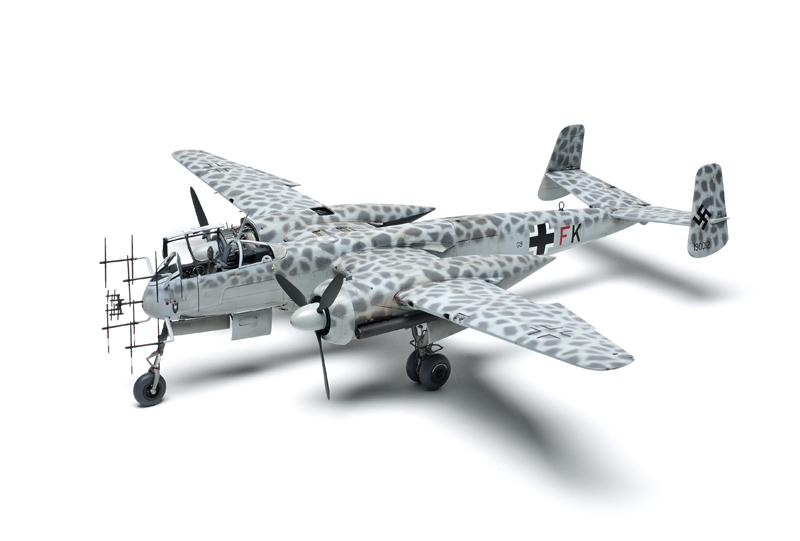

After I added the control surfaces, my Owl was ready for prime time. I painted top surfaces with Testors dark gray RLM 75, followed by RLM 76 light blue lines; the result looks like random gray dots, just like the original (I hope). The decals are thin and agreeable to setting solution, but they can tear if abused. A bit of weathering, a flat coat, and I was able to attach the myriad assemblies and parts, such as the engine and landing gear.
I spent an involved 85 hours on my Owl, and I could have — and should have — spent more. This is a kit that will reward loving care. The complexity and fit adjustments call for an experienced builder — but if you are up to the task, you should have a hoot.
