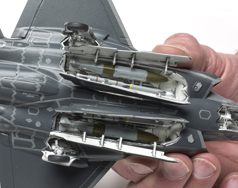

Italeri’s F-35A comes loaded with a pair of GBU-31s and two AIM-120 air-to-air missiles for the weapon bays in the airplane’s belly.

Overall, fit is good with no filling or sanding. The main assembly problem was the weapons-bay doors. Instructions don’t mention that you can pose the doors closed, though it appears the parts were designed for it. Instead, you’re directed to slice off a small panel on the inboard doors and add hinge arms to both inboard and outboard doors. Neither the doors nor the bays have positive locators for the hinge arms; you have just as good a chance of getting them wrong as getting them right. I suggest gluing the arms to the doors, then adjusting their fit while the cemented joints are still soft by test-fitting them to the shallow depressions in the edges of the bays.

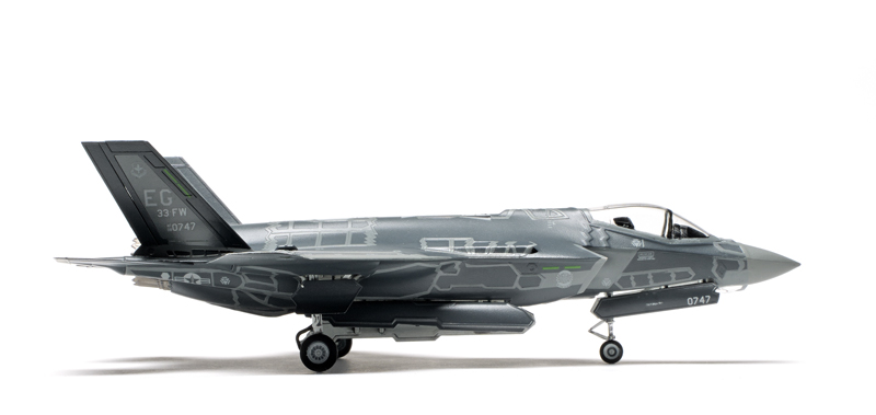

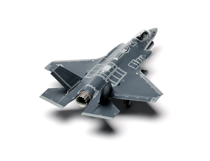

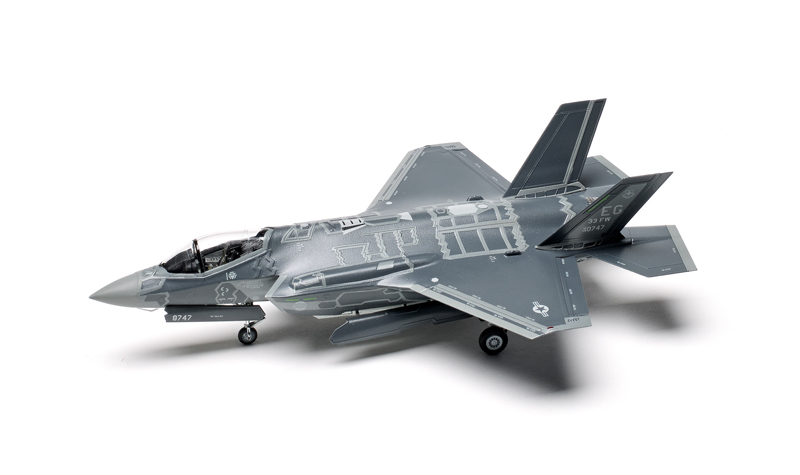

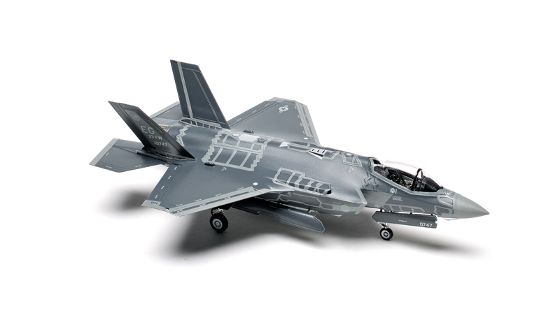

Painting this model is a chore. After painting the gear and weapons bays gloss white, I masked them — not easy at their zigzag edges. Photos of F-35s show a dark gray overall with dozens of zigzag “panels” and edges in a lighter gray. The instructions specify Federal Standard 36118 gunship gray for the darker color, but then suggest “FS36622 flat gull gray” as the lighter — but FS36622 is the almost-white color underneath the U.S. Air Force’s tactical aircraft of the Vietnam era, so that’s wrong. I used FS36231 dark gull gray for the lighter color, which I applied overall for the first coat. I masked all those panel edges with burnished Bare-Metal Foil, cutting around each edge with a sharp blade and removing the excess; it took at least four hours. I wish Italeri had provided decals for these areas. Also, photos show leading and trailing edges and the radome are an even lighter color; I used Testors Model Master FS36251 aggressor gray.
Decals are provided for aircraft of the USAF evaluation and training wings at Nellis and Eglin air force bases, along with provisional national insignia for the United Kingdom, Italy, Belgium, and Netherlands. The decals went on fine. I found the footprint of the canopy to be a bit smaller than the area that it sits on. I’m not sure if there should be any framing on the clear sensor fairing under the nose, so I left it clean.
It took 31 hours to finish the model, nearly all of it masking and painting. From arm’s length it looks pretty accurate, but then there isn’t a lot of reference information on this aircraft. From the breakdown of the parts, I suspect we’ll be seeing U.S. Marine Corps B and Navy C models soon.
