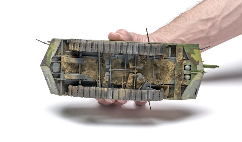

Steps 27-33 assemble the lower suspension. This assembly is fragile and needs care to avoid breakage during subsequent building and painting steps.
I did not follow the assembly sequence in Steps 28-31. Instead, I glued the inner road-wheel brackets to the lower plates first. When these were dry, I glued the wheels and outer brackets. I had to trim tabs on the inner and outer brackets to fit them into the grooves on the lower plates. Then I went back to add all of the support brackets and other details I had skipped. I did have trouble getting the U brackets (A13) to align with the base plates (A2).

Each track link is made of three parts; it takes 36 links per side. They’ll be workable if you are careful. Make sure the first track link has an extra set of loose parts (parts B2 and B3). These connect the ends of the track when they are placed on the tank. Then you can glue the final track shoe to complete the run.
I painted the tracks Vallejo Model Air black gray and weathered with AK Interactive washes and powders and Vallejo Panzer Aces rust colors.

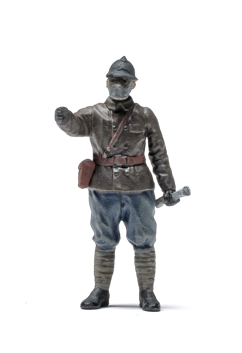

A French tanker figure is included, wearing facial armor designed to deflect shrapnel flying around the interior. No painting instructions are included for the figure; you are directed to follow the box art. I used Vallejo and Humbrol paints to match the artwork as best I could.

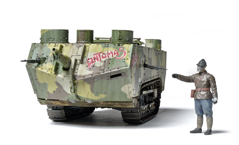

Two marking options are provided, with a two-side view of one and a three-way view for the other. Both are in black and white; for color profiles, you are referred to the box art and Tamiya colors.

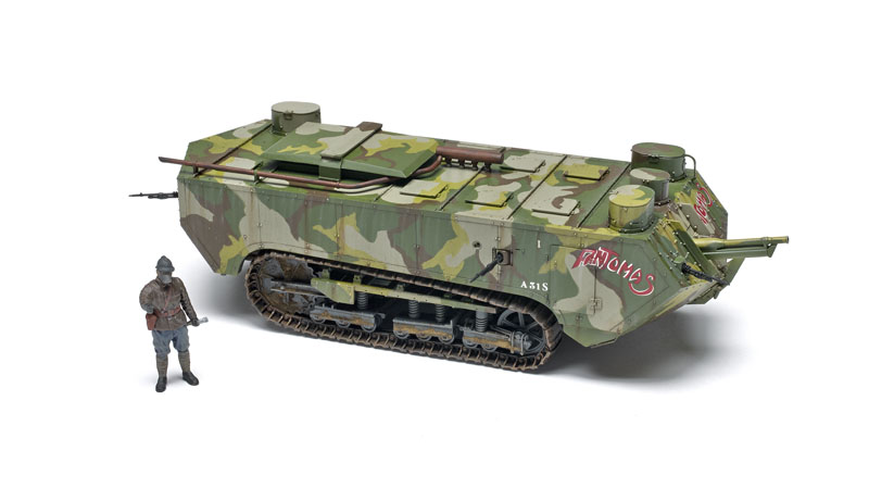

Choosing to model Fantomas, I found in Steven Zaloga’s book French Tanks of World War I (Osprey, ISBN 978-1-84603-513-5) that the paint scheme looked more like the first option instead of the one shown. I found another color profile on the website www.panzertruppen.org similar to the one in the directions. But the box art and the directions do not even match, so I chose a combination of the three color profiles.

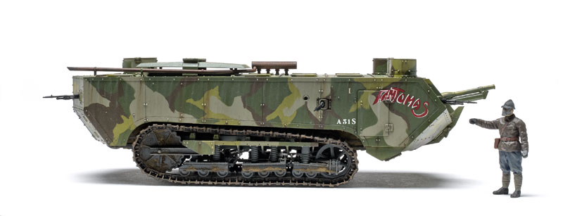

I painted the model with a base coat of Tamiya medium gray (XF-20), then masked gray portions with Silly Putty. I did not like the green specified in the directions, so I mixed Tamiya flat green (XF-5) with yellow green (XF-4) until it looked closer to the box art. Then I brush-painted Vallejo dark yellow and Vallejo chocolate brown, the other two camouflage colors.
The decals adhered well over a gloss coat with no silvering. I did have to use Solvaset to lay them into some of the details on the hull, and I punched holes for the large rivets. Mig washes and AK Interactive streaking colors finished the weathering, and CMK powders added a touch of mud.
