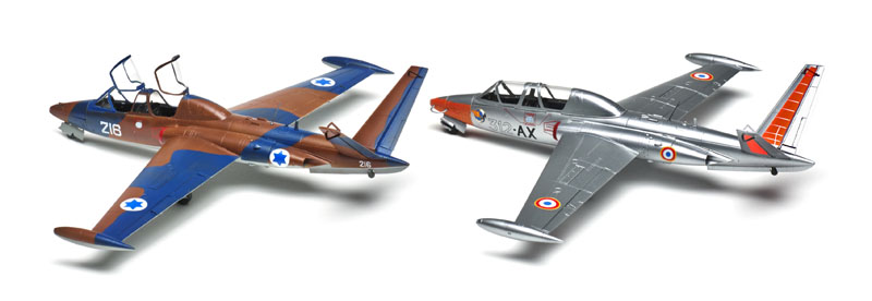

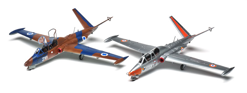

I completed my two Magisters in 30 hours, and the finished models look neat. On the downside, more effort than I anticipated was required to overcome the inconsistent molding, poor fits, and poor instructions. Consequently, I would recommend this kit to experienced modelers only.
