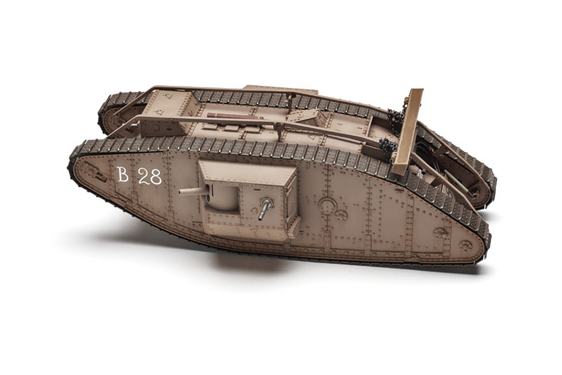

Fear not. Even with the novelty of motion, Tamiya’s Mark IV captures the rhomboid clunkiness of the landship.
The tan parts show terrific surface detail. The Mark IV is a mass of rivets and flat panels that is reproduced faithfully. It’s sharp molding that will catch washes and dry-brushing and really pop!

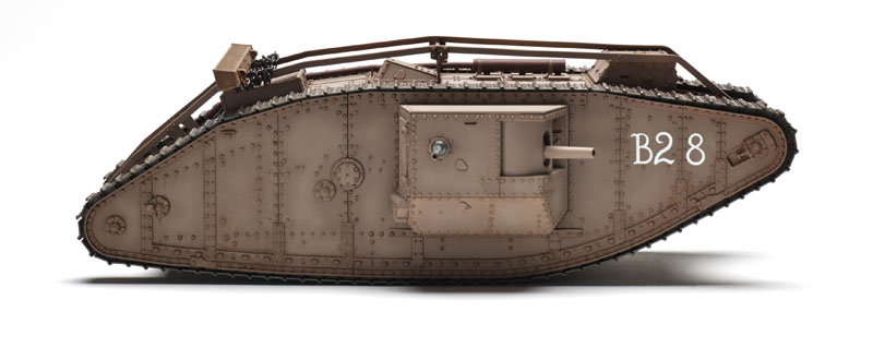

I had the model ready to paint after about eight hours. Tamiya calls for a mix of equal parts flat earth (XF-52) and deck tan (XF-55) for the hull. It does give a good rendition of the “tank brown” most Mark IVs received in 1917-18.
Decals provide markings for three vehicles, including names and hull numbers. They settled over the bumpy detail with help from an undercoat of clear gloss and Microscale decal solutions.

The finished model looks clunky and awkward, just like the real thing. The accurate shapes and easy assembly make this a winner. I recommend it to any modeler.
