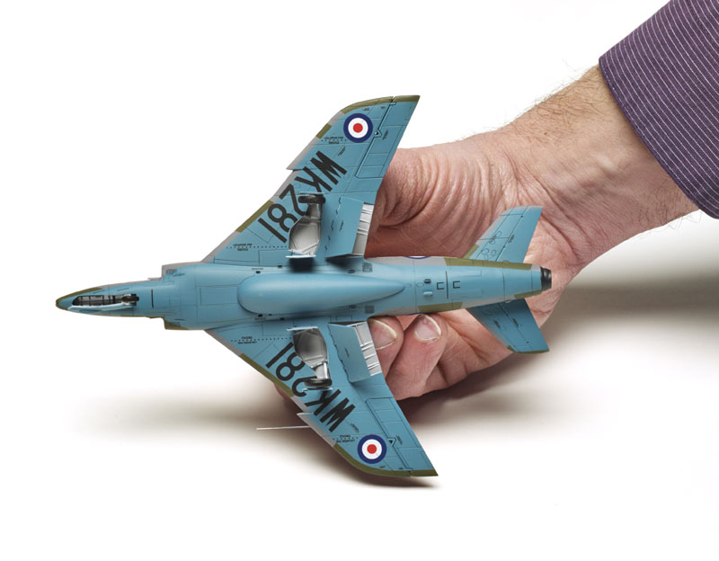

I had real issues trying to fit the combination nose wheel well/cockpit tub assembly into the fuselage. Finally, I sawed the well and tub apart and installed them separately. But the cockpit still sits too low.
The instructions specify 2 grams of nose weight, but there’s little room for it. So, I snipped off the lugs atop the nose-wheel well to make room. I installed additional weight beneath the cockpit as well.
Most of the fuselage seam and the forward wing-to-belly joint needed filler.
Once I was over the fuselage hurdles, the remaining parts fit nicely and the build went smoothly.
The landing gear, wheels, and wheel wells show excellent detail. The gear struts have trunnion mounts at their upper ends, like the real aircraft.
The main wheels mount to the struts with an elongated pin-and-slot arrangement; the slots aren’t in the center of the wheel hubs, so the model’s stance can be altered a little, depending on how the wheels are attached.
The flaps’ attachment points on the wings are small. That makes them more fragile than most of the rest of the model, second only to the pitot boom, which I broke twice. (I finally discarded it and replaced it with hypodermic tubing.)
The clear parts are a little thick. The painting instructions don’t show the reinforcing edges of the canopy’s Plexiglas (“Perspex” to Britophiles) sliding section. However, the box art does. So, using that as a guide, I painted those edges light gray.
I added shims beneath the clear gun/camera sight to raise it to its proper height and compensate for the low position of the cockpit tub.
Painting instructions reference Humbrol colors, but I used Tamiya acrylics, mixing my own PRU blue for the undersides. Two markings options with full stenciling are provided. The decals were practically flawless.
The cockpit fit problems necessitated spending slightly more than my usual building time for a model this size — about 20 hours. However, the finished product looks … well … pretty swift — I think, anyhow.
