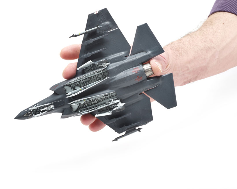

I was impressed with the fit of the parts as I installed the cockpit tub, landing gear, and weapons bays in the upper and lower fuselage/wing moldings. The ejection seat is impressive, with bolstered cushions and photoetched-metal harness and pull-handle. The separate side-stick and throttle seem large for the scale. Inner faces of the intakes fit particularly well.
With everything clicking right along, it was soon time to close the fuselage — and that's where I had trouble. I may have done something wrong, but I can't see how. The bottom of the cockpit tub collided with the top of the nose-gear bay and prevented the forward end of the fuselage from closing properly along those sharp, stealthy lines. I had to grind away the top of the gear bay to get the fit reasonably close, then used gap-filling super glue on the remaining seams.
The canopy is lightly tinted and looks great, but there is no mention of the black inner bow. Is it a brace? An antenna? I used a strip of black decal there. OrangeModel gives you a simple mount for opening the canopy, but it must be glued to the very front of the clear area in the canopy. I decided to leave the canopy closed.
The landing gear is well detailed, but I found I couldn't install the nose strut in the bay without clipping the wingtips off Part E18. The weapons bay doors are complicated but well designed, and fit as directed. I didn't try, but it looks as though they can be closed if you leave off the hinge mechanisms.

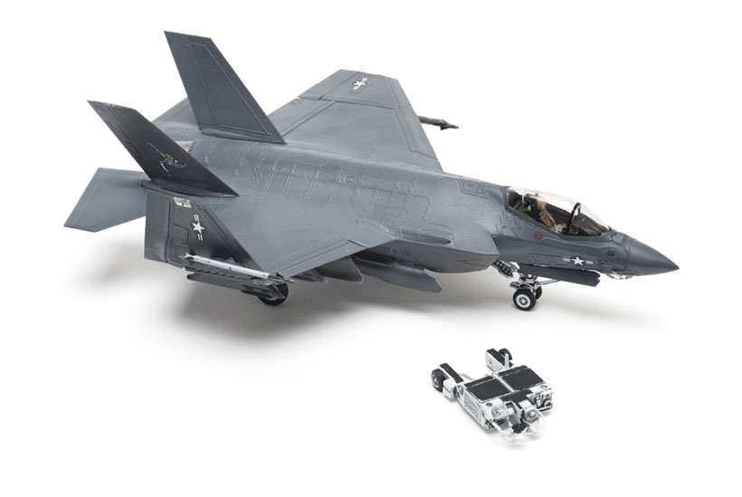

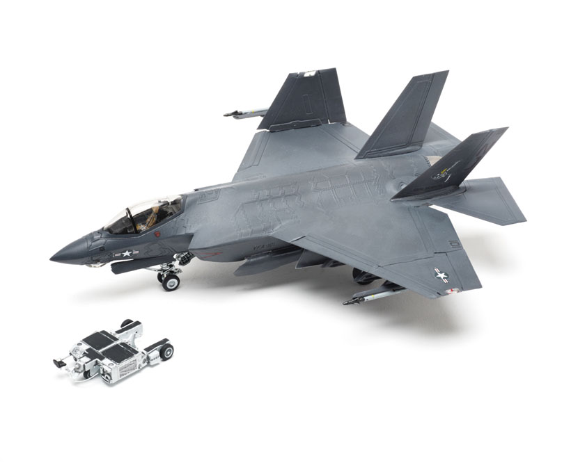

The little aircraft tug was fun, but the photoetched-metal parts for the caster-wheel guard and seat are difficult to handle. I didn't attempt to build the photoetched-metal tie-downs; each 1/4" tightener is made from 12 separate pieces. No way! But I'd welcome a resin casting someday.

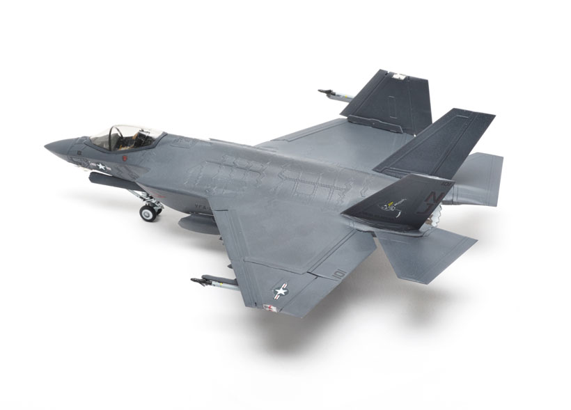

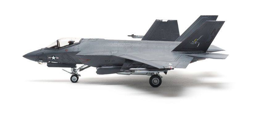

So, it came to painting. The proper color applied to the F-35s is FS36170, and I couldn't find a model paint to match it. Instead I used Testors Model Master engine gray (FS36076). I just couldn't bring myself to paint all the RAM panels without the requisite masks.
The decals were trouble. You have a choice of high- and low-visibility markings for VFA-101. While the high-vis insignia and emblems are good, the gray stencils and warning placards are printed in translucent ink and have a visible pattern. They disappear when applied to anything but white. I'll be looking for aftermarket decals soon.
It was a quick build with a simple paint job (lacking the masks to do the RAM panels), so I needed only 22 hours for my F-35C. It appears accurate, but new, developing aircraft often change in detail. So, we'l see what the future holds for OrangeModel's rendition.
