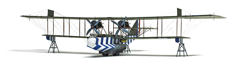

Before attaching the inner part of the wings and tail, I taped the waist hatches in place. Then I masked and painted the hull’s dazzle camouflage. The tail components fit snugly and the struts pop into place, making glue almost unnecessary.

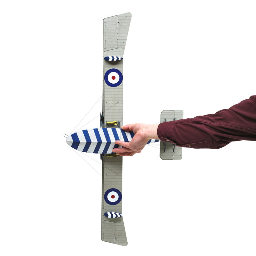

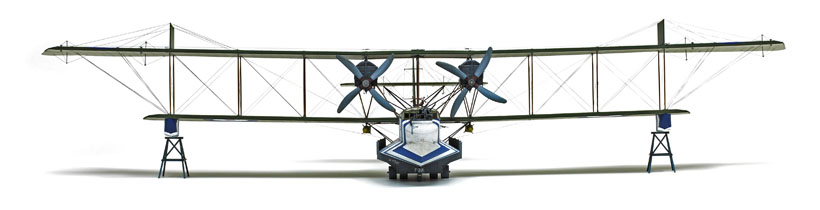

The outer upper wings fit easily. I bent the struts and popped them into place one by one, clamping the wings with tape as I progressed. A drop of super glue secured each strut. I left the huge ailerons detached until near the end, because the attachment points are very small. In theory, you can remove the wings for transport. But I can't see anyone attempting that after assembling the wings and struts.
Rigging this beast looks daunting, but if you take it section by section it is logical and manageable. The rigging diagrams are mostly adequate, but the drawings aren't always clear about where the tailplane control lines enter the hull. There are pre-molded holes for rigging placement — helpful if you want to drill holes through surfaces to pass lines.
I used elastic EZ Line from Berkshire Junction for rigging, and nylon monofilament suture for control lines. Because many of the control lines are divided by kit-supplied photoetched-metal splitters before reaching the control horns, I assembled them off the model.

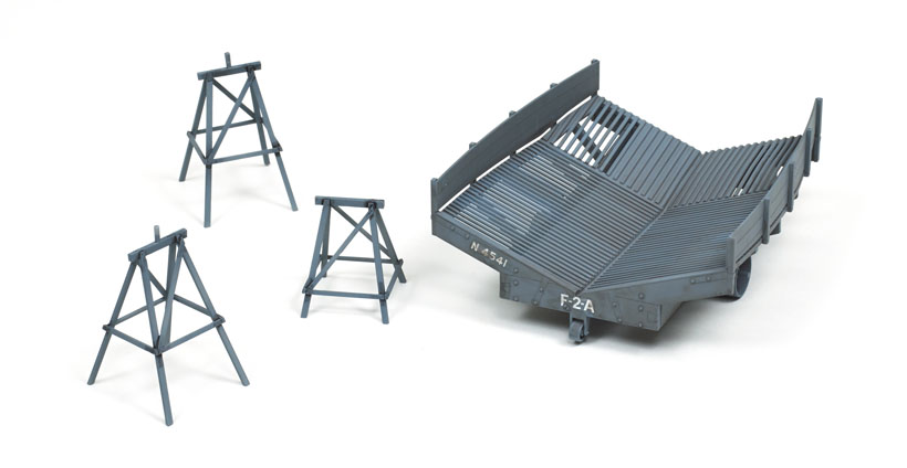

Building the beaching trolley and support stands finished the behemoth.
I spent 118 hours on it and could easily have spent more. I skipped some external lines and all the internal ones, and it still took me almost 12 hours to rig. Masking the striped camouflage didn't make things easier — that alone took six hours.
