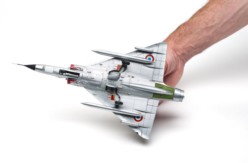

The wings go together without problems. But there is a gap at the wing roots when the wings are added to the fuselage in Step 8. It's easily fixed by clamping the wings and fuselage; the pressure spreads the fuselage to fill the gap. If you glue the aft end of the intakes to the fuselage, the solid assembly won't spread and the gap will need to be filled with putty.
Now you can install the intakes. They'll need clamping for a proper fit. Glue the top and rear of the intakes first. When those joints are dry, clamp the bottom wing and intake joint. It sounds tedious, but you'll get a tight joint that won't require filler.

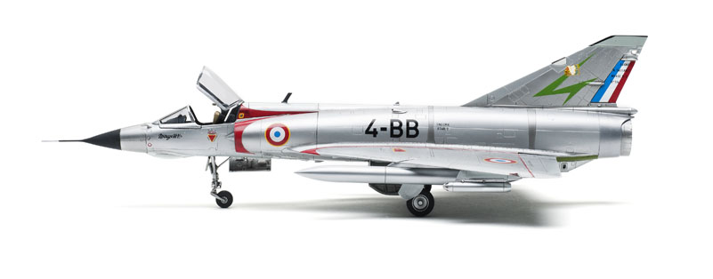

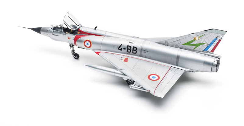

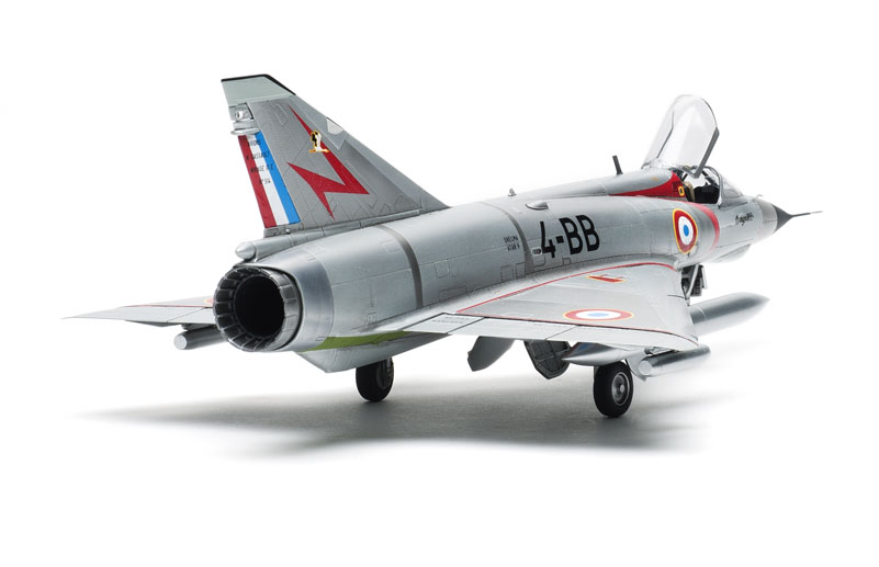

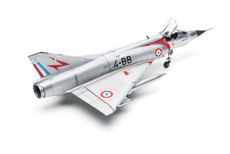

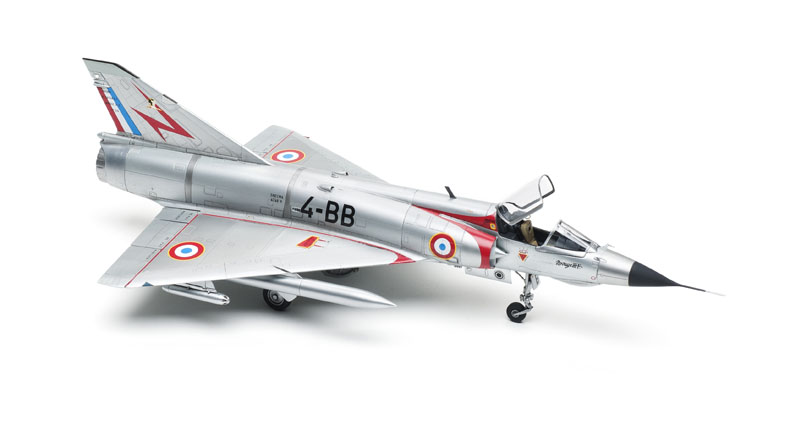

After painting my Mirage in natural metal, I applied decals for one of the French air force fighters. The Cartograf decals performed flawlessly.
I spent 27 hours on the Mirage, but there was some downtime due to the clamping needed. The extra work paid off in my having to do very little filling.
The finished model captures the Mirage's graceful lines. I recommend it to anyone with some modeling experience.
